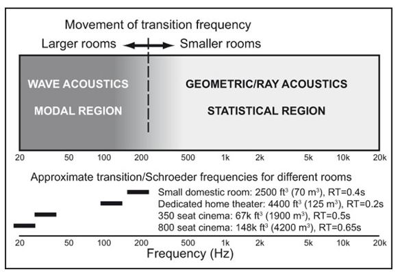

Floyd Toole discussed an additional point wrt active (DSP) loudspeakers in Sound Reproduction 3rd edition:
Manufacturing variations in driver sensitivity and frequency response can be significant, but directivity is unlikely to change. This is yet another advantage of active loudspeakers: the ability to make them functionally identical at the end of the production line.
Toole does not recommend automated room correction activated by pressing a button on a commercial receiver. But that's not how DIYers use DSP. We use DSP to individually equalize drivers and eliminate passive crossovers.
DIYers also use DSP to address high vs low frequency behavior in small rooms. That's an area where a new DIYer will excel. Designing for the room's transition frequency will be second nature for you. You'll never complain about a speaker's "lack of low end" because you'll understand low frequencies require a different design strategy (i.e. different speakers.)
