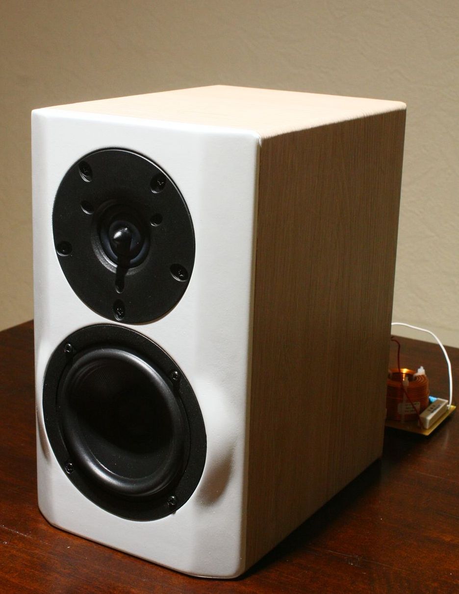

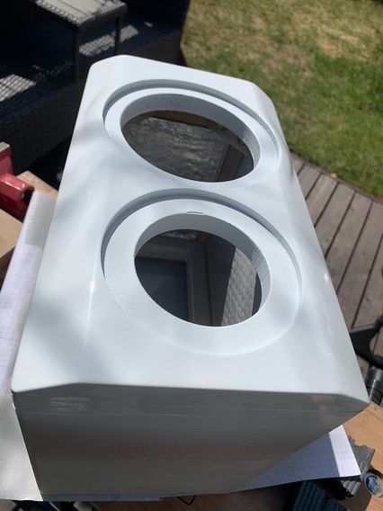

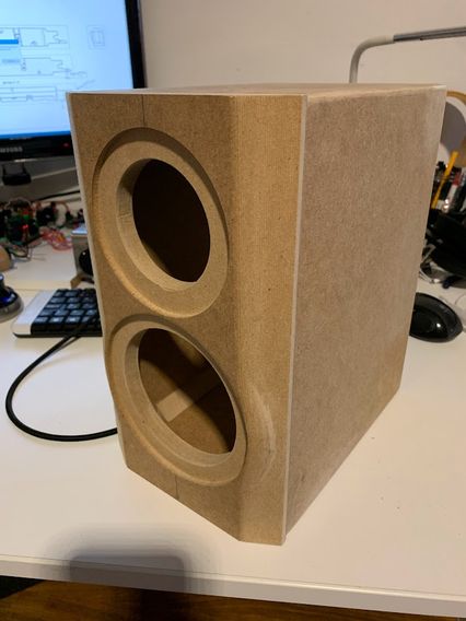

I've finished my desktop speaker. I've attached a some picture from it.

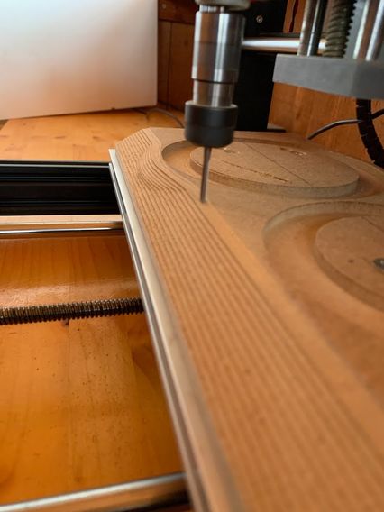

I designed the cabinet 3D CAD, then I have simulated with BEM method. I have a 3018 CNC, so I had to fit the front wall dimension into the CNC working area.
Then the painting process:

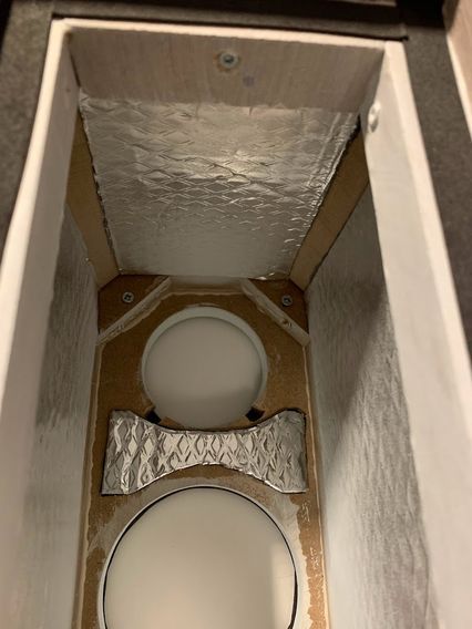

Damping

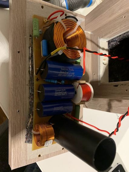

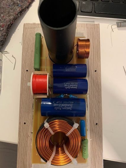

Crossover:

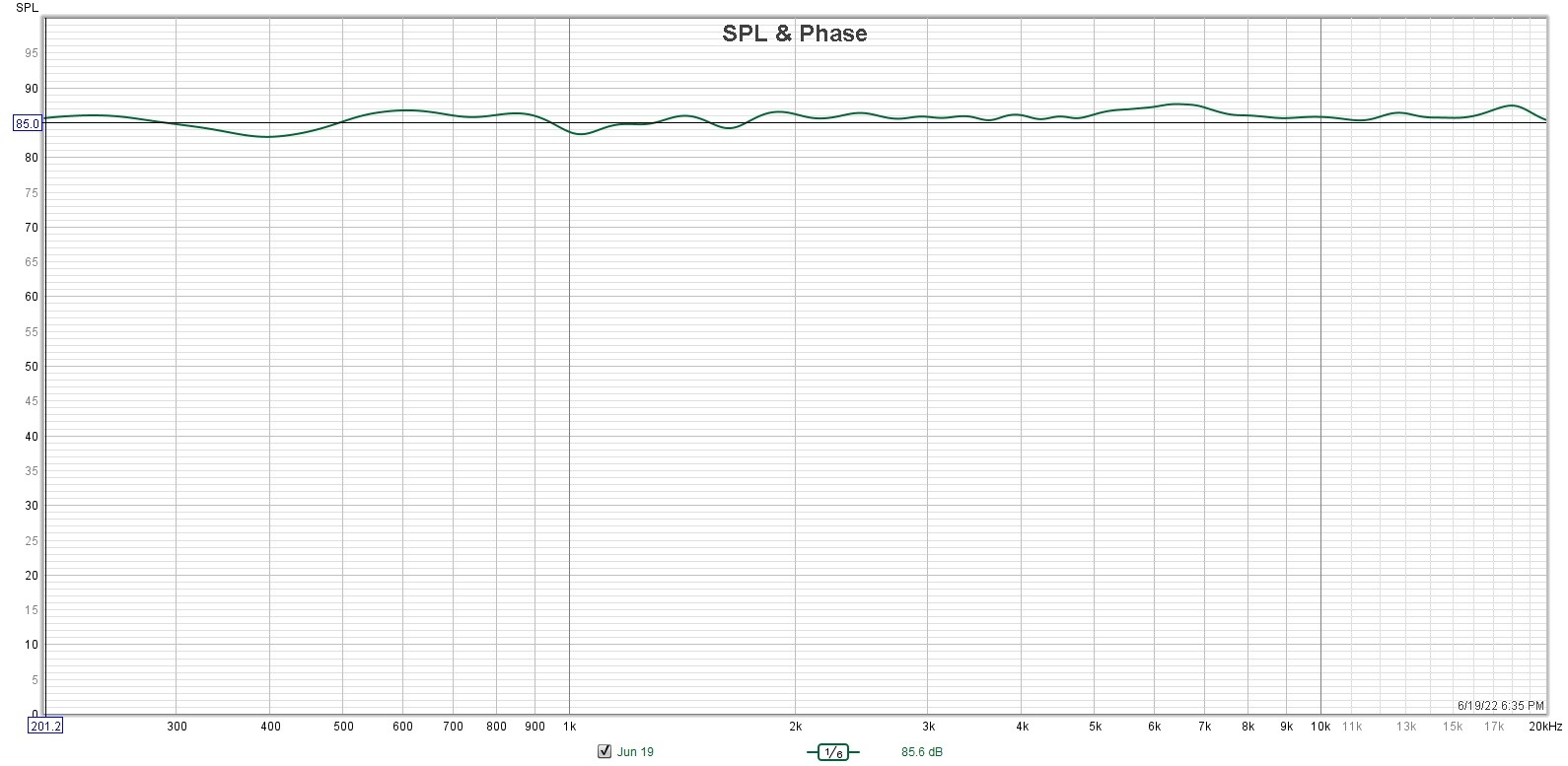

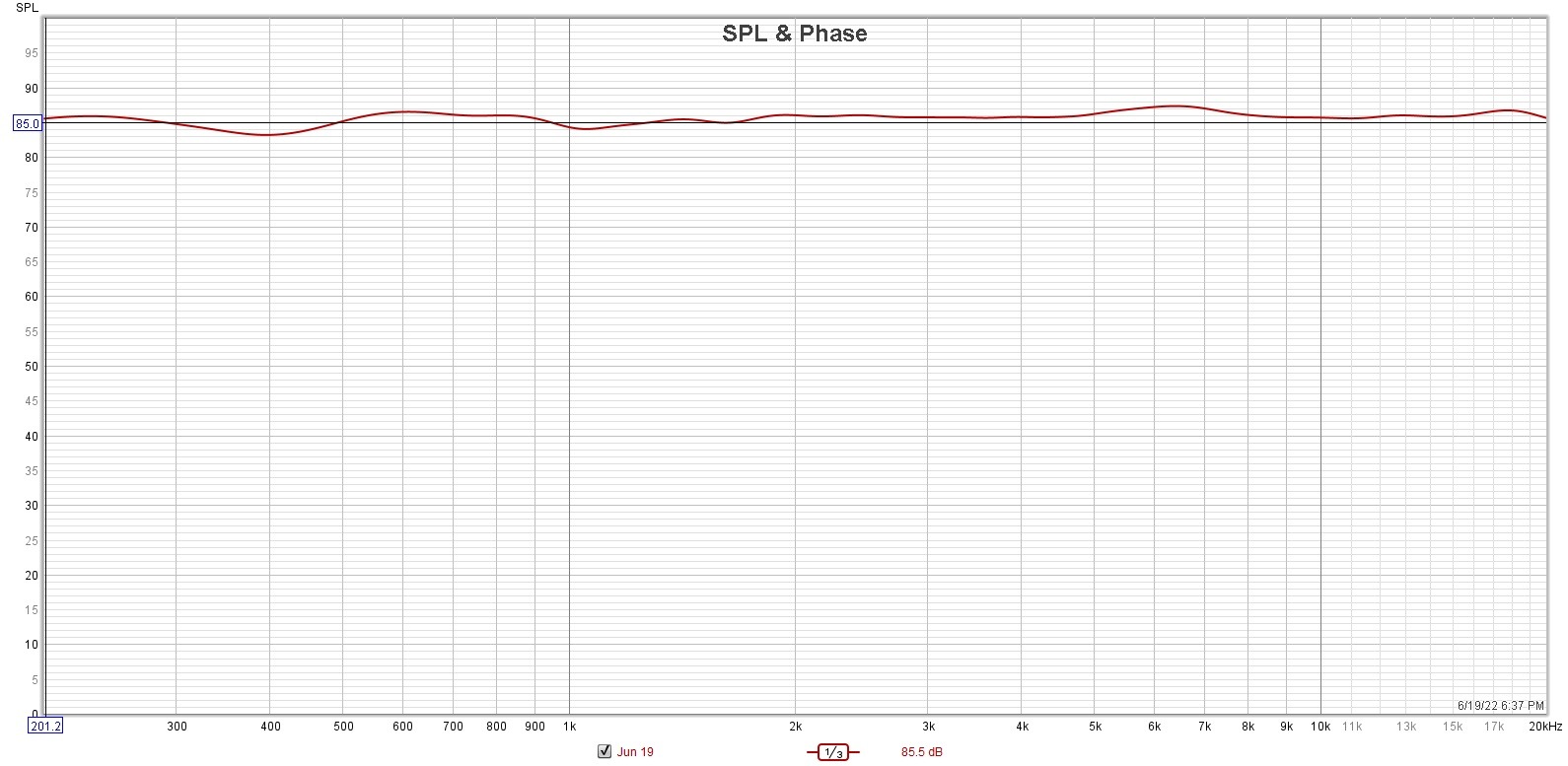

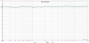

And the measurements. The measurement was gated between -0.3ms and 5ms measuring distance is 75cm (this is the listening distance)
1/6 octave smoothing:
1/3 octave smoothing

this white + oak cabinet looks pretty. Impressive what can acheive CNC in our hobby.
Just personal taste and according to the rest of the devices, the power response may be a little too flat and fatiguing non saying the little bump around 6k to 8 hz -said brigthness area-. You could try more resistor attenuation in front of the tweeter. But this is a detail.
Impressive job for a first loudspeaker ! Bravo 🙂 ... mine is ugly in front of your and does not measure better !
Very nice. Is this a normal / hobbyist 3018 CNC? What else have you built with it?
The FR plots on the pdf imply that it was intended to be listened to 15 degrees off axis (that's the flattest FR plot, without the little 6kHz bump). Is that how you use it?
The sculpting you added to the baffle may have had some minor effects on the response.
A free way to test tweaks is with software EQ: I use Equalizer APO, but there may be other / better options.

My CNC is the cheapest hobbyist 3018 CNC. But It working perfectly for such a small project. I'm also using it to CNC engraving and milling the front of the amp enclosure.
The measurement is on axis measurement, but I'm listening 5deg off axis. Maybe in the future I will correct the 1.5-1.8dB bump at 6kH. The crossover already has a notch filter in this region, so I have to play with the resistor size, but for my ears it is not bad.
Thanks for the suggestion about the EQ. Maybe is a quick and good tool to test it before modifying the crossover.

Would you mind me asking how long it took to machine a baffle?
Thanks for the pics, always nice seeing someone’s CNC work.
Matt
Hi Matt,Well done achieving this on a 3018! I would not have thought it possible 🙂
Matt
It was a slow work. I divided the CNC program into 6-8 parts. First the two speaker's coutout, the roughing one side of the baffle, then the other side, then finishing step of both side. I don't remember exactly but around 1-2 hours each step. Let's say 6-8 hours.
