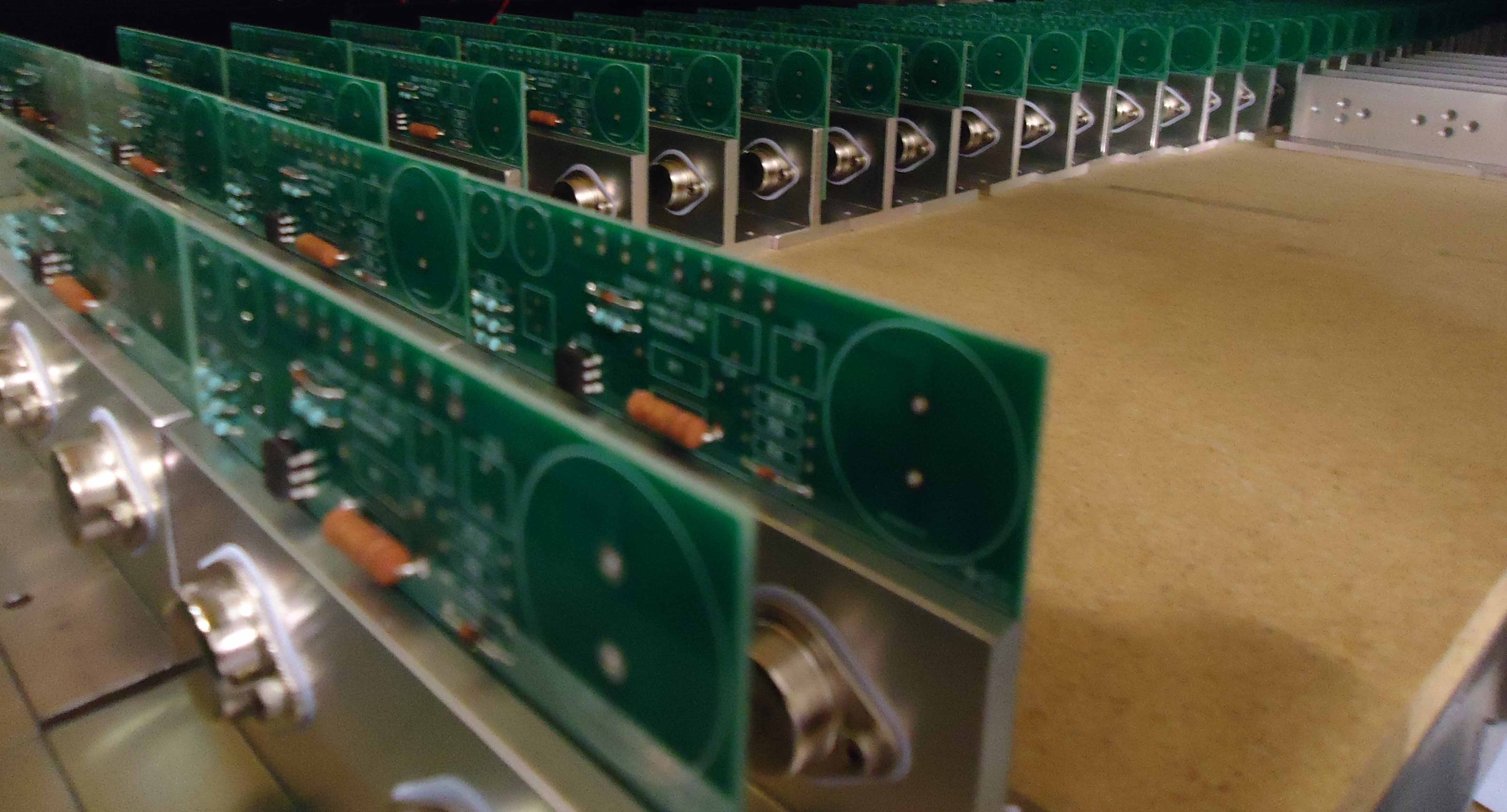

Partially assembled ?!?
Yes. Given the price and scarcity of the Sony VFETs, I am mounting the
output transistors and enough parts to protect them and allow a
functional test.
This kit is designed to be friendly to newbies as well as you sophisticates,
and this way there will be fewer tears.
Don't worry, there are parts to add, and you can still pick your own
caps. It's powered by a desktop supply and I designed a nice little
filter to take the noise out.
There will be options for five, count 'em, five front end designs,
one of which is my M2 input stage, and the others are Mark Johnson's.
(collect them all!)
And wait till you see the chassis....
