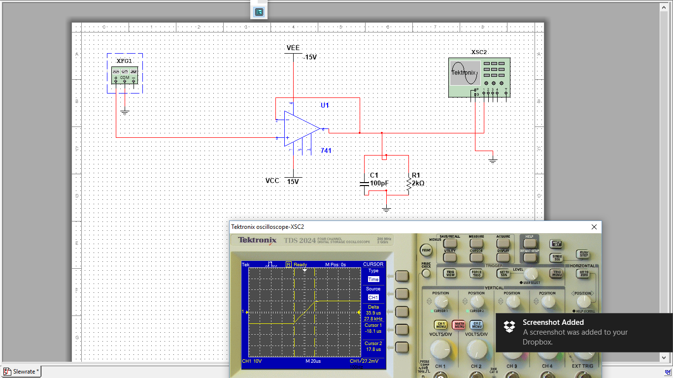

I am currently using ver. 14. Will it be possible to measure slew rate on an amplifier circuit under simulation?

Yes. Read section 1.39 from this version 8 introduction. I will look for some updated information from 14 as that is what I am learning, as well.

Check out the attachment. Made simple slew rate measurement with the Tek TDS-2024. Take your Delta V and divide by Delta T. I come up with ~.551 V/us on a uA741 with data sheet test conditions.
