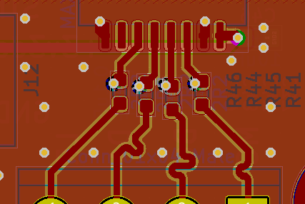

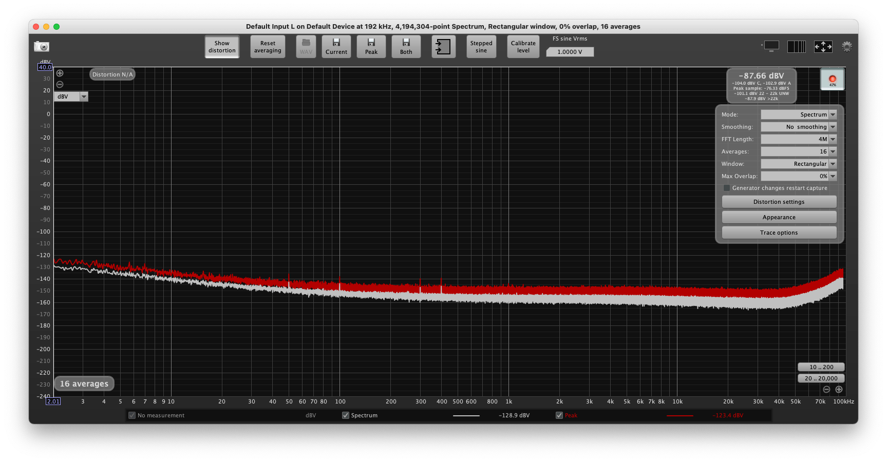

I have used both similar shunt-regulator and simple low-noise LDO (LP5907) with clocks (NZ2520SDA). No noticeable difference in DAC/ADC noisefloor or phase noise. Maybe you should add LP5907 to your board so you could test both.

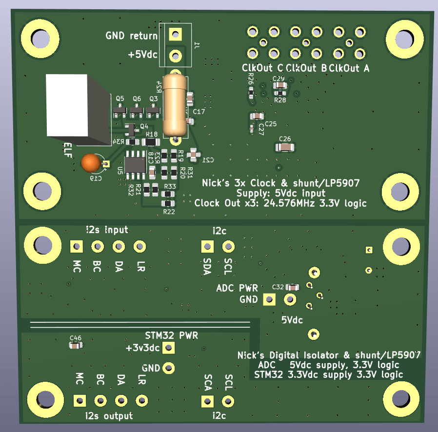

Now with added LP5907 + 1uF caps OR resistor + shunt. I may move the DC side right a little as that ground via matrix next to the oscillator is getting claustrophobic.
LP5907 is very good LDO, and for the digital circuits (including oscillators) it is more than enough.
Like most LDOs it will still need ferrites etc to cope with HF.

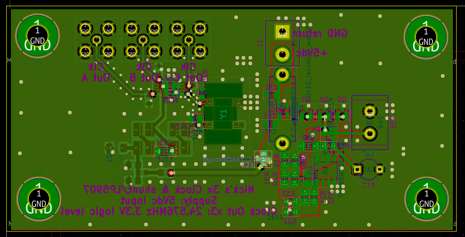

I've essentially finished the design - I need to double check the pins against the data sheets for the ICs etc. These can be populated by either a PL5907 with two caps or the shunt. There's also edges free of mask to make box. I've included a multi-turn borns pot for initial testing that way if the initial 10K resistor isn't right it can be trimmed then replaced by a new value.
You should add series terminator resistors to isolator I2S output. IME isolators outputs can have huge overshoots. What isolators are you planning to use?
i2s : MAX14434. 200Mbits/sec 3.3-5.5V logic. 4 channel, all single direction.
i2c : ISO1640QDWRQ1 which is designed for for i2c.
I did notice the overshoots with the i2s on the protoboard, so that's a good shout.
I've put in source series resistors, I've also added optional spaces on the underside for parallel termination (caps or resistors) to ground. The traces are matched from the IC pads to the resistor pad and then matched from the resistor pad to the connector pad.
I've not tried the i2c yet, however that would require bidirectional additions so I'll add the same for that.
I need to do some additions & modifications - the i2c needs pull-up resistors in place on both sides, and the demonstrator board for the MAX14434 has both R and C surface mounts to ground on both sides - I can adjust mine to get rid of the via (less inductance).
The i2c needs some careful calculation to ensure the draw is <3.5mA according to the datasheet: https://www.ti.com/lit/an/slva689/slva689.pdf so a 1K resistor seems to be right for the 400kHz with minimal load as a starting point.

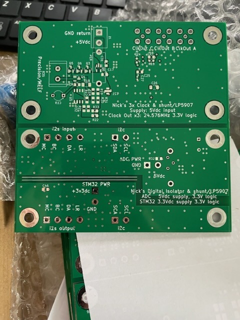

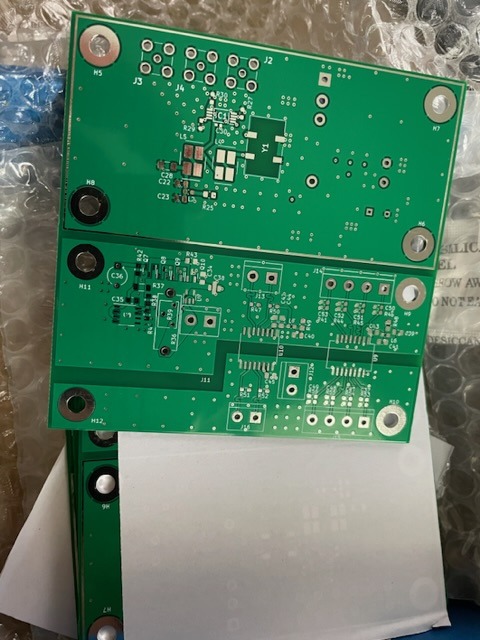

Boards have arrived. Plan is to test some of the impedances and reflections using a signal generator and scope. I calculated some resistors but before i order them I’ll cross check with some measurements.

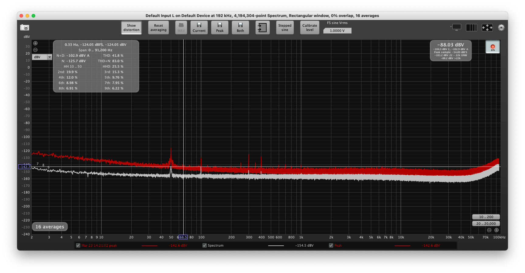

So this is without the 15mF caps on the SMPS power supply - but this is running on my clock and isolator (the wiring needs cleaning up too and a few other things as the 3.3V is using the SMPS too at this stage). That's cleaner than the original SDG without the caps etc.
I need to verify that the clocking is equal too but it looked good from the scope.
So I'm not running the 15mF caps on this first run but it's the first run of my clock PCB and isolator PCB hooked up to the 3.3V on the SMPS supply instead of the 3080 with a second dropping that from 5.0 to 3.3V. Not bad for its first run with a patchwork of wires, sat next to the mains cables (literally next to the plug blocks). It seems less noise peaks are present looking between the two images.
That LF slope and the spikes should be resolved with the 15mF caps and using the 5.0-3.3V supplies.
Starting look clean (and about maxing out my ability to get it cleaner).

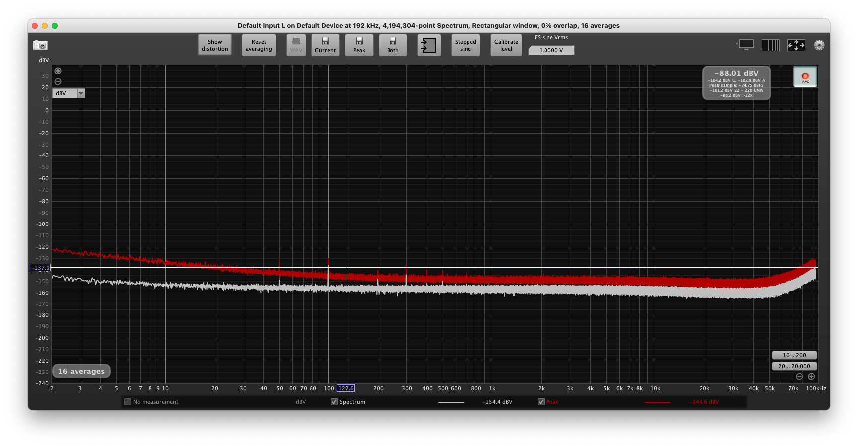

Hehe putting the 15mF caps across the input for the regulators (between the SMPS and the regulator) has resulted in this lovely display:
That's a considerable reduction in LF noise which is good.

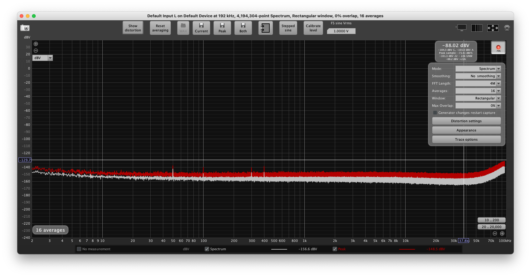

With just the added 15mF caps in (still have the 3.3V on SMPS direct without PSRR... and left to stabilise/warm up - this is a nice image 😀
One last one for a while I promise 🙂

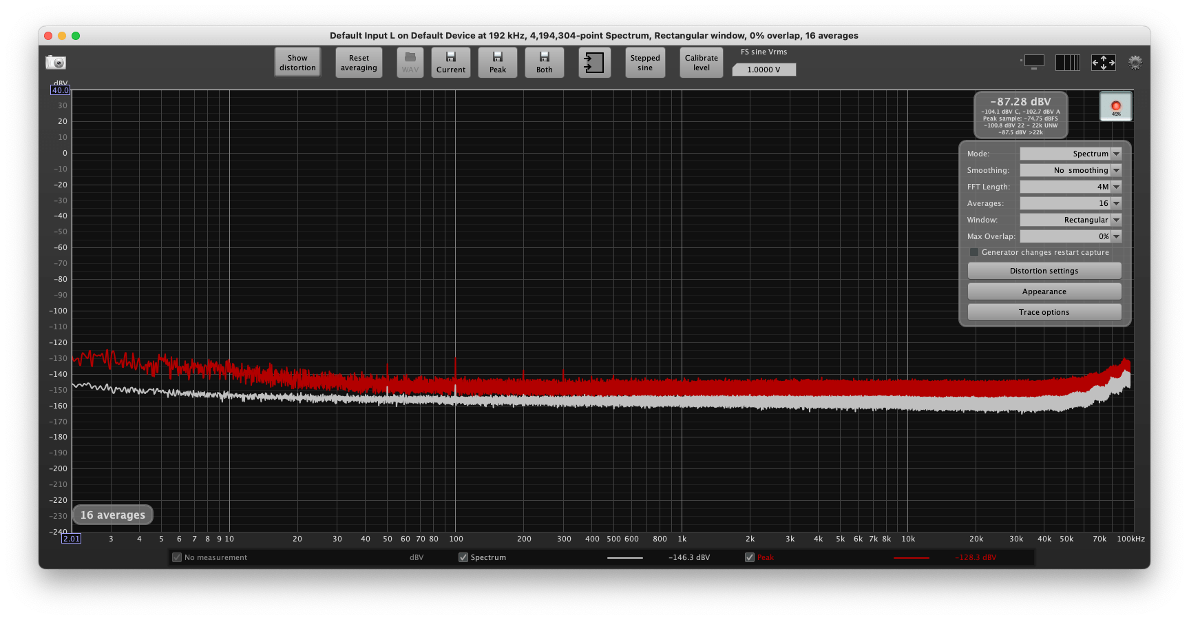

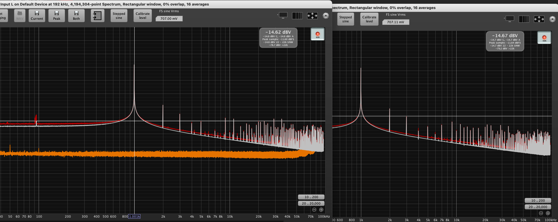

I also tried a single ended SDG generated 1KHz signal and compared to a previous test (where the previous had the SDG also generating the master clock) - left is new with the new clock etc and right with the SDG master clock.
There is a subtle difference - it seems the noise is less allowing you to see more spaces (rendered) between the noise spikes and if you look at the 1KHz skirt there is a small narrowing if you follow the line. This is more noticeable further up the spectrum but a 1KHz signal phase noise distribution doesn't really make too much difference. It does show there's some reduction of noise based on the rough general upgrade.
I'd say the biggest drop of noise was from the isolator (27dB), then the 15mF and regulators on the power supplies (lowing LF noise), the clock is more polishing and the noise reduction. This goes well with what your point about - you will gain more in reducing power supply noise than simply reducing phase noise further. In the end the ADC/DAC then limits by it's internal noise.

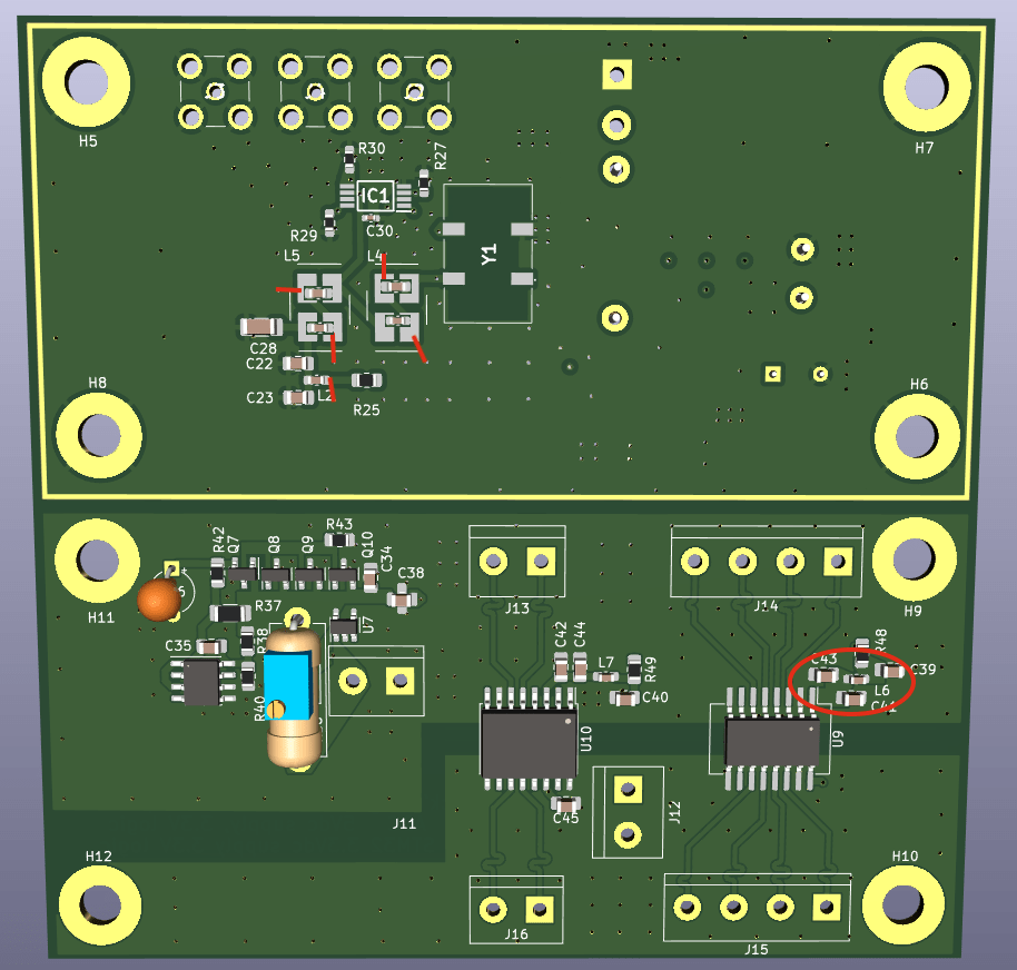

I had a bit of time last night, and a couple of things/improvements (note I still need to order the additional bits but I figured I'd use components I had already):
1. Fitting the isolator decoupling caps - the iso chips didn't have any decoupling which would make them very noisy. (see image circle below)
2. Fitted the clock face down in its final position.
3. Wired up the i2s ribbon ground lanes and rerouted the it.
4. I'm also thinking about changing the larger 25MHz common mode chokes to the 600R 25Mhz inductors to reduce noise - I specifically left the vias uncovered so they can act as solder pads should I want/need them. In this case I can add caps in red to the make a RCLCLCLCLCLC chain rather than the current two inductors - see the image below. The caps will simply bridge to the nearest ground via. (the original filter was RLCLCLC only).
5. I noted that the inductor after R25 (the main power feed) didn't have a cap so this needs adding:
The improvement, just with the positioning and additional decoupling caps, seems to reduce the peak noise substantially after warming up - the space between the peak and the 16x average values has reduced which is is a good indication of overall noise reduction:
I think adding some small caps to decouple the ADC and the clock further (ie small electrolytics and ceramics) will help reduce the inductance of the long test leads further. However I think the next step is making some shielding around the ADC board.
