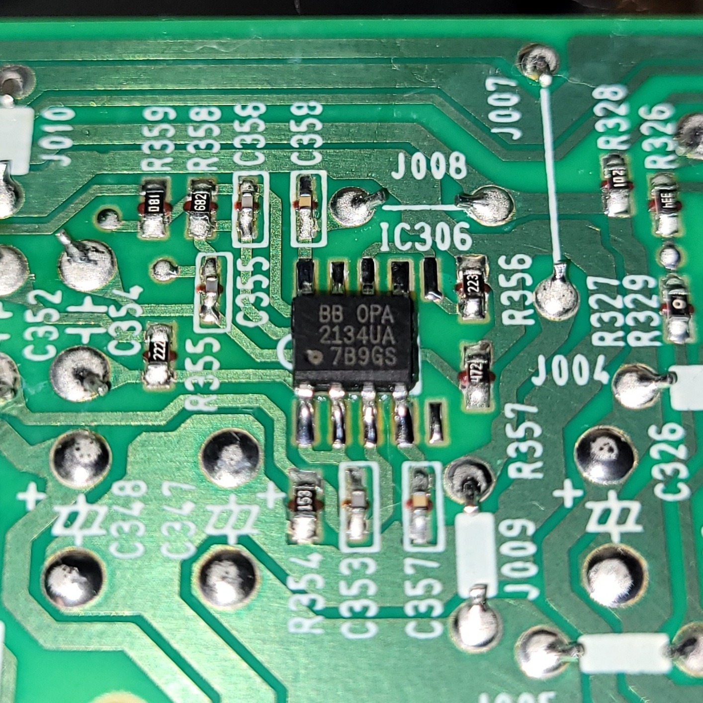

I have a pair of Yamaha HS8 monitors, in the signal input circuit, there are 6 NJM4558M op amps, I would like to upgrade to NJM5532M because they are faster, I fear the circuit will wobble.
Will I gain sound quality?
I see that some people put OPA2134 in place of NJM4558...
Could someone more experienced give me an opinion?
A photo of the input circuit board:
Datasshet NJM4558M:
https://www.njr.com/electronic_device/PDF/NJM4558_E.pdf
Datasheet NJM5532M:
https://br.mouser.com/datasheet/2/294/NJM5532_E-1917664.pdf
See pages 14 and 42 in the service manual.

I admire your quest for a nicer sound, but I really believe that the cost/risk to benefit isn’t going to make that worth while.
I agree with that.I admire your quest for a nicer sound, but I really believe that the cost/risk to benefit isn’t going to make that worth while.
Yamaha designed that in a laboratory to a certain price point and quality.
Since it's a small type of common powered speaker system, if isbarbato wants to "gain sound quality", then a better system is the answer.
Too many people want to "make a silk purse from a sow's ear" and just waste their time and money.

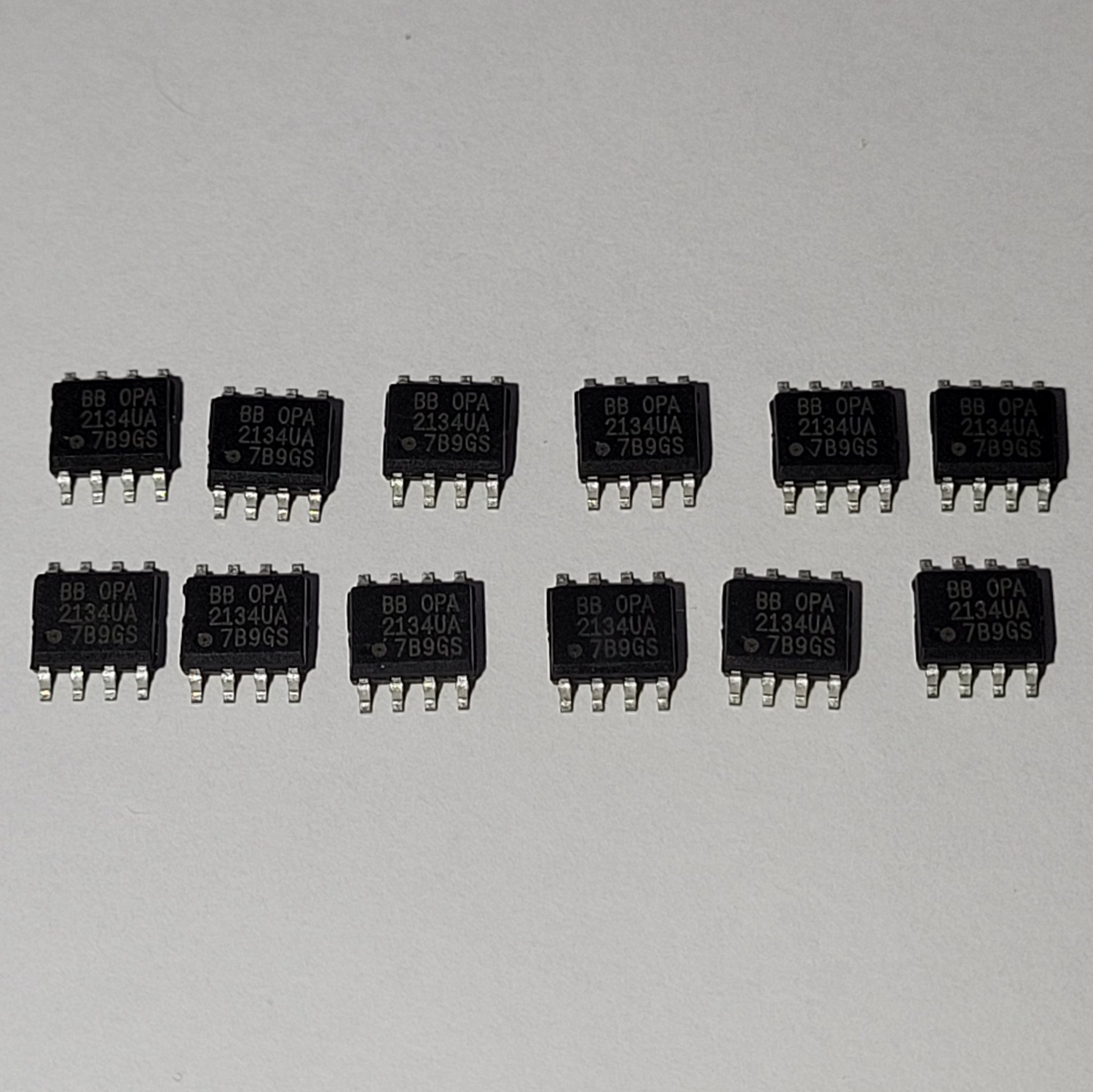

I bought 12 units of the OPA2134UA made by Texas Instruments, I paid $3.53 for each piece.It depends your ear taste.. NJM4558 and NE5532 are both BJT input amplifiers while OPA2134 is a JFET one.

Sure they are real?
The BB marking was changed by TI on some parts.
Also, some pre amps work at their ideal voltage ranges, simply changing them does not work, you have to check if input level and power supply voltages are suitable also.
Otherwise you will get trapped.

With little modification it is possible(often) to swap op-amps. But op-amp like 5532 is quite power hungry compared to standard 4558 type.
Apparently they are real yes, they are not magnetic, the prints do not erase with solvents and the markings are compatible with a Texas Instruments document, and they work.Sure they are real?

They are powered by +/- 15V from the 7815 and 7915 regulators.
The differences in sound are quite subtle, but there are, the highs seem more understandable, less cluttered.
The noise in the tweeter is the same as in the unmodified speaker.

Personally, when I made a phono pre amp, I took the circuit from the service manual of my Kenwood set, which specified a 5532 or 6556. I had to change the input and output resistors to get a proper sound level, as I used a TL072 in place of the 5532 specified.
The user is happy, but the pitfall is that blindly changing op amps is not practical.
In conclusion, if you are happy, do the other channel.
