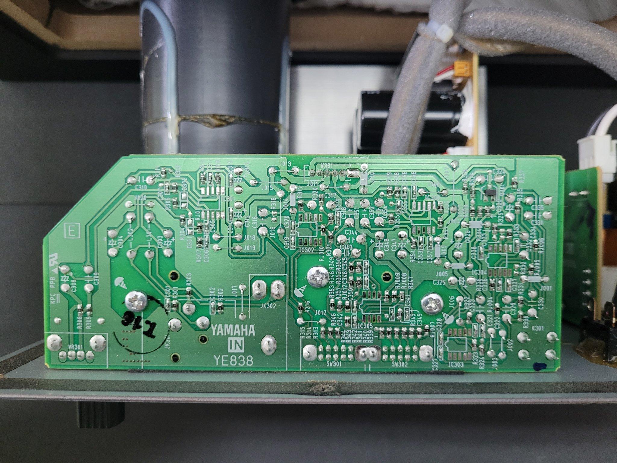

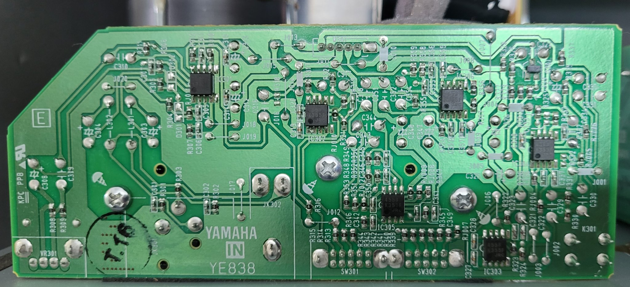

I did not start this topic with the merits of discussing tube amplifiers × solid state amplifiers.
I just wanted to upgrade the 4558 on my audio monitors.
Probably the results I heard are psycholigocos and I'm not sure of the originality of the OPA2134, I'll go back to the 4558 and keep the original speakers.
Be careful of damaging the PCB tracks, I have no idea of your competence level, no offense meant.
Bear in mind the fact that those are SMD, and Yamaha could have put 5532, the price difference in bulk would be too small to bother.
So think why they did so.
I have technical assistance, I have tools and experience in SMD welding. The 4558 should already be competent enough for that application on that particular product.Be careful of damaging the PCB tracks, I have no idea of your competence level, no offense meant.

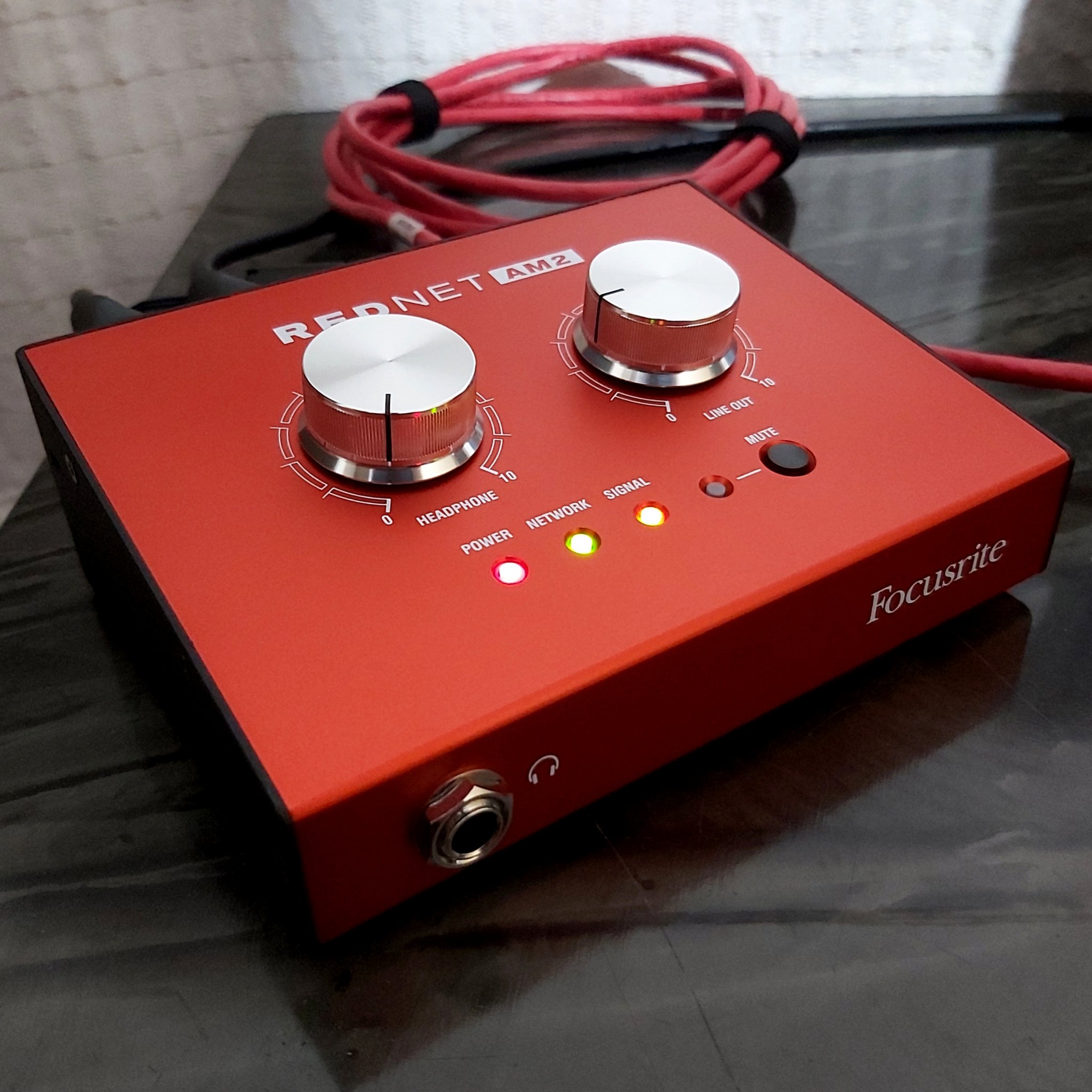

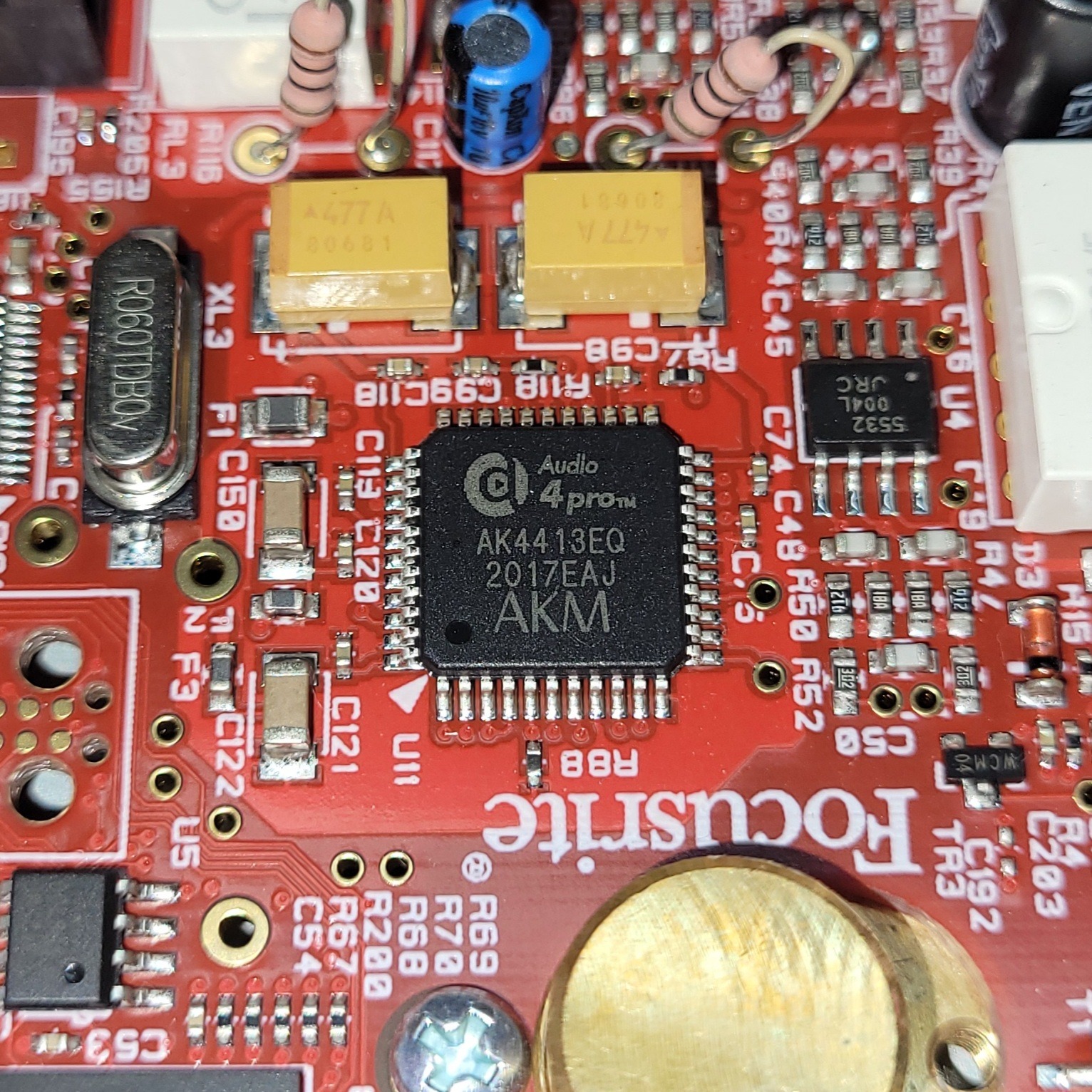

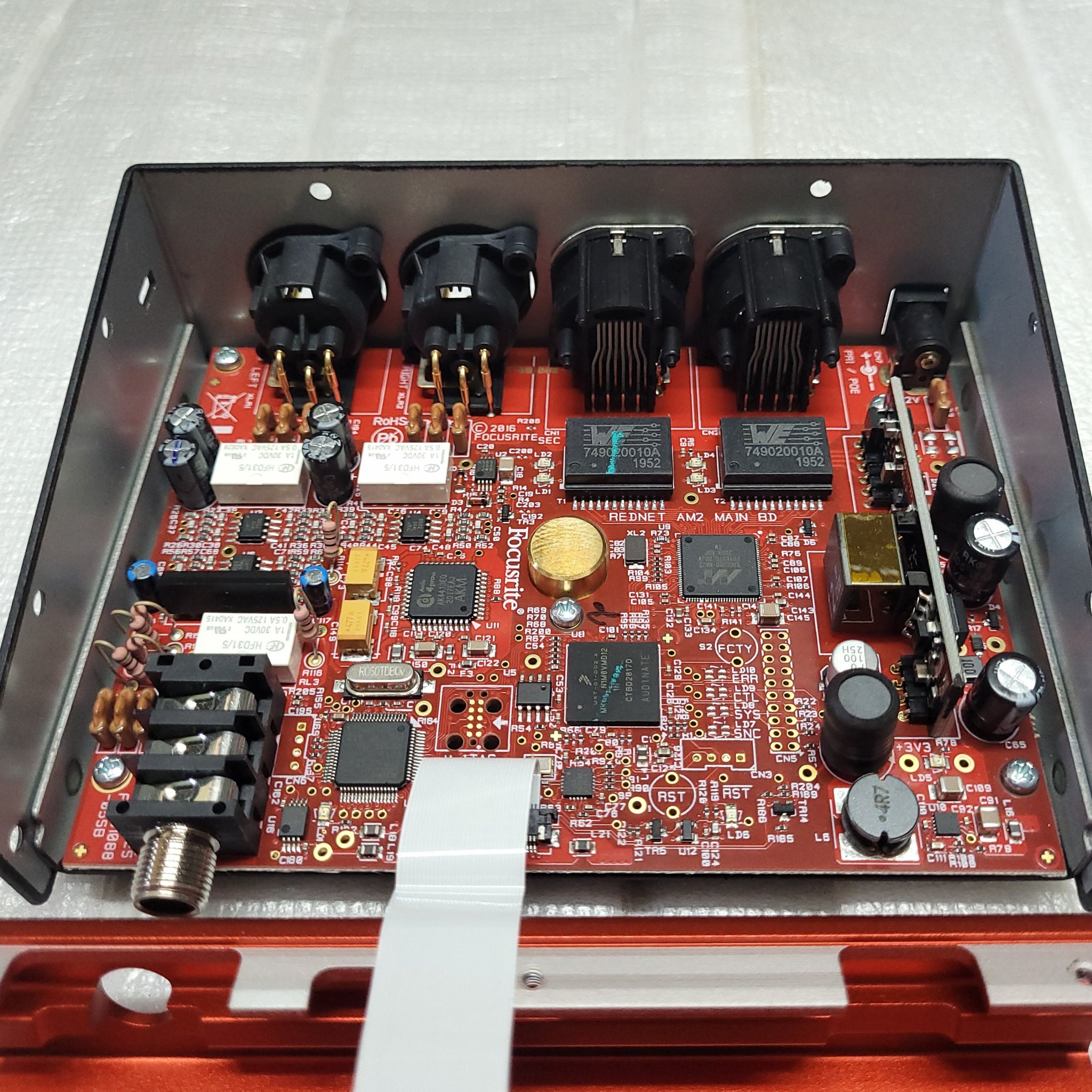

My signal source is a Focusrite REDNET AM2, I buy tracks in AIFF format with a sampling rate of 44.1 kHz and a bit rate of 1411.Internet is full of self styled gurus.

You're right, there's no point in messing with something that's good enough.Seems to me, after reading numerous positive reviews about these speakers, and the $500+ price each, plus the engineering that Yamaha has already put into them, why would anyone not be satisfied with their performance?
Why would anyone attempt to make improvements that Yamaha already did in a laboratory and engineering department?
Maybe I was influenced by the internet and a site that makes this type of modification called zenproaudio.com
Your unit has 5532 inside, not the higher slew rate devices. And CapXon - semi competent Chinese - capacitors...at least a blue one.
Like I said, leave well enough alone.

Worth testing as manufacturers cut corners all the time and better specc'ed devices come out regularly.
On the other hand, if the circuit has been built with one device in mind and in the manufacturer's tests, you should also check whether a new device doesn't make the circuit deviate negatively from what the manufacturer intended. A new 'better' op amp can actually start oscillating and affecting sound in a bad way if some measures aren't taken.
I would also use a scope to check whether there is any oscillation with the new op amps. If so, you'd need to at least add bypass caps to the op amp power rails. The datasheet should help here for the implementation. Then install and re-check with the scope.
Only after that, do your critical listening.
In any case, if the original implementation sounds better, you can always revert to that. If the new ones sound better, you win with a little effort.
It's your gear, you can do anything you want with it, no matter what other people say.
My point was that the 4558 and 5532 were first in DIP, and much later in SMD housings, and the price difference in OEM quantities would be negligible.
Another thing is that the 2134 he got could be laser marked op amps of a cheaper version.
And like you said, it is his gear, he has to decide after listening if there was any change.
Suppose the new ones are really 4558 or 5532?
