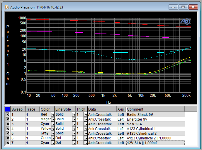

Just ran some z-tests on A123 cylindrical cells which are "aged" -- the impedance is in the tens of ohms. I think the datasheet said 0.006 ohms was typical.
One of the ham-radio blogsters complained that LiFePO4 cells do not age gracefully.
More work to be done.
I would be glad to send you one that isn't tired to test.
I think the continuous charging allows the batteries to stay fresh as opposed to cycling.
So far, after a couple of years in service, I have not noticed any loss of performance but only substituting new ones would make that meaningful.
Might you measure them on the output of a regulator? Just hoping ...
No question the battery you tested could not possibly do a good job at powering anything other than a flashlight!
I figure the key to them is their extraordinary ability to deliver bursts of current "faster" than the regulator preceding them?

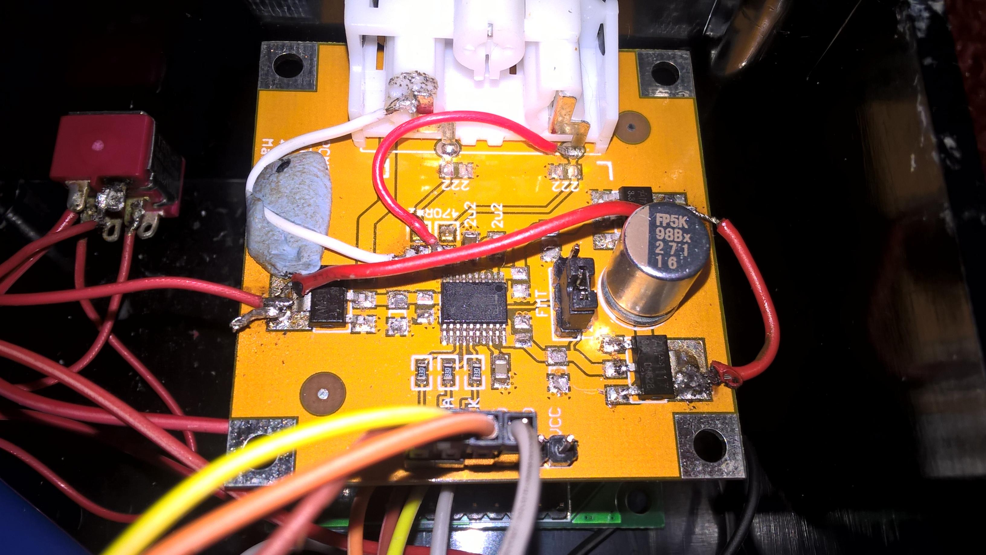

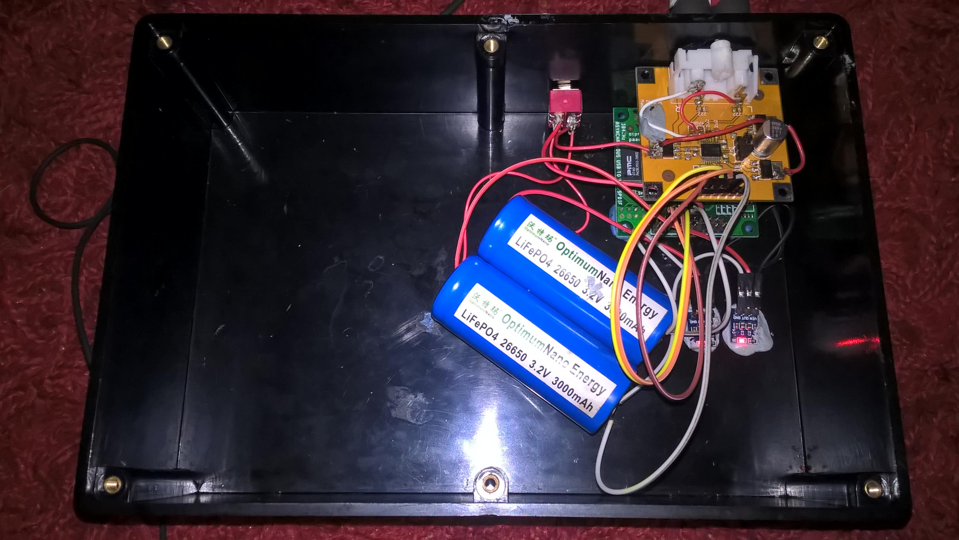

Battery powered DAC
I have read all the posts on this thread with interest as I have been trying out powering one of my DACs by battery.
The first thing I have to say is I have tried various ADM7150 and LT3042 and other lower noise regulator power supply kits but none of them get close in terms of sound quality to a LiFePo4 battery.
The second thing is what Rick says about capacitors on the power rails between the battery and chip doing more harm than good is absolutely correct. The improvement in sound quality after they have been removed is not subtle at all - clearer mids, deeper bass, cleaner top end, wider soundstage etc.
The DAC in the pictures is what most people would call a budget option, but when powered by a A26650 battery, the sound quality is anything but. I am using DIYINHK CM6631A USB->I2S board (£40) paired with a very cheap PCM5102A board (£5 each) both powered by separate A26650 batteries which are float charged by a couple of AMS1117 regulator modules (£1.50 each) which gets its 5V power from the USB->I2S board USB pin. There is dual pole switch between the batteries 3.3v+ and the boards so the power can be cut when not in use
The USB board has been left as is, but on the PCM5102A which is designed to be powered by 5-9v, there are 3 AMS1117 regulators to which one of the batteries 3.3v+ is fed in a daisy chain configuration. After each regulator there was a 10uf and 0.1uf capacitor feeding pins 1,8 and 20 of the chip. These have been removed. In addition the low pass filter (470R & 2N2 cap) on the analogue outputs have been removed so the chip output is wired directly to the phono sockets. Any noise is not audible during normal playback.
The float charge boards are permanently wired to the batteries, but the sound quality of DAC does not change if you remove them (i.e the chips draw all their power from the battery).

Just a wire, the PCM5102a chip and the CM6631A board run from a 3.3V source which the batteries provide. No regulation or filtering of the supply is needed in between.
