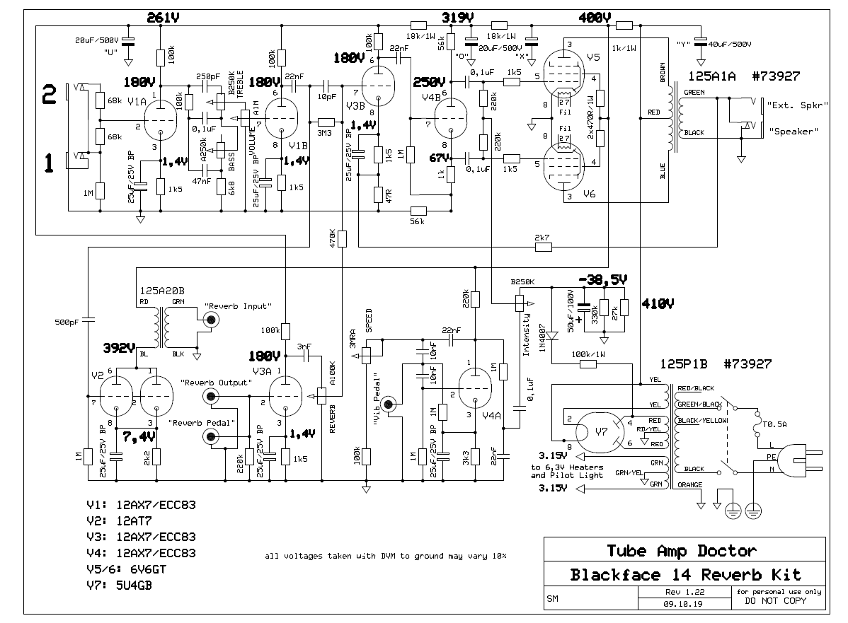

I'm building a Doctor Amp princeton kit and after building it completely I can't make it to work properly. The only sound I get out of the amp is a loud noise.
I've checked if I had positive feedback but the noise is still there after reversing primaries on the output transformer or removing the feedback wire.
This is the noise I'm getting Amp Noise
Any advice of what should I checked? any mistake I should have made? Any bad component?
Thanks!!!

Is this it? Sounds like a problem with the power supply. Diode in backward? How do the voltages measure across the B+ cap / resistor string? Be careful with your meter probe; maybe power cycle off before connecting / disconnecting to the 3 nodes A, B, C with the design voltage values shown.
Lots, and Lots, and Lots of gain . . . plus a very small amount of feedback from the wiring dress creates an oscillator.
3 stages of 12AX7 gain is a lot (the concertina does not count, its gain is slightly less than unity).
I am guessing that another possible cause, may be a ground loop that is creating feedback.

Could also be the more simple 5F2 Princeton, so need to be specific.Is this it?
The audio clip sounds like a tig welder!
Post the schematic (or clearly identify which amp) and chuck in some photos and maybe someone will see something that might be out of place.
Do you know which version of the Princeton you are working with? Here's a schematic of the 5F2A. Check the lower drawing with all the wiring and compare it to yours.

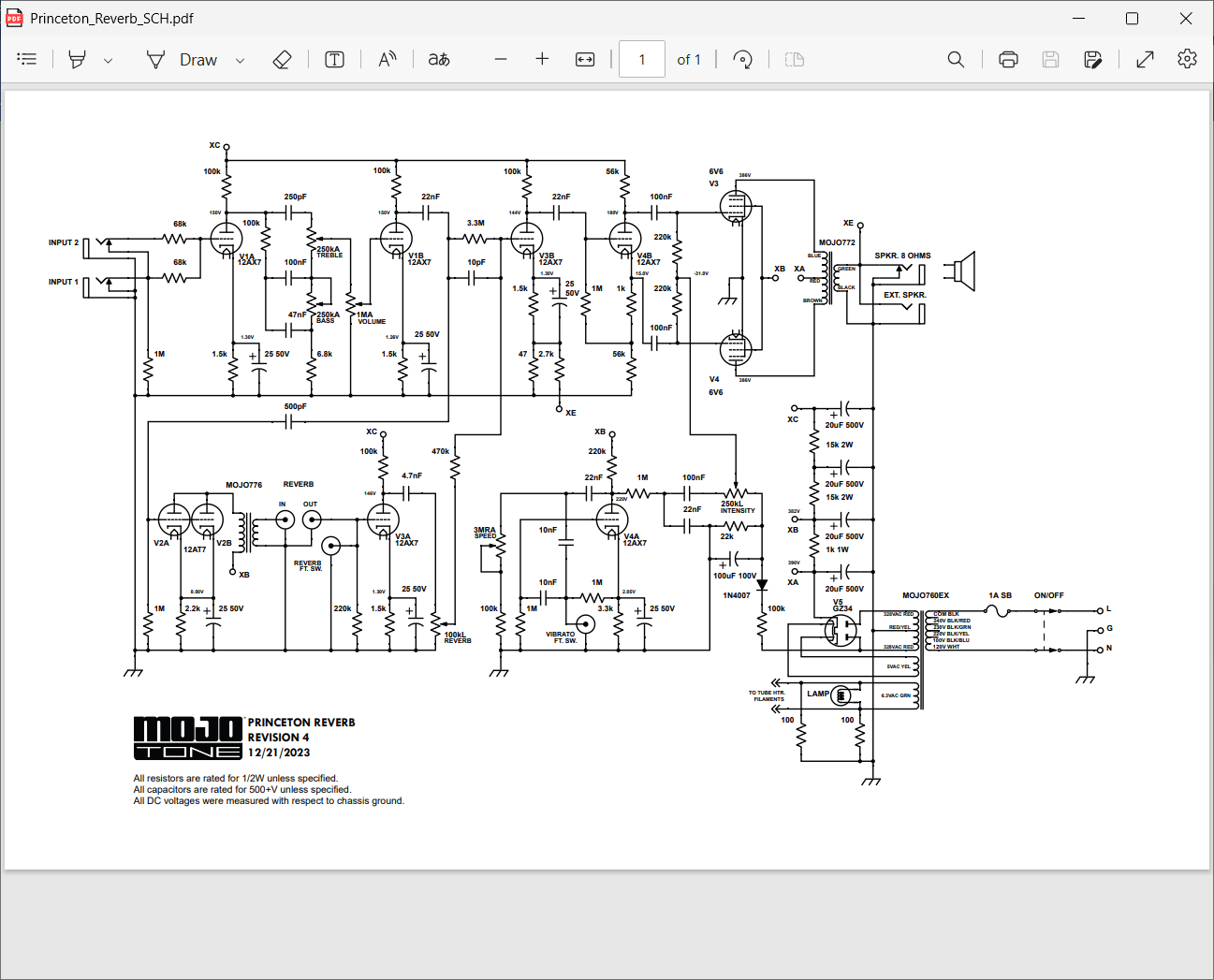

Thanks for your responses. I've managed to find that if I remove V4 (vibrato and phase inverter) the noise is gone but I still can't find out where it comes from.
Any idea?
Yes : it comes from the preamp section, not from the power stage and its supply.
Reinstall V4, put your amp on normally, and successively ground the grids of V1A, V1B, V3B, V4B, through a 1µF capacitor if needed for V4B. When the noise ceases, then you know which stage is the culprit, and so where to start the troubleshooting search...
