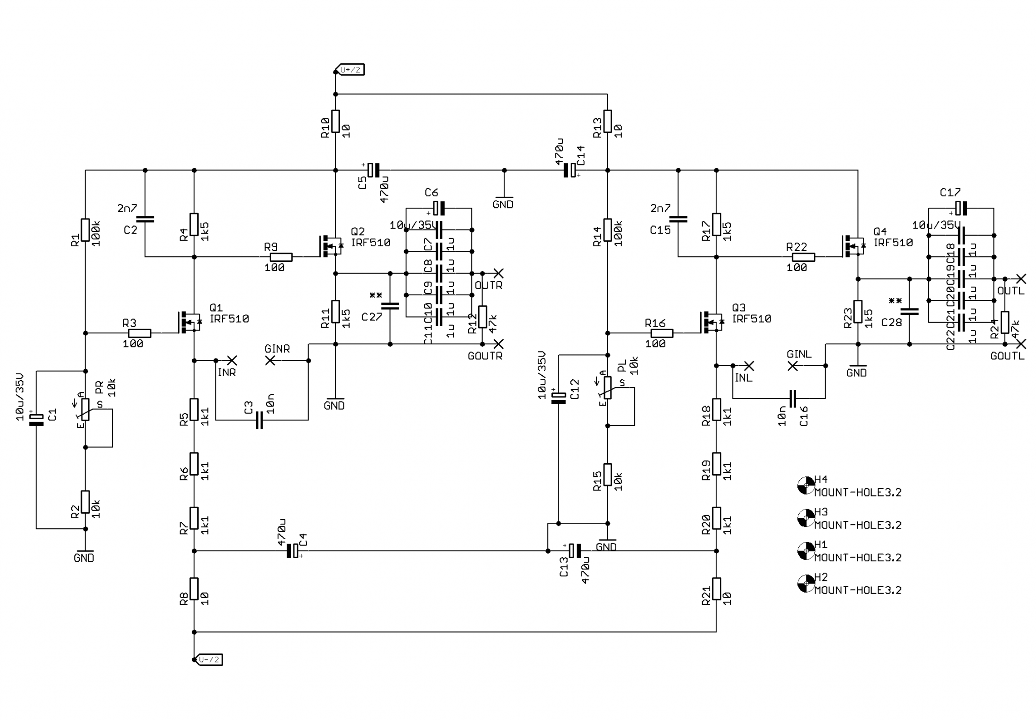

NOS TDA1541 + D1 I/V & output stage
The internal CCS of the 1543 is a 'pull-up' source, to the +ve supply. The digitally controlled current source (DAC) sinks current to 0V. In a D1 configuration the pull-down is what's needed, no requirement for a pull-up source as the 'pull-up' function is effectively provided by the common-gate MOSFET as long as its biassed above the maximum 'pull-down' current from the DAC. To keep the FET in its linear region for all possible DAC output currents it needs some extra 'pull-down' from an external CCS, that's Q2/Q3 on your schematic in post #218. Adding the 1543's internal CCS into the mix just means you'll need to increase the Q2/Q3 current to compensate and that'll just generate more noise.
