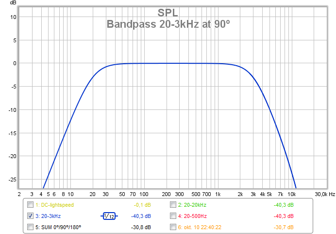

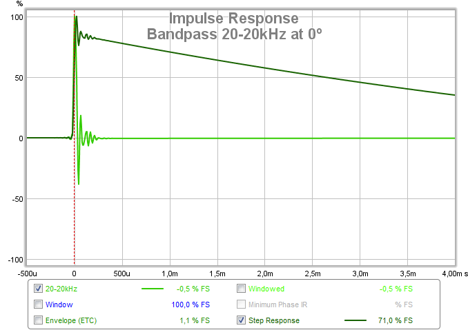

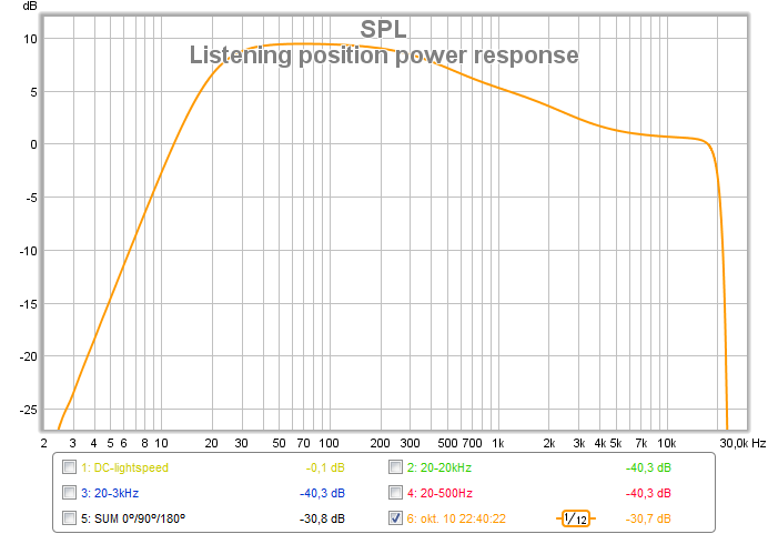

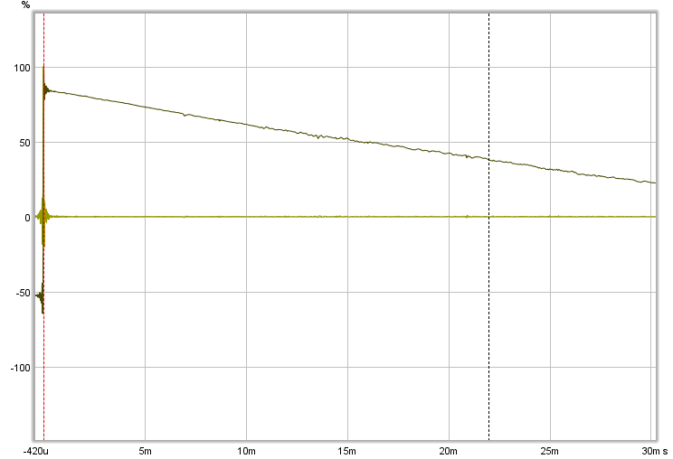

.....I wouldn't call this STEP transient perfect but it has a good continuous flow in the phase. Transient perfect STEP would be flying higher for a longer duration.....
They should get some flying higher when measuring at listening position "Power response" verse short distance "Frequency response" measurement and speaker is in a room.

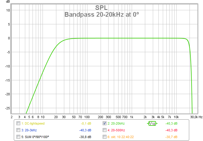

Picture 1 (short distance on axis response bandwidth 20-20kHz)
Picture 2 (90º off axis response bandwidth 20-3kHz)
Picture 3 (180º off axis response bandwidth 20-500Hz)

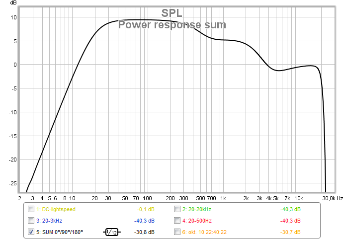

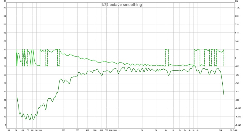

Picture 4 (Sum power response and lets smooth that out and use picture 5 instead)
Picture 6 is IR/SR belonging picture 1, picture 7 is IR/SR belonging picture 5 and when compare these get some flying higher SR. Having slope that fall of as frq rise show gives the soft rising on SR also seen on the line arrays SR plot.

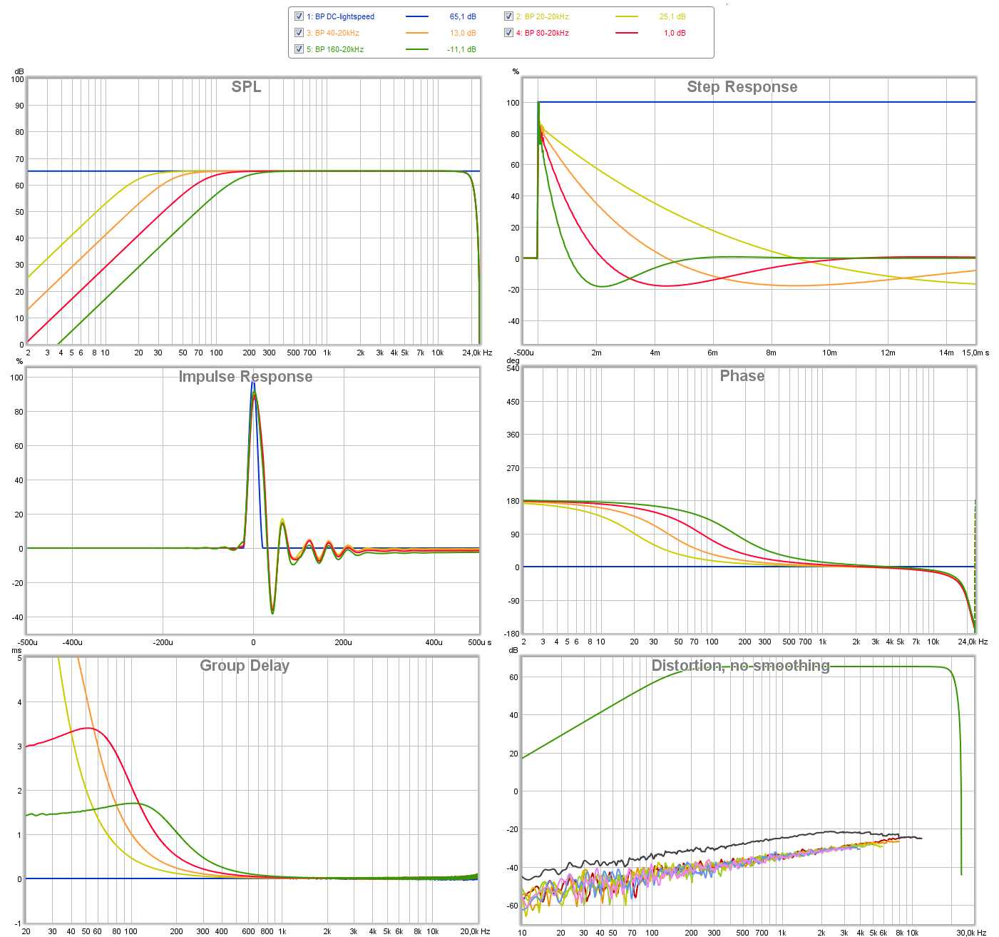

byrtt, thanks for these simulations. I am really starting to understand how all these different measurement graphs are connected to each other.
Looking at my impulse and step response, it looks like I am hitting the 100% point briefly, and staying above 80% for about 250usec, and I cross the line at about 1.2msec which seems to match your 100-20khz simulated step response.
508181d1444469799-eva-foam-performance-speaker-enclosures-dq25-tg9-ob-lr2-4khz-impulse.jpg
What I have noticed in my various step responses, is that the smoother my frequency response the less wiggles and the straighter the slope of the step. It also seems that the accuracy of the time alignment and phase is linked to the cleanness of the rise of the step. In reverse, if I optimize for a clean rising step(no double peaks, no ringing, no sharp shifts, rising on the 0time point) and clean curve/slope, then I get good phase response and good frequency response. So I am starting to realize that getting textbook flat frequency response is important for many things and not just for the tone of the speaker. So starting with smooth response drivers that can be easily eqed seems important.

.....One may ask, why not just use the TG9FD all by itself, it seems to look pretty good after EQ? Well here is the TG9FD only phase:
And here is the TG9FD only IR and SR - not as good as the combined 2-way sysem - mostly because such a steep cutoff is acoustically imposed on the driver at the high frequencies. Byrtt has shown electronic experiments that show this causes the overshoot and ringing in the IR and leading peak on the SR.

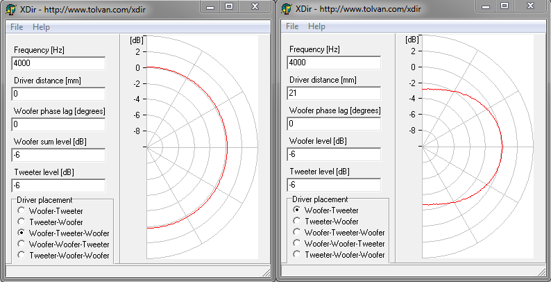

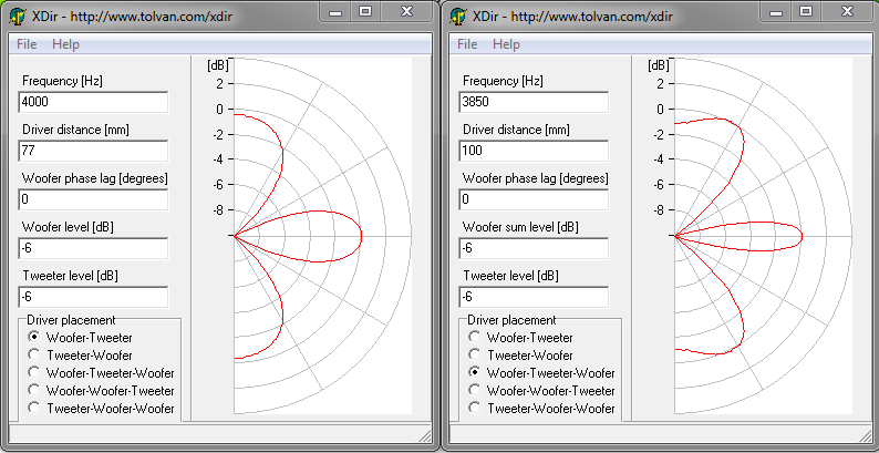

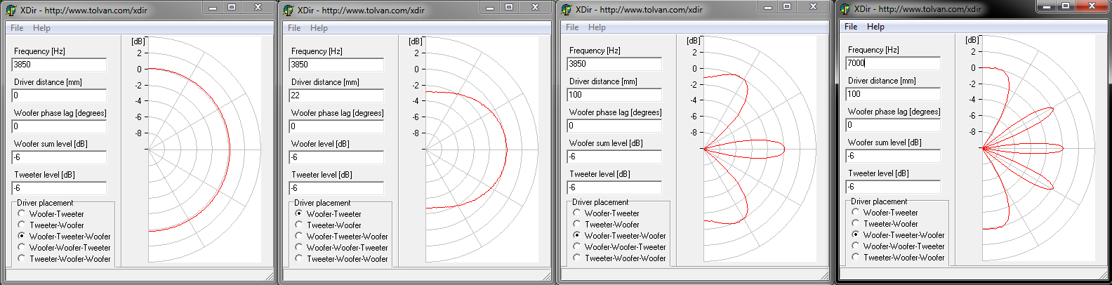

Picture 1 XO area vertical lobe configured as W/T 4000Hz ctc 77mm, then configured as W/T/W 3850Hz ctc 100mm.
Picture two 4000Hz area zero ctc distance then the vertical lobe when ctc is below often recommended 1/4 wavelength, but ctc 21mm distance is not possible.
All these trade offs seems we will never hang on to wesayso's XO-less line arrays, maybe to get closer build as Barleywater LX mini clones or some kind Synergy build or clone the line arrays : )

Your SR is the most impressive of any speaker I have ever seen. How can we ever compete with you? To be fair, the TG9 here has bandwidth from 100Hz up vs your array 17Hz so of course it won't have much staying power beyond a few ms. Once integrated with a woofer that will take it down to 40Hz it will do better but will still be >2x less than your 17ms. So I am guessing maybe 7ms at best.
@GregB, the Bessel is 2nd order electrical. There is some EQ shaping to flatten things before the XO so it would take more of an effort to have a good baffle that is either offset, trapezoidal, or rounded edges to minimize diffraction and also flush mount the tweeter bezel - which I have not done here.

Tweeter improve IR/SR on axis but seems lock ears listening height window in XO area some.

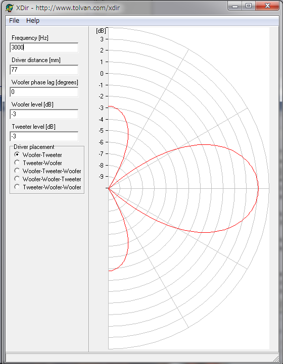

This is very interesting! I didn't know about Xdir, This looks like a great tool, thank you for sharing. Tolvan Data
I am guessing a little here, but looking at this directivity and then add in the nulls at 180deg created from a open baffle dipole, would this not create a very focused forward/rear directivity with almost no energy on the sides? Maybe something like this? again just guessing, but honestly this is what I am hearing from this speaker as I walk around it (about 20deg of direction beam forward/back with almost nothing to the side, above or below)!!
508376d1444569679-eva-foam-performance-speaker-enclosures-tg9-dq25-directivity-4khz-dipole.png

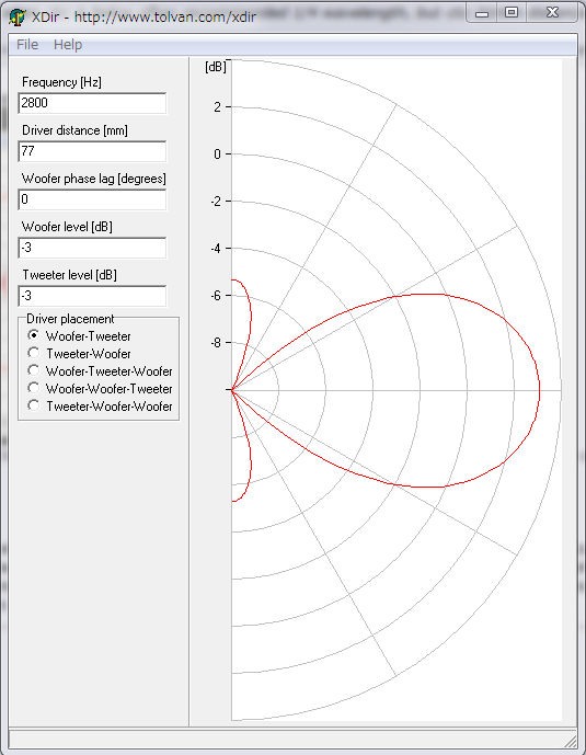

Playing with Xdir, I think I definitely want to see if I can do a 3khz or 2.8khz LR2 as well as I was able to do the 4khz LR2.
508379d1444571357-eva-foam-performance-speaker-enclosures-tg9-dq25-directivity-2.8khz.png
508381d1444572555-eva-foam-performance-speaker-enclosures-tg9-dq25-directivity-3khz.png
Thanks for these polar plots Byrtt. I am quite sure I don't hear this narrow beam when moving my head up and down - I will measure and see. Is it only at the XO frequency of for all frequencies above the 3850 Hz XO?

Guess its XO region dictated by order of slope, to get over this ctc problem wish they made a special coxial TC9/TG9/10F with a cute little mini tweeter into dustcap position XO 7-12kHz and up : )
No problem there be tweeter output but visual there is some difference in the model between using TG9 all the way up (Picture 1), the less than quarter wave ctc distance as recommended to form a point source (picture 2), OB TG9FD/DC28F/TG9FD (Picture 3), and for fun same with a 7kHz XO (Picture 4).
Regarding running TG9FD as tweeter all the way up one could try EQ LP roll off slope, i mean not press and extend -3dB point but try get a softer slope ala BW2 or softer, this must give less over/under shoot.
