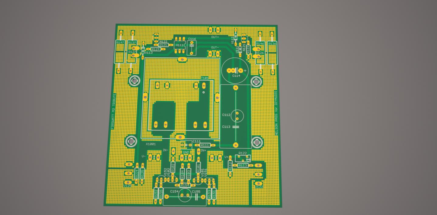

Maybe that's another feature good to have on the PCB: options for different configurations of the coupling cap.

... I´m alive! Bad that PDF is limited to 1MB, I´ve a nice 3D PDF!
The vector font isn´t sexy and I will try today the Hershey-Text ULP. I´m expecting good results.
I´m waiting for remarks until monday. DRC/ERC and I will be ready for GB thread.

Sorry I don´t want to waste time for all possible coupling capacitor configurations: it was really hard to place the shielding without big layout modification. Electrolytics paralleled with MKP, MKS: the coupling MKP is 20mm width, 42 length and the pitch is 37.5mm. I will add some additionnal pads.
