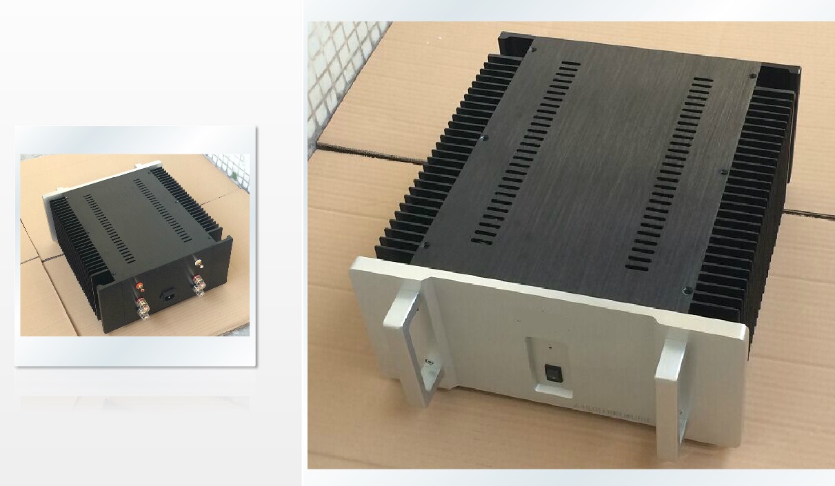

This is one case that I am planing to use on the M2.
Still searching for 2SK170BL/2SJ74BL, most difficult, the 170/74 GR are available but not sure if we can use that. The step up tansformers will be coming in next week. Next is the 1530/201, these aren't easy neither, can get 1529/200 (only differ by 1, you think that can work?) or just go back to ifrp2940/940?
Third step is to plan the power supply, speaker protection, delay startup circuit...
The last and most important thing is the PCB, I am not good in that so just will have to wait.

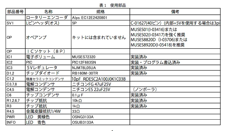

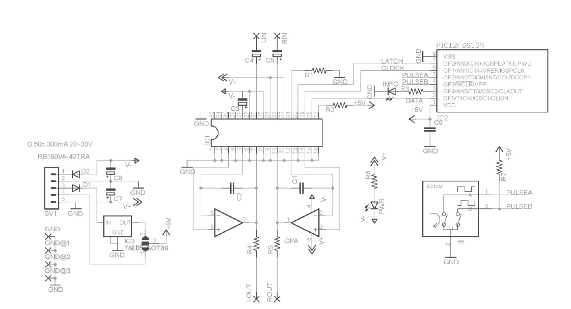

You can do the programing by yourself…? here it is in the PIC12F
Here you see the circuit of a Japanese unbalanced kit only available over DIYaudio friends there…..
of course I bypassed the input caps and the OPA using only the naked Muse.
