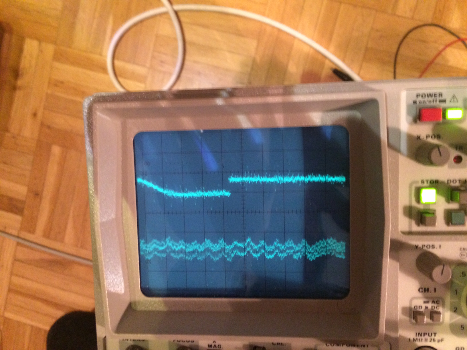

Fired up my first channel. Runs at 1.33A.
Unfortunately I have a hard time to control the DC. Even after over an hour of heating it wanders about, sometimes as much as 100mV in half a minute.
Tried to catch it do it on my scope, sorry for the bad iq.
Both channels are are 50mV/Div and 0.5s/div, respectively.
Bottom trace is the ripple as seen on the positive rail. Top trace is output DC. At the left of the screen you see the DC move down and settle on a new level. The kink is where the beam refreshes.
Any idea what I am seeing there?

Any idea where to start hunting? I am puzzled by the chaotic nature of the drift.
Voltage across C3 is steady as is the voltage across R13+R14.
And I can get music through.
no clue
I am puzzled by the chaotic nature of entire construction.

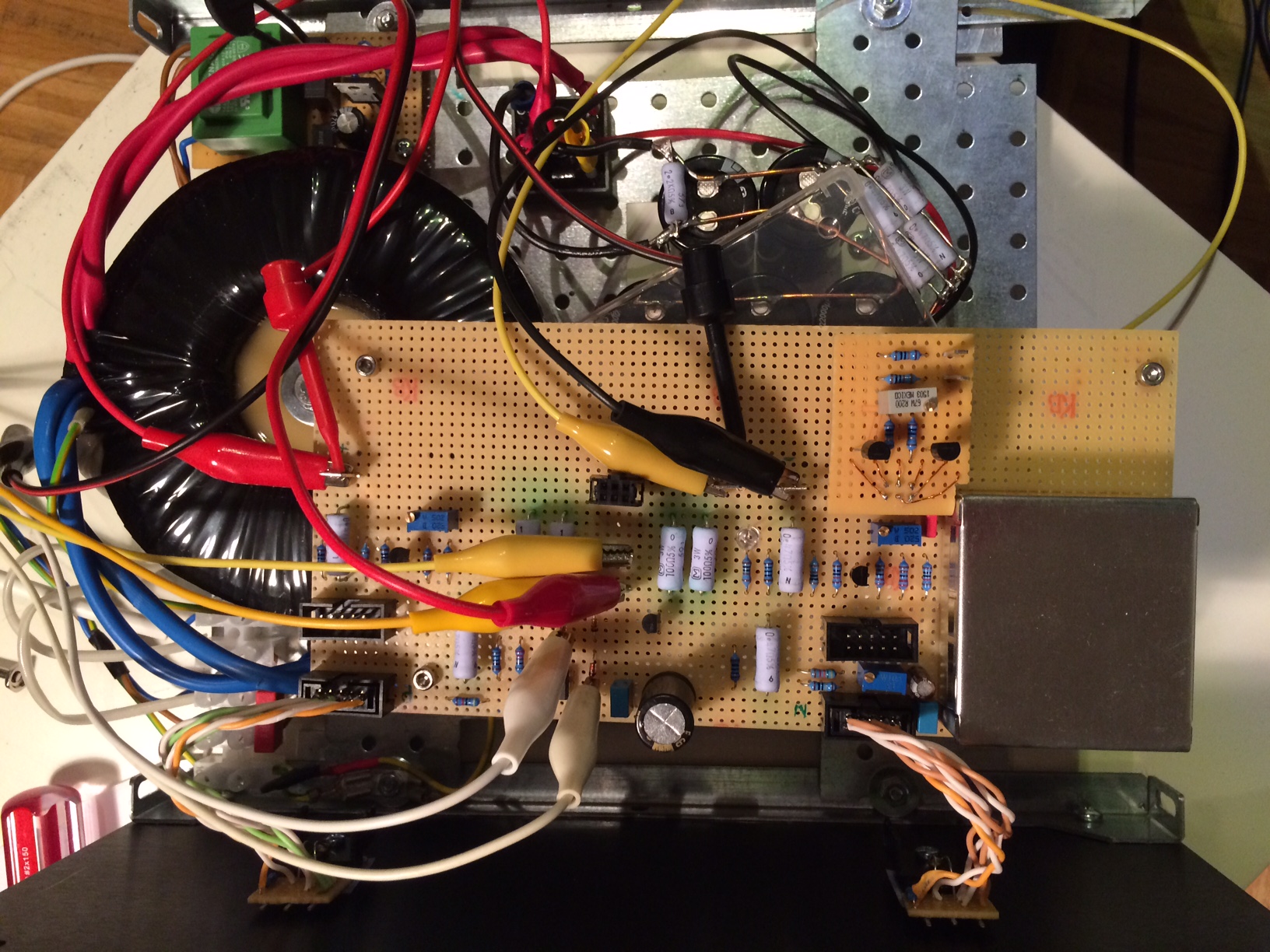

I would never trust these clip cables!
You mean for power supply? I can upgrade that. Just wanted to fire it up as soon as I had the first pcb completed to see if the design bears out.
Also beware of the connector to the transistor, you are passing 1.3A through a tiny contact. It will develop bad contact soon enough taking your speaker while doing so.the DC drifts when I touch the supply clips. ...
