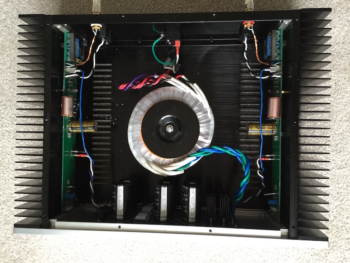

This is the signal i get on speakers. The input is dead queit also when shorting it the signal remains on speakers. Only difference is when I move the toroids away from the circuit I get different modulation and volume.
On the psu do you have your GND return to chassis with CL60 ?
The signal is certainly high frequency but aperiodic which is odd.
Yes I tried also to rotate it and the modulation of the signal is a little different.
Today I played whit different position of toroids and its clear that I need to move them 10cm out of the enclosure to get almost no hum but still... This toroids hum also so I put them on aluminium plate and I get almost the same sound from it as is in speakers...I tried a DC block but no change, they just hum...
Odd experience so far! It looks like the quality of toroids is the most important thing! This were made by toroidy.pl.
Today I played whit different position of toroids and its clear that I need to move them 10cm out of the enclosure to get almost no hum but still...Odd experience so far! It looks like the quality of toroids is the most important thing! This were made by toroidy.pl.
That's a great point! I have a Piltron toroid in my F6, it's about 25% smaller in size than the Antek. I think I'll try swapping them and squeezing it another 1/2" further forward.
change that 10uF for start
though , if crackling is nonexistent with input shorted ........ recheck all solder joints
most important is that you excluded input JFtes and xformers from list of suspects , rest is peanuts
Thanks everyone for the help. It's fixed. I used my meager oscilloscope skills and found the noise everywhere including at the input with no source. It had to be the Jfets. I replaced them again with a pair from a working F5 board. The bad ones test fine with my Peak analyzer so now I'll have to go through my stash of sk170/j74 and see if I have been sold fakes. They were matched for IDSS so I'm not sure...

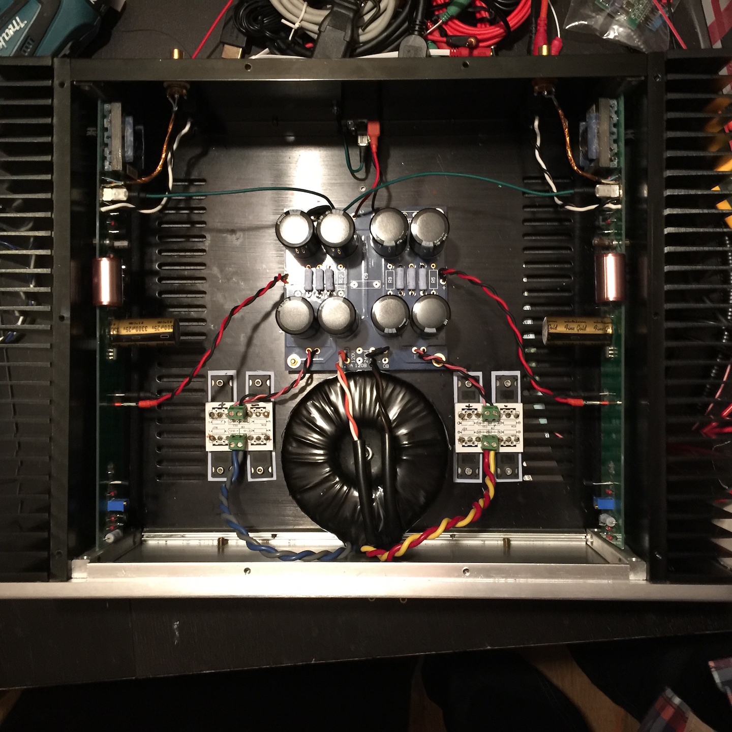

New Power supply and Layout
I spent a day getting this sorted but It was well worth the change. Now the HUM is present at 2' vs 20'. The 300VA Piltron doesn't have a shield wire but is much quieter in this configuration. Now it's cooking time.![note :note: :note:](https://files.diyaudio.com/forums/images/smilies/note.gif)
First photo is Antek 400VA second 300VA Piltron.

Congrats...you will note that is the configuration NP uses...i use it as well.
Because transformer is furthest away from input !!!

Interesting PSU board. Who made it?
