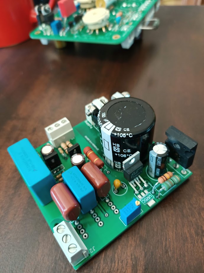

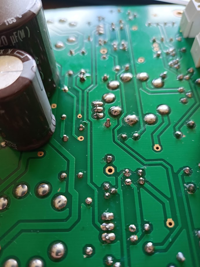

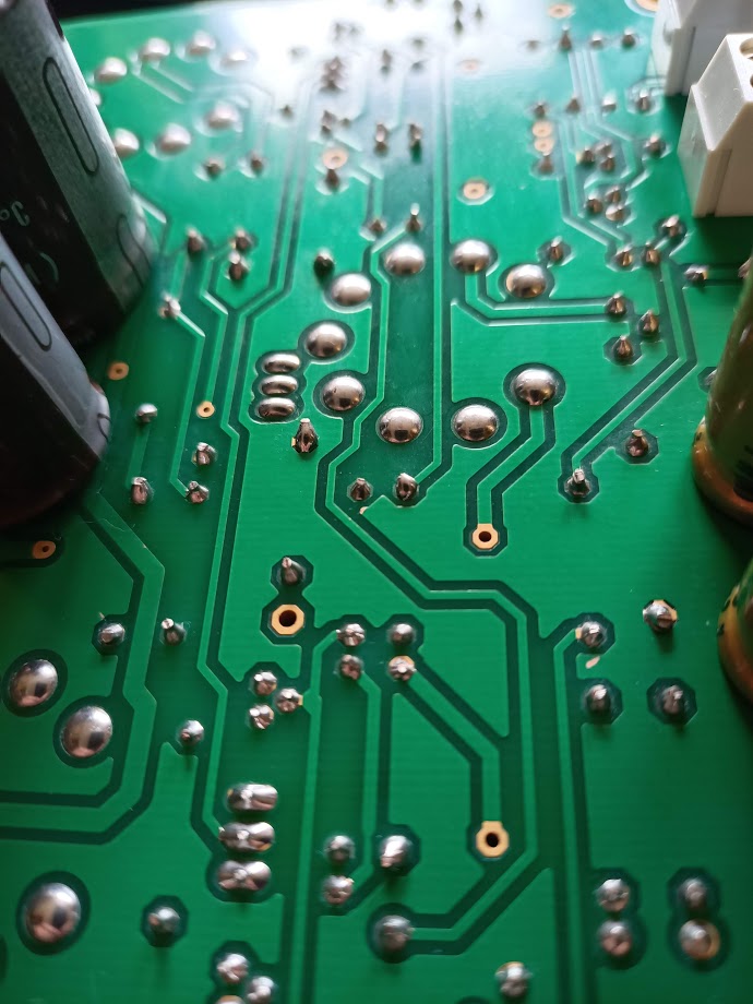

To prevent me from soiling the GB thread GB for Baby Huey PCB I'll be posting assorted pics here regarding my build.
The rounding of the board and the thickness makes for a very nice looking board.

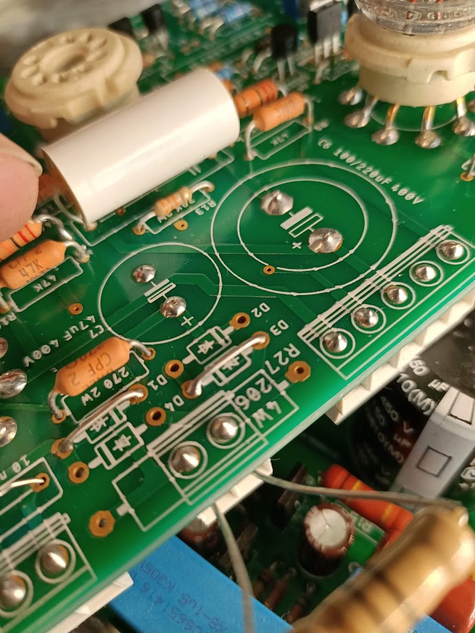

I've decided to use schottkeys for at least the bias supply diodes. Perhaps also for the main psu rectifiers.
https://www.st.com/resource/en/datasheet/stpsc2h12.pdf
They do need some bending to fit. And I'll have to devise something so they don't touch each other. Should be no problem if I check after assembly if they don't touch.

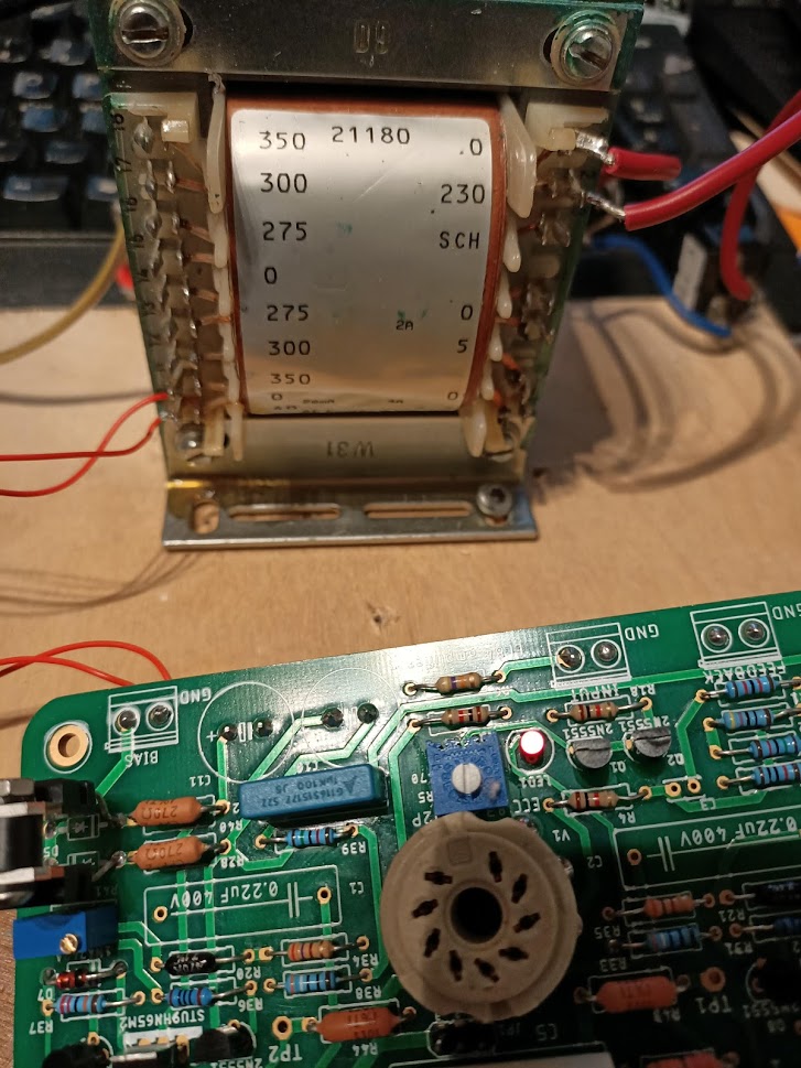

Hi Prasi,I am not sure if marc (bandol83 ) intended to populate them from bottom side .
I populated the sockets from the top.
You gave me a big fright now.
I used this picture as my guide. But looking at the pcb I have in my hand....and the sockets....and the pcb tracks.... all looks good.
Nice solutionMy bias schottkey rectifier assembly just to prevent them from shorting...Just to be safe.
But couldn't you find any bigger diodes for 10mA rectified current ?
Mona
I tried. But mouser said the ones I ordered would be too heavy for airmailBut couldn't you find any bigger diodes for 10mA rectified current ?

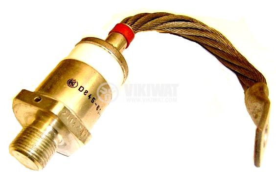

Try this one.I tried. But mouser said the ones I ordered would be too heavy for airmail![]()
1200PIV 100(160)A
