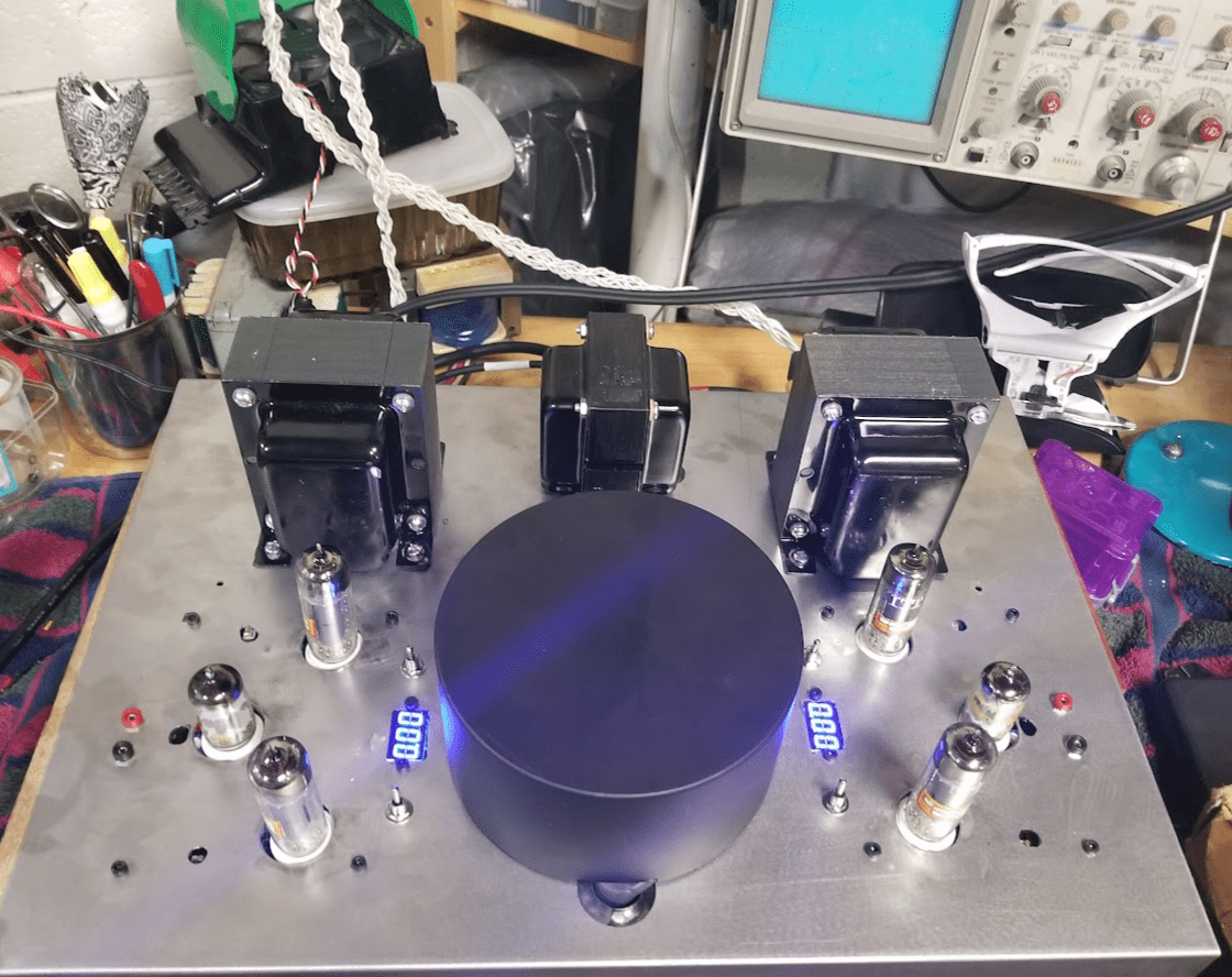

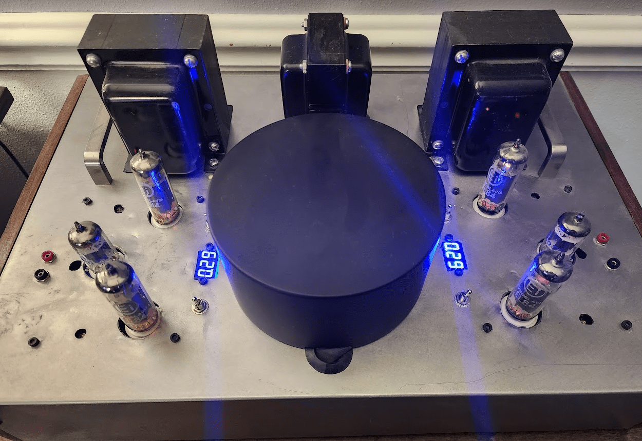

yes - this would imply that I have mine set to 30mA - 300mV across a 10ohm resistor , so if you follow the letter of the law , it should be 0.26V
I set mine up with switches and little built in V meters - it was more important for me to have all the tubes set the same and having an easy way to set them. - and now they are reading .29V :)
