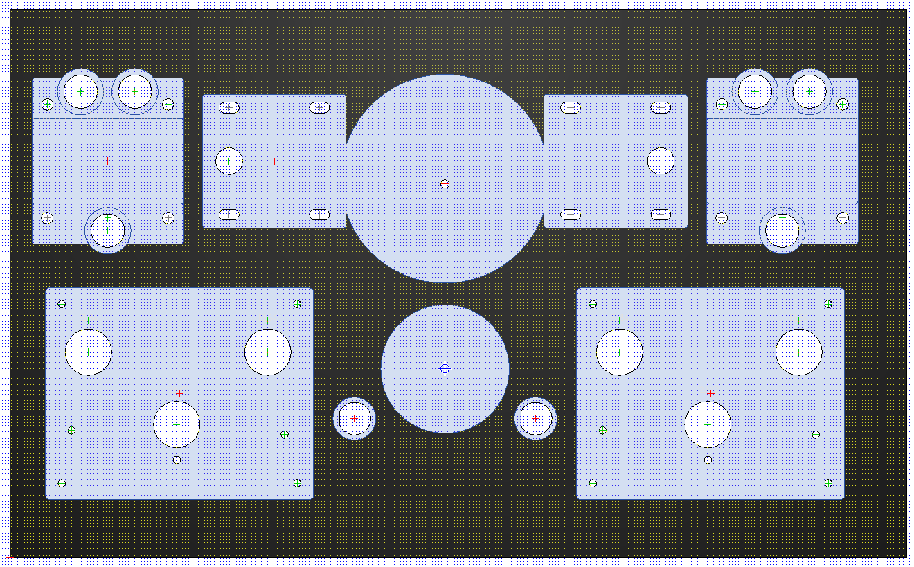

I really want to finish my BH EL84 build but am struggling to find a decent layout that I like.
The one attached is with an Antek toroidal PT with 2x250V and 2x6.3V. In this layout each board would get its own 250V and 6.3V supply.
The small transformer is a 2x30VAC wired in series for bias supply... but I think 60VAC is a bit high here (posted about this a bit earlier).
Also, if that single transformer is used for both boards, isn't it problematic to use a single transformer for 2 different rectifier circuits (each board has its own voltage doubler for the bias)? It seems like a 2x48V transformer would be better (one tap for each board).. but can't really find anything suitable.
The top transformers are a OPT and Hammond 193 enclosed chokes.
I thought about converting to monoblocks but it seems way overkill.
I'm looking for ways to simplify this. One option is to the PSU (bridge + 2 caps) of a single board, with an HV regulator and connect the regulator in parallel to both boards. This would allow me to get rid of both the chokes and only require a single HT tap. I could use something like the Edcor XPWR262-120 (250V@300mA, 6.3VCT@6A). I would still require a bias transformer though.

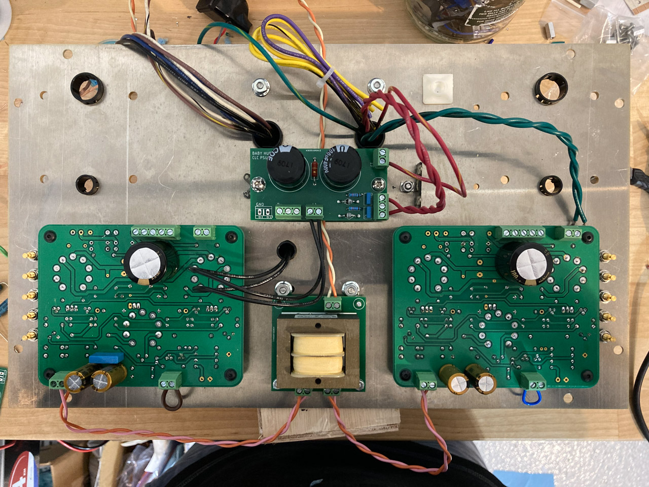

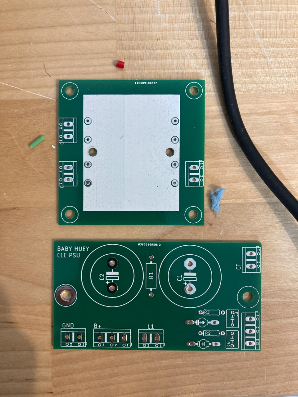

Thanks for the information. I finally had some time to work on this and went with a similar approach.
I used a Hammond 370HX (550VCT) which I already had on the shelf. I used a small PCB for a CLC PSU that mounts directly underneath it. The board uses 2 diodes in a FWCT configuration with R-C snubbers.
That B+ voltages is wired to the PSU resistor on the PCB's for another RC stage on each board. (not pictured)
The choke I used is a Hammond 193H, 5H with 65 ohms resistance. With the high mains voltage in my home (~124VAC), I needed a 300R resistor on each board.
Since the Hammond has a 5VAC winding, I may consider using a tube rectifier to drop some voltage that way.
For the bias, I wasn't entirely happy with the dual 30VAC toroids. While they may be sufficient for bias, I wasn't sure if that provides sufficient voltage for the drivers (which need 50V+ to my understanding).
Anyhow, I found this small 12VA transformer with dual 50VAC windings. It is PCB mounted so I made a small PCB for it.
I have more PCB's if anyone wants to take this route too.

Looks good. There are a lot of modules to put in place to get one of these BH amps up and running. FYI you do not need +50 for the driver voltage. +20 will be enough. We do not need or want to drive the power tube grids positive so the mosfet only needs about +10v to stay linear with a 0 volt output. I think my BH el34 ended up at +22. You do need at least 2.5 x your -bias voltage setting on the negative side to make sure the power tubes will be driven all the way to cutoff. So, if you are running -30v bias on el34s you want at least -75v. For an EL84 version you are typically running -10 or so on the grid, so at least -30v should do the job.
Thanks for the info.
With the dual 30VAC toroid I had max -18V on the EL84 grid, and 25V on the driver.
Now there is up to -40V on the EL84 grid, and +55V on the driver, so seems better.
I like using the PCB as it opens up the possibility to use transformers with a center-tapped HT.
Still contemplating a tube rectifier to drop some of that voltage down.

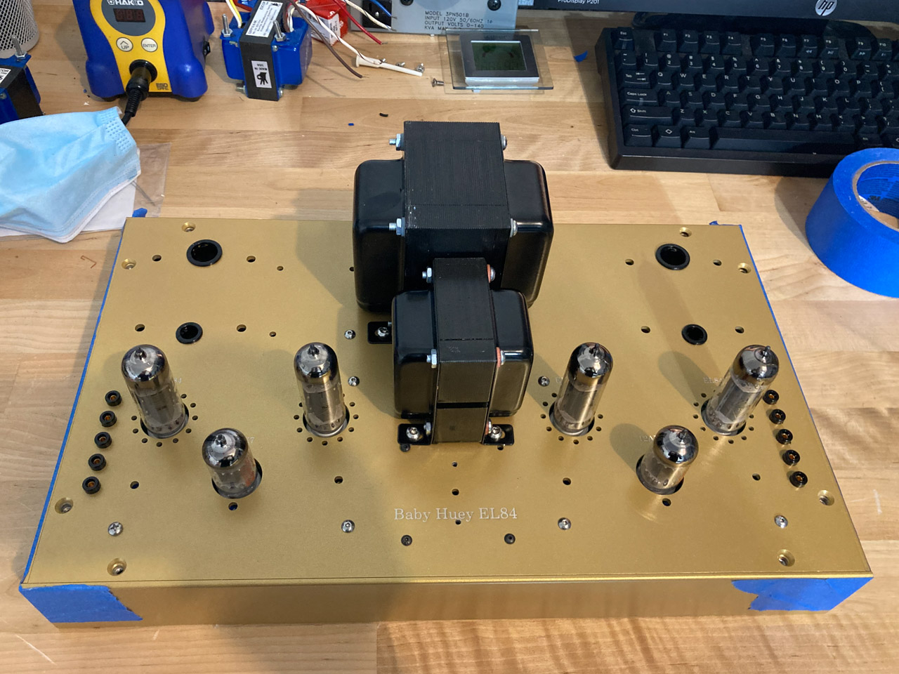

The choke I used is a Hammond 193H ...
I was under the impression it was a good idea to try and orientate the choke in a different plane to the power transformer to minimise coupling, and ideally the OPTs too. I presume it has worked OK for you to have them aligned?
Thanks dB.
OldHector, yes, generally you are right.
The OPTs will be at a right angle to the PT.
The choke then can either be in the same plane as the OPT or the PT... I chose PT.
I haven't tested it entirely yet, just initially voltages. I'll report back if any issues, worst case I can rotate it.

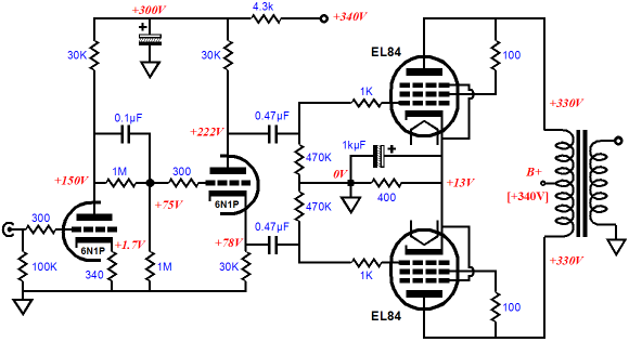

I know you posted this last year - but were you comparing this to the schematic from Tubecad attached here? Do you still think the BH was better than the Broskie design? I have to redo mine, and I always thought it sounded great.... but of course if there is something else out there better then I'm all ears!!Yes. There is some temporary board that I'm using since I'm planning a 21st century Maida regulator. So disregard that.
