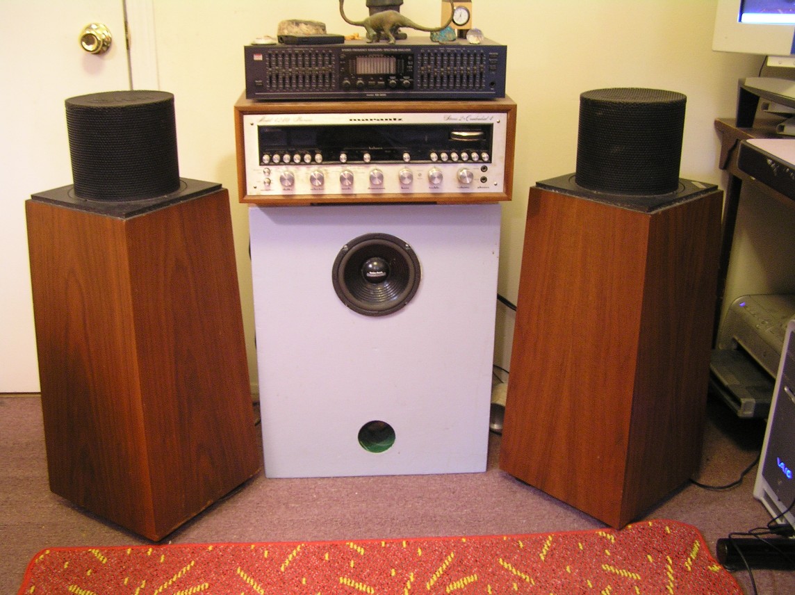

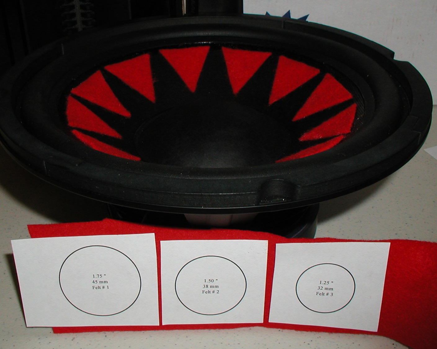

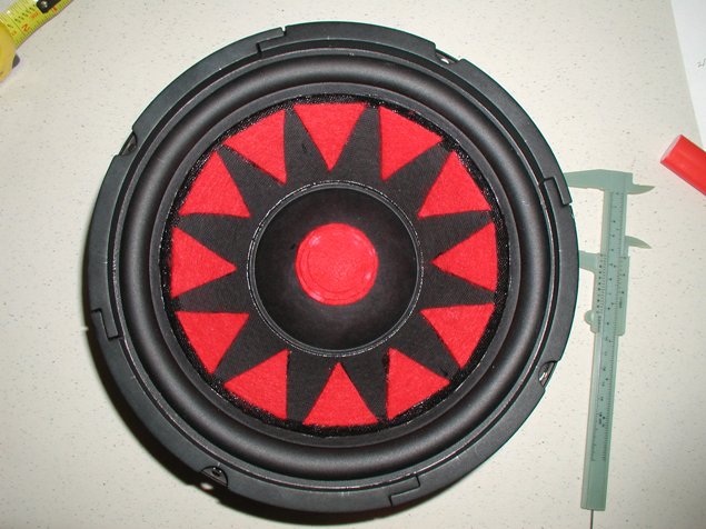

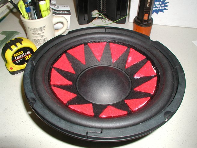

Here are some pic's of my 10 inch Pioneers with Dr. Mamboni's felt triangle treatment.

Thanks for the pictures, I had read about the magic triangles, but didn't understand what they were until I saw the photos you took.

The shorter enclosures worked - just not as well as the taller ones. I'm sure that this had more to do with volume rather than height. If I remember the volume was should be 25L - but go back to the start of the thread to be sure. The speakers with more volume had an fuller and smoother sound to them compared to the smaller one's. It would be difficult to spot unless you could compare the two side by side tho.
The tweeter I used was an ESS AMT1 and properly used is a classic high end mid-tweet. Very clean - dipole design which ties into the "omni" design of these speakers well. I would suggest using a similar dipole tweeter and in this application I personally prefer the AMT (Air Motion Transformer) design. B&G makes the Neo-3 and Neo-8 without the back cups http://www.parts-express.com/pe/sho...713&vReviewShow=1&vReviewRand=4031788#reviews and they are full dipoles so I would consider using them. The ESS AMT's are available again over at Parts Express here in USA - but I'm unsure of availability outside of US. 😕 http://www.parts-express.com/pe/showdetl.cfm?Partnumber=264-600

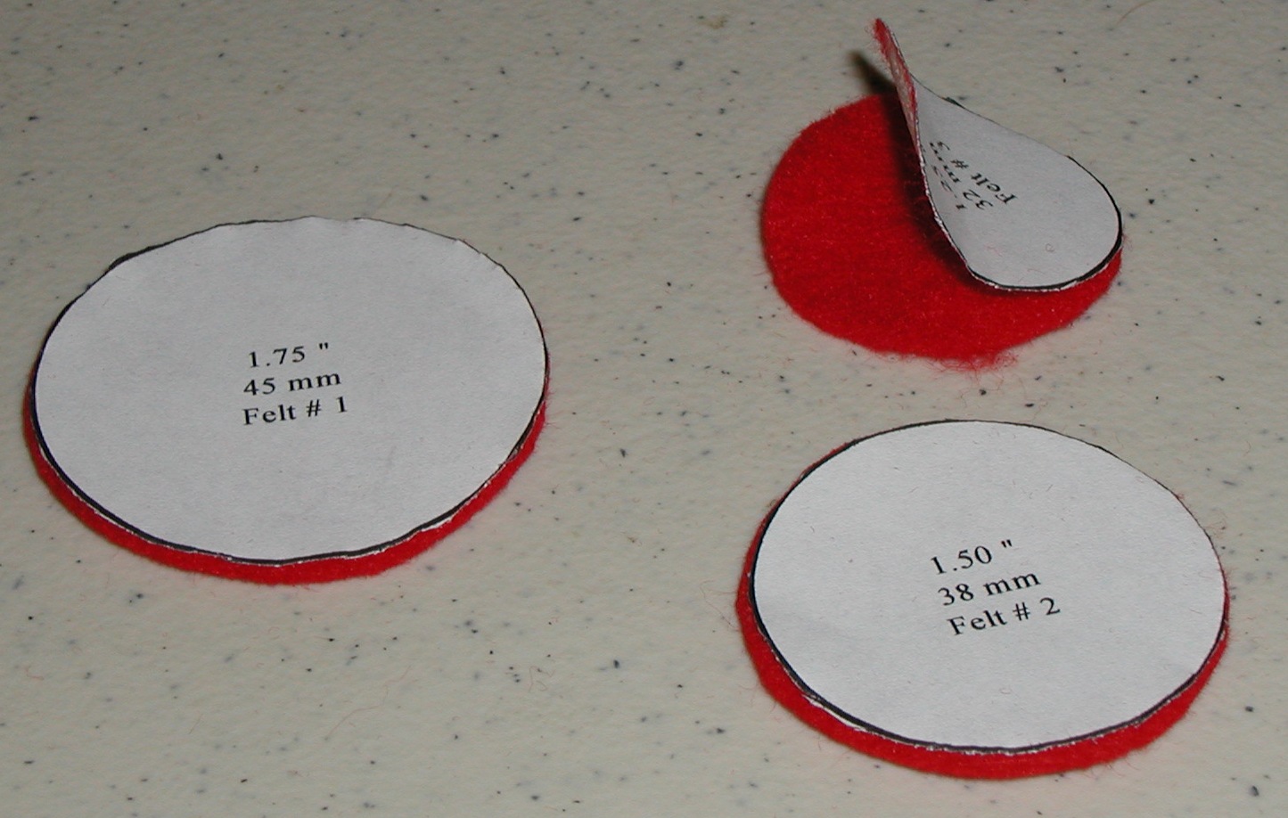

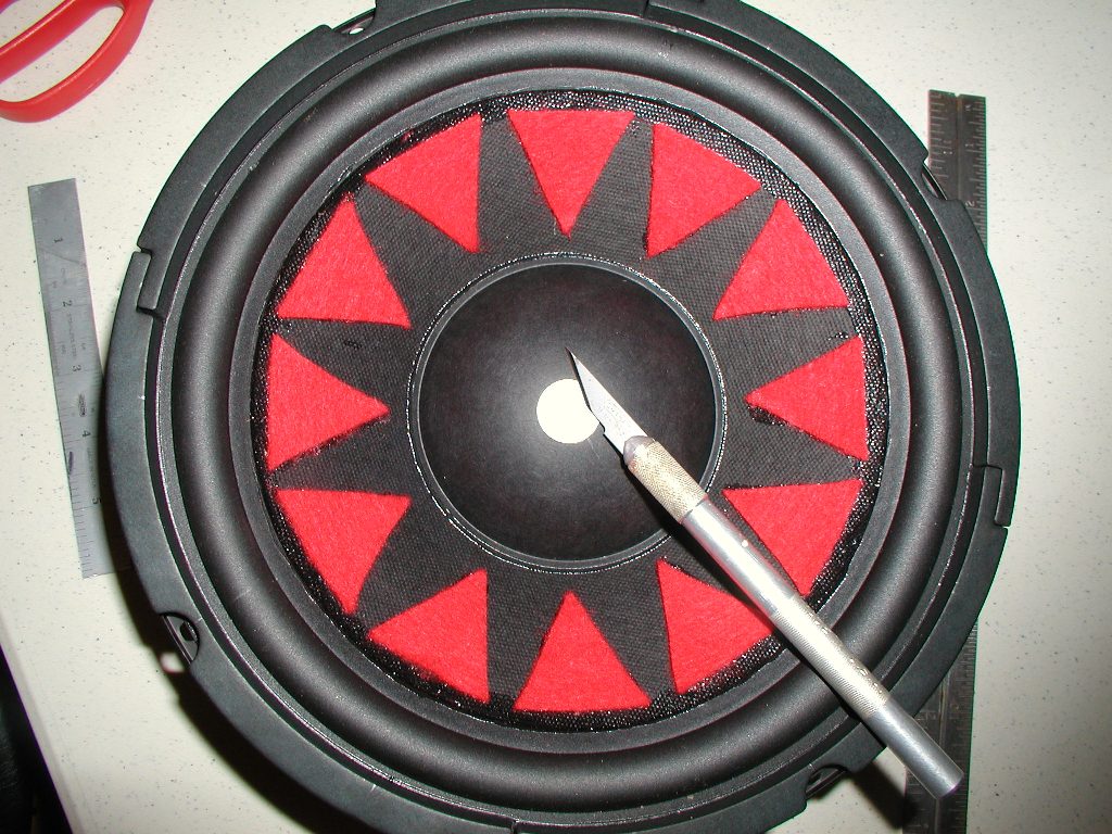

The felt cap is on this thread - see post #33
Yes! Post 33. I assume you cut the hole with an x-acto blade. While I haven't found dimensions for the triangles, I assume I could just estimate from the way they lie in your speakers. Perhaps not real critical. I read the felt is just standard stuff.
