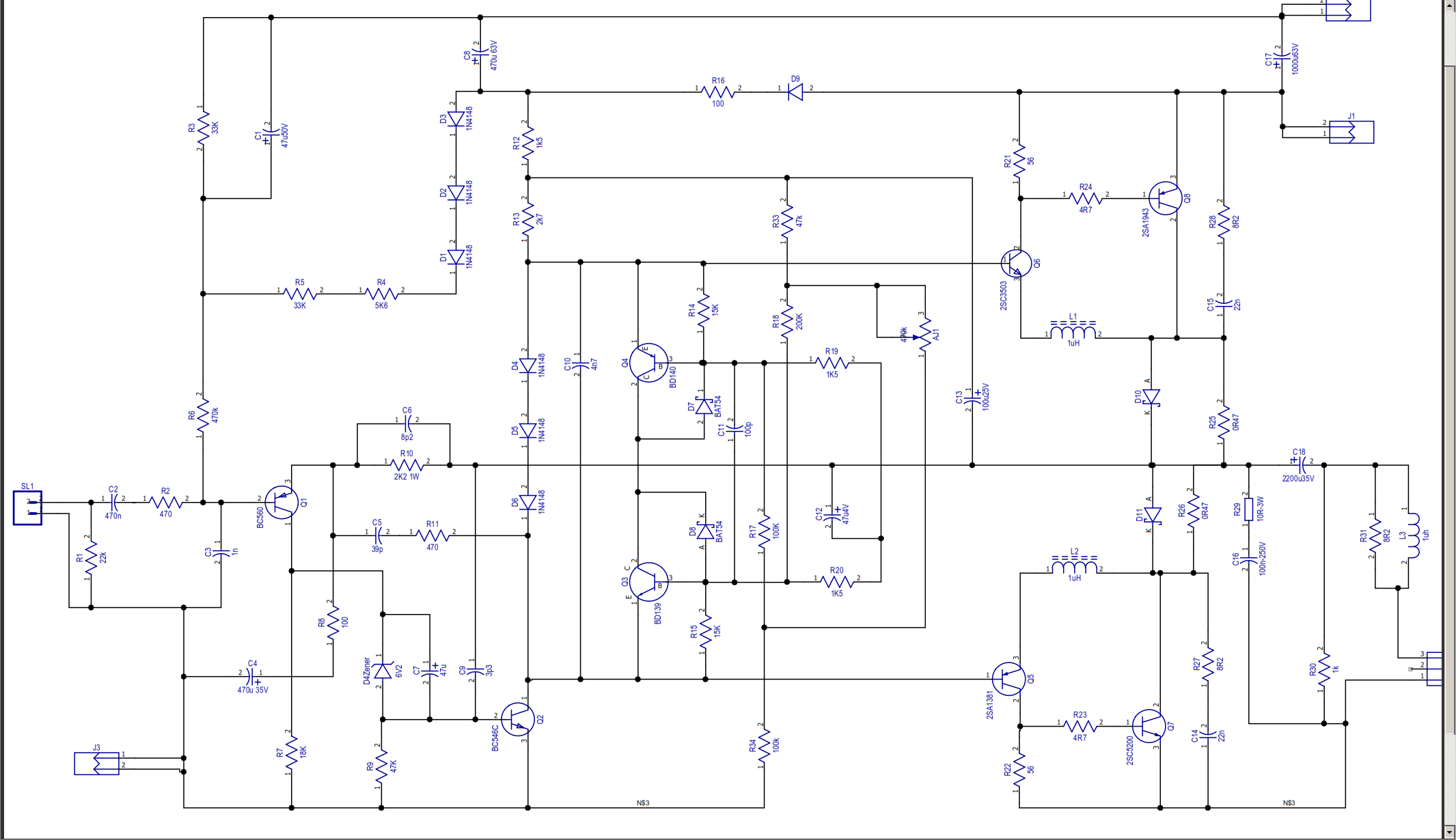

Dear LV,
Made all modifications as suggested. Kept all options available in the scheme. If any thing is to be included further, please suggest.

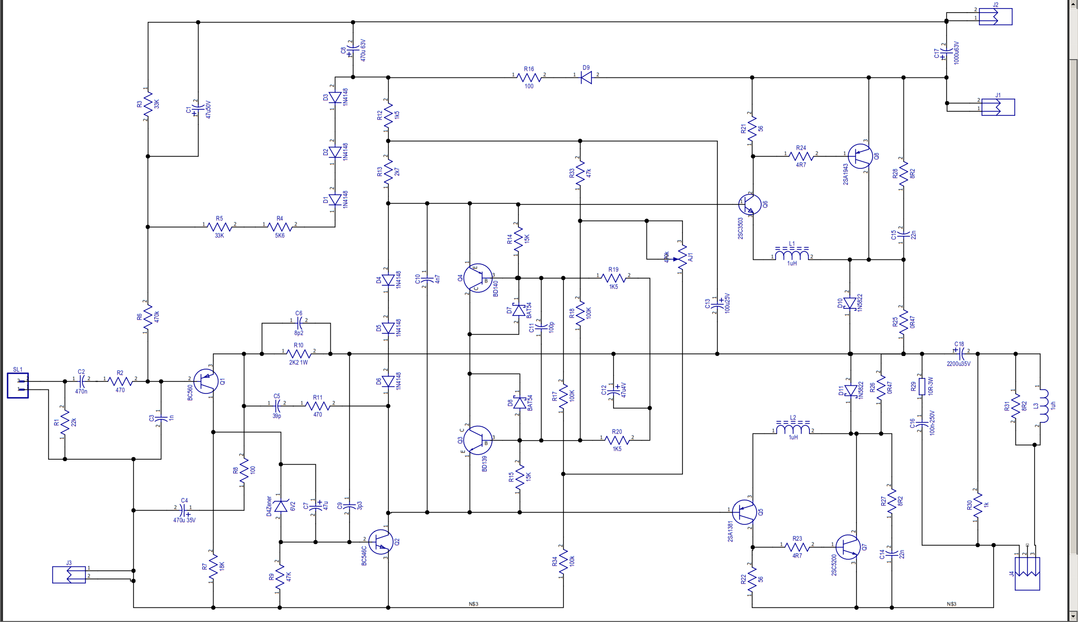

Dear LV,

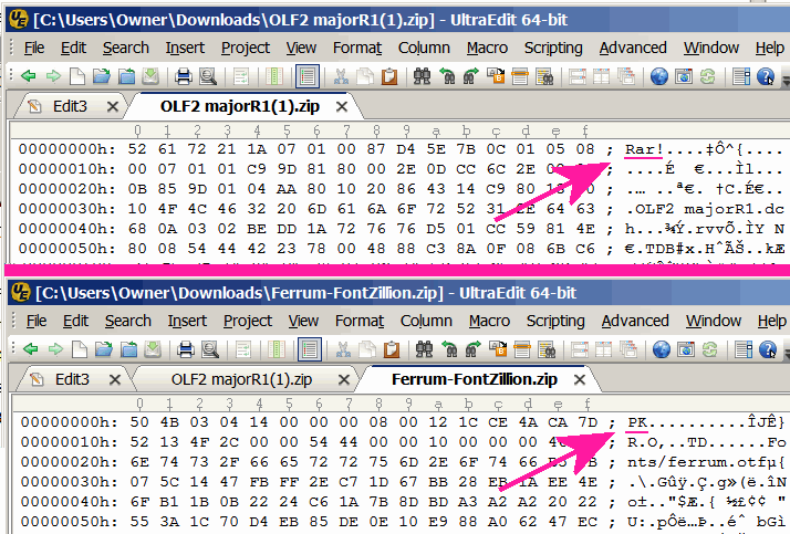

Why didn´t you say so when you posted it?It is a .rar file. DIY does not accept rar files. I changed the extension to zip. Please change it back to rar and it should open.
WinZip got crazy trying to open it.
R29 and C16's primary role would be as a Zobel, not a RF trap: their purpose is to keep the output terminated by a low impedance at high frequencies, to prevent the loop gain of the amplifier from wandering into hazardous regions.R29 & C16 are an external RF trap. Also should be included and not shown, 11 turns fat wire around a 1 cm coil form between speaker jack and amp output, parallel a 10 ohm 3 watt resistor.
As a side effect, it will also attenuate and dissipate some of the HF ingress, but that is not the reason why it is included in 99% of the amplifiers.
(If you need it, I can show you an example of a real RF filter)
Here, this network is split between C15/R28 and C14/R27: together they form the equivalent of a 44nF/4.1ohm Zobel network, but they also stabilize the CFP OPs.
An inductive Zobel can be useful, for capacitive loads (relatively rare) or relatively long cables behaving capacitively at some frequencies.
R18 still needs to be changed to 100K. If any thing is to be included further, please suggest.
I took it as given you had managed the high freq loop gain of the base circuit already. When dynaco post ST120 shipment suggested 1000 ohms series .047 uf on the back of the speaker jack OUTSIDE the 11 turn inductor , it pretty obviously had something to do with the outside world. Like more portable FM transmitters in 1970 than in 1966. And warrenty calls. Other thousands of "zobels" may have to do with internal stability as you say.R29 and C16's primary role would be as a Zobel, not a RF trap: their purpose is to keep the output terminated by a low impedance at high frequencies, to prevent the loop gain of the amplifier from wandering into hazardous regions.

Why didn´t you say so when you posted it?WinZip got crazy trying to open it.
That's just dumb of WinZip.
I wrote a whole explanation of how easy it could know/suspect it wasn't a ZIP, but my computer ate it.
File format - Wikipedia

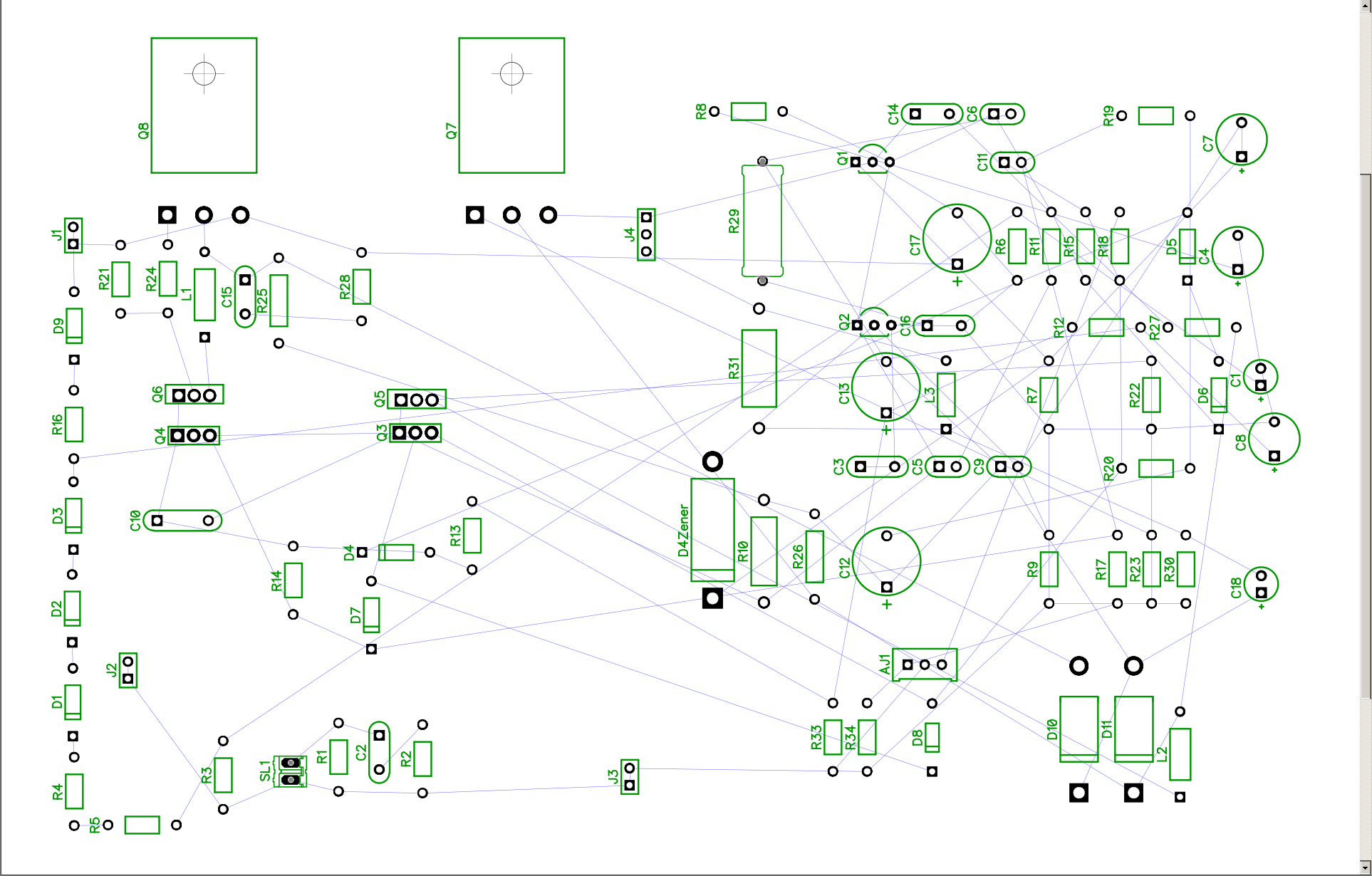

This is the final PCB shape I would prefer depending on the Heat-sinks I have.
The height not more than 3.8 inches to fit in 4in height heatsinks and box. Distance between power BJT mounting holes to be 4 in . The actual pcb width can be more or less as suits the design, but not more than 8 inches. Thanks for any help.

Difficult to tell without seeing the finished result, but it doesn't look promising.Dear Elvee,
I started in my own way to start the lay out in Diptrace. the resultant pic is as below.
The Eagle file is only the schematic.
--gannaji.
It looks like the raw output of an autoplacer
It could be more promising, but more is needed to be able to judgeThis is the final PCB shape I would prefer depending on the Heat-sinks I have.
