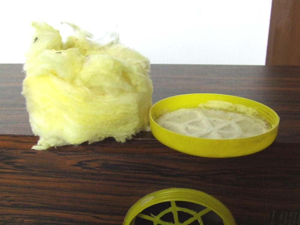

yes,I added diy variovent (dimensions exactly as in original Dynaudio's),and-yes-to secondary (upper ) chamber

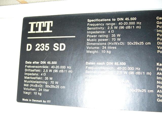

Hi all,
I just purchased a pair of black ITT D 235 SD 's.
They sound great, as expected, but high tones seem to go not as high as the tweeters of my B&W560 ? Seems like these gradually fall off above 10 Khz (could it be the 36uF elco in the series filter design?)
All in all I wonder if these have the vario-vent already built in. When I read this thread I get confused about the DIY variovent...is it there or not or has this speaker just two chambers with a vent? When I knock on the side of the speaker I notice that the sound changes a little below the middle as if there is a construction inside at that height.
I tried to get the front off, but it seems like its not really ment to be dismantled. Can I try brute force here without total destruction ?
Any advice/experience would be helpfull.

anyway - yellow variovents you can see in few first posts of thread aren't original ....... I made them (according to original Dynaudio Variovent dimensions ) , and mount them on back side ..... in upper half of enclosure ;
yes - box have two chambers ; with sort of felt as barriere between them ;
look at pictures again;
it will be helpful if you post some pictures , even if I expect that both drivers are sealed to box with some rubber-like glue ;
you can pry them off only if you cut that glue around perimeter of driver ( carefully with knife) and then try to pry them out , working slowly around with two wide screwdrivers ; you'll certainly damage somewhat plate around drivers , but thats price
look at xover - compare it with my schematic , so we can discuss it later

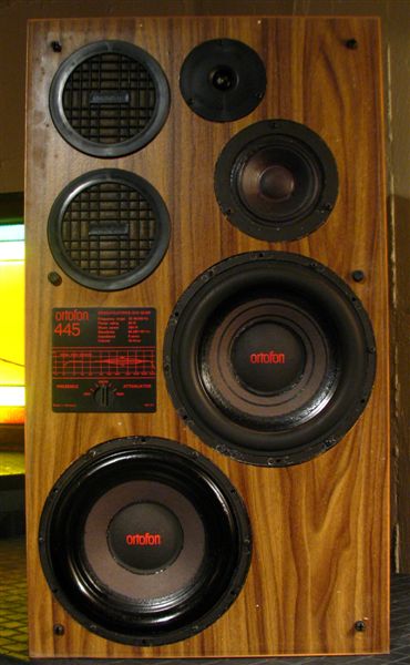

Ortofon 445
Last week I picked up a pair of nice sounding Ortofon 445 (from 1975). It turns out that the crossover and all of the drivers are Scan Speak. The wire, stuffing, and other details look identical to those in Zen Mod's ITT boxes. Seems like ITT and Ortofon were just badges applied to systems designed and built by Scan Speak. Here's a little more info I found on the web--

Here's a photo of my 445. I'll post some more photos later
