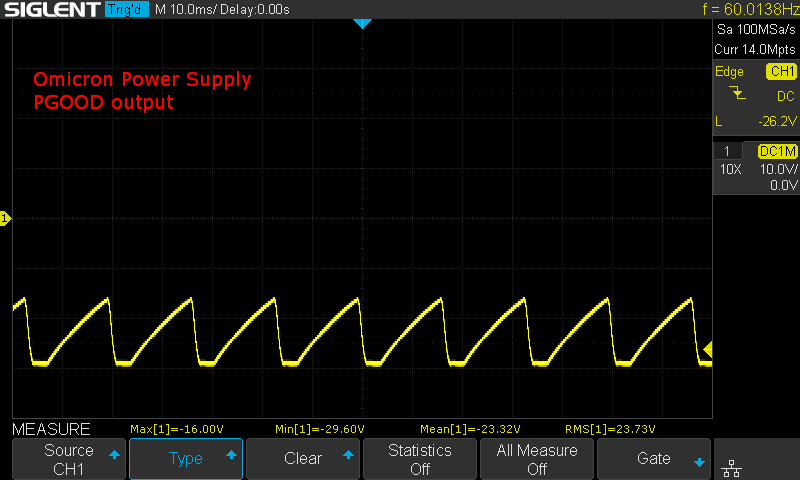

Then, let's see what is wrong with PGOOD. Since PGOOD uses a separate rectifier with a small filter capacitor, it has a large ripple:
The amplitude of the ripple depends on the filter capacitor, C14 (here, 10μF), and the forgotten resistor (here, 2.2 kOhm) that discharges C14 when the AC power disappears. If the ripple becomes too large, Q53 will be opening on the positive peaks and discharge C53. You can see on the picture that in my case, 2.2kOhm is just high enough. The easiest way to check the ripple is with an oscilloscope if you have it. If you don't, just try increasing the discharging resistor and see if it works any better.
![PGOOD.png PGOOD.png](https://www.diyaudio.com/community/data/attachments/1086/1086811-502ced91044a4905ea5e560ba30dfc4f.jpg)
Your suspicion in regards to shorting PGOOD input to ground was correct (this was performed without PGOOD connected to the PSU.)

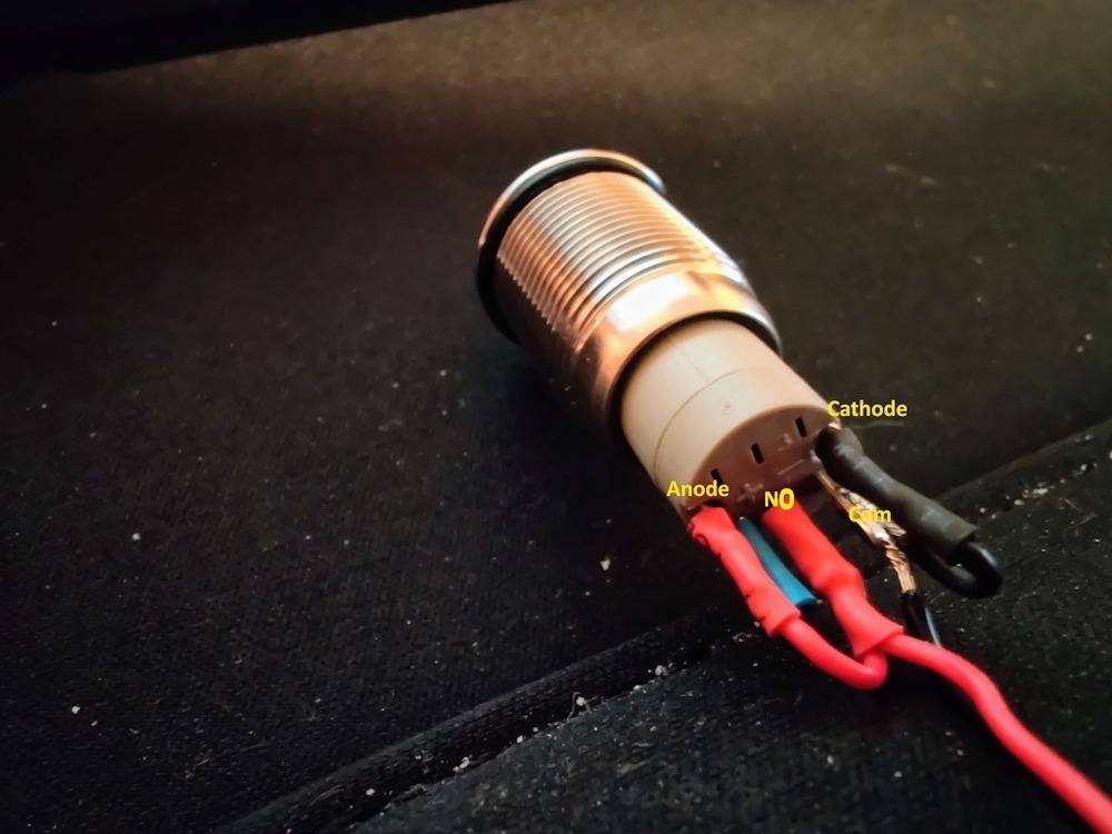

Wiring an LED to indicate crossfeed status is easy. Simply wire the LED in series with the switch. On the two-way "XFEED_SW" header on the Omicron board, connect the anode of the LED+switch combo to the pin closest to the relay, and the cathode to the other pin. When the switch is closed, both crossfeed and the switch LED will be on. The way it works is similar to how the on-board LED is wired in series with the (other) relay.
It's me again. I wired up my switch per your post, pic attached. The switch activates the xfeed relay immediately, and turns on the LED. Turning the switch off turns the LED off but the xfeed relay remains activated. I desoldered the LED cathode from the switch com pin, and now the switch behaves as expected, but the LED does not.
It seems like the LED is activating the xfeed switch by being connected to both pins. Is the easy answer to just connect the LED cathode to Gnd (0 vdc) on the PSU?
The photo seems to show the LED connected in parallel to the switch - did I get that right? - not in series as I suggested. A parallel connection would explain the relay remaining on which the switch on (i.e. shorting the LED) or off (leaving the LED in circuit, in which case the LED would be on).
Boy I feel ashamed, sometimes I can be dense. I get it and understand where I went wrong. It's been a long day. I got hooked on the idea of anode/cathode and pins, and wasn't even thinking about series vs parallel lol. Switch is functioning as desired now.
On a slightly related note, despite having a labeled anode and cathode, the LED on my switch functions bi-directionally on my DMM, certainly added to my confusion trying to come up with a solution earlier.

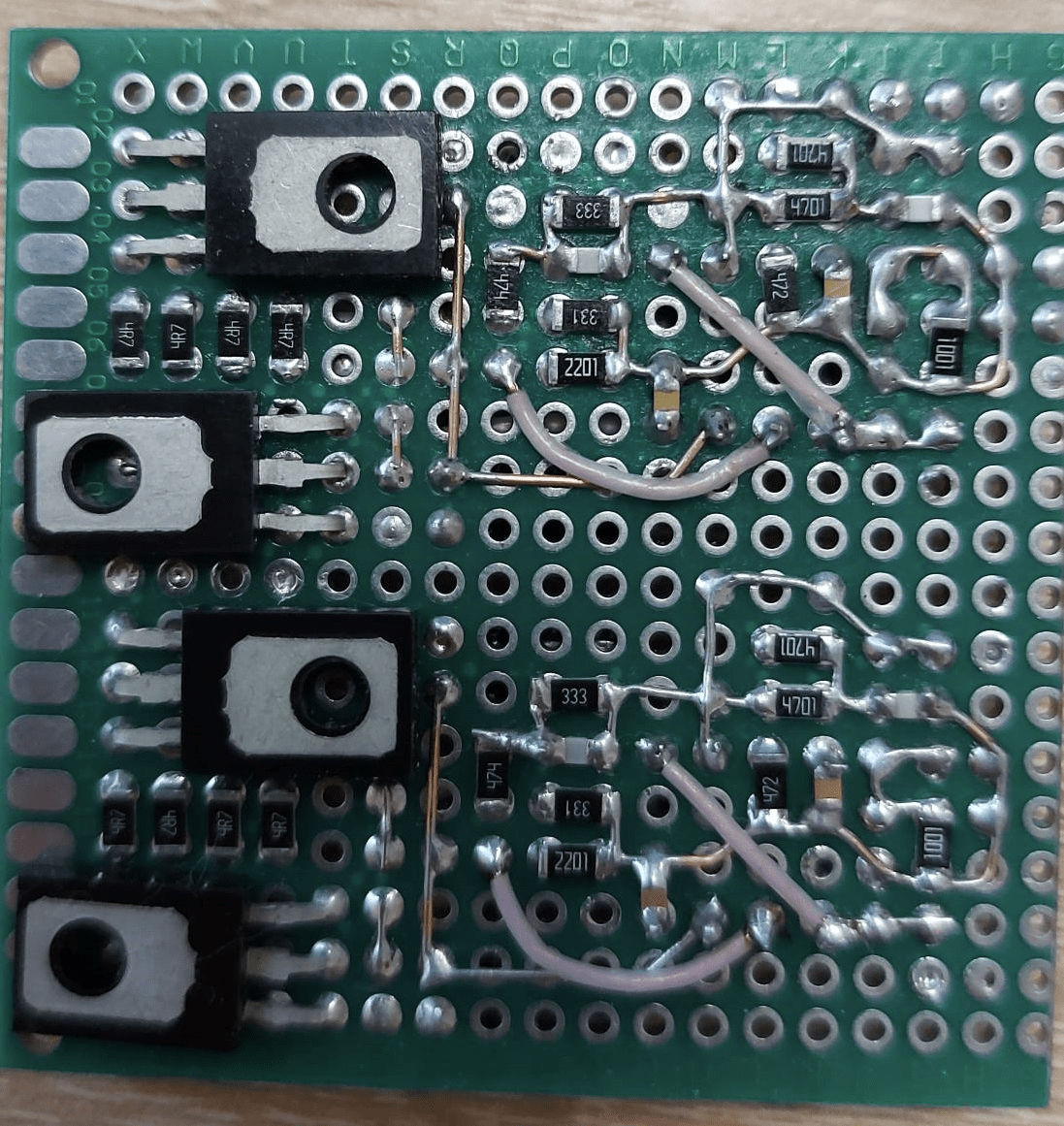

Meanwhile, another Omicron is live:
Quote from the builder:
![1685547751269.png 1685547751269.png](https://www.diyaudio.com/community/data/attachments/1087/1087230-7fa70db6f560551331d3b9887028ade8.jpg)
![1685547764916.png 1685547764916.png](https://www.diyaudio.com/community/data/attachments/1087/1087231-f6ba678aa8766b63172d46472639b0f8.jpg)
Built an Omicron on a breadboard. Plugged it into my DAC instead of my AD8397 based headamp. Could not measure the distortion - the measurements from the DAC output and from the Omicron's output are identical (0.00033%, measured by Cosmos ADC). Worked right after assembly, no debugging or adjustment was required. Sounds easy and relaxed, with precise bass. Will compare Omicron with my composite (NE5532+LT1210) headamp, but even now it is clear that the sound is good.

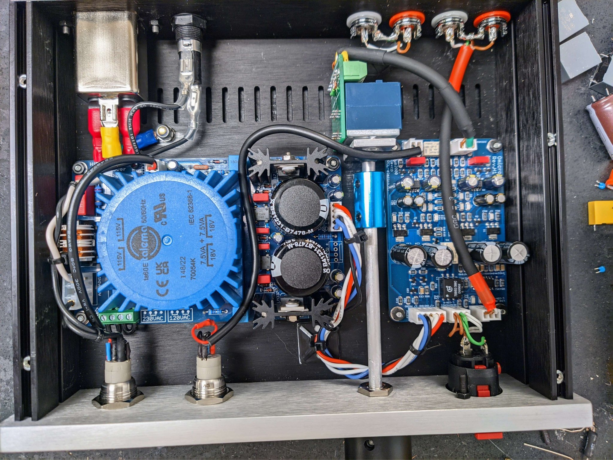

We are up and running! I haven't plugged in headphones yet, just listening to it as a preamp right now, and it sounds fantastic! I will give a more thought out review later on, but my initial impressions are that this is absurdly clean, the bass hits harder than my Krell KSA5 clone w/ alex's mods, all around I am very impressed and pleased.
Protection circuit definitely functions, while adjusting volume a few min ago there were a couple of moments where the audio cut and protection had clicked on/off. Not sure what would have caused any sort of spike, as long as protection works right?

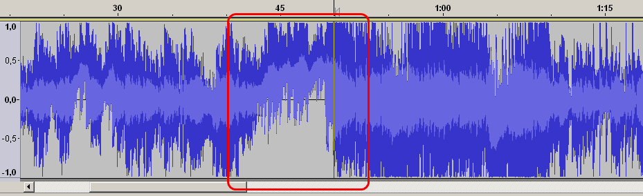

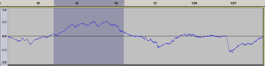

It seems to be a similar situation here. The track in question has a large infrasound component. In an audio editor, it is visible as the mean deviating from zero:

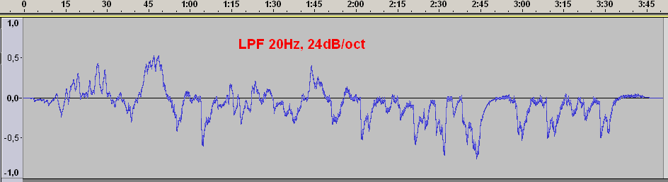

and even more obvious if you filter out everything audio (i.e. 20Hz and above):

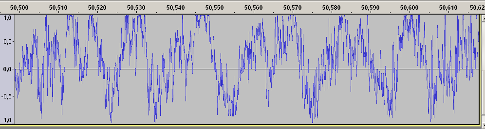

If you zoom in around 0:51 time code:
you see a large positive offset.
The offset is visible in real time at Omicron's output:
Naturally, Omicron's protection switched off the load - it does its job.
We see a few ways of dealing with this:
1. Do nothing and avoid this particular track (BTW in addition to what's discussed above, it clips a lot):
2. Adjust the window of allowable DC from +/-80mV to, say, +/-160mV by changing two resistors (R53 R54) from 100 ohm to 200 ohm.
3. Increase time constant of the protection's input LPF by increasing the values of C41-C44.
4. A combination of (2) and (3) above.
I'd suggest (2) as the easiest and least intrusive option. Note that any of (2), (3) or (4) would slow down the protection's triggering in case of a genuine fault.
![1685644584966.png 1685644584966.png](https://www.diyaudio.com/community/data/attachments/1087/1087551-92d1ba296a170f7dc8e8f1a18f53aedc.jpg)
![1685644634873.png 1685644634873.png](https://www.diyaudio.com/community/data/attachments/1087/1087552-4ada5bde77f496f35db30ac5759c50a0.jpg)
![1685644720840.png 1685644720840.png](https://www.diyaudio.com/community/data/attachments/1087/1087553-d876ac9216198b65c97ec955c0a439c0.jpg)
![1685644804437.png 1685644804437.png](https://www.diyaudio.com/community/data/attachments/1087/1087554-2750afbe8b6e299e8d93801ccbea9c10.jpg)
