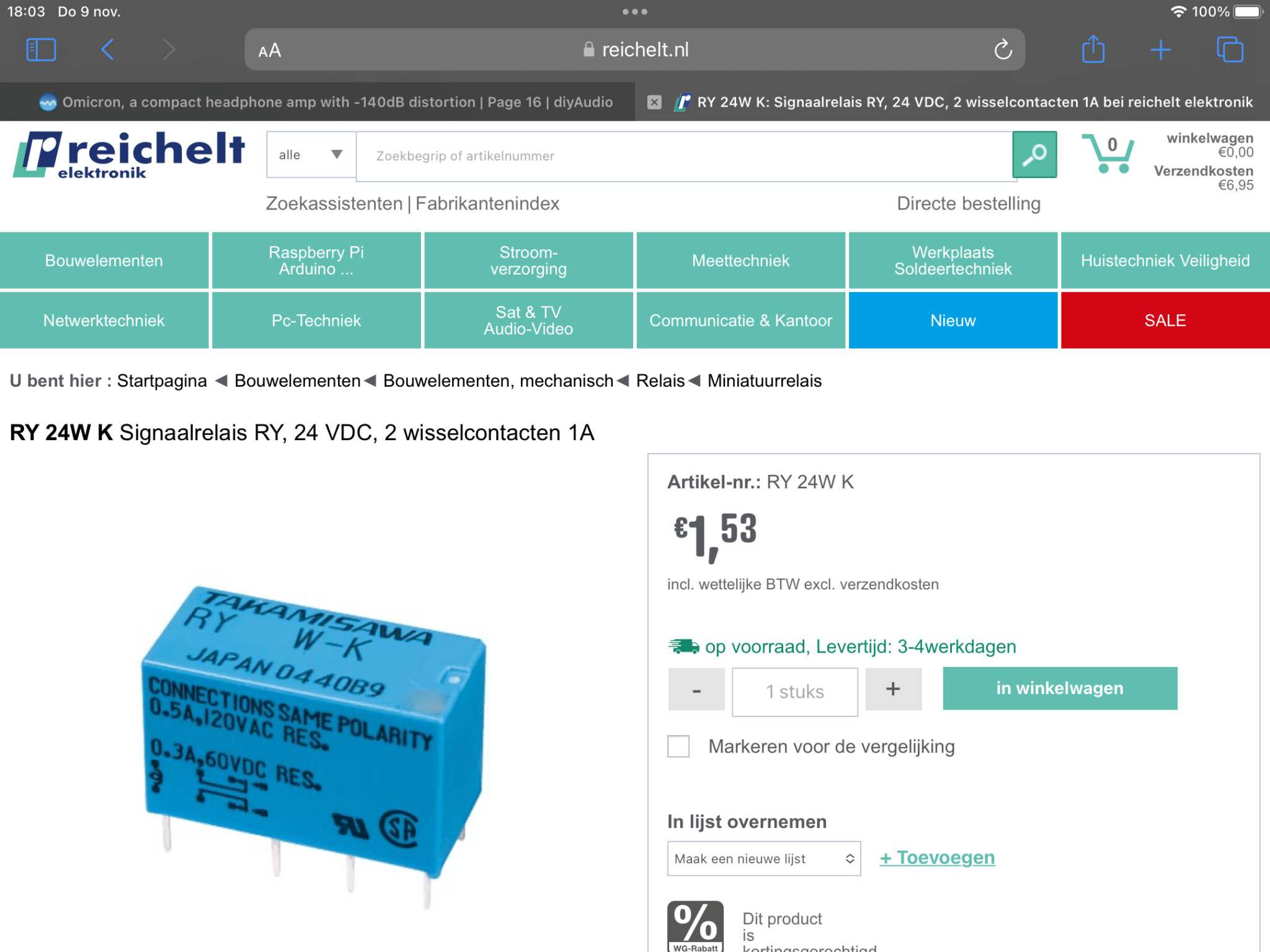

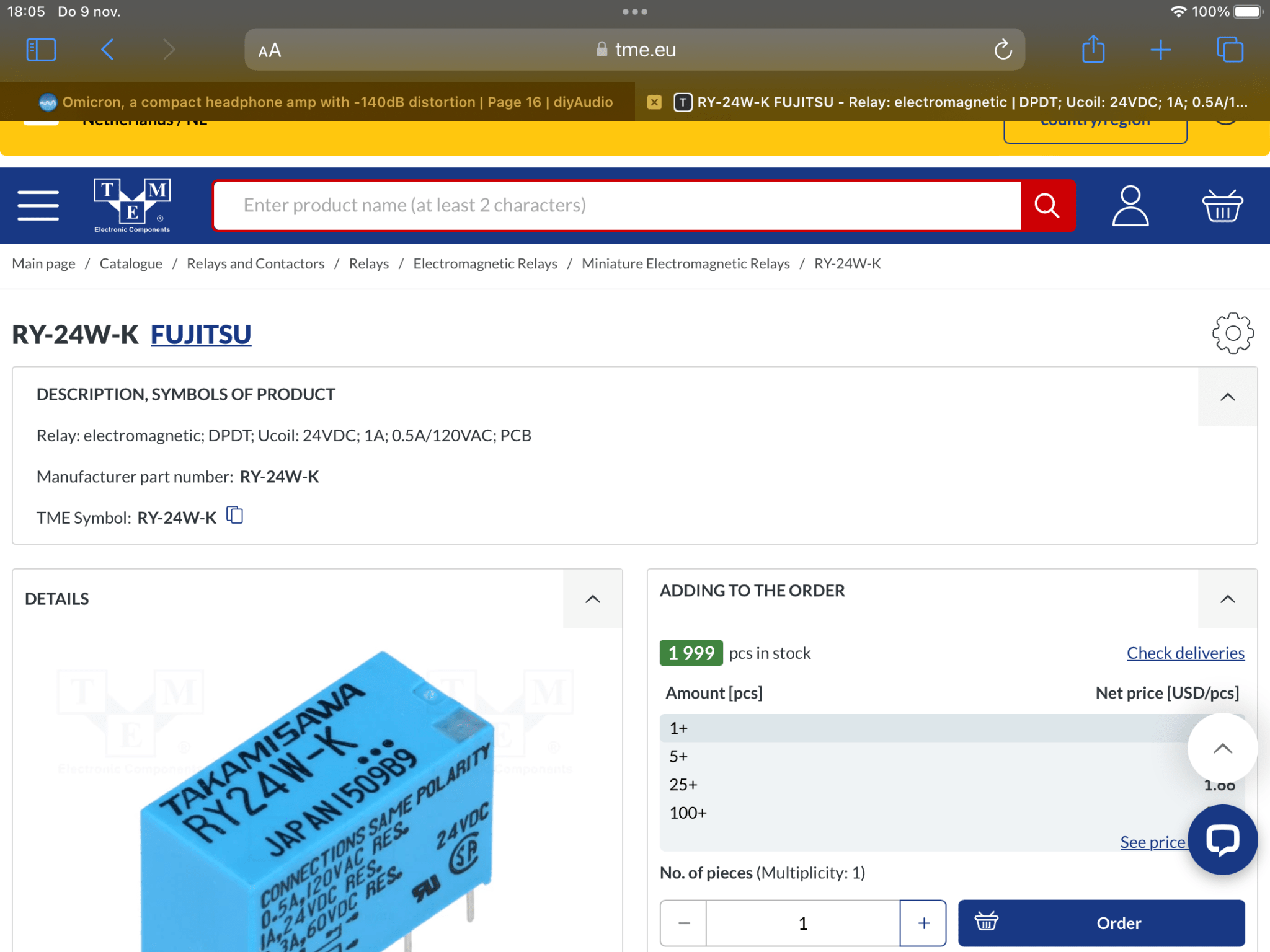

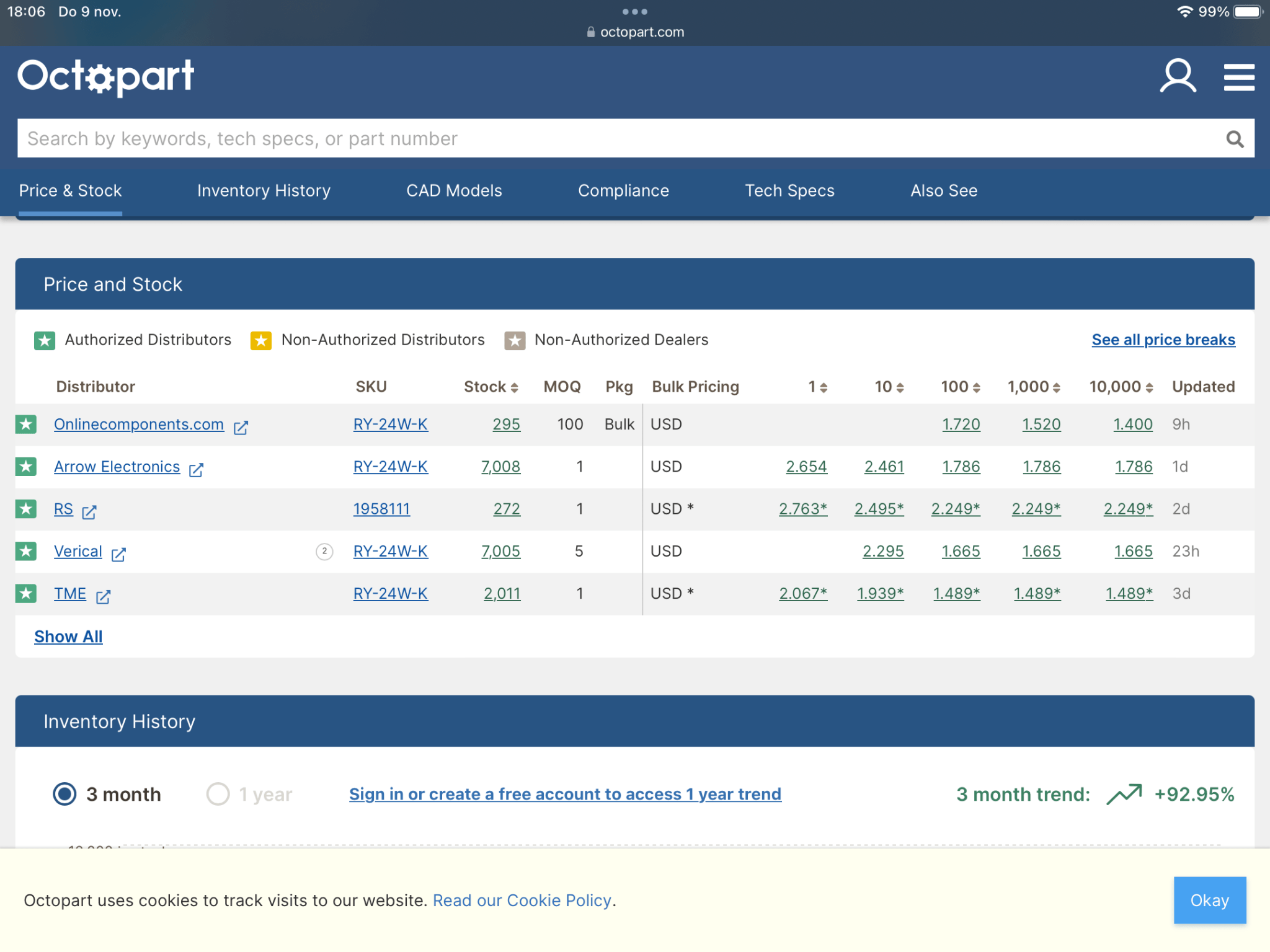

reliable source for K1, RY-24W-K
These are easy to substitute with e.g. Omron G5V or G6A, CUI SR10 or SR11, etc.

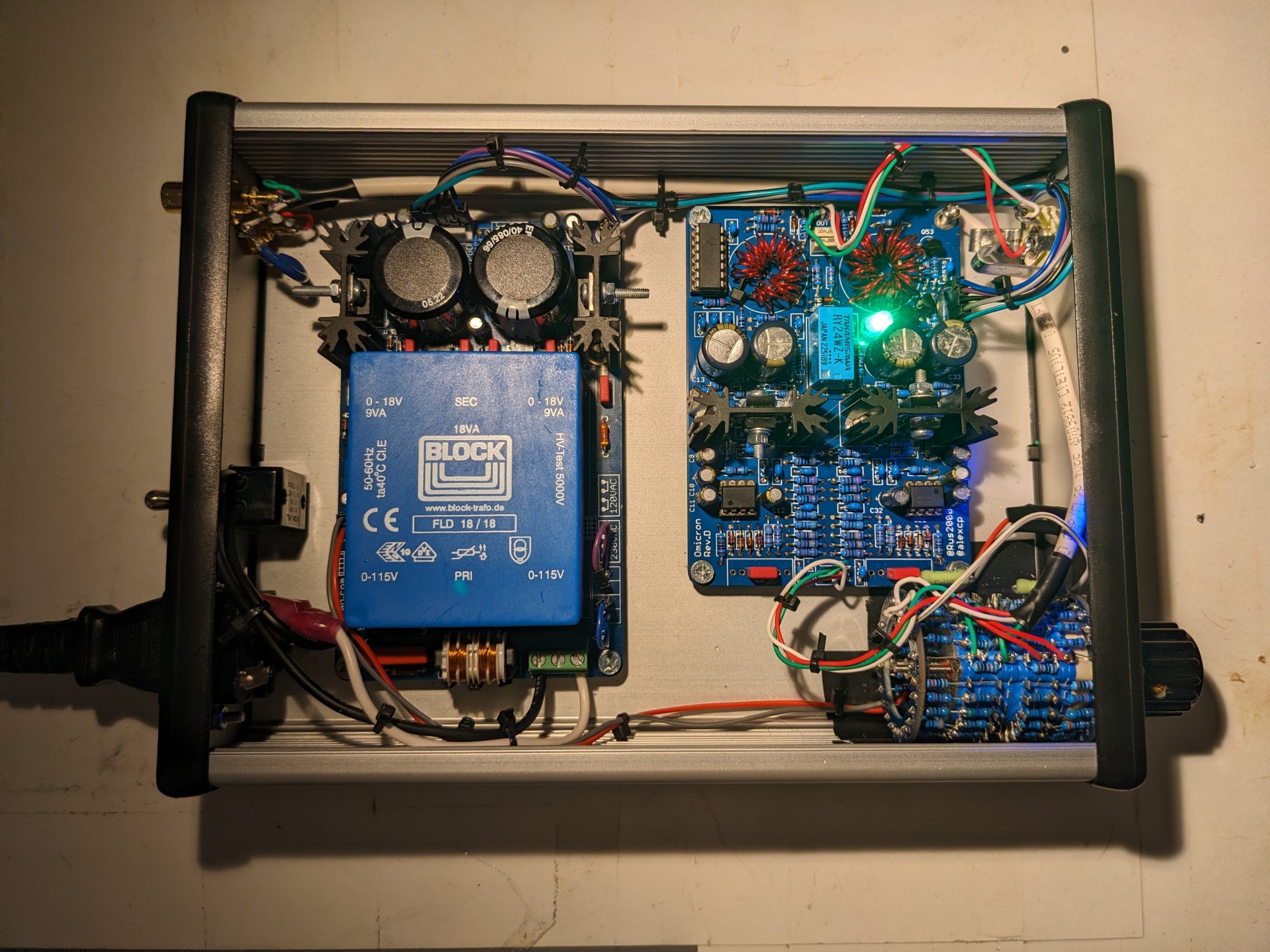

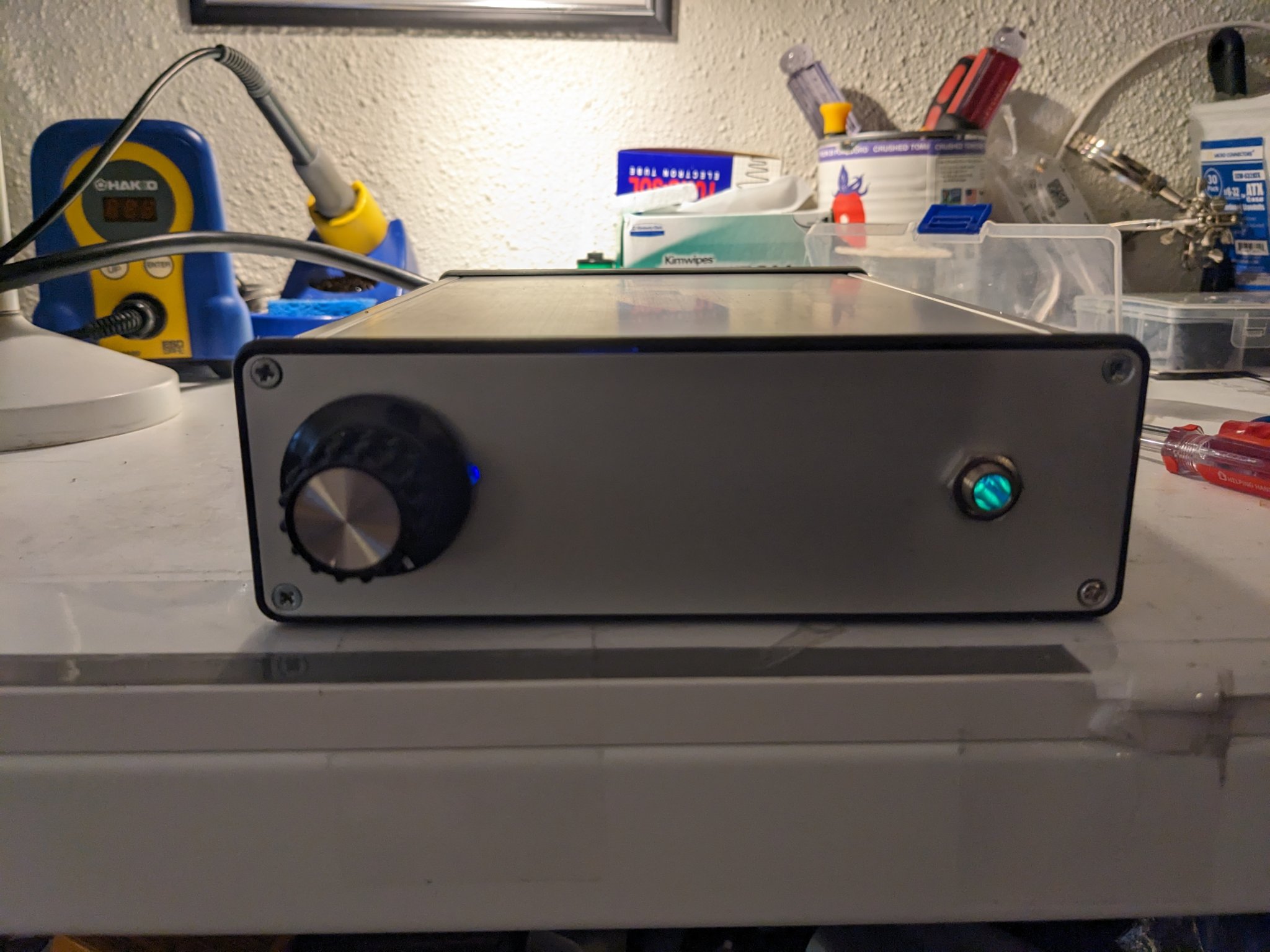

I finished up the project this morning, really sounds excellent. I haven't had enough time to comment on the sound quality yet but very transparent and I'm just using a 3.5mm to RCA from my phone.
A bit challenging for a beginner like me but I'm very happy with the result.
Reactions: 3 users
Really very happy with this headphone amp. I listened to it for about an hour with a pair of hifiman HE500's as well as my Beyerdynamic t1gen 2. Sounds fantastic. I only wish I was better at drilling haha.

Thanks Bill, I've built a couple amps before and I have a fair amount of experience soldering but I don't understand a lot of the more technical aspects. I'll look into a optical center punch.
I've been listening to this Omicron amp all afternoon and the sound really is fantastic. Absolutely no background noise and is completely silent without a source playing at full volume. It's a huge step up from the headphone amp I was using before, a bottlehead crack with the speedball upgrade.
The soundstage is really amazing with my hifiman cans and there's a wonderful amount of detail. Very liquid sounding and the amp just seems to do everything right. The amp runs very cold too, the case never even gets warm.

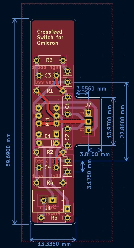

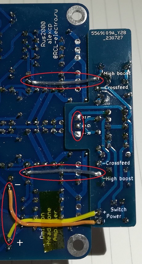

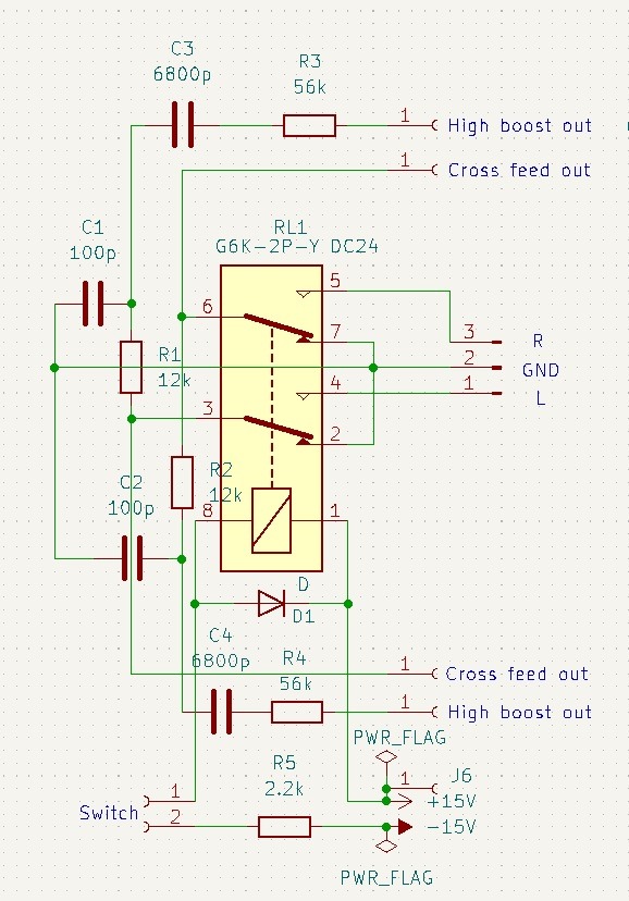

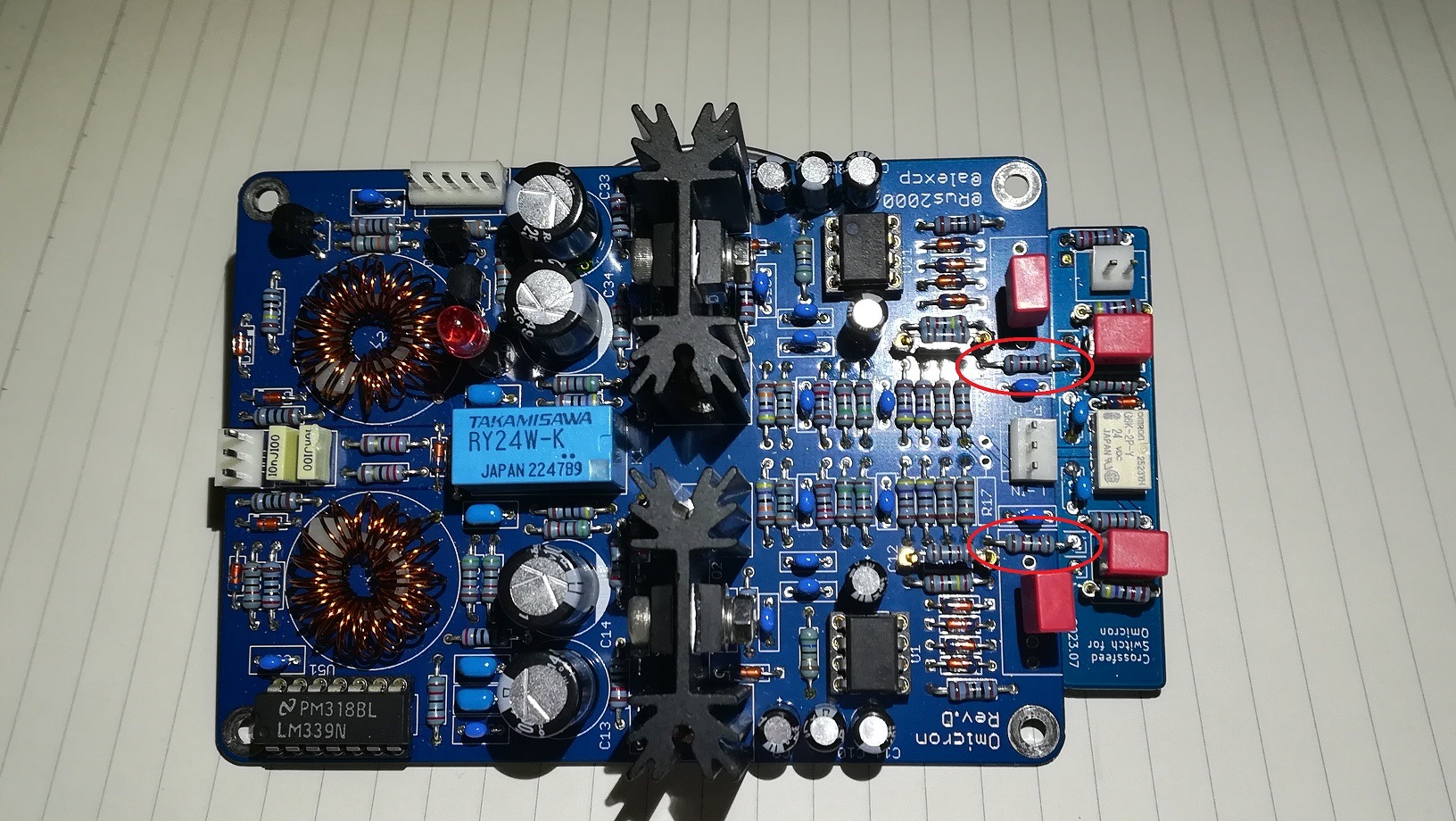

I made a crossfeed switch board for the through hole version Omicron!
This board includes a crossfeed switch and a high pass filter to boost treble a little.(experimental)
I'm not sure my board doesn't ruin the performance of the omicron but it's works fine for me.
I have attached the gerber file. If you are interested, Feel free to use it to order PCBs.
FYI, The red circles in the first and second pictures are where you need to connect to the mainboard.

Omicron Crossfeed 01.jpg Omicron Crossfeed 02.jpg Omicron Crossfeed 04.jpg Omicron Crossfeed 03.jpg
