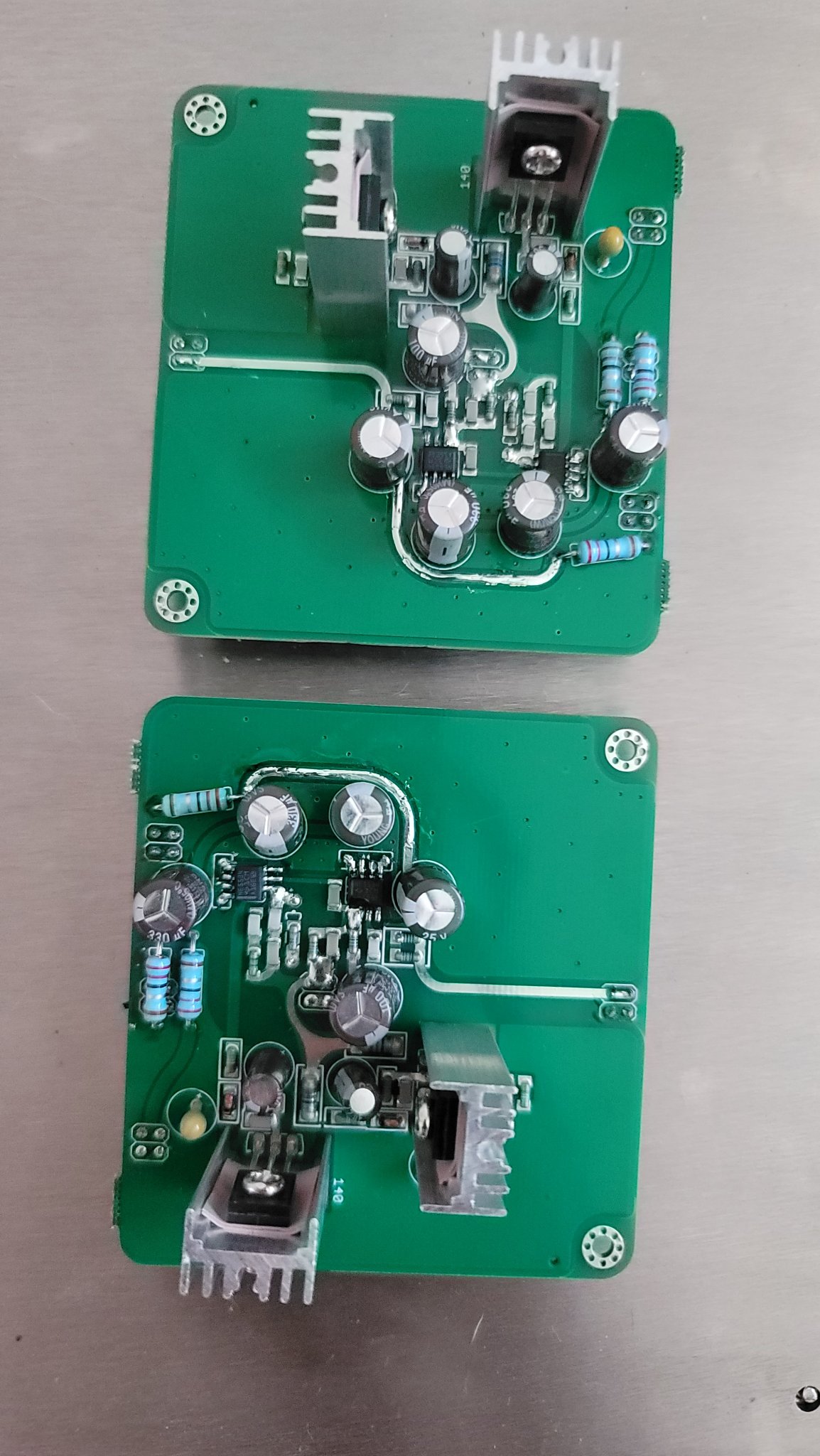

Ah yeah, I forgot to swap them around, was working in a rushBefore the quality of the PCB pattern, it seems that the inverting input and non-inverting input of OP-AMP are reversed in both the circuit diagram and the board.

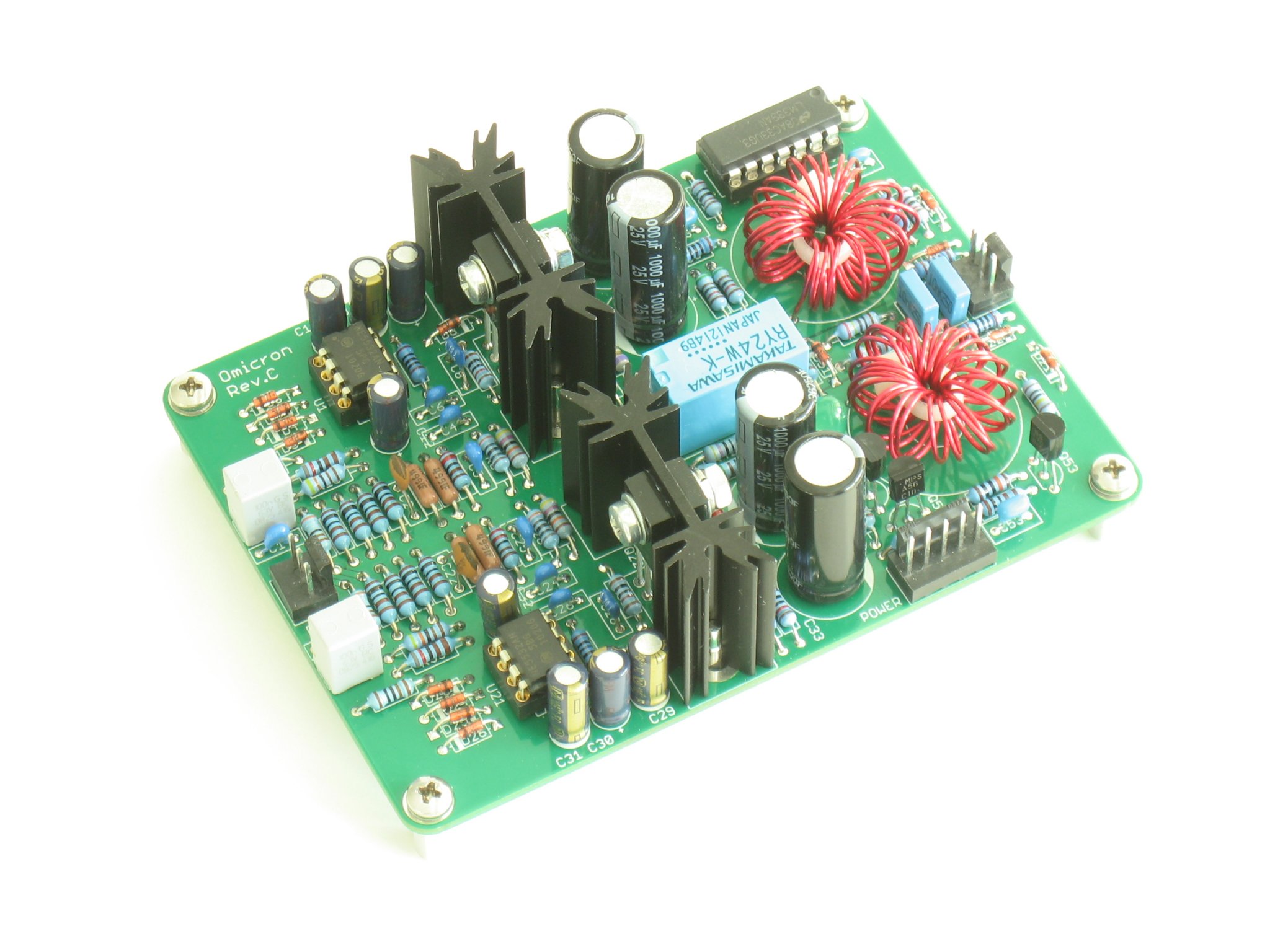

Will there be gerbers available for it ?Omicron construction, as mentioned before, is a single, all-through-hole, 78x108mm PCB that holds two amplification channels plus output filters and protection.

Using one board for two channels simplifies proper grounding, which is essential - and I cannot stress this enough - for the distortion performance of any amplifier with single-ended input. It also makes it easy to use a single power supply for both channels; I believe using one power transformer per channel of even a high-performance headphone amplifier is unnecessary (and costly).

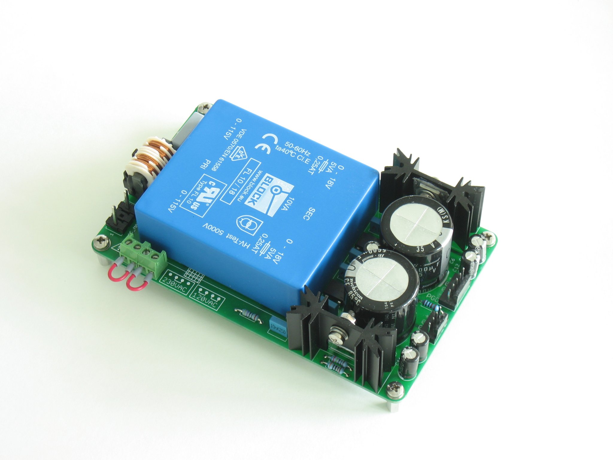

The power supply is on a separate, slightly larger (78x128mm), board:
View attachment 1066320 View attachment 1066335 View attachment 1066343
Both boards are designed for commonly available parts, including axial 0.25W metal film resistors, radial NP0 or film capacitors (5mm lead spacing), an Omron G6A small-signal relay, Aavid 5310 board-level heatsinks, and so on. Two handmade components are theb toroidal air core inductors for the output filters - I will discuss them in a separate post. The connectors are Molex KK254 or similar, but the boards will happily accommodate 0.1" screw terminal blocks, other 0.1" connectors, or bare wire.
Most parts, including the output transistors allow, broad substitution. One that I do not recommend replacing is the 5532 opamp. In testing, it demonstrated best overall performance and is strongly recommended. Having said that, other opamps with GBW of 8 to 16 MHz (e.g. OPA2134) may work, but one needs to check for stability and clean clipping. Even the TL072 works well. although its lower gain shows in the slightly higher distortion:
Faster opamps (e.g. the 55MHz LM4562) require changes in the frequency compensation and are not recommended.

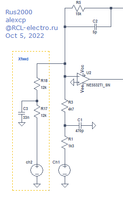

Some of those building Omicron found its input impedance a little low, esp. with the crossfeed connected. There is an easy way to triple Omicron's input impedance by changing the values of the feedback and crossfeed network as follows:
If the input is connected directly to a volume control pot, then the higher input impedance will somewhat change the relationship between the knob position and the signal level. In testing that was hardly noticeable and caused no inconvenience.

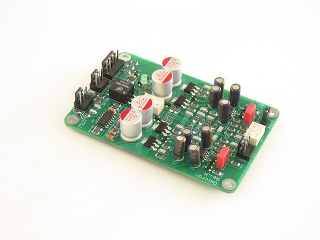

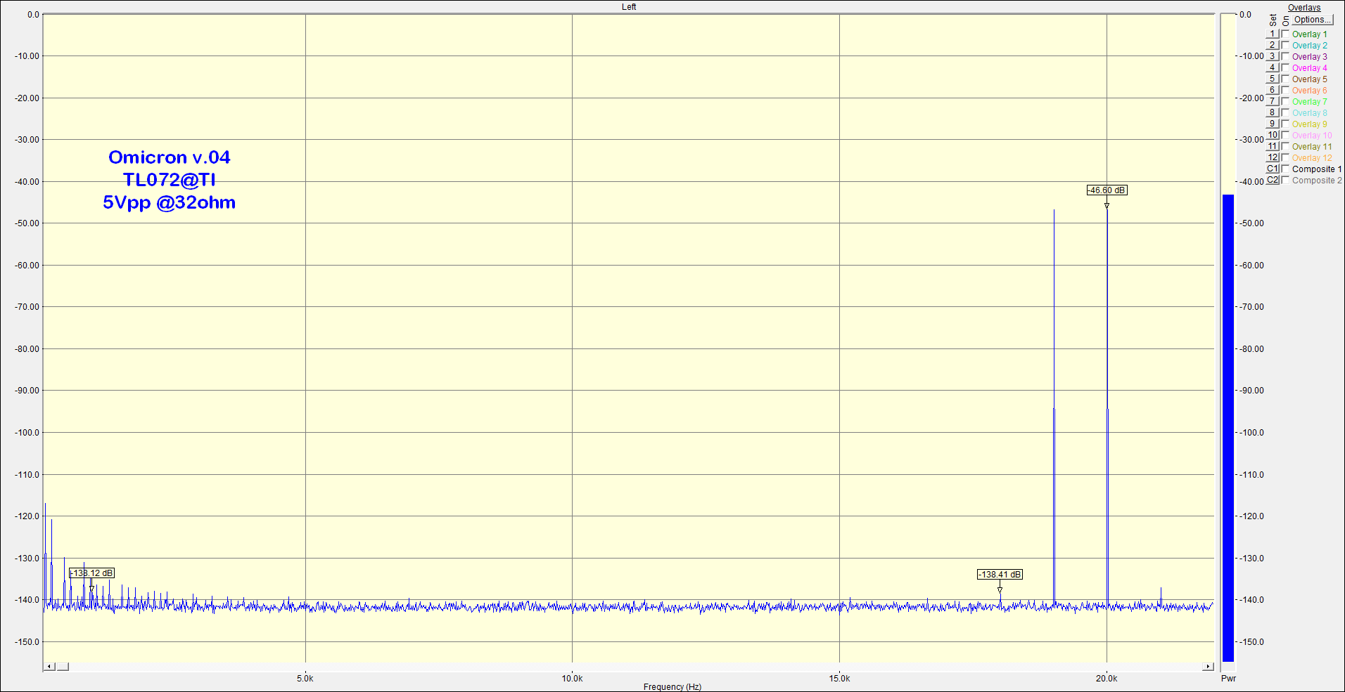

Omicron has got a new (prototype) SMT board:
The size is 60×90mm - that's two amplifier channels, DC protection and the output filter. Most of the components are SMT, but in the packages easy to solder by hand - 1206, SOIC, SOT-23 and SOT-223. The only through hole components are connectors, relays, larger caps, and the (optional) LED. The output transistors are PZT2222 and PZT2907, the quiescent current is 25mA. The board serves as the heatsink.
Compared with the through-hole version, the crossfeed can now be switched on and off by a relay. Listening with the crossfeed on and off confirmed that a crossfeed is a must when listening with headphones.
Also, a line output is added - instead of the inductor, it uses a simple RCR filter and allows using Omicron as an extremely low distortion preamp.
I have not measured the distortion yet nor have I tried other opamps (currently, the board runs with two NE5532D's by TI).

The inductor is there - on the photo, it's the black cube close to the connectors on the left. It is Murata's 78602 pulse transformer with triple identical windings (the idea is borrowed from @Nazar_lv). The leakage inductance plays the role of the isolation inductor, while the coupled inductance protects the amp from common mode EMI ingress.I can't find the isolation inductor
The line output bypasses the inductor and uses an RCR T-filter instead.
The prototype is stable with capacitive loads up to 10nF on the headphone output and with any capacitance on the line output. I am still working on it though.

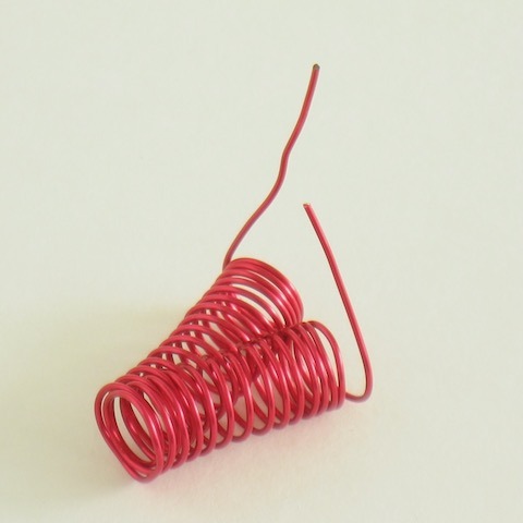

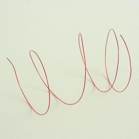

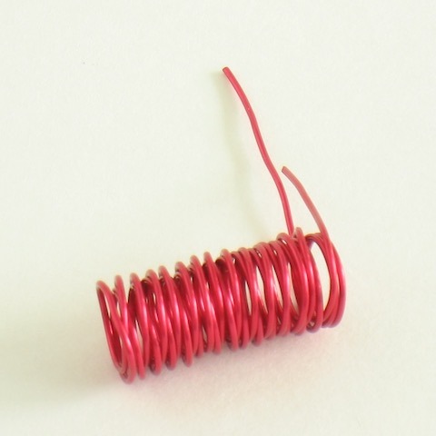

Speaking of the inductor for the through-hole version of Omicron, here is how to make one.inductor with that very impressive shape

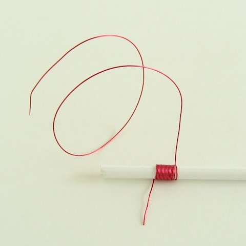

Start with about 32in/80cm of 22 AWG (0.6-0.7mm) magnet wire:
![IMG_5017.jpeg IMG_5017.jpeg](https://www.diyaudio.com/community/data/attachments/1029/1029365-8fda9e5fa82afaac9b7dc2e93027e350.jpg)

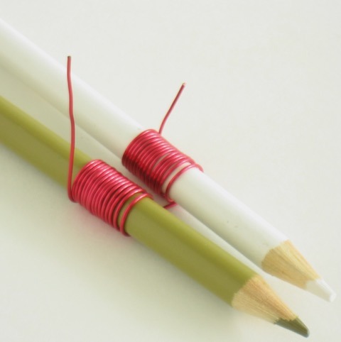

Wind half of it in a single layer coil on an approx. 0.25in (6-7mm) cylindrical former - a thick pencil with round cross section worked well:
![IMG_5020.jpeg IMG_5020.jpeg](https://www.diyaudio.com/community/data/attachments/1029/1029364-f77dcaffbf23065bd3b49b974a42b71a.jpg)
Wind the other half in a separate single layer coil, going in the opposite direction along the length of the former:
![IMG_5021.jpeg IMG_5021.jpeg](https://www.diyaudio.com/community/data/attachments/1029/1029363-6babb64e78394fc599383ab9c9cfda0e.jpg)
Here I used two pencils, but it is not essential - one is enough.
Next, push the two coils together, interleaving turns from one with the turns from the other cool:
![IMG_5024.jpeg IMG_5024.jpeg](https://www.diyaudio.com/community/data/attachments/1029/1029362-1f5f0490397843cf7951e45bfe7c25a3.jpg)
The result will be a single coil:
![IMG_5028.jpeg IMG_5028.jpeg](https://www.diyaudio.com/community/data/attachments/1029/1029358-0cedf972c017213f8f5c63c06d211ed5.jpg)

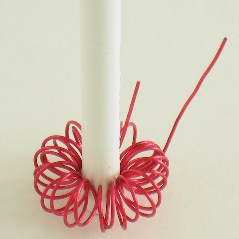

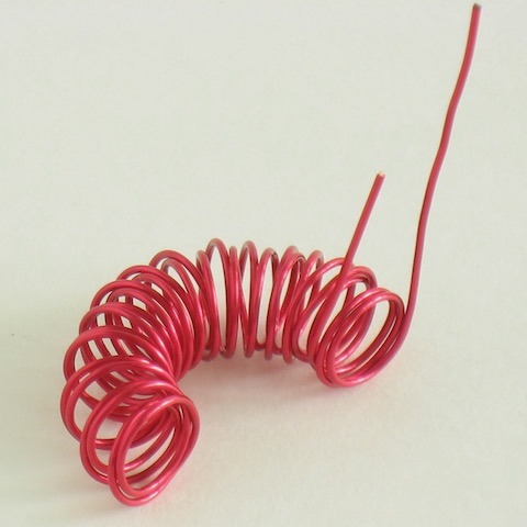

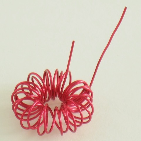

Expand the turns on one side, shaping it in a toroid:
![IMG_5032.jpeg IMG_5032.jpeg](https://www.diyaudio.com/community/data/attachments/1029/1029361-7631db67c1c667fe930ff5d51c6e920e.jpg)
Wrap the coil around the same former and expand the turns on the outer side so that the spacing between turns is more or less uniform:
![IMG_5041.jpeg IMG_5041.jpeg](https://www.diyaudio.com/community/data/attachments/1029/1029360-bd0ed5a37531a218fd353574316895c7.jpg)
That's it!
![IMG_5042.jpeg IMG_5042.jpeg](https://www.diyaudio.com/community/data/attachments/1029/1029359-92b1cf940e8d9ecb0c88747ea5d13c45.jpg)
One may add a small cable tie inside for better stability.

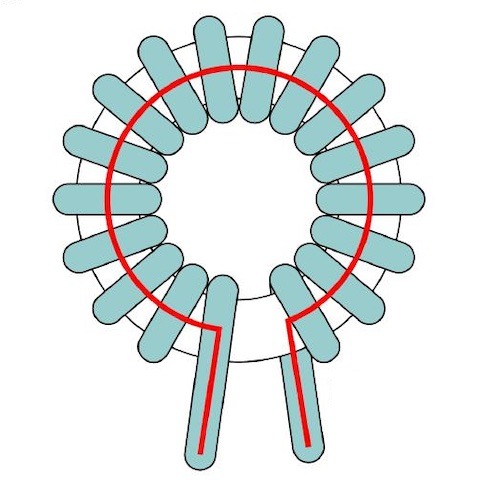

How is this way of winding better? It greatly reduces the effect of the parasitic turn:
![parasitic turn.jpg parasitic turn.jpg](https://www.diyaudio.com/community/data/attachments/1029/1029357-1b063180d6e5b7af3a233516e6c3e793.jpg)
This reduces the inductive coupling between this inductor and other circuits, such as the power transformer or the sensitive input circuit of the amplifier.

Those obstacles are manageable. All the measurements in the post #11 were done post output filter, on the PCB shown in the first post of this thread - and they are an order of magnitude better than -120dBc.board patterns and mounting become obstacles. In particular, the placement of the output inductor is a critical issue
