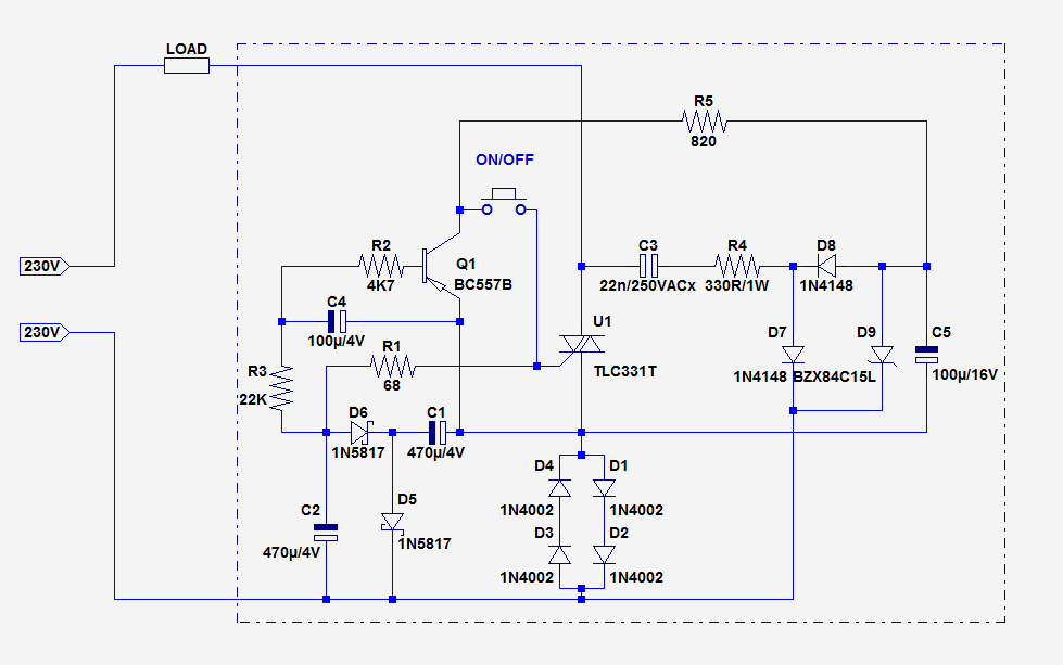

This circuit emulates a mechanical SPST switch controlled by a push-button.
As its mechanical model, it is 2-wire and requires no auxiliary supply.
It will waste ~1.5V ac in the ON state and leak ~1mA in the OFF state.
Since the triac is DC controlled, it is compatible with any type of load.
On a cold start, it will start in the OFF state.
The version shown is low-power (<200VA), but it can easily be upgraded; in fact, making it larger will ease the trade-offs (the load current needs to be at least 3x the Igt).
The 1N4002's and the triac need to be beefed up, but other than that, little modifications are required.
The circuit is designed for a sensitive gate triac (Igt<10mA), because it is intended for low power, but it could accommodate a standard triac if the power controlled is >100VA: the 68Ω needs to be lowered to accommodate the triac's requirement, and the 470µF's need to be increased in the same proportion
Edit: the circuit is shown with a 230V supply, but it will work with 120V as well; C3 might need to be increased if you want to switch ON and OFF repeatedly very quickly, but I don't think it is advisable anyway

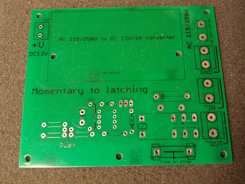

Thinking to make a simplified version (without the led and its resistor) of the circuit proposed by Bobsone with a 2 poles relay to switch ON/OFF a poweramp.
So, related to the circuit from Bobsone's first link (Toggle ON / OFF Switch - Electronics-Lab) and the schematics in the Circuits Page 9 (Circuits Page 9), I'm not sure to correctly understand "One disadvantage is the relay may be engaged when power is first applied. To solve this problem, you could tie the reset line (pin 4) to another resistor/capacitor combination with the capacitor at ground and the resistor at the +V point. This will cause pin 4 to be held near ground for a short period which will reset the output when power is applied.".
Does it mean that pins 8 and 4 of the 555 have to be disconnected (leaving pin 8 connected to the +V) and that the pin 4 alone has to be connected to the +V through a resistor and to the ground through a capacitor? Which values then for these R and C?
Thanks in advance for replies/comments!
Edit: will something like attached work (given I use main AC rated relay and supply 120VAC instead of 12DC as pictured)?

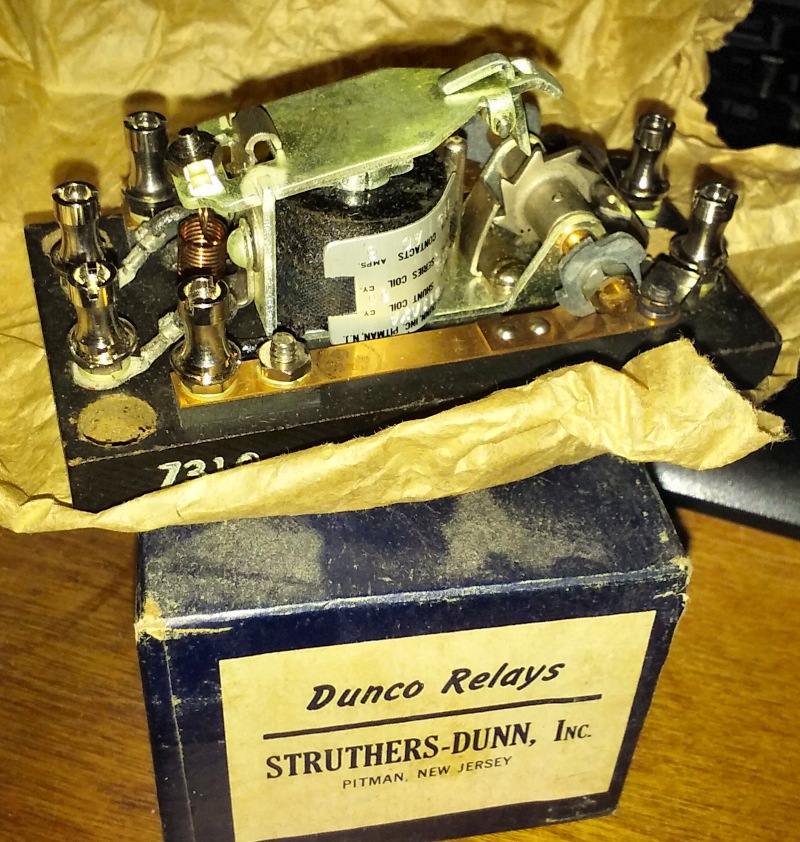

Agh!! These are ALL over Amazon France, but almost impossible to find on the US market. (Why I paid a lot for the S-D antique.)
SAME mechanism: coil ratchet cam switch.
Different coil voltages available. 230V is simple. 24V may allow less-safe wire on the buttons but needs a LV power source.
For EUR14 you get light plastic parts. EUR30+ gets a DIN-mount. Link.
Spec Sheet
ONE found randomly at a place that will ship to me. (This one is 24V DC.) Link. More.
