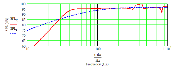

I too have ben interested in the Onken cabs for quite a while.
Just the other day, I found an offer for a pair of AUdax PR330MO, a speaker I used for a project some 10-12 years ago. That project had a bass I have seldom heard - deep ,fast and clean.
These cabs were however over 220 liters net, which is somewhat too large for a normal living room. Stuffing these param's into the Onken calculator indicates that this driver is really outside the onken range....judging by what is written here previously, it should be quite ideal..... some 96-97 dB too..
Is soneone could stuff this into MJKs sims, I would be greatful (- I don't have access to a suitable Mathcad version )
Here are the param's:
Fs Qes Qms Qts Vas Re Le Sd Xmax Pe
28 0,28 6,69 0,27 264,0 5,8 0,4 538 5,0 120
'Stuff' what in MJK's software? I mean it can't do any auto designing with just loading the driver specs into it.
Depending on how high the cab is, 220 L doesn't seem all that large for a 'normal' size living room, but I realize this varies around the world, so I'm curious what HxWxD you consider 'normal'.
Regardless, yes, this driver's specs fall outside the Onken's rather narrow ideal range, but since the specs otherwise make it OK for a vented alignment there's no reason you can't use it to design a good performing cab using only four vents and a ~0.6Sd vent area in a ~131 L net/39 Hz alignment to get the vent lengths down to around the recommended length limit. MJK's software only allows a summed vent area, but give a good idea of what to expect with a N = 6.34 alignment and 0.25 ohm series resistance added for wiring losses):
L = 32.25"
CSA (WxD)= 248.02"^2
zdriver = 14.93"
Av = 49.6"^2 or four each 12.4"^2 x 13.34" long
All dims approximate and minimal stuffing used, so if the vent pipe's harmonics are a problem higher up, stuff the them to suit, though I assumed a somewhat acoustically resistive 10:1 H:W ratio (4 W x 40 H cm) vent, so will probably be damped enough as is.
GM

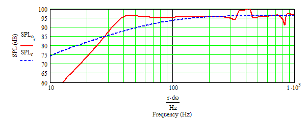

Thanks, GM...
although a bit hasty and vague in my last post, that was exactly what I was looking for!
I was fiddling around with the Onken calculator, and setting N=6.4 , the "best Onken setting" , gives an acceptable cab of appx 130litres, and just about sets the vents around the max allowed length of 35 cm.
The sims gives approximately the same results as the Onken calc.

GM said:
......though I assumed a somewhat acoustically resistive 10:1 H:W ratio (4 W x 40 H cm) vent.......
Oops! Make that 20:1 H:W ratio (2 cm W x 40 cm H).......

You're welcome!
Normally it would theoretically be 24 dB/octave, but the large vent is raising the Q a bit, though due to the even higher aspect ratio than I realized it will probably behave more like this with a ~20 dB/octave roll off and reduced peaking:

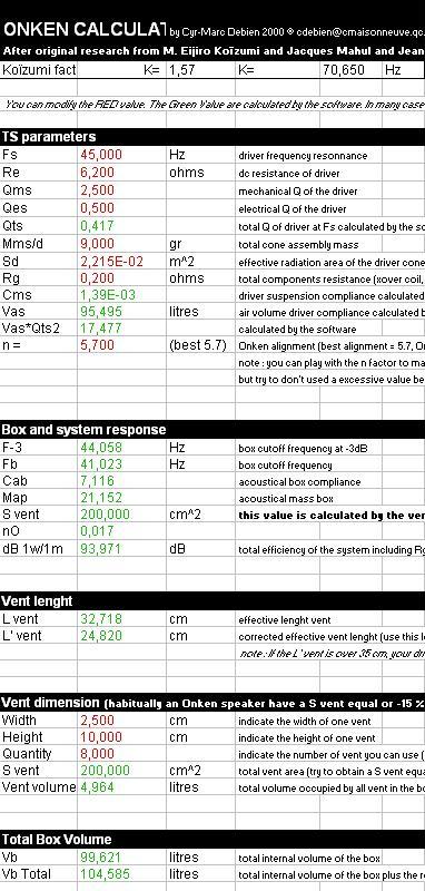

Hemp FR8c ?
Hi there !
please look at the spreadsheet...
did I really find the perfect driver for a 100 liter cab, finally ??
These are the factory specs for the Hemp FR8c fullrange driver.
will this work ??
And if so, one more question;
because I cannot decide if an F3 of 44Hz is low enough
for home-use (mostly music, occasional movie at nice SPL)
I mean,
what is a "normal" F3 of a good sounding speaker ?
Is it true that a somewhat higher F3 will help reg. placing the speakers (back against a wall), to prevent boomy-ness ?
Hope to read your reply !
Empee

For a single 8"er with decent sensitivity, 44Hz is OK. And it's near the driver's Fs anyway.
Is it enough? It's very personal.
It might help playing music with a handy RTA. So you can both listen to and 'look at' the sound.
In most recordings, not much information below 40Hz. But in some others, there'd be a lot! With the help from RTA, you may judge for yourself.
For myself personally, 44Hz is not enough. About another half of octave, say, 32Hz, things would be VERY different. That's for hearing.
(If "feeling" is needed, then you'll need 20 something.)
