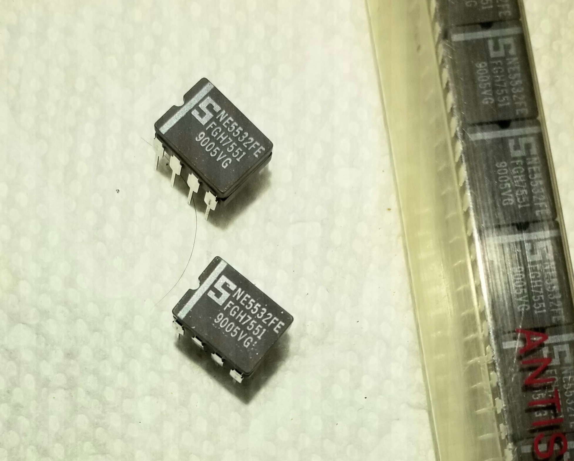

I got my hands on some NOS mil spec ceramic case NE5532s and have used them in upgrades of my personal gear. They have about the same character as the original Philips chips but sound a bit more transparent and refined to my ears. That being said, the original NE5532/ 34s overall sound balanced and have the "correct" sound. Used correctly, they have clean analytical tight low end, neutral mids and transparent quiet top end. Piano music is my go to benchmark test for evaluating audio gear and these original spec NEs have the most inert sound of any older bipolar op amp. I do prefer the "AN" spec for phono riaa stages because of the lower noise spec than the common N suffix. The standard version is more than up to the task compared to any of the other cookie cutter bipolar op amps. I've had good luck with the TI version AN suffix as well, but they do tend to be a little more forward sounding than the originals in lower gain situations, so I understand why you would label them as shouty. By far the nastiest bipolar op amps are the 4556, 4558 and LM324. They sound downright awful and usually are found in cheaper gear that have tons of polarized electrolytic and mylar coupling caps in the signal path. Alot of budget "DJ" / karaoke mixers and amps come with bucket loads of these nasty chips.

As I said, the problem is most of the Sig/Philips 5534/2 on Ebay are fake. You may want to try to find real one in some broken old equipments. There are usually socketed. If someone has real ones, I'll buy them. They are valuable.other folks in this thread have said the same thing about the phillips 5534's sounding better. I would definitely be interested in trying out a set against the TI ones I have. I believe you may be correct
Yes, that's true about the counterfeit garbage found on ebay. Most are remarked 4558s. You can usually tell by the font and the faked lot number that never changes. The ones in the picture are the real deal ceramic body version and very hard to come by. I found them at a yard sale in my area - go figure.As I said, the problem is most of the Sig/Philips 5534/2 on Ebay are fake. You may want to try to find real one in some broken old equipments. There are usually socketed. If someone has real ones, I'll buy them. They are valuable.
I'm not sure why there is such a big spread in quality among 5532 / 34s. The dye will certainly be different because from personal experience I can run these FE spec 5532s on up to 20V rails without issue (+/- 18V is rated max spec). I torture tested one into a 100R load at +/- 22V rails for a whole week without issue. It actually got pretty warm but never showed any other symptoms of stress. Two of these with each internal pair in parallel and SE push/pull on a single rail per channel makes for an amazing higher impedance HP amp. I tried a few others under these conditions and most failed within a minute or two, with the exception of the TI branded "AN" version and the NJM branded "N". Of the two, the NJM sounds closest to the old Signetics version, but a hint more noisy.
