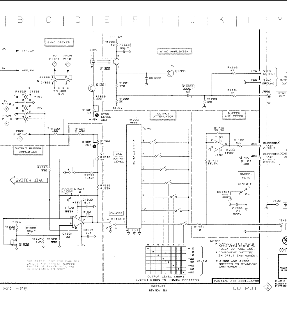

I suppose I could try swapping LM49710s for the 5534s in my preamp and seeing what difference there is with and without biasing to +ve rail. Trying a CCS to the -ve rail is going to be too messy on that board and unfortunately I have very little time for my hobby at the moment. Although I'm more than happy to trust my ears so far, I am an EE and would prefer to be starting from a position where I know I'm likely to be improving the measured performance rather than vice versa. Hence my question. Should it turn out that way, I'm not really keen on the idea of a mod that seems like it improves the sound if it involves increasing distortion...
What is that compensation scheme ?
I suppose a lead-lag on the negative input and a cap over the feedback resistor.
What is so clever about that especially when you use high value resistors in a shunt feedback arrangement ?
That cries for oszillation.
KSTR; you are very cryptic.

But therein lies the problem 🙂 Do you see.
Normally a 5534 is compensated with a single cap. Next "level" is two-pole comp (seen at other places in SG505 circuit), but here its something I haven't seen anywhere else so far and don't quite understand it yet.It´s a bit more complex, i agree.
I have to study that in detail.
And the JFET error signal booster is also nice but might introduce supply ripple/noise (the SG505's output is quite polluted with mains components by today's precision oscillator standards -- note to self : need replace all supply-related 'lytics).
