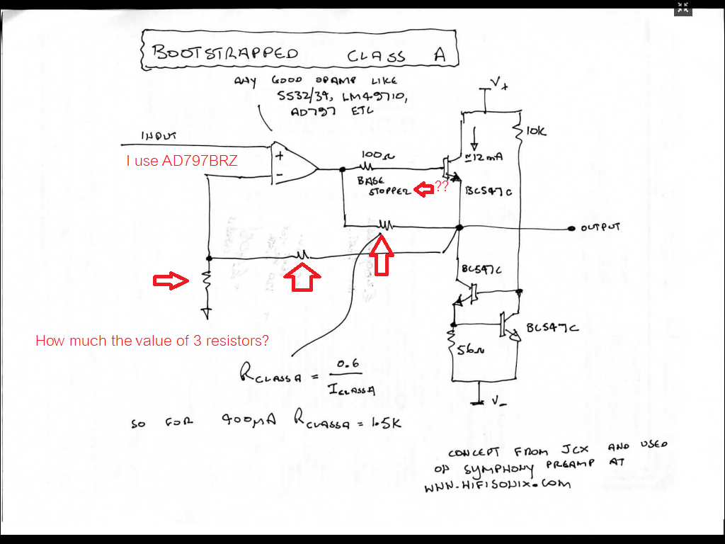

There is another very easy way to bias an opamp into class A and not have to worry about any PSRR degradation - see attached diagram. DIYaudio forum member jcx showed this a few years ago and I used it on my Symphony preamp. If you are looking for the ultimate in quality, its best to also buffer the opamp as shown. You can then drive loads up to 2x the peak buffer standing current with virtually no loading effect on the opamp at all.

Great stuff Andrew! Looked at the article. CCS'ed current sink + CCS'ed buffer = perfect combination 😎

Dear Mr. Bonsai,
Can you help me a little?
What are the value of 3 resistors in Bootstrapped Class A opamp?
My rail voltage is +15VDC and -15VDC
Rclassa determines the current in Class A the Opamp deliveres... So, basically Ohms law... For each mA it's about 650 (Ohms)/ x (mA) (assuming Vbe = 0,65V )
The other two resistors determine the amplification of the total circuit. Let's assume the most left resistor is R1 and the other R2 : (R1+R2) / R1 = amplification
