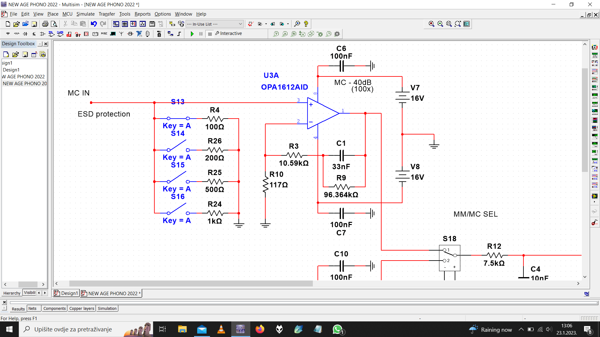

Not sure how experienced as a phono designer you are, but there are a few very good reasons behind having a pre-pre stage with 10x gain for mc carts to get the best possible SNR with sufficient headroom and +-5V supply is absolutely ok for that. A lot less nightmares can happen with a +-5v supply .In past year I slowly designed high quality phono preamp. Started with circuit itself, various ideas, pros and cons, power supply concepts, pcb design and so on.

Why you opted for a 40db stage for mc carts ...I have no ideea.

Those diode clamps are also necessary if the power supply cannot sink current.Do you have reverse voltage diode clamps across your PSU?

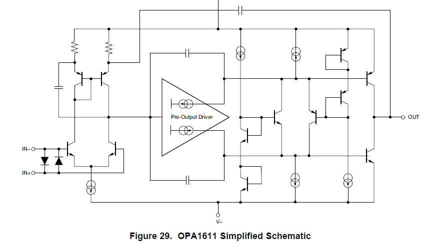

I refrained from mentioning internal ESD protection diodes as I couldn't see how conditions to burn them would be met in your case. They are rated for 10 mA continuous and several hundred mA pulse. I know first hand that they sustain repeated 50 mA pulses with 50 ms duration.

Having resistor at MC input (<1K) would protect opamp or save expensive cartridge if failure conditions were not coming from the MC input.
I would suggest that too. However, due to the high capacity, which is definitively necessary for a sufficiently low f3, an electrolytic capacitor (polarized cap) must be used.Why not to add an input coupling cap? It also may be chosen to low frequency roll off at f<20Hz.

You don´t want to add anything in that place, it is a ultra low level signal input section, you try to avoid every component that can add distortion or noise.Why not to add an input coupling cap? It also may be choosen to low frequency rolloff at f<20Hz.
Even parallel load resistors are super low noise type, resistors add current noise, in dynamic signal condition resistor can add another type of of noise as signal changes.

What does the MC IN ESD protection look like? Schottky's to the positive and negative supplies, which would probably also prevent latch-up triggering from pulses at the input, or some transzorb-like thing?

Connect two anti parallel diodes between the two inputs and you will never have the problem again.

Assuming a electrostatic discharge triggers a catastrophic latchup - you have two options
1) Keep the trigger impuls off your pcb. I have some experience on this topic and can say this may be very difficult due to the nature of such pulses. Typical ESD pulses have amplitudes of several kV at rise times of 1nsec giving current rates in the ballpark of 10amp/ns. These incredible current rates generate a 10V voltage spike along 1nH - something like 1mm of wire. It is evident that there is no practical way to shunt these even with big SMD MLCC cap or with any clamping diode. All you can do is insert some series impedance that reduces current amplitude.
2) The electrostatic impulse has little energy content and is not destructive per se. It becomes destructive with a powered chip when the pulse triggers internal parasisitc thyristors. If you limit the supply current below the latching current, current flow will stop immediately after triggering and nothing is burned. I propose 47Ohm SMD resistor in each supply line of each IC with local blocking caps of 10nF.
