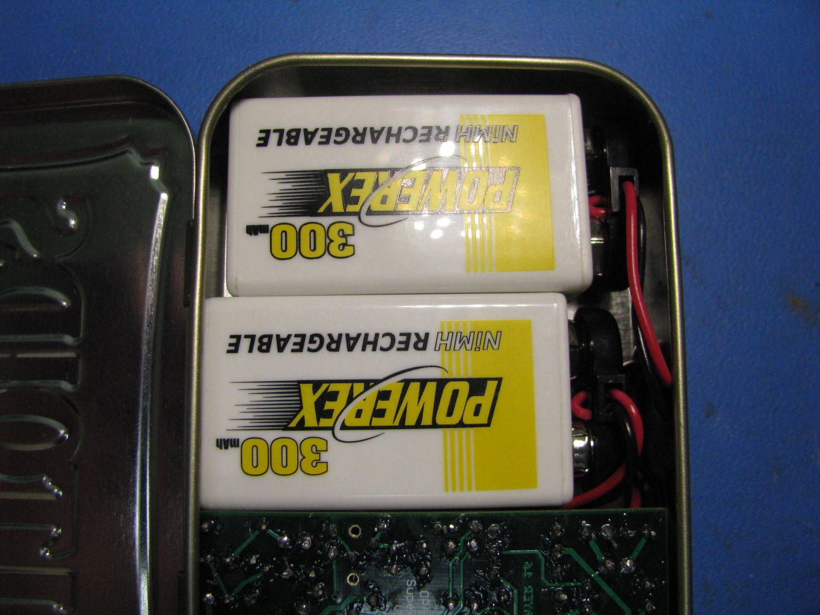

A battery header is OK! In fact I sized those 4 holes for a 0.1" header and originally intended to use one, so the battery clips could just be plugged onto the header. That would make the battery wires a bit more break-proof too if the insulation had some support in a header socket. The problem though is all the headers I could find were too tall when the socket was plugged in. I thought about trying a right angle, but it seemd like it would hit the batteries. If you are able to make a header fit, please post some pictures!
Also, something I've been meaning to post in general, might as well twist the two battery clip wires together for each snap. The whole thing is in a metal mint tin so EMI pickup is likely to be nil, but might as well twist the wires anyway.
Thanks. Just wanted to make sure. I have a bunch of generic "Altoids" size tins. I was going to custom etch one for this but I'm on an Art Deco kick right now so I think I'm going to custom build a case from either or a combination of steel, brass and/or zinc. That will allow me to use the headers and JR connector and would end up with a case just a tad larger than the tin.
We'll see once I get the board done.

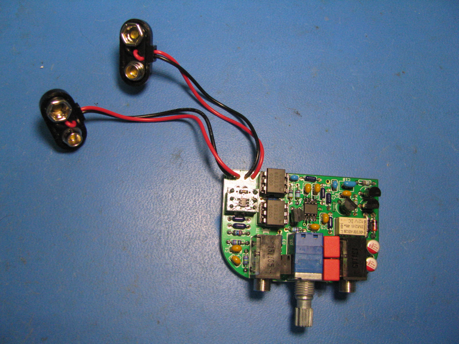

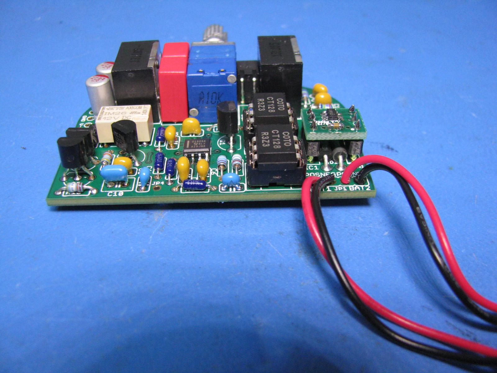

I see the mc78l12acpg in the circuit, and I'm having a bit of trouble wrapping my head around what part I would need to replace it with, if any, assuming modification of the circuit to essentially bypass the voltage drop detection portion.
Good question! I'll bet there are other folks out there who AC-power their Super CMOYs.
The good news is that all you will have to do is run the +/-DC from your split power supply to the Super CMOY battery connection holes. Everything on the Super CMOY board stays the same. As long was your split supply is more than +/- 7.1Vdc (and less than +/-17Vdc) the low battery protection circuit will think you have fully charged batteries. If you use the alternate set of resistors in the BOM for lithium rechargeable cells it will drop that "low battery" point down to +/-6.26Vdc.
I've attached a picture of the Super CMOY battery wire holes below. What you would do is run the positive DC voltage from your split supply to the bottom terminal of the four, marked "POS", near IC3. Your negative DC voltage from your split supply would go to the "NEG" hole on the other end, near the board edge. Then the common ground wire from your supply would go to either one of the two center battery holes - doesn't matter which one - marked "POS" and "NEG". Be sure to twist all 3 of the wires from your split supply together to help eliminate noise pickup.
And that is it! The OPA1688, the TPS3701, and all the Super CMOY's parts are OK with up to +/-17Vdc power supplies. It would be up to +/-18Vdc, but the MC78L12 is only rated to 35Vdc. For more than the +/-11Vdc you get with two batteries you would have to check on chip power dissipation at very high volume levels with low loads (16R headphones). But for normal listening levels your should be just fine above +/-11Vdc.
The low battery cutoff circuitry is up by those battery input holes. The MC78l12 on the other end of the board is for the headphone relay circuit, which eliminates the turn-on and turn-off pops. Lots going on with that small PC board!
The low battery cutoff circuitry is up by those battery input holes. The MC78l12 on the other end of the board is for the headphone relay circuit, which eliminates the turn-on and turn-off pops. Lots going on with that small PC board!The MC78l12 is there so that the relay's coil always gets a constant 12Vdc regardless of how discharged the batteries are - or with an AC supply. A second benefit is providing a constant voltage for the RC time delay parts, so you get the same 2 second turn-on delay regardless of how charged the batteries are.
Thanks for the answer of what that regulator does! I think I'll be able to remove it as I intend to use 12v regulators in the split supply to give me a solid +/- 12vdc..........unless instead the op amp isn't cranky about unregulated ~15.5vdc?
Hi, you would still need the MC78L12 because it wires between the rails. So if you have a +/-12Vdc split supply, the MC78L12 gets fed 24Vdc. If you are using your +/-15.5Vdc rails then the MC78L12 gets fed 31Vdc (which is OK). The headphone relay circuit parts and voltages are all relalative to the negative rail, not relative to ground like the rest of the Super CMOY circuitry is. The relay circuit is designed that way so that it doesn't matter if the batteries are fully charged or nearly dead, the relay circuit will work the same way. The MC78L12 only feeds the relay coil and relay control circuit, it doesn't have anything to do with the OPA1688 audio chip's power supply.
You still would need the relay circuit with an AC supply because it is what eliminates the turn-on and turn-off pops in your headphones. As far sas I know there isn't any other CMOY out there with an anti-thump circuit.

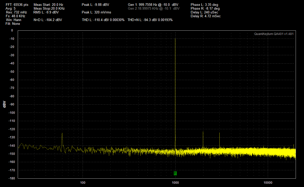

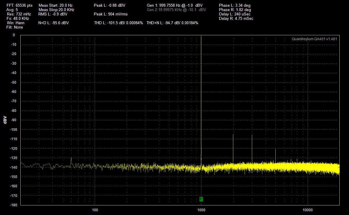

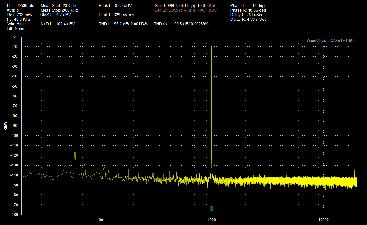

THD+N: primary 9V batteries vs. "9V" lithium polymer - part 1

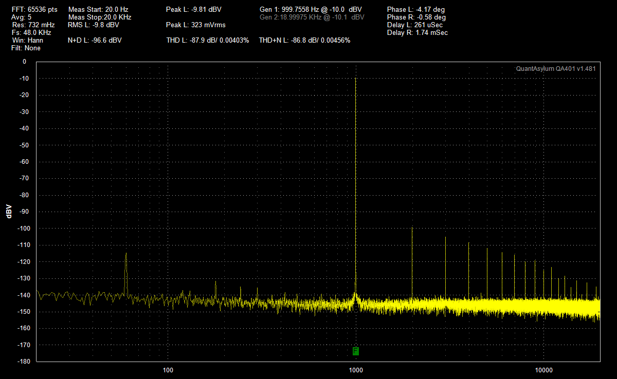

I've been curious what the THD+N for various loads would look like with the Super CMOY running on 9V primary (throw away) batteries vs. the lithium polymer "9V" (7.4 nominal) batteries, given the huge internal resistance difference from the posts above.
The net result: very little difference in THD+N between the two battery types! Likely due to the good PSRR of the OPA1688. But the other take-way here is the OPA1688 is not a happy camper distortion-wise with a 15 ohm load and higher volume levels. Well, it is just a 4mm by 5mm chip after all, with 2 amplifers in it!
Pretty impressive overall for such a tiny chip vs. the huge heat-sinked LME49600 buffers on something like the O2 Booster Board or opc's Wire headamp.
Plots:
* loopback of the QA401 with -10dBV input and -1dBV input, just to map out the analyzer's own 2nd, 3rd, and at the higher -1dBV input level 5th harmonics. Subtract those from the results. The calculated THD and THD+N is listed at the top of the plot. Remember that you can click ont he arrows in the lower left corner of any of these to zoom it up.
In all of the test results here the 9V primary cells are on the left and the "9V" lithium polymer rechargeable battery is on the right, of each test pair for a given load and input level.
* -10dBV input with a 150R load. Remember from the loopback plots that the QA401's own 2nd and 3rd harmonics at around -122dBV at -10dBV input and around -105dBV at -1dBV input. Pretty large. So with those subtracted out the results due to the Super CMOY here are all under -120dBV. The 4th and 5th harmonics are just a bit less with the lithium polymer batteries.
* -10dBV input with a 33R load. The spray of harmonics from the 3rd on are all under 110dBV. Very similar looking results for the two battery types. Mouse over the plots and you can read the test details in the file name.
* -10dBV input with a 15R load. Everything under about -105eBV. Again very similar looking results for the two battery types.
* -1dBV input with a 150R load. All the harmonics still under -110dBV if you subtract out the analyzer's big 2nd and 3rd harmonics.
Plots:

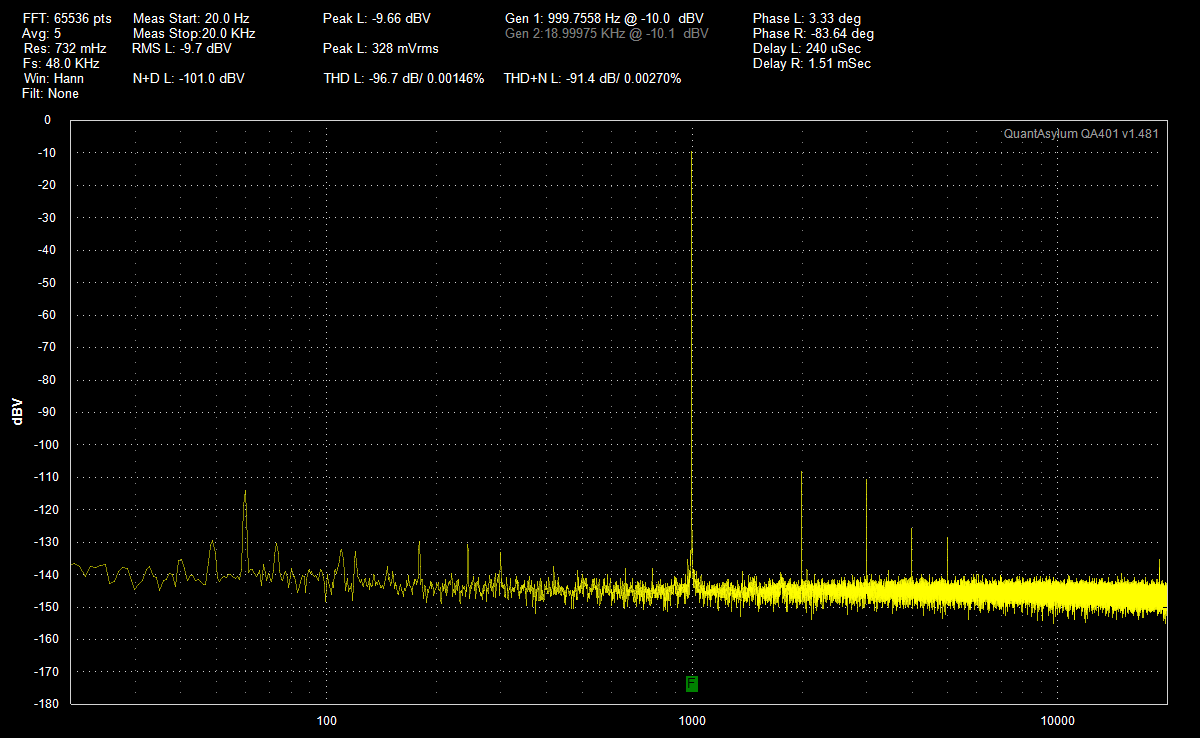

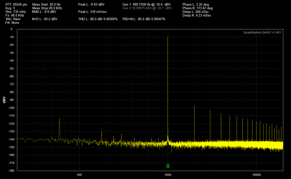

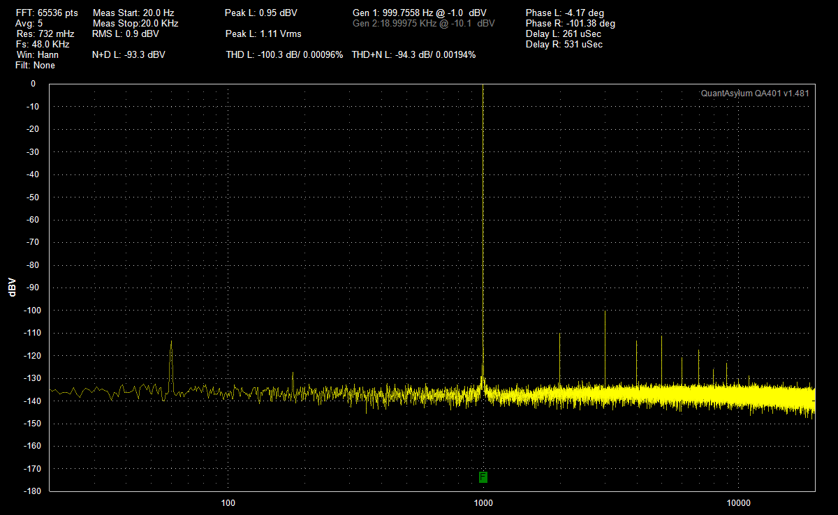

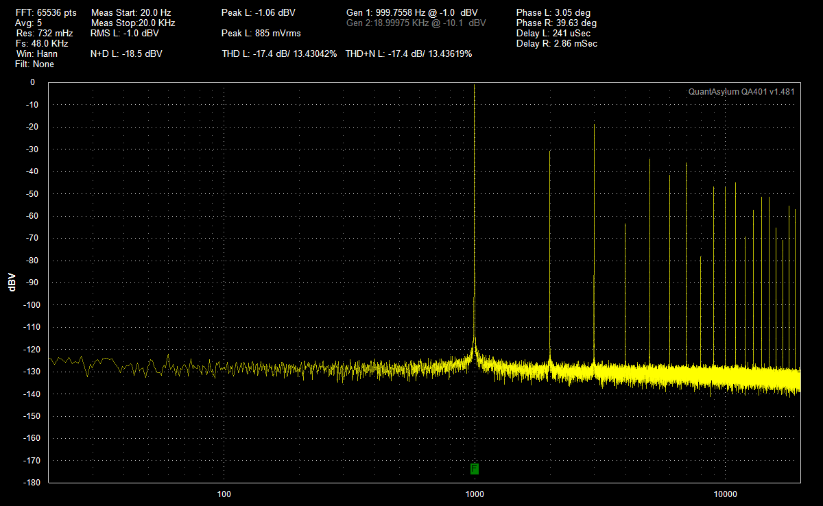

THD+N: primary 9V batteries vs. "9V" lithium polymer - part 2
...ran out of photo slots in the post above, part 2.

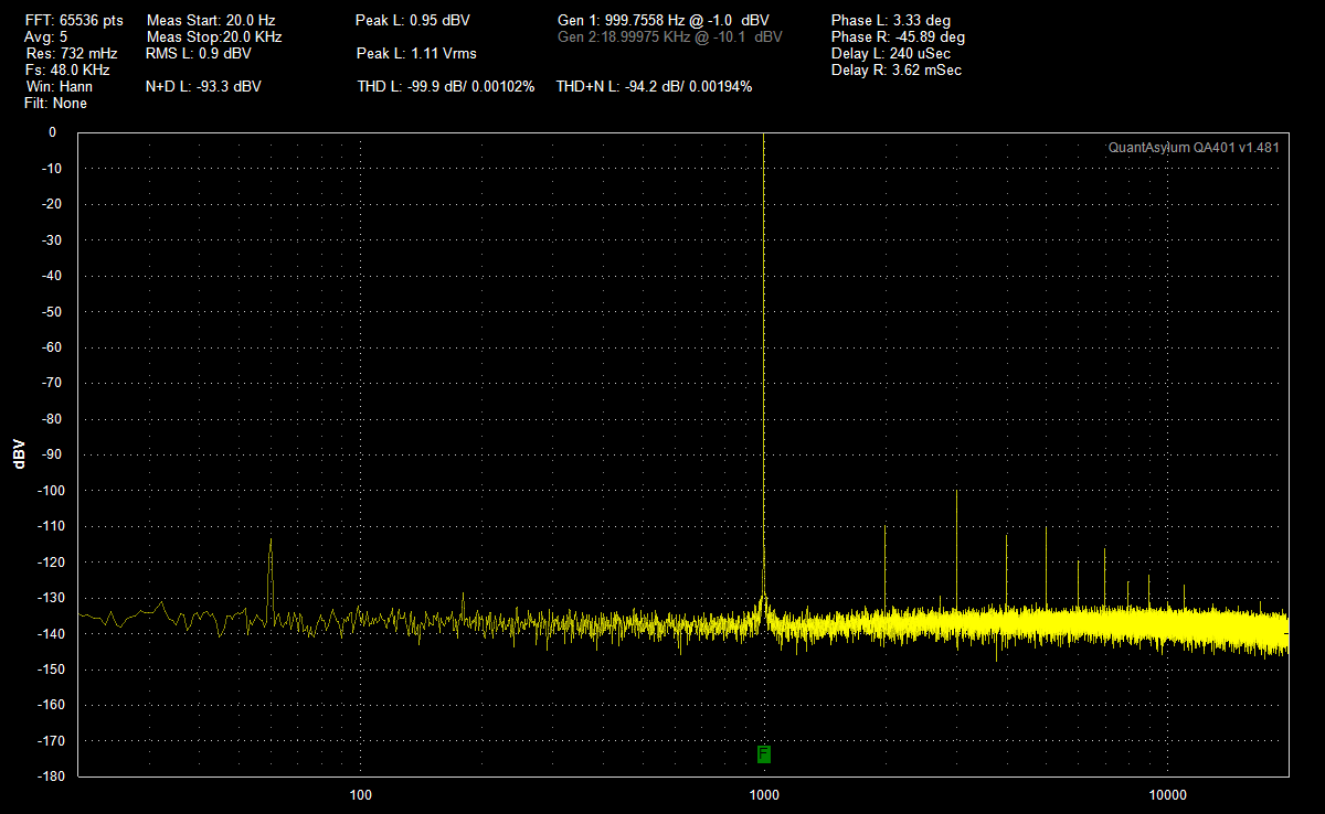

Same deal as above, the left plot in each pair is the primary 9V batteries, while the right plot is the lithium polymer rechargeable "9V" 7.4 nominal batteries.
* -1dBV input with a 33R load. Not bad at all!
32R is a common headphone / IEM impedance and this is a higher input level.
* -1dBV input with a 15R load. Well... yuk!
That is the technical term.
Hmmm... worth going back and having a closer look at those OPA1688 THD datasheet curves at 16R load. But at least the chip is still under -105dBV harmonics for lower levels qith a 15R load, above.
I used 33R & 15R rather than 32R and 16R (the datasheet loads) in all these tests just because these are what I had on hand in 1/4W metal film 1%.
The whole purpose of this exercise was to compare the THD+N results of the two battery technologies. From these results is looks like a wash - nearly similar. But the lithium polymer will still provide 3x the capacity. I didn't test any of the NiMH rechargeable cells since their internal battery resistance from the posts above (around 2.2 ohms) wound up between these primary cell (5 ohms) and the lithium (0.4 ohm). I figure that the NiMH results would be inbetween these two.

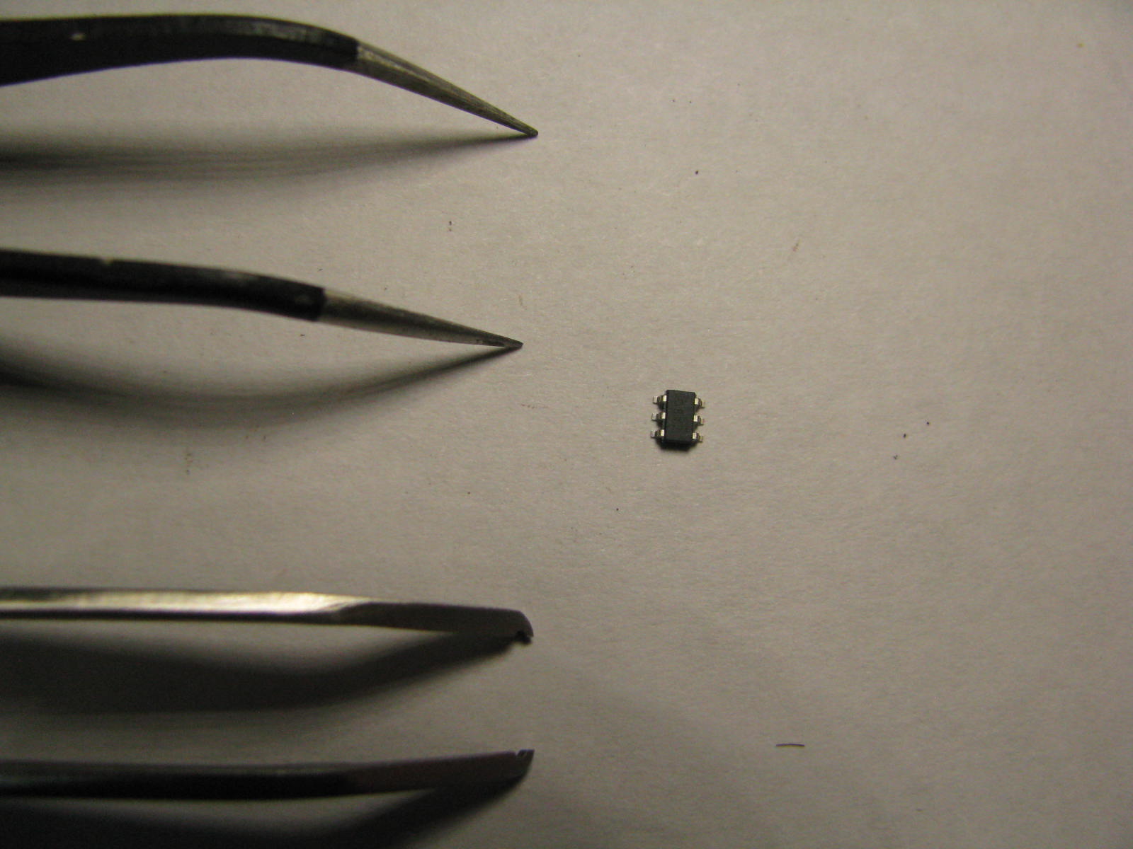

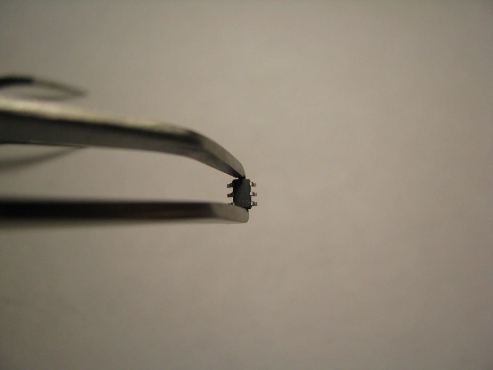

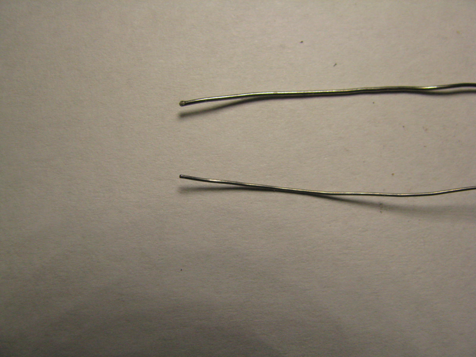

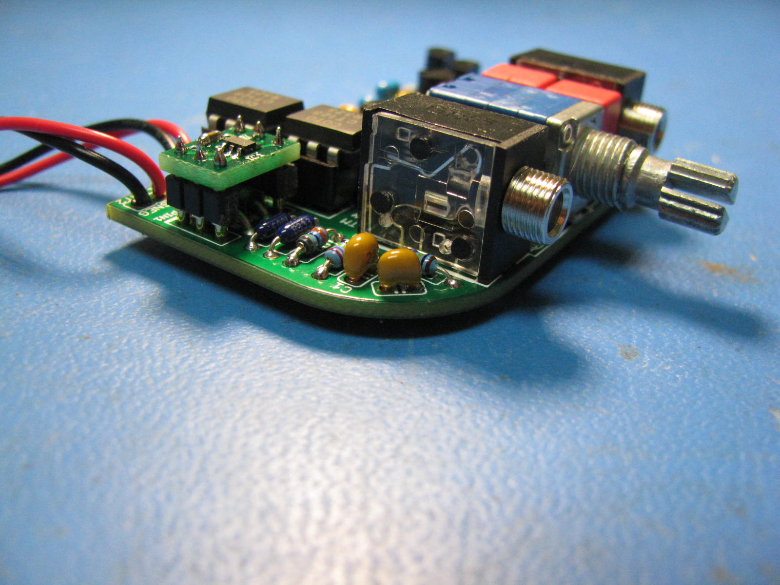

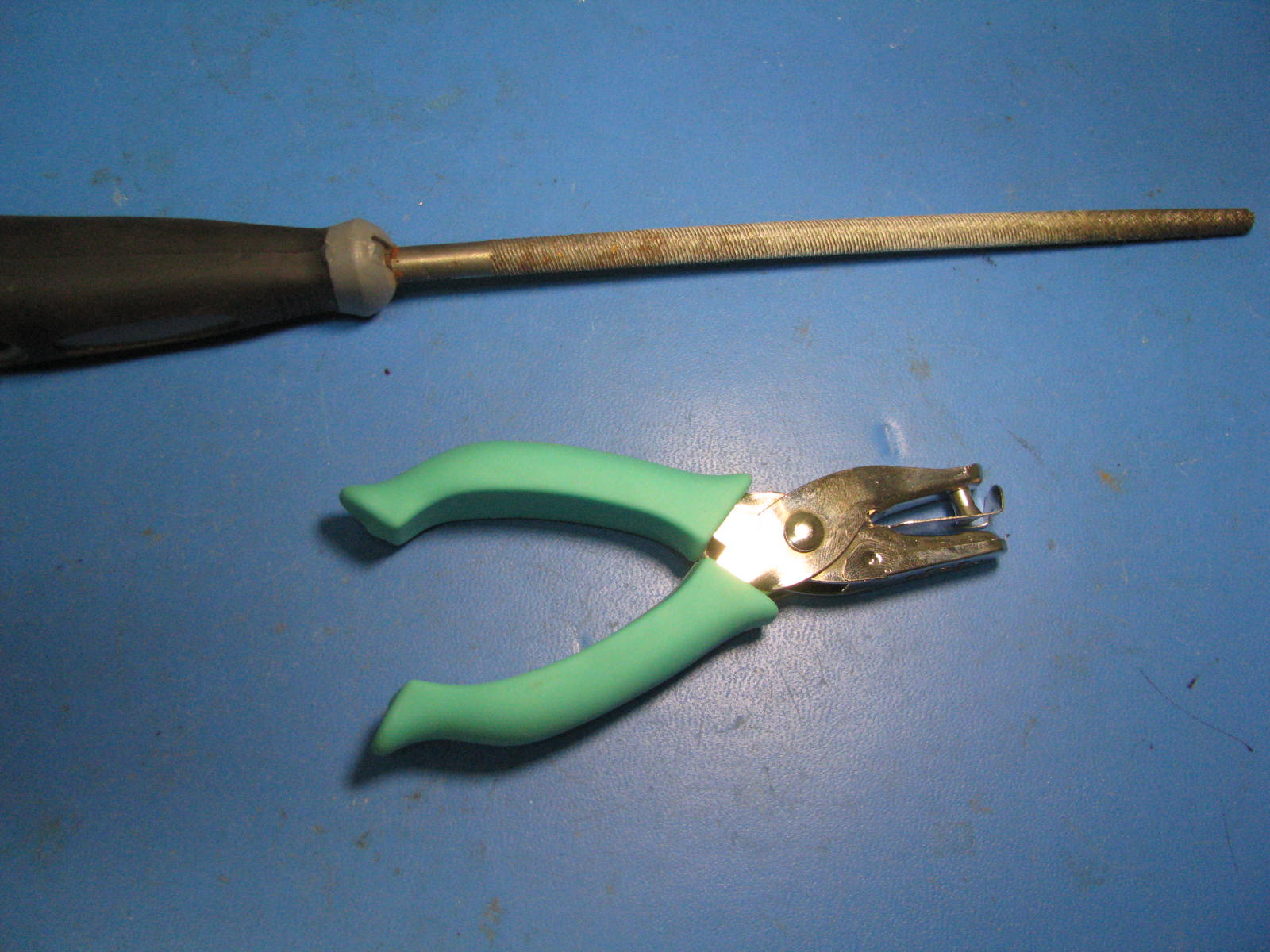

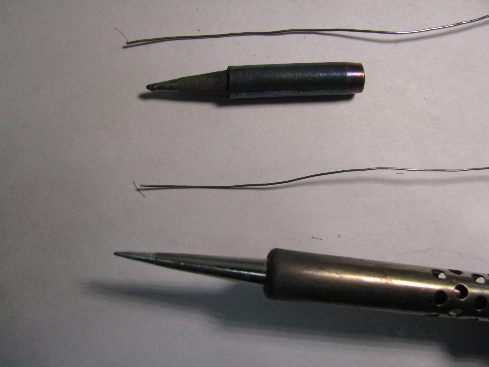

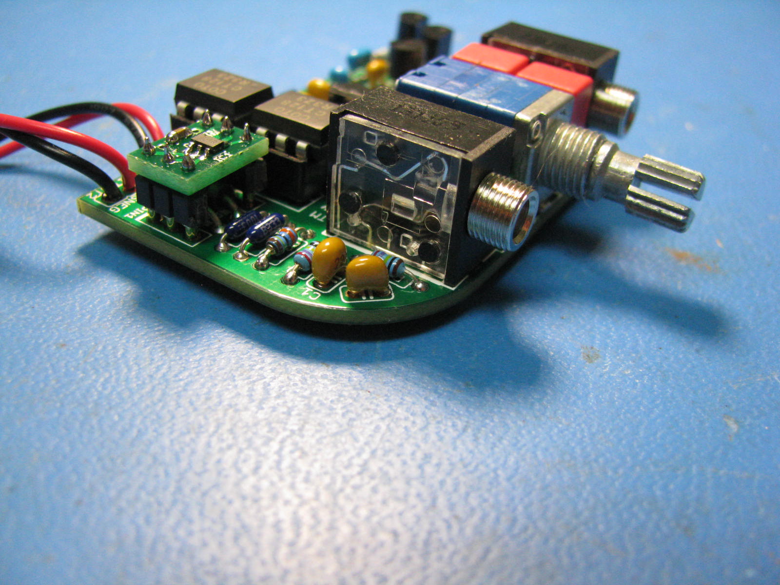

More tips about soldering the TPS3701 boards + Farnell added to BOM + CMOY FR

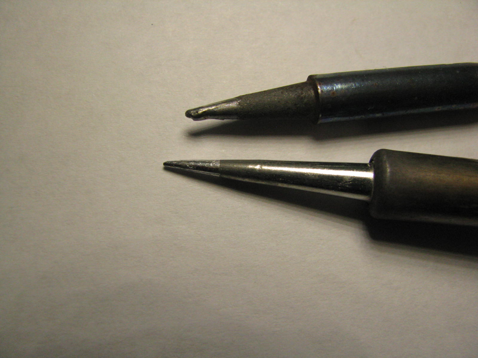

I have a few more helpful tips for those who want to solder up their own TPS3701 comparator adapter boards.
I tried a finer tip on the soldering station weeks ago and found it didn't really help, the tiny leads on the TPS3701 still flooded and needed solder wick after to clean up. Then I remembered a few days ago that finer gauge solder exists. I use a 0.022" (=0.56mm) eutectic silver-bearing solder for most things (63/36/2). The next standard size down is 0.015" (=0.38mm). I had also forgotten that I had a bunch of it, I just never use it because - until now - it is too thin, requiring several inches to be fed to a normal sized joint.
Well it turns out 0.015" solder is just the ticket for the SOT-23-6 package. Now with a finer tip (1/64" = 0.4mm conical) I can individually solder nearly every pin on the chip. I'm down to solder briding maybe 2 pins on each chip rather than all pins on both sides.
All of this is done under a magnifying glass too.
The first photo shows the 1/32" (= 0.80mm) conical tip and the original 0.022" solder. The bottom half of the photo shows the new 1/64" conical tip and the 0.015" solder
The next two photos are close-ups of the solder and soldering station tips. The 1/64" doesn't hold much heat, but not a lot is needed either for the tiny chip and thin solder.
The next photo shows a handy type of tweezer. The black sharp ones at the top are the tweezers I use for most things. The stainless pair with the flat tips are a Hakko 107-SA from Amazon.com for around $17. The tips are specifically designed to pick up small SMD parts. If anyone knows of other tweezers out there designed for SMD, please post! The tweezers at the top work great for standard SOIC8 (like the OPA1688), but are completely useless for the tiny SOT-23-6. The chip just flies off the end in all directions.

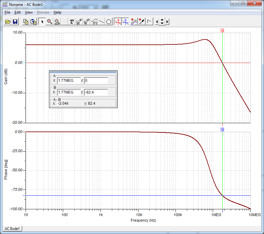

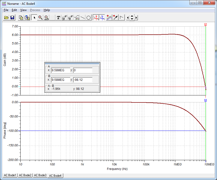

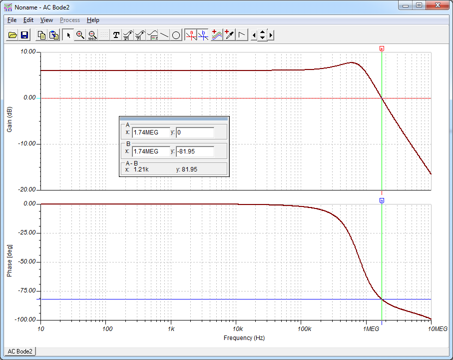

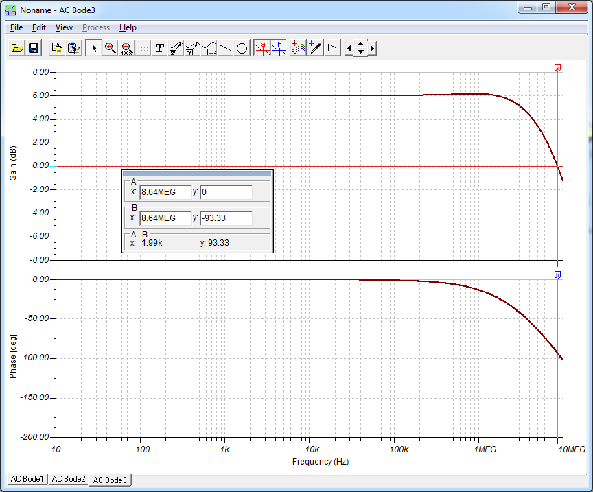

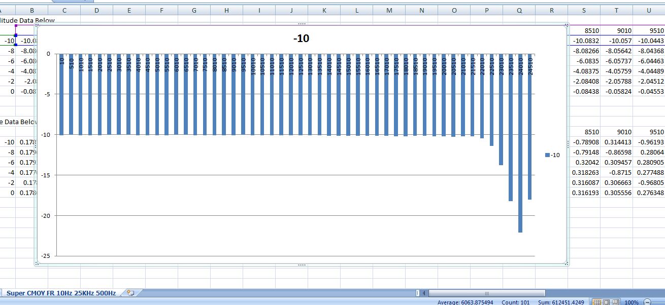

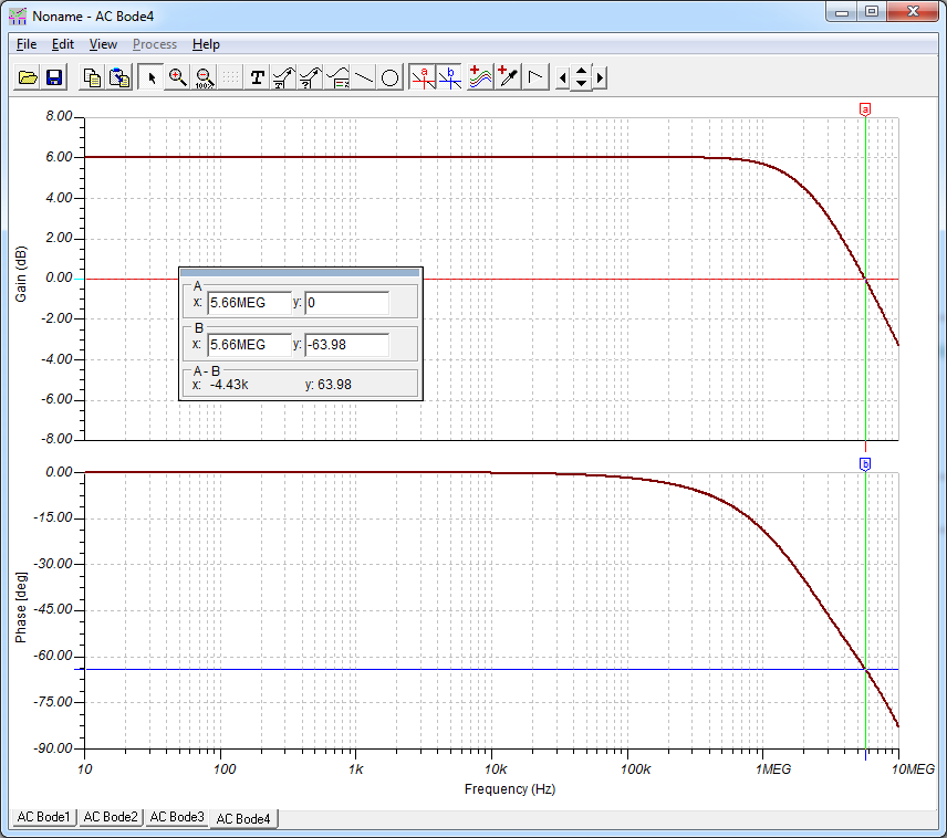

And finally in the THD tests above with the two types of batteries I also ran a frequency response test on the CMOY using the QA401. Results below. Flat as a board up to 22KHz. The test was from 10Hz to 25KHz in 500Hz steps using the QA401.

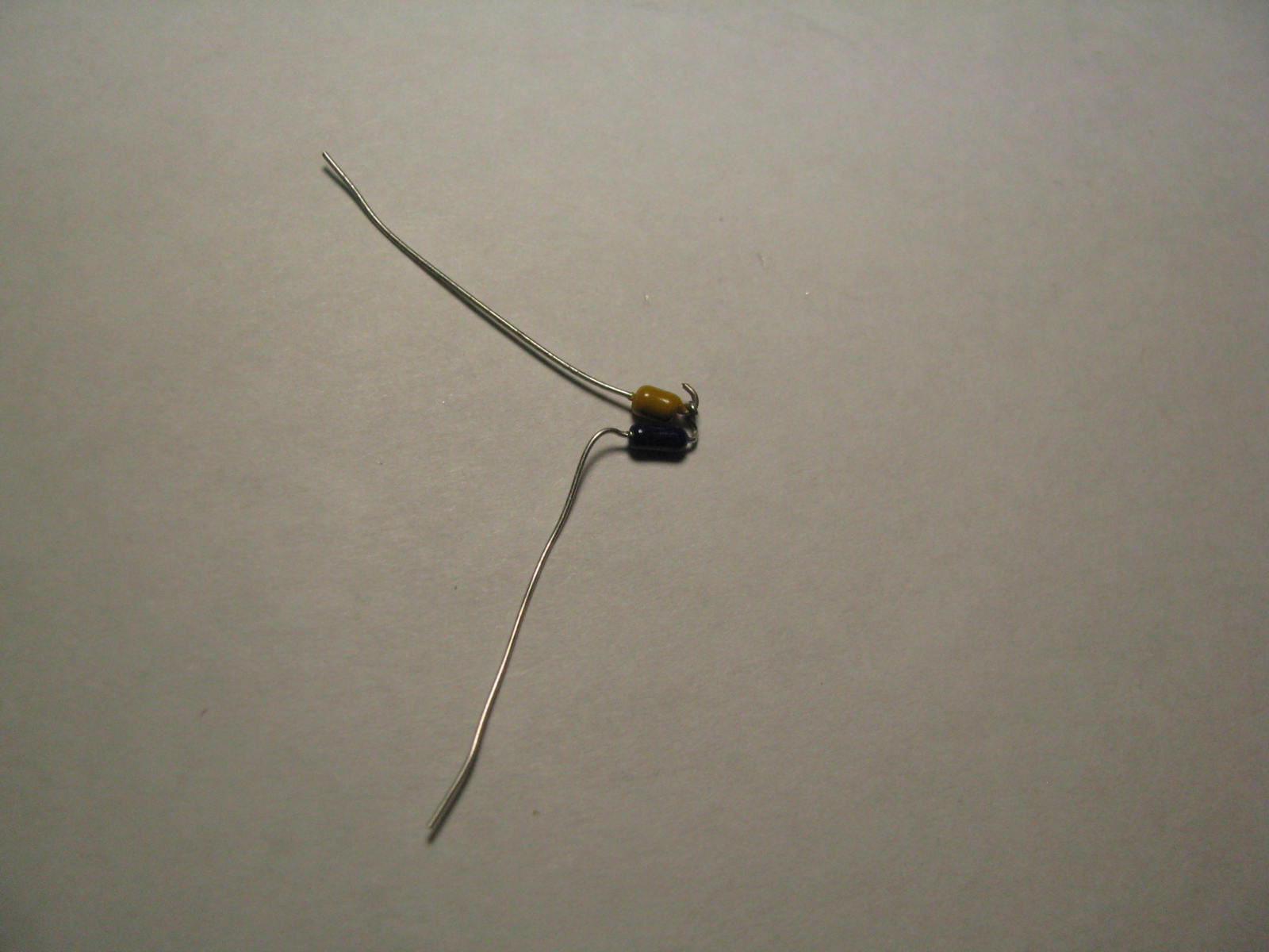

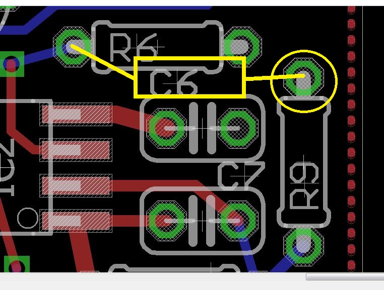

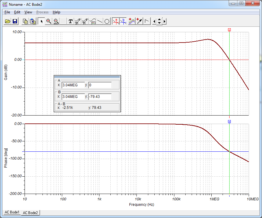

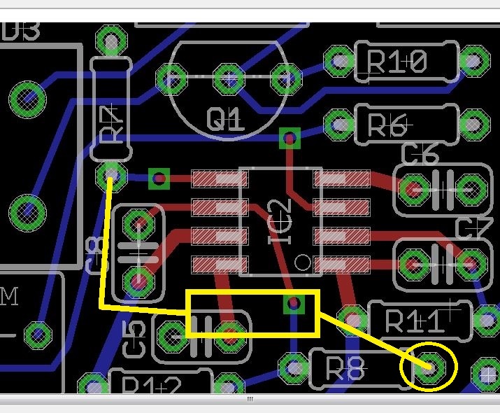

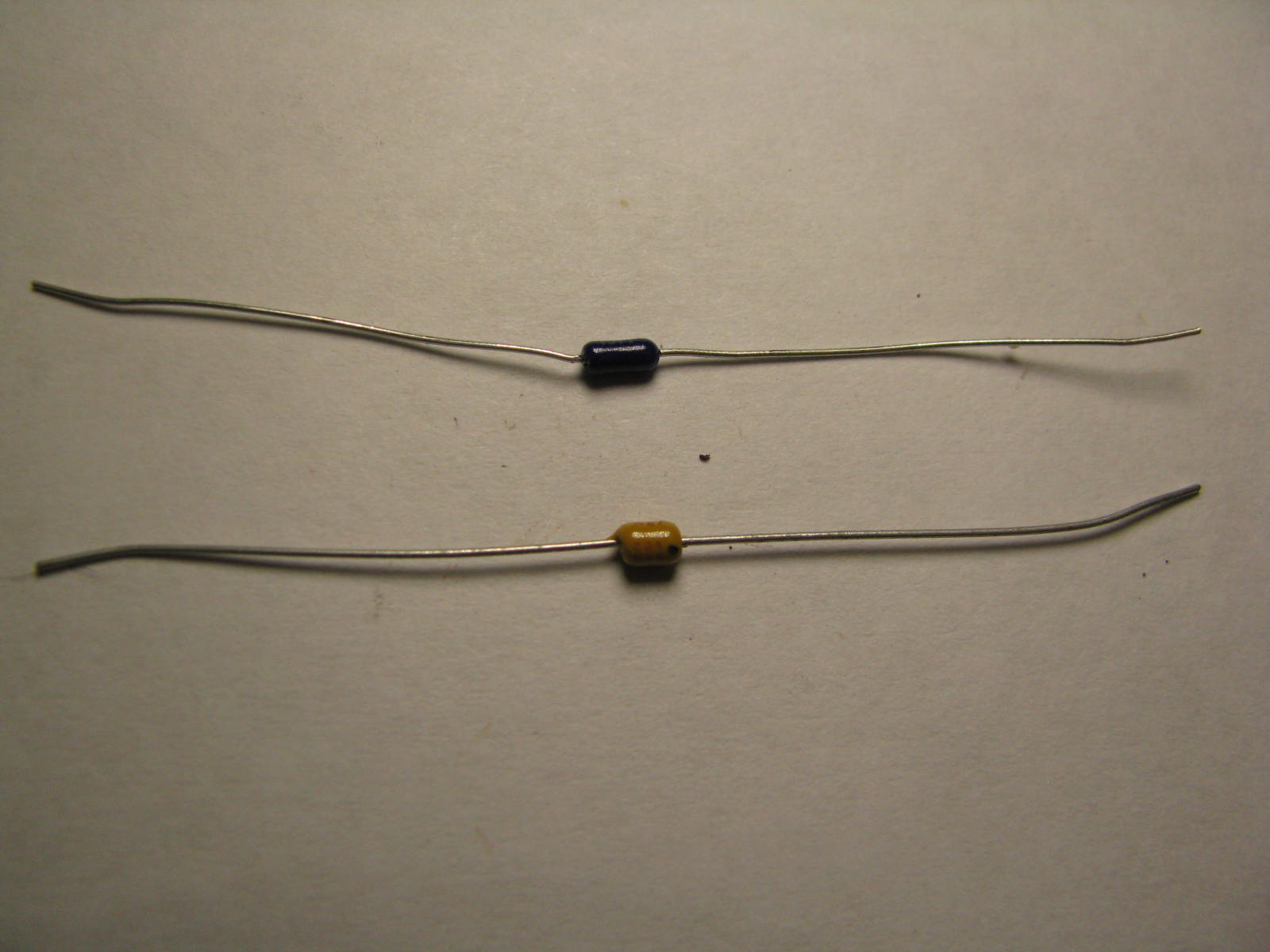

1x gain rework instructions forV4.0 boards
If you have one of the existing V4.0 Super CMOY boards and want to set it for 1x gain, here is some re-work instructions on how to add the 1nF capacitor that johnc124 calculated in a post above. Note that this is ONLY for 1x voltage gain (run as just a current buffer). If you are using any other gain, like 1.5x, 2x, 3x, 4x, etc. you don't need this. The board is fine the way it sits. This addition just increases the phase margin a bit in the specific case of 1x voltage gain. The new V4.1 boards have a place for this capacitor already on the board, but again it is only needed if you set the headamp for 1x gain.
The first photo shows the parts involved. The existing 825R resistor in for R8 and R9 on the top of the photo, plus the new 1nF (= 1000pF = 0.001uF) axial, 50V, 5% C0G MLCC cap, Mouser #581-SA105A102JAR for $0.33 each. The capacitor is about the same physical size as the 1/8W resistor.
What you will be doing is unsoldering one end of R8 and R9, pulling it out of the Super CMOY PC board, then soldering that end onto one end of the 1nF capacitor. The 2nd and 3rd photos shows a good way to do that. I typicall bend small hooks in each lead, the hook them together and cut off the excess before soldering them. For R9 the two should be soldered at a right angle like picture #2. For R8 bend the capacitor back on top of the resistor before soldering them together.
The first plot shows what to do with R9. Unsolder that top lead with the yellow circle around it by using the soldering iron tip to heat the lead why prying it up and out of the PC board. Then solder it to one end of the capacitor (that yellow rectangle in the plot) and finally the other end of the cap to the left end of R6, which is the chip non-inverting input. Just solder it right on to existing R6 lead, no need to remove that one.
R8 is similar. Unsolder the right end, solder it to a 1nF capacitor which sits on top of R8, then attach the free end of the capacitor to the bottom end shown of R7, which is the other OPA1688 non-inverting input. For that long wire run from the cap to C7 you may want to insulate it with heat shrink tubing, or just a length of insulation stripped off another wire and slid back over the capacitor lead.

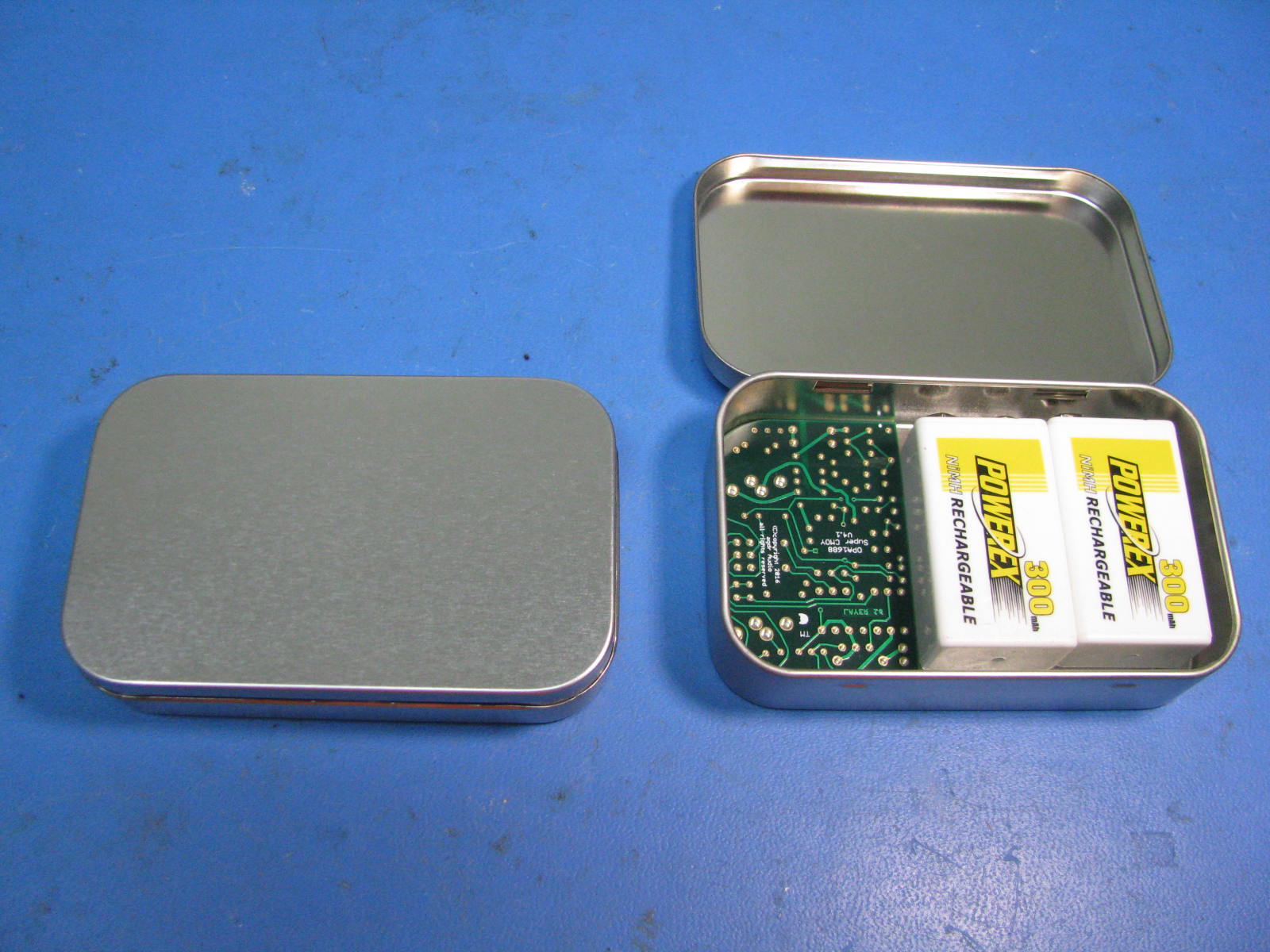

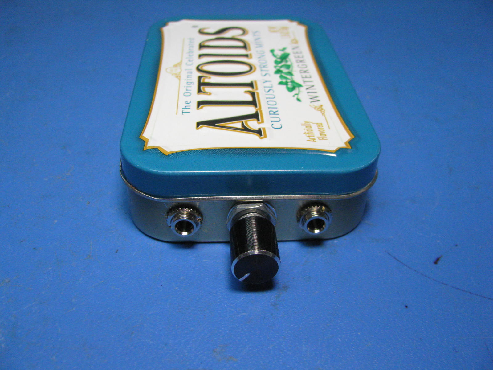

Adafruit knobs & case + V4.1 boards + my mistake on the 15R THD & -1dBV input

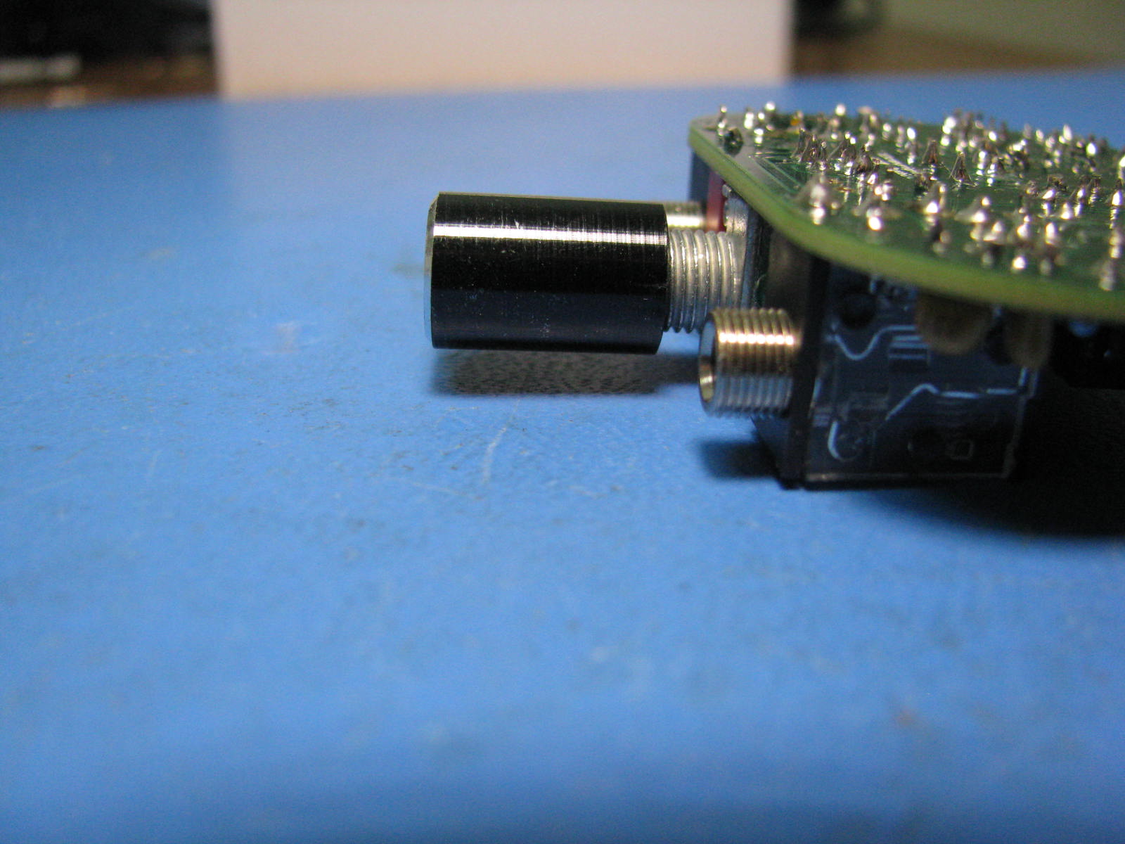

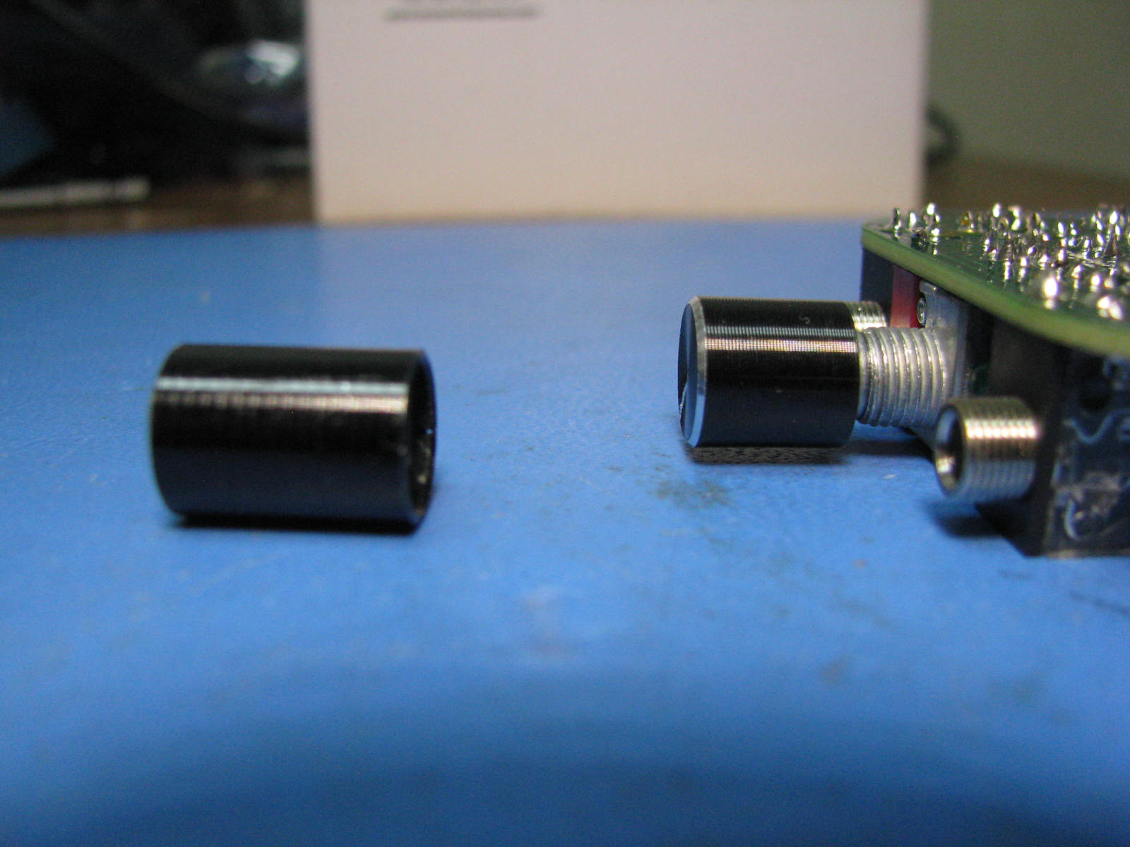

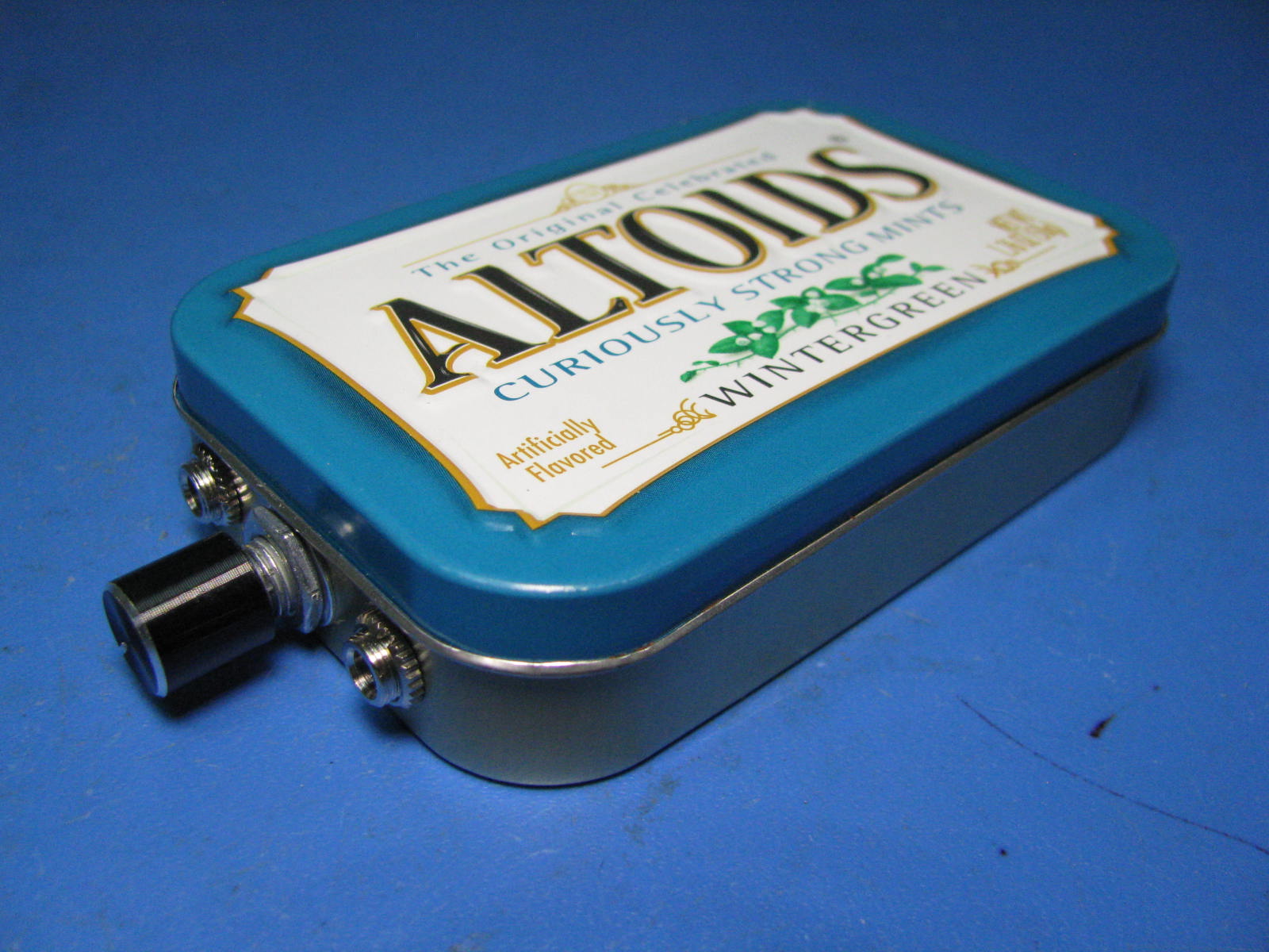

Adafruit knobs and mint tin

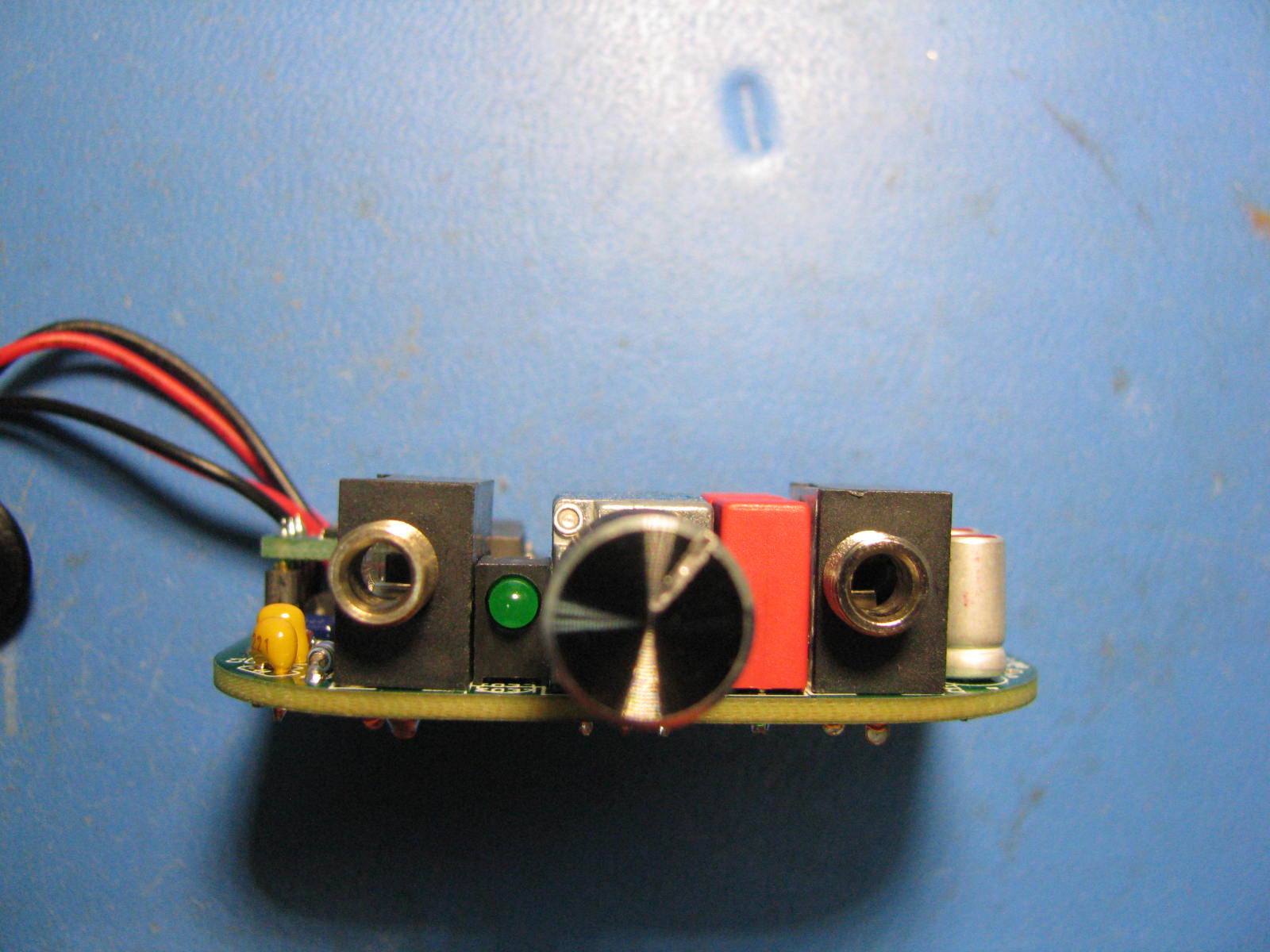

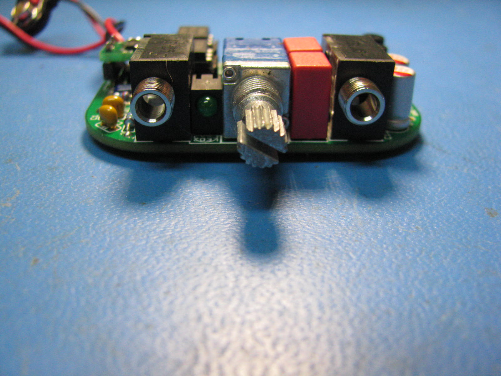

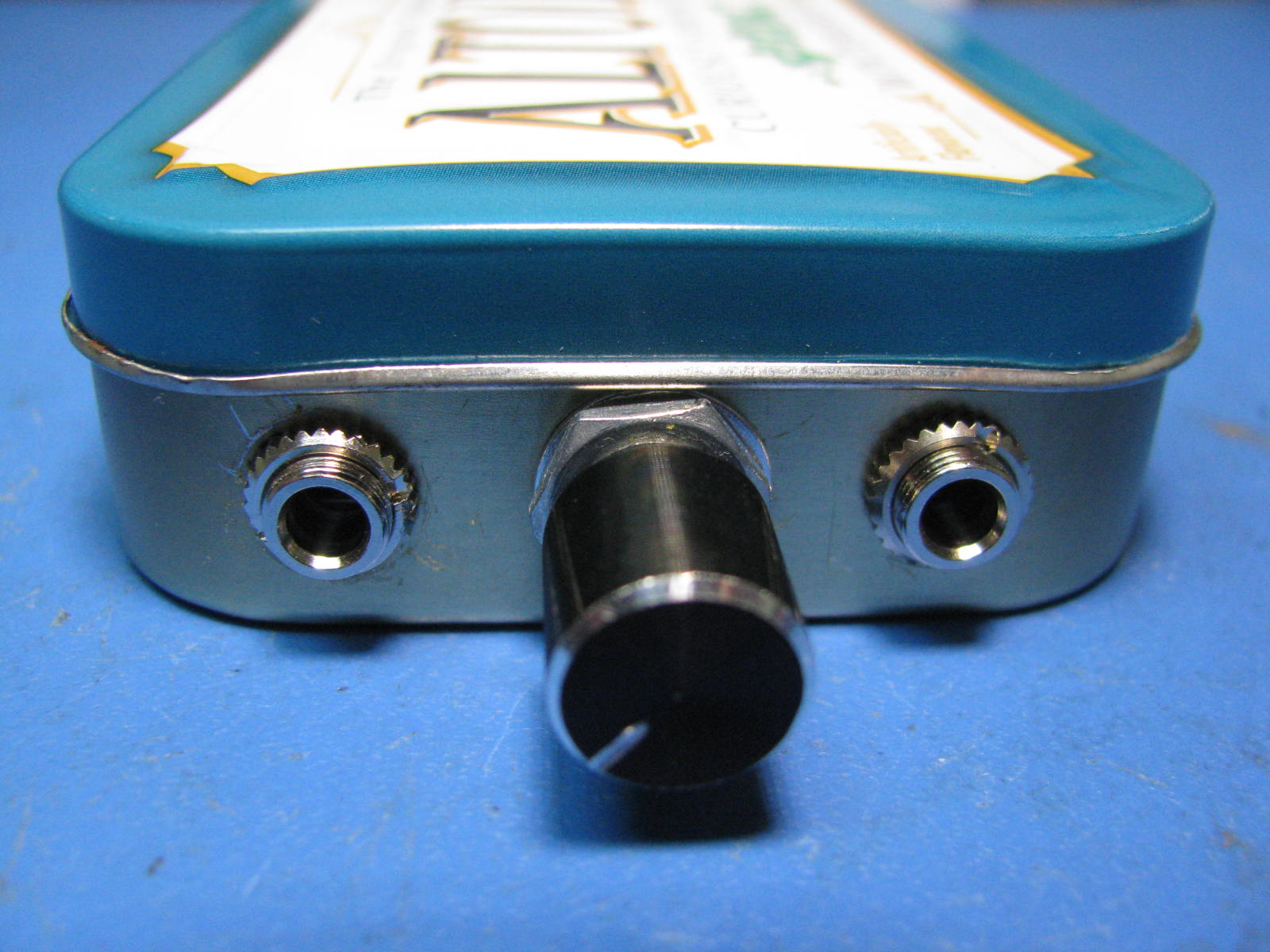

The slim knobs arrived from Adafruit and they work perfectly! I also ordered some of their "blank" mint tins to try out. Their mint tins really are the same size as the standard mint tin. Something to keep in mind for folks wanting to do their own artwork on the tin!
The first 3 photos show the new knobs, 10mm long and 15mm long, #2058 and #2057 at adafruit.com for $0.95. You can just enter those numbers right into their search box and it will come up with the parts. The diameter of the knobs is just slightly less than the width of the volume pot, which is perfect.
The next two show their blank mint tin, #97 for $2.50. Fits great!
I have some of the knobs and mint tins now I'll be adding to the sales list at my vendor thread, just at-cost.

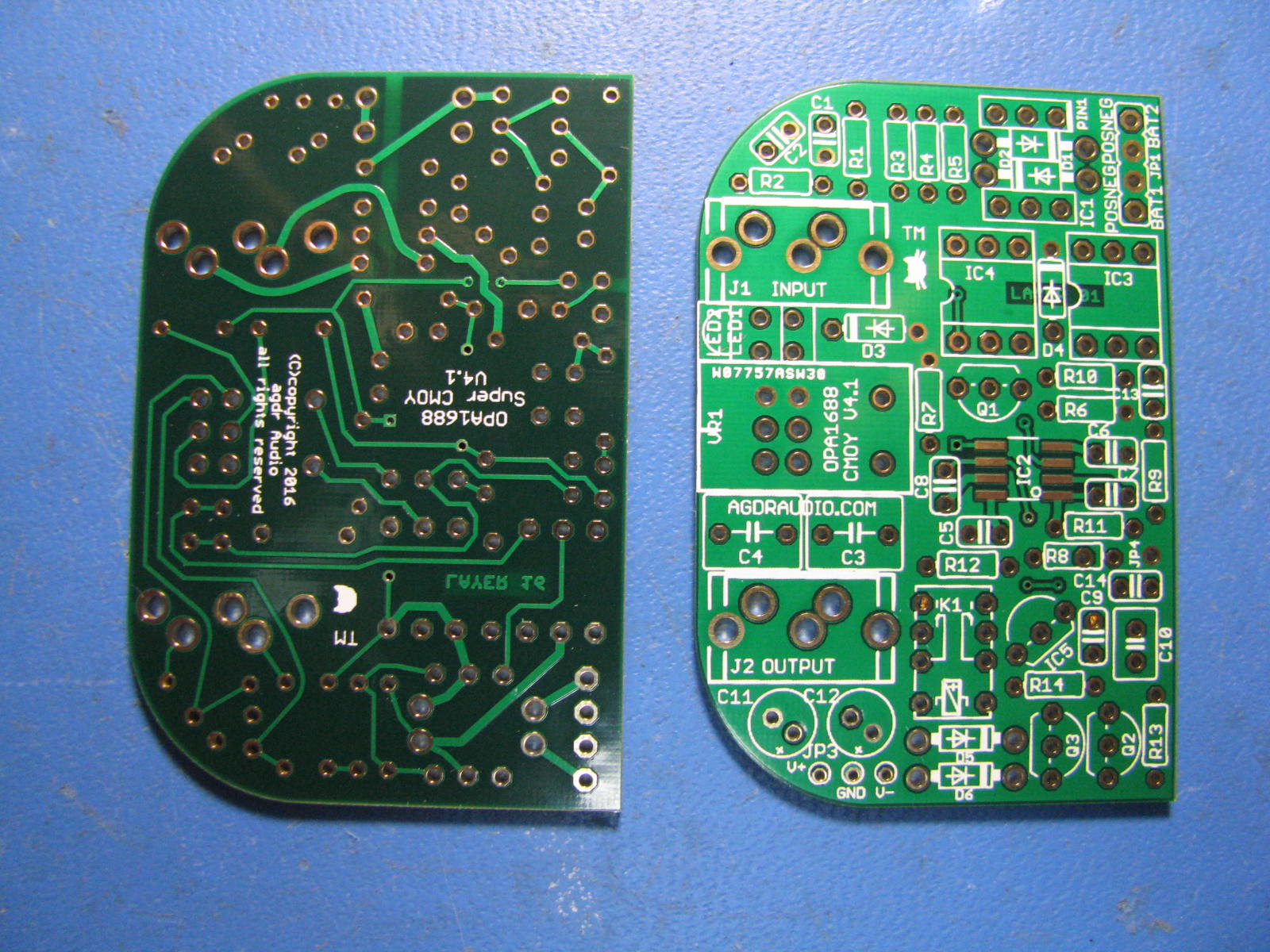

V4.1 PC boards back from fabrication
In other project news the V4.1 PC boards are back, below! I'll build one up over the weekend and make sure there are no layout errors. I'm in the process of modifying the BOM, build instructions, and other materials out at the Google Drive link to be combined V4.0 and V4.1. The only significant difference between the two board versions are the C13 and C14 capacitors that implement johnc124's fix for 1x gain, if someone wants to use 1x gain. The rest of the changes are just minor cosmetic stuff with the silk screen part markings. If you have a V4.0 board and want 1x gain, just follow the re-work intructions in a post above to easily add those two capacitors.

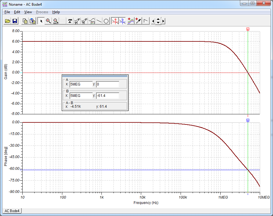

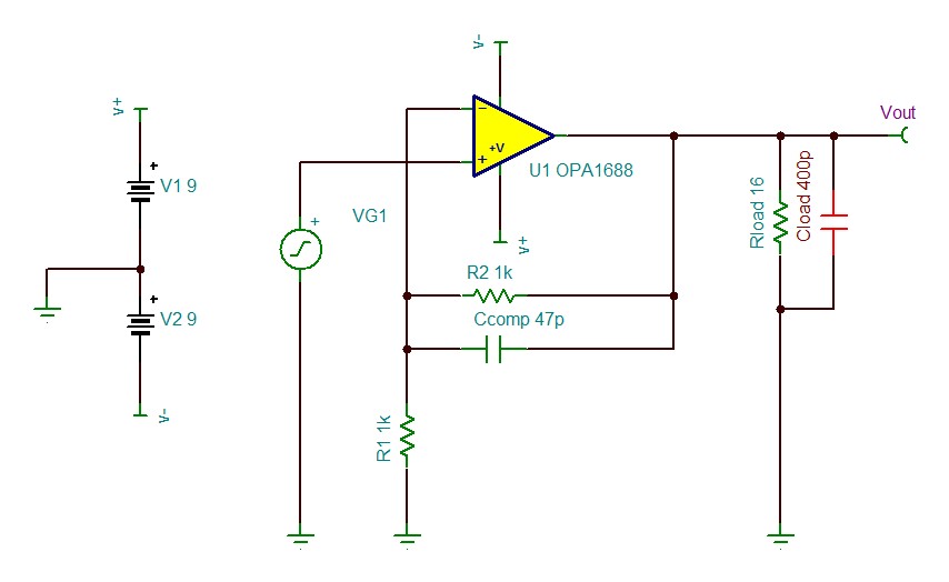

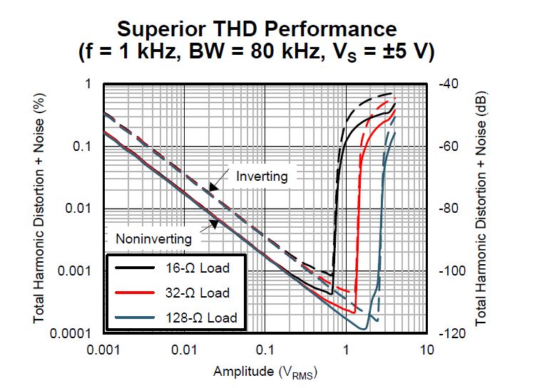

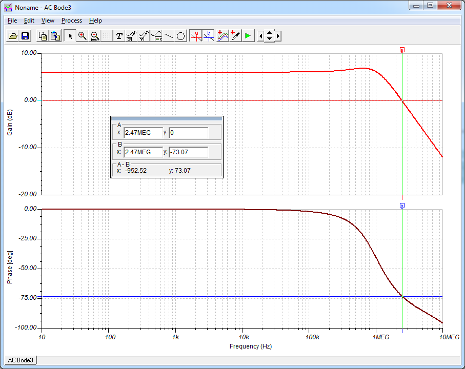

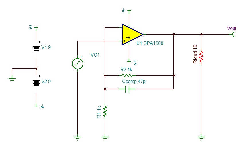

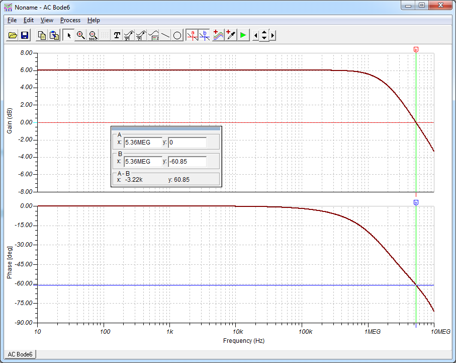

Discussion of the 15R load THD results and mistake in the -1dBV level
And finally I've figured out what went wrong with the 15R load THD measurements in post #88 above. Operator error!
First off, on the 33R and 150R load tests at -1dBV measurements I actually had the amplifer adjusted to +1dBV rather than -1dBFS, which means 1.1Vrms rather than 0.9Vrms. That shows up if you zoom in on any of those -1dBFS measurements and go up to the text at the top in the middle. The 15R load was currectly at -1dBV though.
The big problem with the 15 ohm tests is that I simply had the input level up above what the OPA1688 chip is rated for. At the 0.9Vrms input that would be 1.27V peak output. Into a 15R load that gives 1.27V/15R = 85mA, 10mA more than the maximum rated 75mA output of the OPA1688, resulting in the high level of harmonics. So the chip was doing exactly what it is supposed to do, the input level just went above max ratings. I should have limited the input in the 15R load case to 0.8Vrms = 800mVrms, 0.1mV less that what I was using, to stay under 75mA output.
From the datasheet THD curves below the "knee" of the 16R THD curve (black line), where it hits the output current maximum and shoots up, is around 0.65Vrms. But that is with +/-5Vdc power rails. The Super CMOY was running with around +/-8Vrms on the lithium polymer batteries, which will shift the maximum level of the knee up a bit to the 0.8Vrms.
The THD measurements at the 3 different loads matched up well with this datasheet curve. The curves show the 16R with higher distortion than the 32R, and that higher than the 128R. The actual results were similar for 15R, 33R, and 150R.

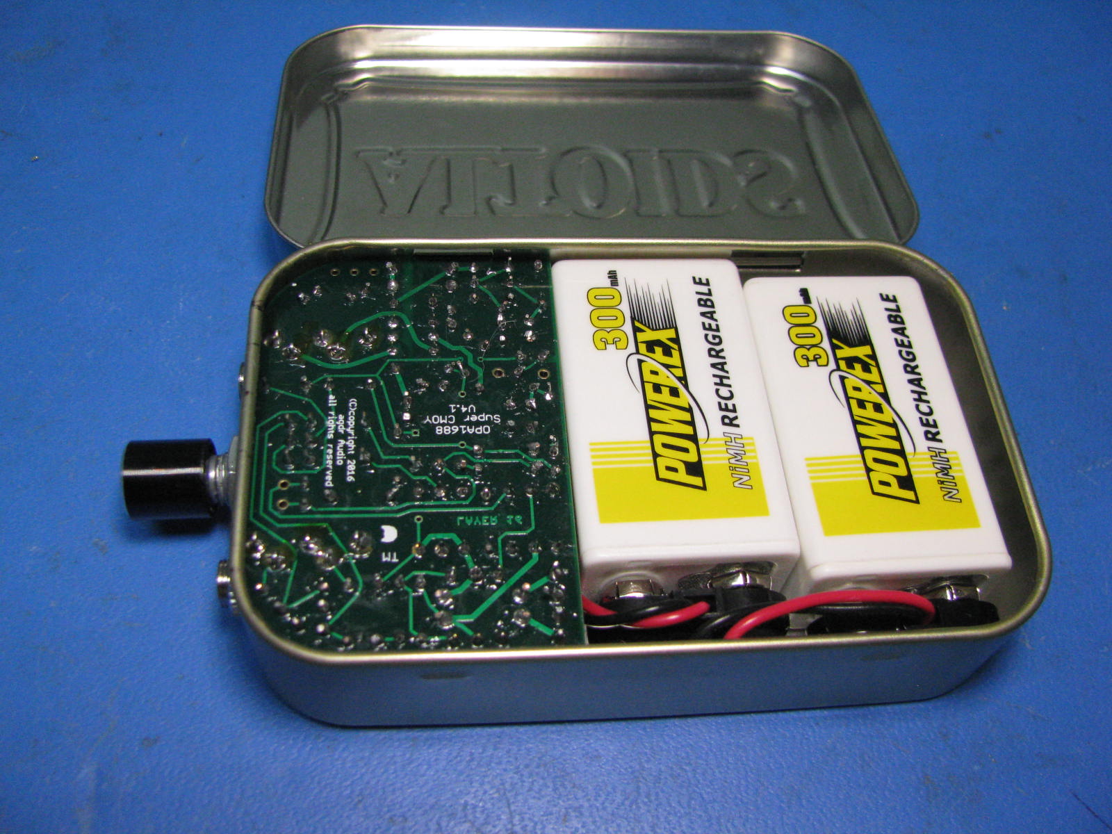

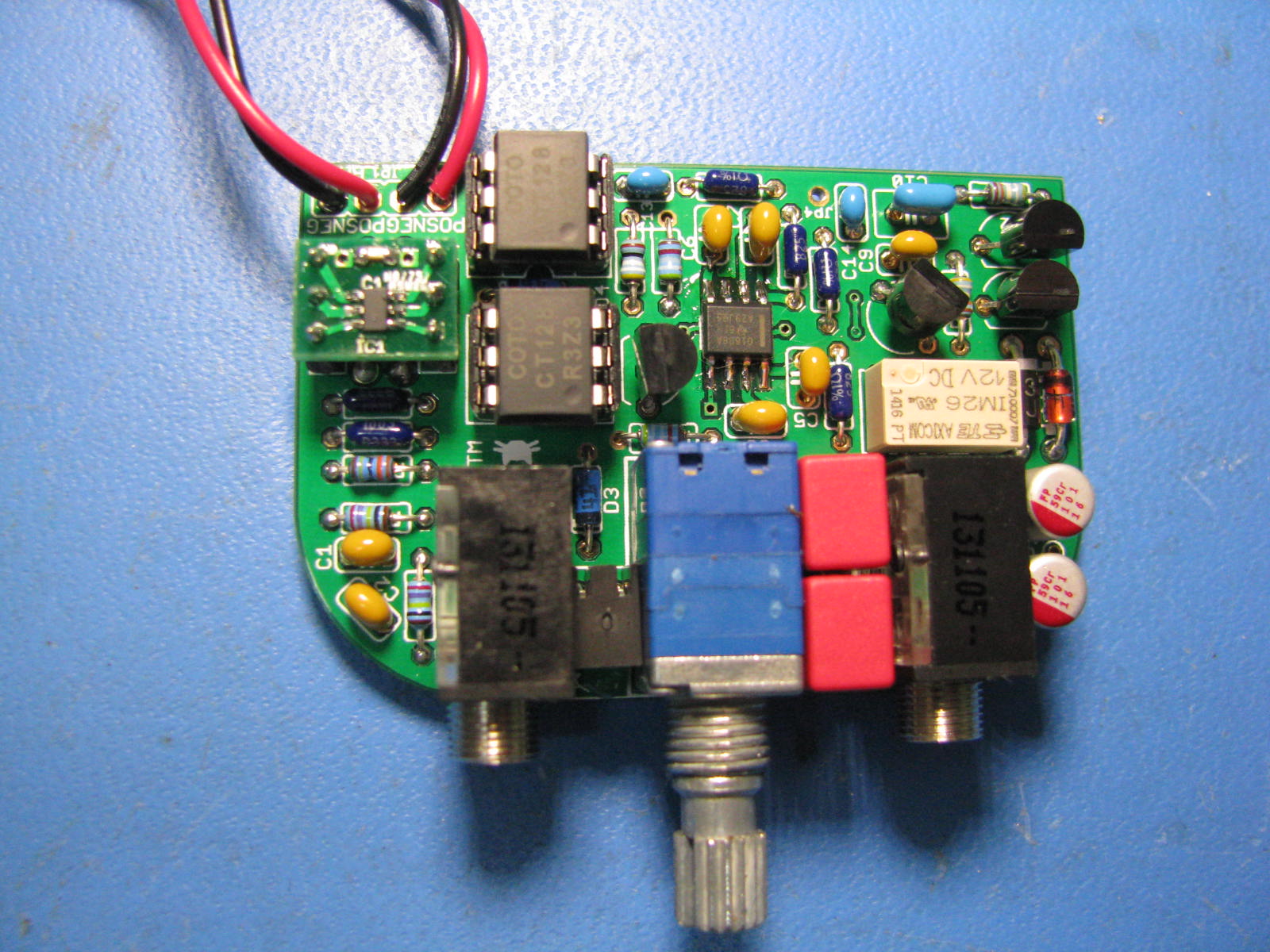

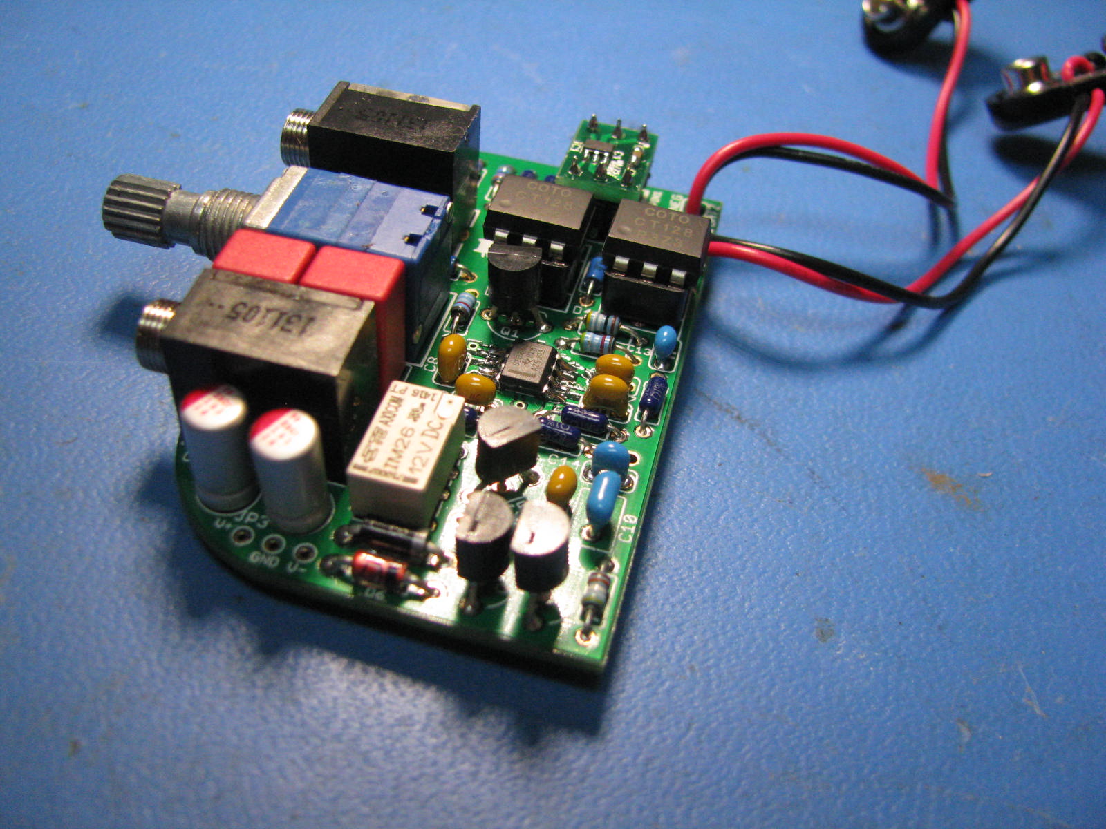

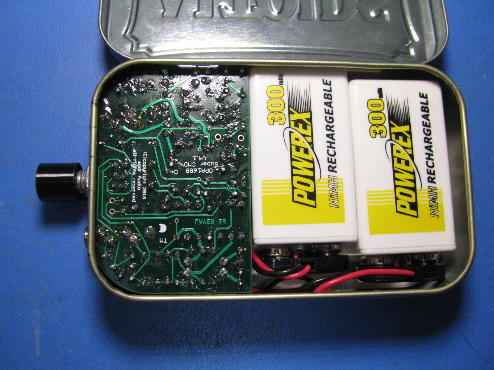

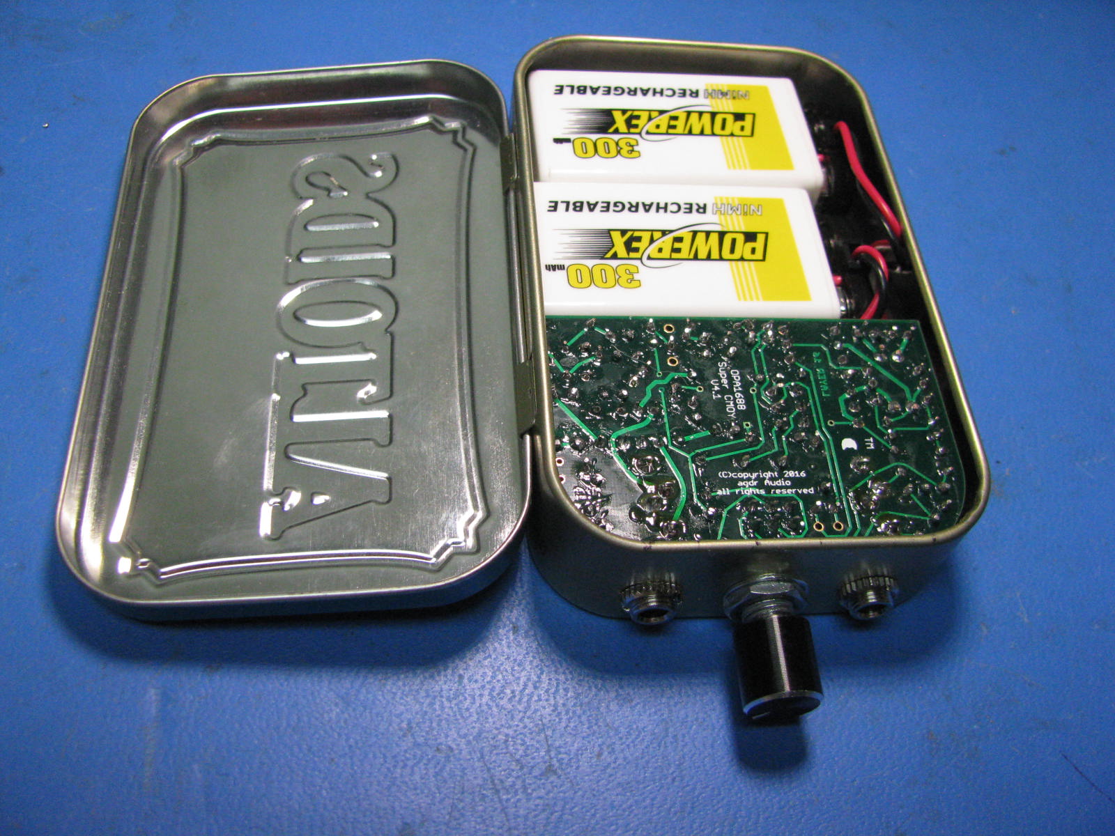

V4.1 works! Revised BOM and Build Instructions available

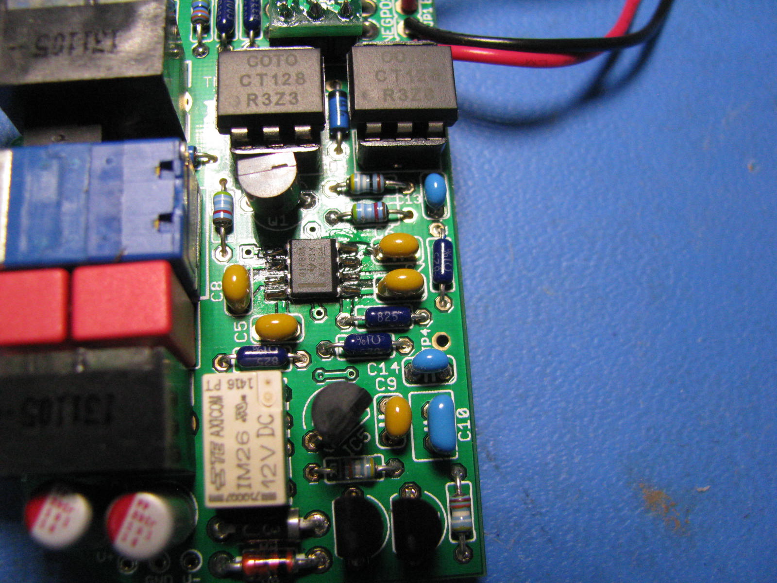

I've built up and tested a V4.1 board now. Works perfectly! I built it up with 1x voltage gain too (current buffer) using johnc124's 1nF compensation caps back to the input.
I've used the solid molded Keystone 235-M battery snaps on this one. I really like these snaps. So much easier to get on and off the batteries. I have them listed in the BOM now.
Which reminds me.. I've continued to update both the BOM and Build Instructions out at the project Google Drive link in the first post in this thread. I did a significant update to the build instructions over the weekend, lots more information in there now. I have the details included now for using - or not using if you want more than 1x gain - the 1nF compensation capacitor. I've added a section on "options" to decide on before the build, such as which battery type you plan to use (which determines the resistor set for the comparator in the BOM), which voltage gain level (determines the gain resistor set in the BOM), and the LED options.
I've added a couple of things to the BOM yesterday and today. The 2N7000 mosfets and the 12V regulator in the headphone relay circuit section are now specified with part numbers that have pre-formed leads to fit perfectly in the board holes without any bending. That just leaves the depletion mosfet in the current source as the remaining TO-92 the leads need to be bent slightly. Microchip doesn't make that part with pre-formed leads.
Remember that clicking on the arrows in the lower left of these photos will enlarge them.
