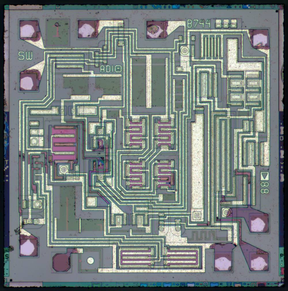

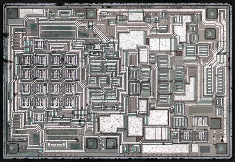

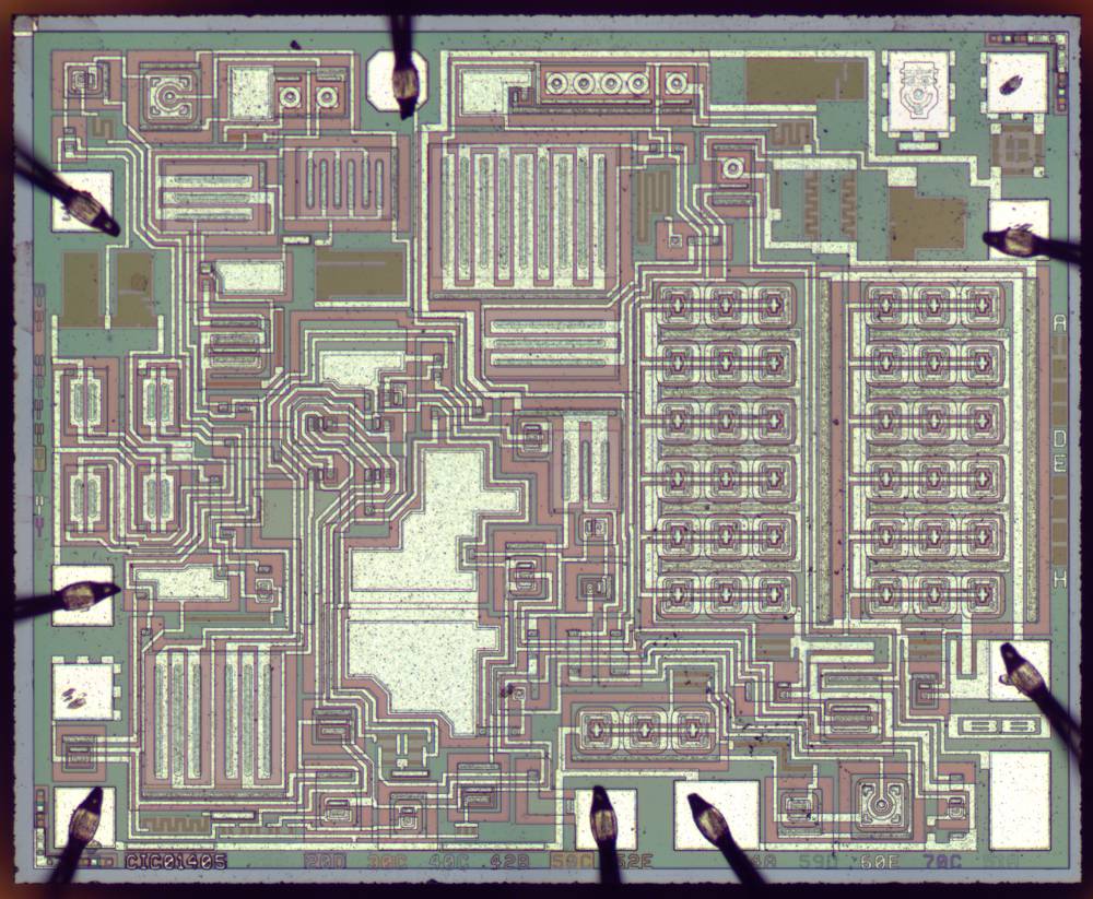

Opa627 fakes are taken from two types of crystals. Yes, they also JFET input opamps (if they wouldn't this will be very easy to check), but with a simpler in production crystals.
Say AD744, or something like ancient TL081.
They can even have trim pins and even fake makers could add needed resistances for pass this simple check.
But what's really differs such a JFET opamps from each other?
DC precision, input current/offset and widebandness!
So, it's much more easy to check.
Just wire an opamp with a gain of 10.000 times. It will have easily measurable output offset proportional to input offset/input current and easily measurable widebandness in extent of audioband.
So, just do this easy labour work and you're in.
Or just went to any good dentist office and ask to X-ray photo of chip, suppose it will have needed resolution, at least internal wire soldering points must be seen.
Original and two possible fakes are attached.

The bifet ad744 has the same resistance, is probably why they are rebadged and sold as opa627. By the way, they sound great, are probably fairly close to one another, guessing from the specs.

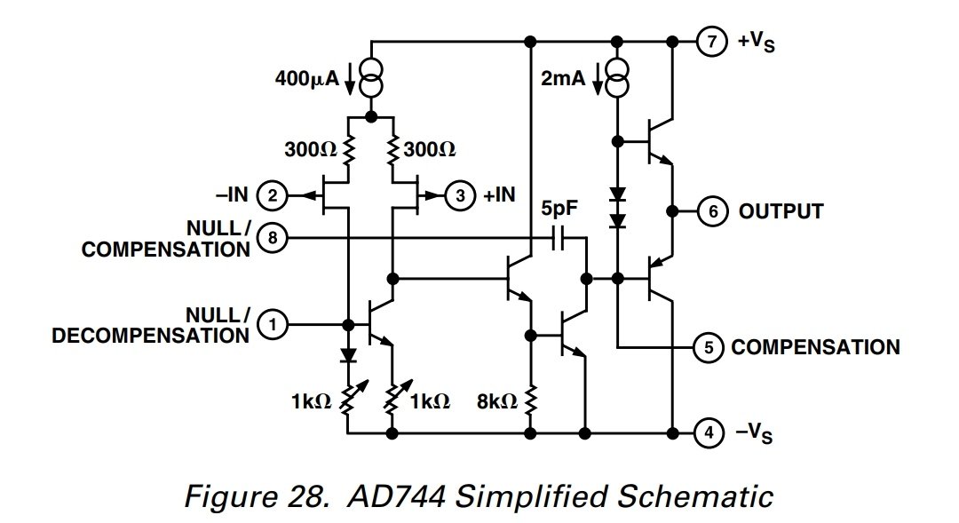

The value of resistances could be similar, however the AD744 has the trimmer connected to the negative power supply rail, hence an ohmmeter could easily tell them apart with resistances being common to the opposite power supply rails.

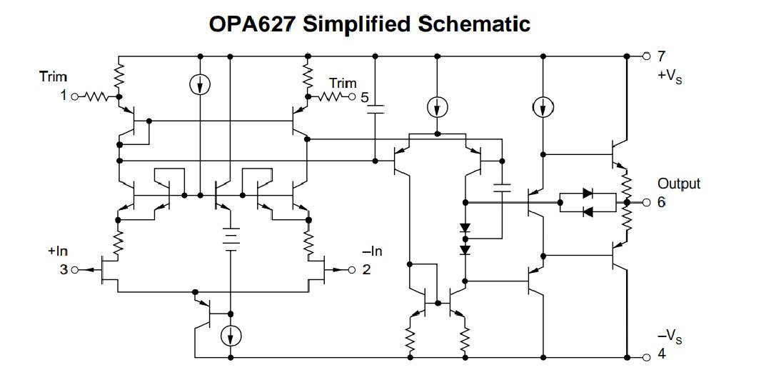

The first page of the pdf for the opa627 below shows the trimmer connections between pin 1 and pin 5 through resistors (probably equal value) to the +ve power supply. Interestingly I am currently sending a bunch back to Polida.
https://www.ti.com/lit/ds/symlink/opa627.pdf

No. They have definitely different connections for triming.
Also AD744 trimming are referenced to a negative supply while OPA627 to a positive.View attachment 997778View attachment 997779
