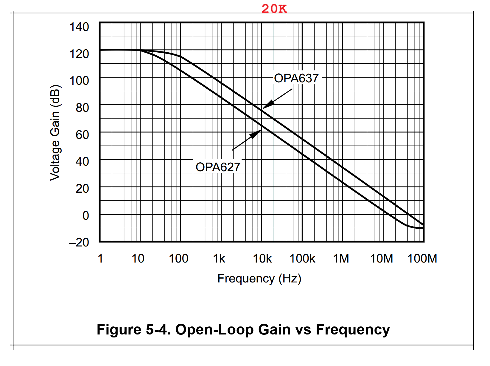

What about the OPA27. Is there an easy measurement that can be done to determine if the part is genuine?
If it's a good/useful part, it's a good/useful part; how long it has been around is not really relevant in that context.627 is an outdated opamp
Any special reason to discuss it ?
Its VERY expensive manufacturing process gave it significant advantages over other parts. Cheaper processes eventually began to shrink some of the advantage gaps. But these expensive parts are still being made and sold. So, they still have something the cheaper parts don't yet provide. I'll give you a hint that the audio world is by far NOT the biggest user of very high precision op amps ...
The OPA627 is a unity gain stable op-amp with 100dB open loop gain at 20kHz, 60dB at 1MHz. Not a bad GBP for a f***ing old device (not to be confused with the f***ing old proclivities seeming of little concern to older persons... particularly those hard of hearing).
Feeding in a small 1 MHz signal ought to get a gain of 1000x open loop, that if set up alternatively for a gain of 100 ought to result in close to achieving that amplification, as seeming doubtful for fakes to replicate easily.
I don't see that on the datasheet. Instead, what I see is 57 dB open loop gain at 20kHz and 23dB at 1MHz. A difference of ~ 40dB (100X)
