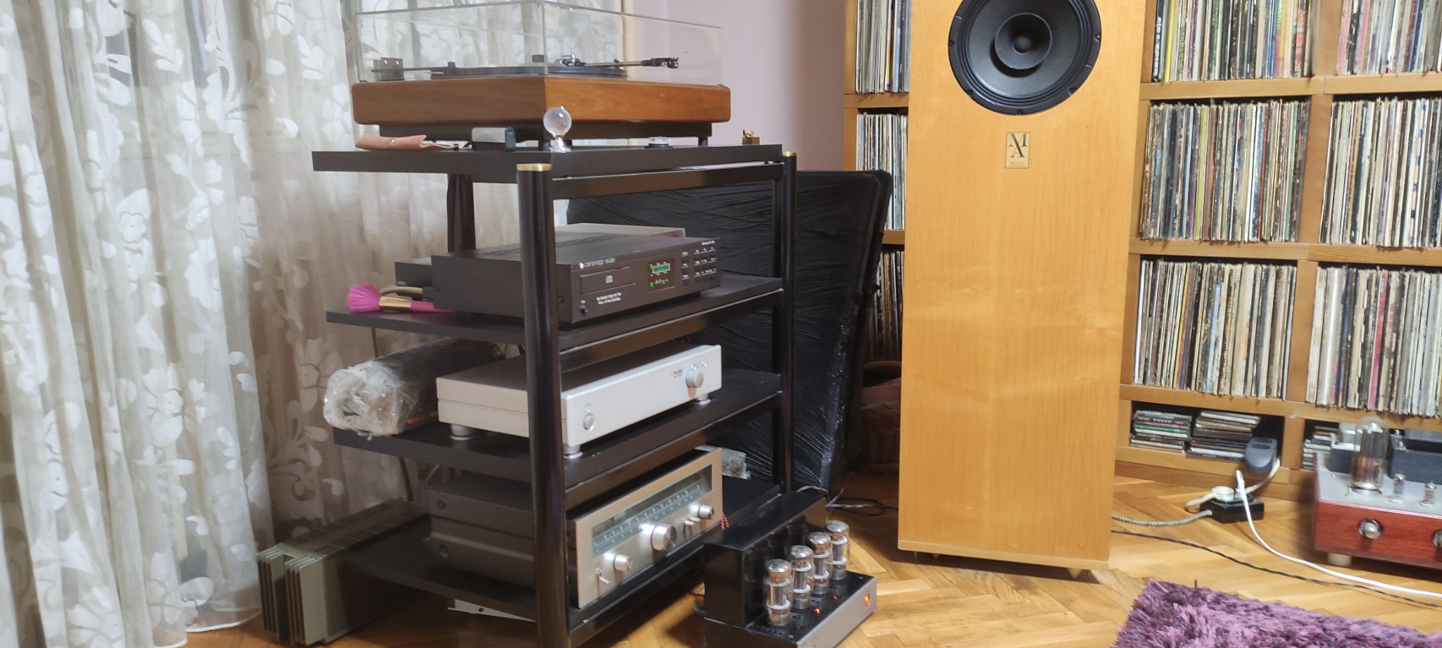

Of course, I read it. But reading theory and listening are not the same. Recently, I've been listening to a friend's Cambridge Audio CD3 as a sound source compared to a turntable.
(The CD3 features 16-bit x 16-times oversampling, a Philips CDM 1 MK II transport, four Philips TDA 1541 A DACs, and eight Signetics NE5534. It's built like a battleship.)
The setup includes:
VPI/SME M2 - 9/Grace F9/E
Sindric Pointe Analogia MK V - phono MM
Bent Audio TVC Preamp Model 102M: A passive preamp with two Stevens & Billington transformers.
Softone Model 7 Amplifier: A tube amplifier with four KT88 tubes.
Magna Acoustica Speakers: Full-range cabinets with two custom 10" Ciare PA drivers.
Whether playing the turntable or the CD player, the difference ultimately comes down to personal taste😉

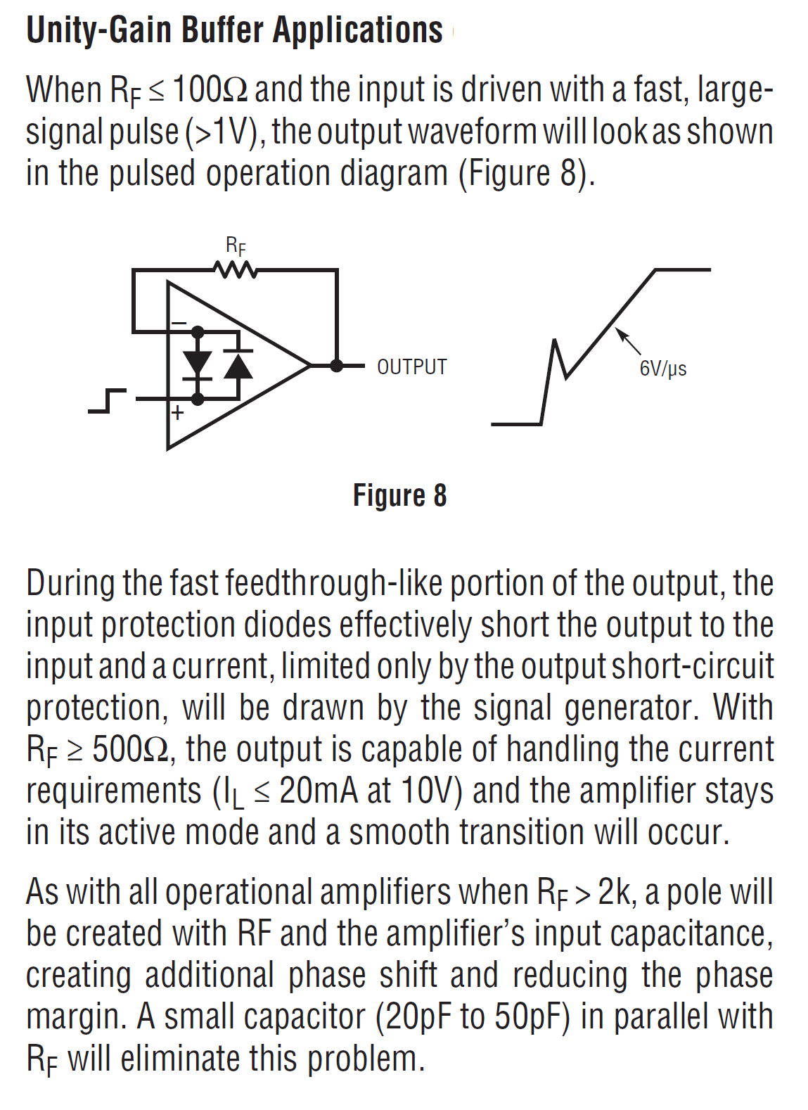

This is true in theory, however it will depend on the specific characteristics of these diodes. The junction saturation voltage is somewhat gradual and will always, at a minimum, have a partial effect on the signal. The in-circuit configuration of the op amp will determine how much actual distortion the diodes generate. The circuit's input impedance is obviously defined by the effective resistor values to ground and neg feedback loop. Bipolar op amps perform best in low impedance applications, which makes the diodes at the input less of an influence but that doesn't completely discount their influence.You will only have 0.6V across the inputs in clipping and slewing, so already distorting. Their purpose is to avoid reverse breakdown of the input transistors spoiling the noise figure permanently.
Its true in practice as the difference in voltage between the inputs in normal operation is a few mV at most and varies even less (a few microvolts typically). No Si pn junction does anything at these low levels but behave like a small linear capacitance. And its a differential capacitance at that. You can safely assume the noise protection diodes do not degrade circuit function in any measurable way other than the capacitance increase. They are essential to the guaranteed noise performance of the devices (which is very measurable).
Linear Technology opamp datasheets carry a warning: these input protection diodes interfere with slewing (as mentioned by @davidsrsb in post 164 above).
_
_
If you are massively slew-limited like this, you are already heavily distorting - this is nothing to do with linear audio use.
Slewing can be a component of settling time, which is an important opamp spec in a D-to-A application.

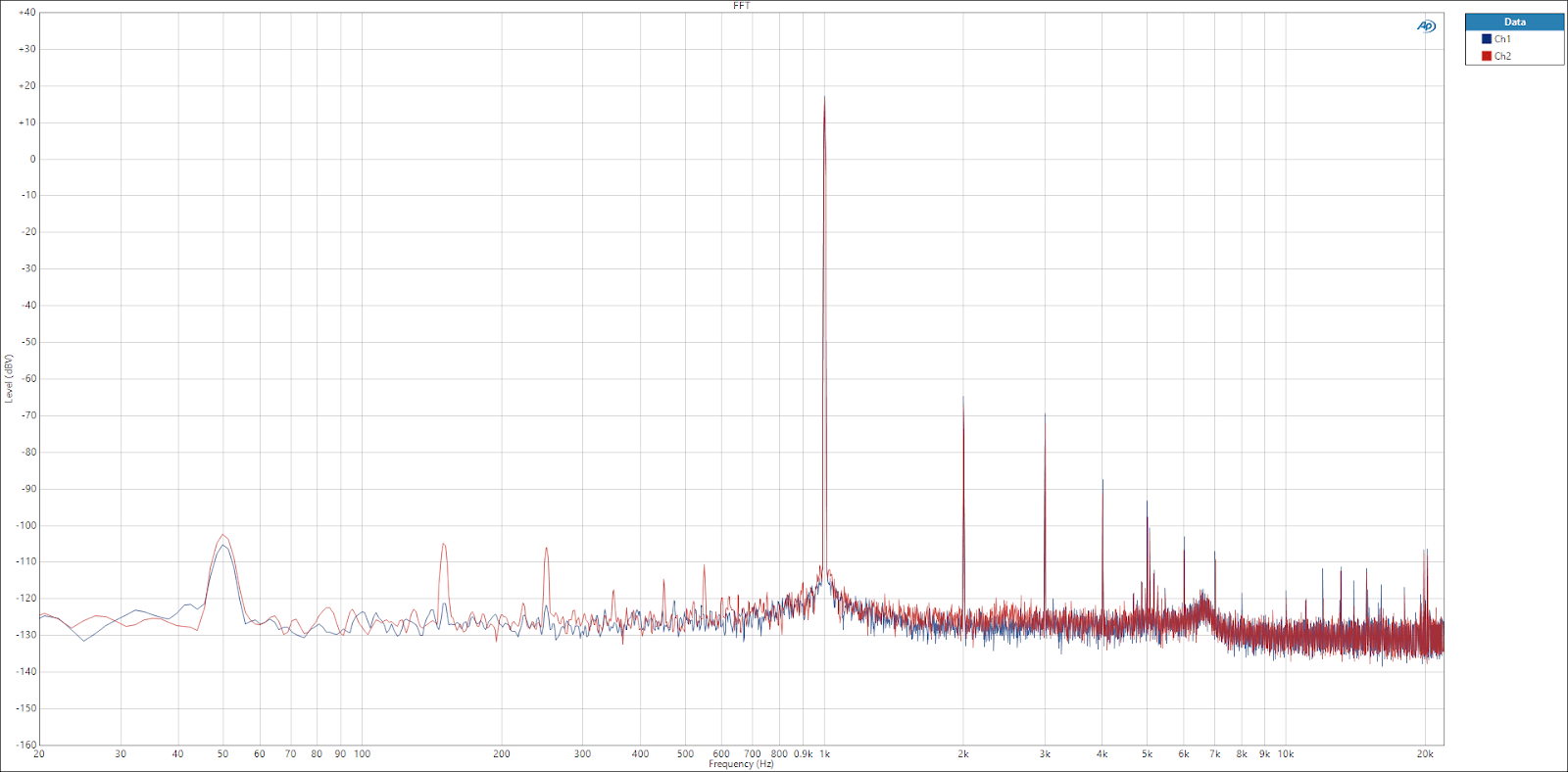

User @Martigane tested Burson op amps in his Whammy in 2020 and provided some useful measurements. In particular, check out the harmonic distortion profile of the Burson V6 Vivid:
Here: https://martigane.blogspot.com/2020/02/objective-benchmark-part-1-op-amps.html
This looks similar to the distortions in many of Nelson Pass’s JFET circuits. I am assuming that most people on this forum are familiar with his amplifiers. In particular the SIT amplifiers and the H2 buffers feature 2nd and 3rd order harmonics as a major feature in the sound of the amplifier. I ran tube amplifiers in my home for a long time, including a JE Labs 2a3 stage, and felt that they often threw huge sound stages. Perhaps the Bursons will nudge my rig in that direction.
