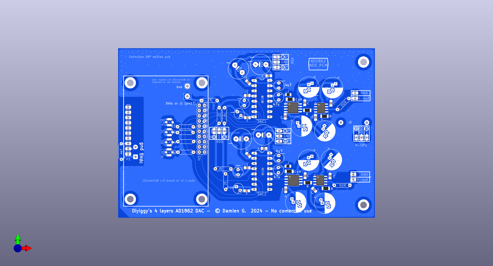

Is there any real advantage to using single opamp in the DAC output stage?
Sometimes PCB layout is simpler with single OP.
No other advantages seen. Channel separation is not an issue, it is more than enough with dual ones.
