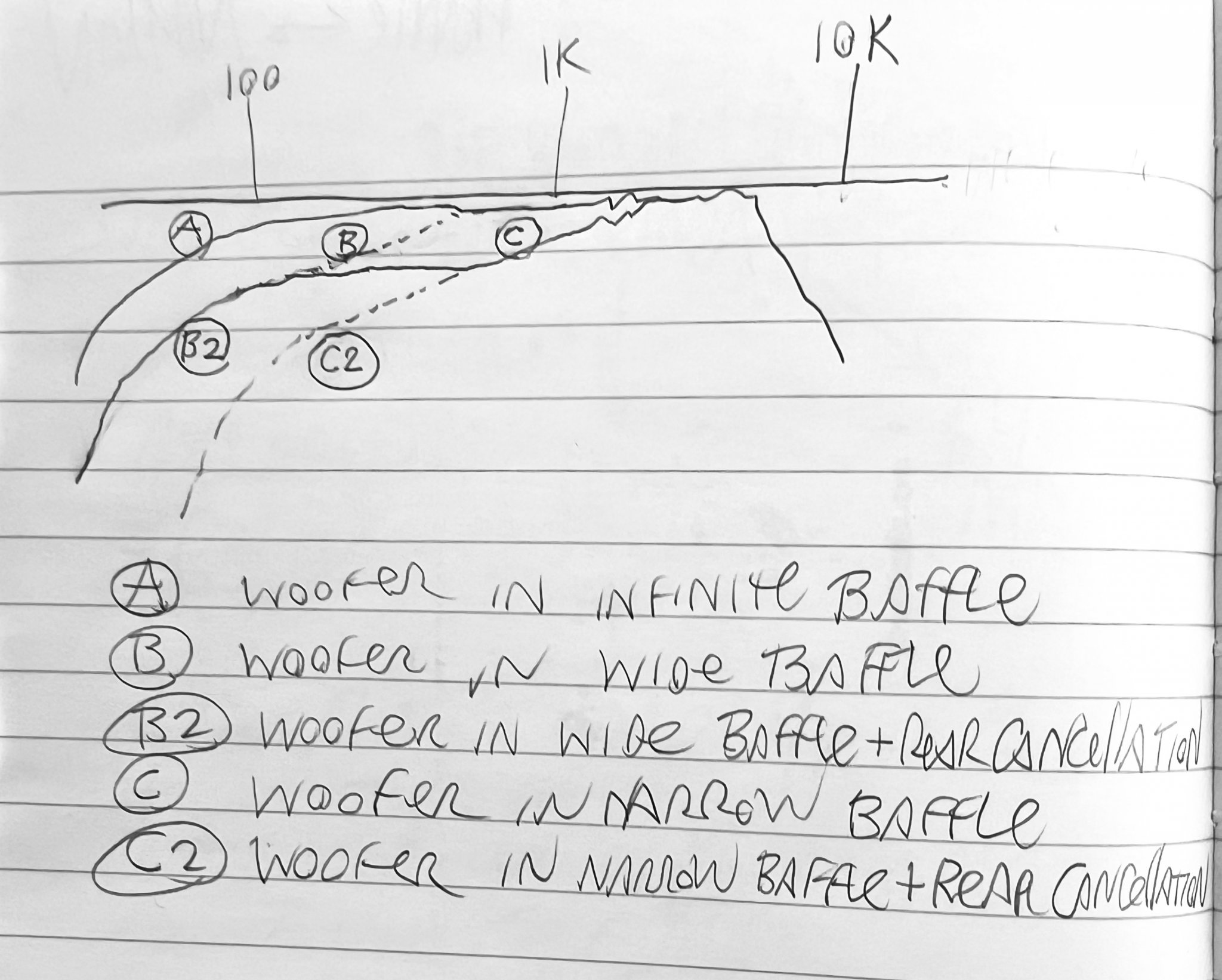

Close to the rear wall is not the end of the world, but it affects all frequencies that are emitted from the back side. All my dipole designs have rear firing tweeters.
It does help that below 150hz the Flanagangsters are no longer dipoles but monopoles. I think a rear wall that close in a pure dipole only works against you.

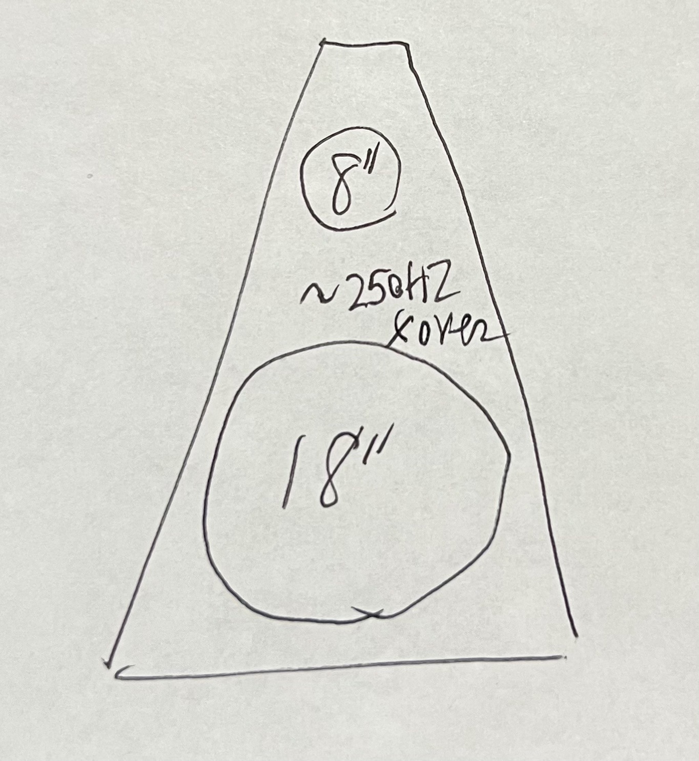

@perrymarshall How feasible is this project replacing the lower PA310 with a BMS 12S330? I mean especially from the series crossover point of view, but maybe other considerations too.
Thanks,
Sergiu
Thanks,
Sergiu
