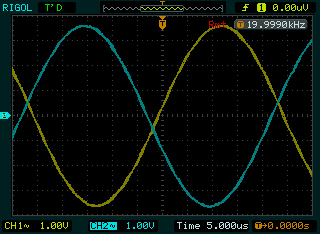

You can use a 12 Bit ADC and look at full scale signals. The issues are obvious enough.
Attached an output waveform from a NS DAC I'm considering buying. Obvious even with the 8 bit ADC in the 'scope that its not a pure sinewave. Yet I take the roughness to be out of band noise. Are you saying that 'instantaneous distortion' is not out of band noise by another name?
Hmm, so, if we call it "out of band noise" it stops being distortion. Clever.
Maybe I stop including > 20KHz harmonics in amplifer THD measurements because they are "out of band noise" so that my class AB amplifiers no longer show a rise in THD with rising frequency. 😀
Forgive me, but I personally prefer to characterise digital systems in the way I do with analogue ones. In which case we have a bad case of noise modulation or maybe LFD's much vaunted "fuzzy distortion" at our hands (and yes, I understand that this is how DS works inherently 😱).
But of course it can be made inaudible by calling it "OOBN" instead of "Distortion"... 😛
Or maybe not.
Ciao T
PS, if you can see this fuzz with a 12-Bit ADC it means it's pretty bad, no? Definitely not the kind of THD claimed in the datasheet (of course, the Datasheet specifies that THD is measures with a high order 20KHz lowpass, somewhere in small print few people read.
You might also want to try the comb filtered noise, just for fun.
Or maybe not.
Ciao T
No rocket science there - it parallels the traditional 'THD+N' figure. Distortion is signal-related error and noise is all the rest. Are you thinking there's a good opportunity for marketing ** here?
Hate to break it to you, but it'll still show up if you include a THD vs freq plot for your babies. As in some opamp datasheets I've seen - the distortion rises to around 7kHz, then starts to fall. An indication they're using the AP's 22kHz low pass filter😀
I see no reason to change the rules for digital when compared to analog either. So in your stereo FM tuner, you include any 38kHz carrier feed-through in the figures? Its only noise modulation if its signal dependent. Otherwise its just plain old noise. I agree that noise modulation is probably the elephant in the room where digital systems are concerned. Rich Cabot proposed a test way back in the 90's, Stereophile used it for a while and found it was a fairly hopeless test as almost everything passed with glowing colours. So they stopped testing for it. But I think there's a need for a good noise modulation test in digital systems.
Or maybe not.
Its a good question. I'm reminded of Douglas Adam's 'SEP' - in the rather conservative world of hifi, it becomes the pre-amplifier (or power amp, or speaker) designer's problem. That's one reason I'm a systems designer, not a component designer - must remember to update my sig😛
I included the pic to demonstrate that your 12 bit ADC is by no means necessary to see it. That scope uses a mere 8 bit ADC, not too invisible is it?
I don't have the equipment myself. What did you find when you did it?
