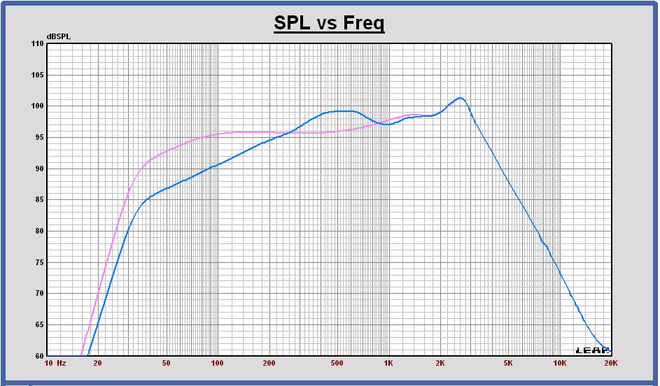

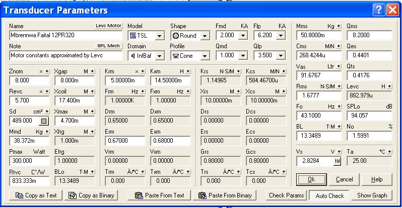

I have following proposal (just to finalize some parameters for the prototype).
Basreflex system, driver = Faital 12PR320 Matthias measurement, VB = 75 L, FB = 35 Hz (port area = 162 cm2, port length = 31 cm).
Then F3 = 49.5 Hz and F6 = 35 Hz.

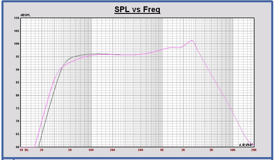

In first plot, Faital 12PR320 in cabinet, infinite baffle response in pink color, full space response in blue.
Adding X-over, the minimum impedance becomes 4.75 Ohm, first check (taken 0.2 Ohm for serial resistance of X-over coils).
Choosing for a more Butterworth B4 response, the minimum impedance will become lower.
For Kaffimann: netto internal cabinet dimensions B x H x D = (32,4 x 61,5 x 37,6) cm; port area = 162 cm2, port length is 31 cm. TSP parameters of Matthias' Faital in attach.
In second plot, the B4 version in grey color to compare with the proposal, both on infinite baffle.
A B4 version is tuned at 43 Hz, port length is 20 cm.
You can see the B4 has less low frequency extension (as Kaffimann told us already 1000 times

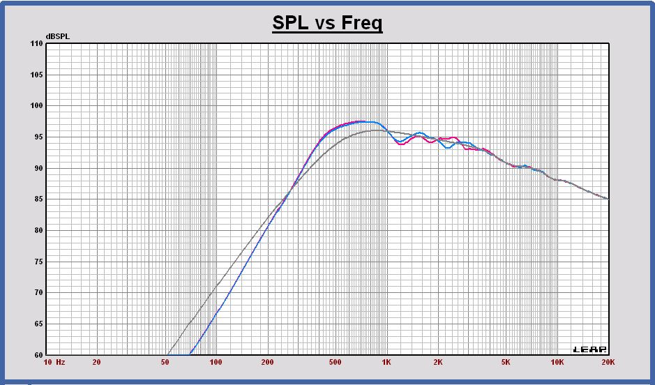

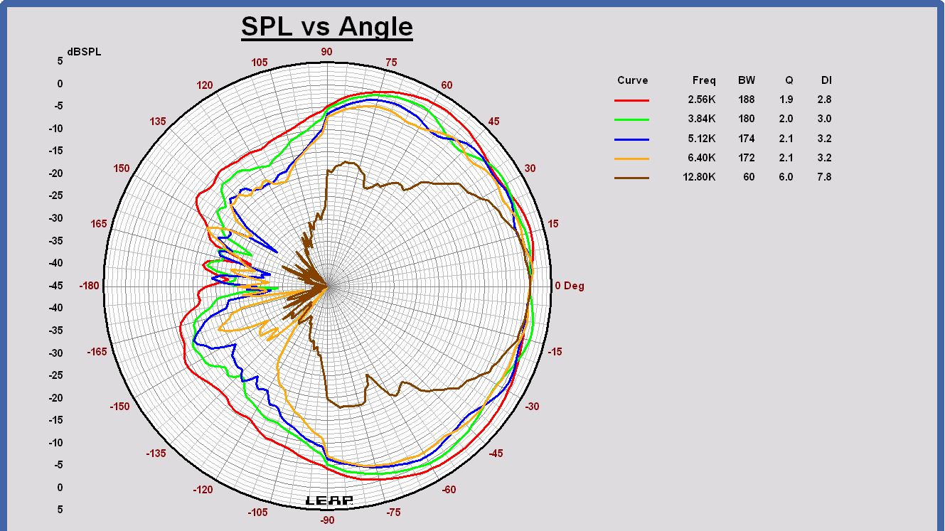

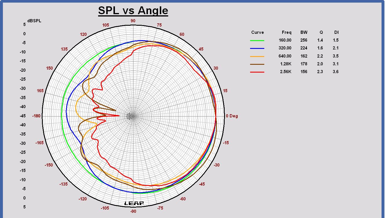

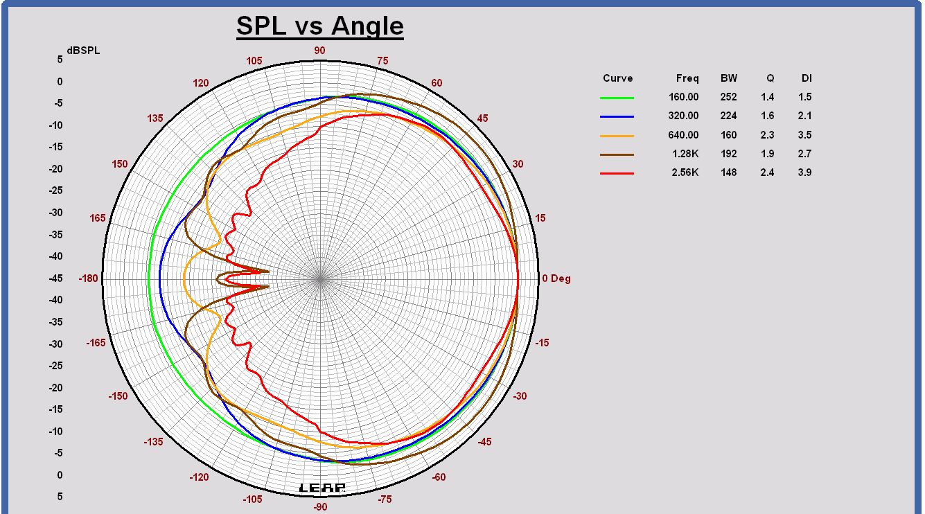

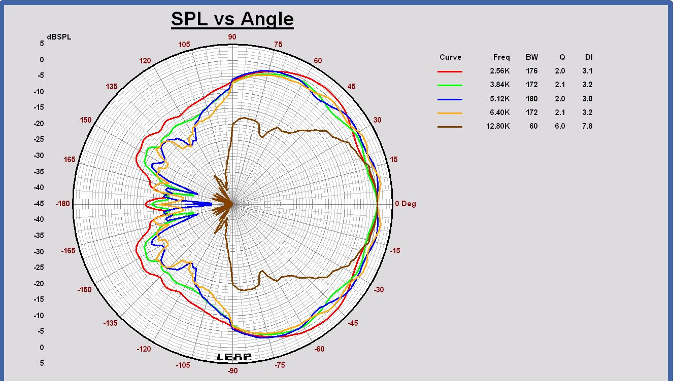

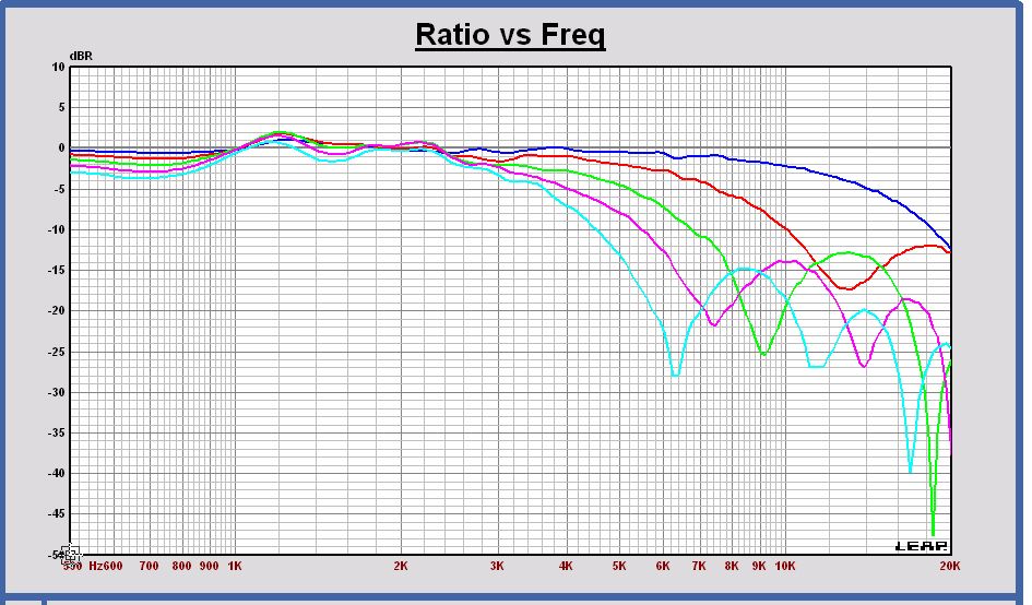

Some simulations plots to show the difference between an asymmetric versus a symmetric horizontal position of the drivers on the front baffle.
For the tweeter, SPL is better on axis, but a little worse horizontal polar.
For the midrange, SPL is the same on axis, but it is better horizontal polar.
In attach some plots.
SPL plots on infinite baffle (grey), asymmetric position (blue), symmetric position (red) for tweeter and midrange .
Polar plots tweeter 2.5 - 12 kHz asymmetric and symmetric position.
Polar plots midrange 160 – 2500 Hz asymmetric and symmetric position.

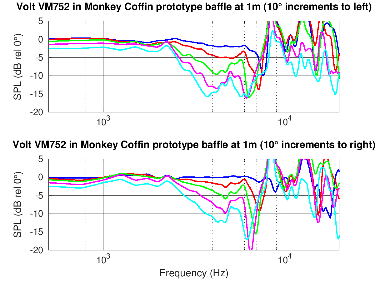

I am curious about the Volt driver measurements.
I got the drivers. Had to carry a 20 kg parcel that was falling apart from the post office to my home.
Anyway, here are the first measurement of the Volt VM752 on the prototype baffle from post 271. I don't have an IEC baffle, and my workshop is a mess. This means there was not a lot of space to make a clean measurement that was absolutely free of echoes, but it should be good enough to show the dispersion trends. At first sight, the results seem to be roughly consistent with Pauls simulations.
BTW.: the Volt VM752 are built like a tank. The ATC SM75-150 is already quite something, but the build quality of the Volts is even higher!

Great !! I did simulate now in the Monkey cabinet with the last front baffle, to the right with 10 deg steps also. Indeed very simular with your first measurements.
I had expected more impact of the waveguide. In your measurement there will be probably some extra diffractions of the front baffle.

Hi Kaffimann, yes group delay, of course, very very important, how could I forget to tell
The resonances around 2.3 kHz, also visible in the simulation, are baffle diffractions. The simulated responses are normalized to the on axis response.

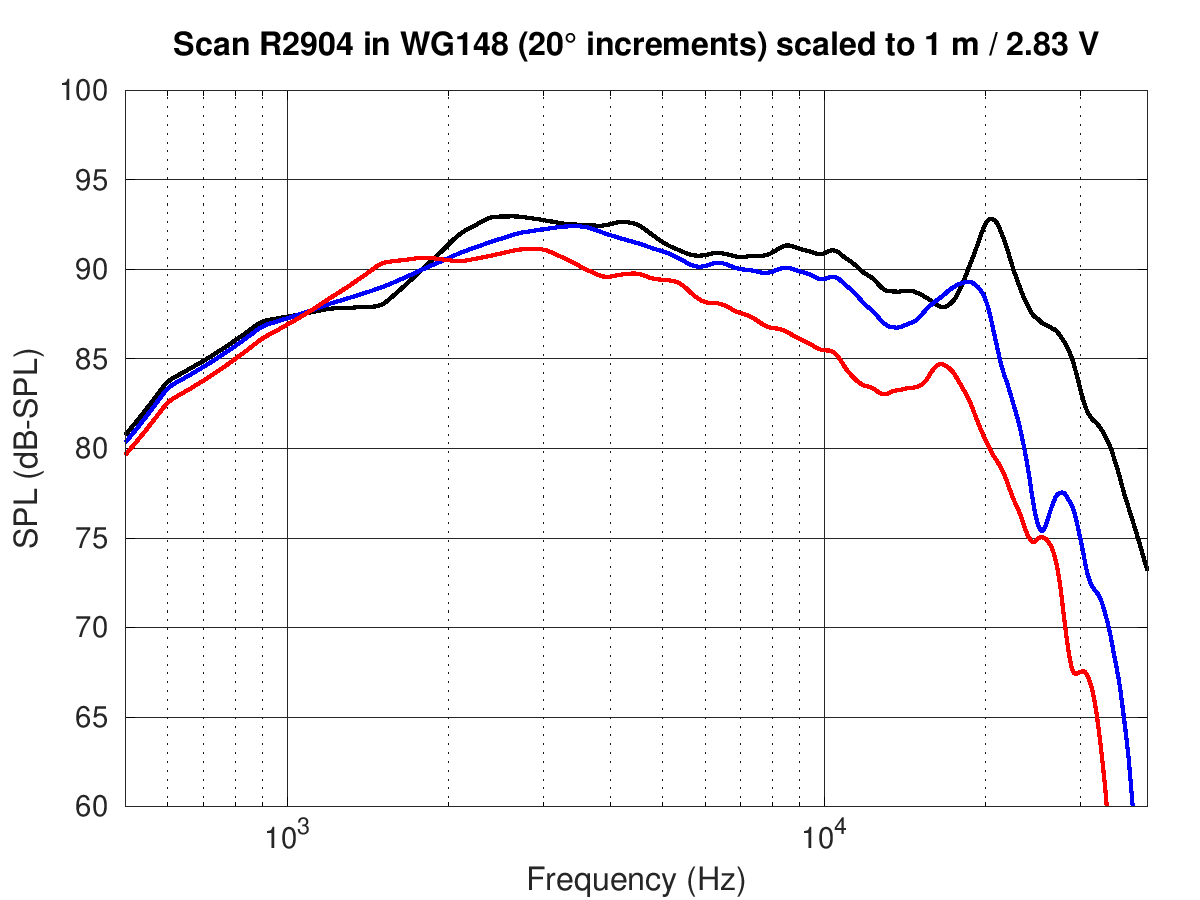

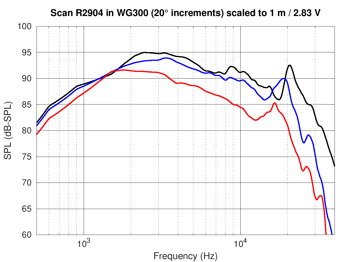

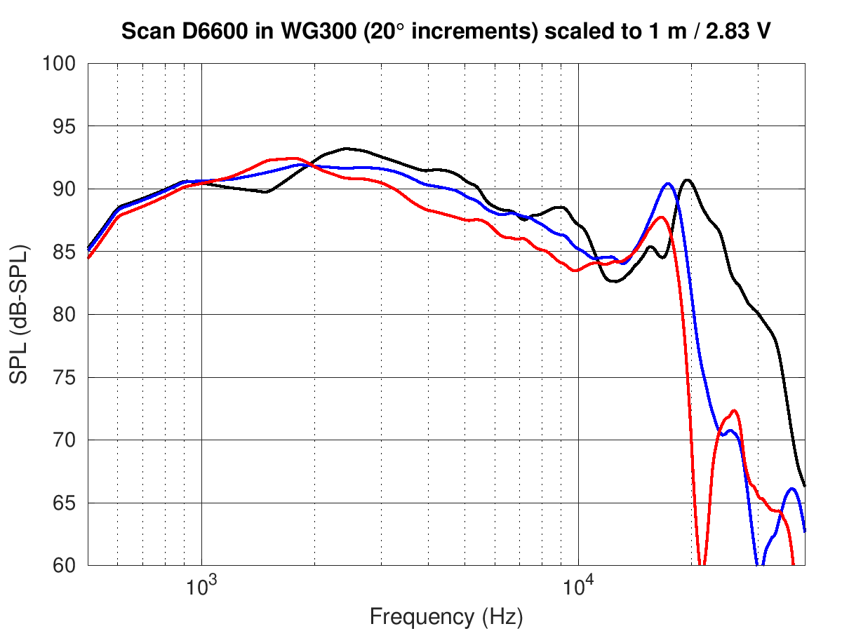

After I tried my Scan D6600 in a WG300 waveguide a while ago, I also tried the Scan R2904 in the WG300 and WG148 waveguides. Mating these drivers and waveguides is a bit of work, but doable (see here for the WG148, and here for the WG300; make sure to scroll down and also read the relevant follow-up posts).
I measured the SPL response and dispersion with the microphone 35cm away from the baffle. The baffle was 32cm wide, with the tweeter in the middle, 16cm from the top (yes, that's a "bad" position in terms of baffle-edge diffraction; and no, I didn't have the Monkey Coffin prototype baffle ready for these tests). The results (attached) were scaled to dB-SPL at 1m distance.
The on-axis is a wee bit bumpy below 10 kHz. I guess this is due to the baffle-edge diffraction, but I think this is not too bad given that the distance of the tweeters were centered relative to left/right/top edges!
There are some wiggles above 16 kHz, as discussed here. They are strongest for the D6600 in WG300, and "best" for the R2904 in the WG148. My ears will not hear these, so I don't worry too much about the >16 kHz wiggles.
While the D6600 is not loud enough for the Monkey Coffin, the R2904+WG148 does look like a suitable candidate. With an x-over of about 2 or 2.5 kHz it might also work out as a good match to the Volt VM752 in terms of dispersion.
What do you guys think?

Looking to the datasheet of the R2904/700000, the sensitivity with waveguide at 2.83 Vrms will be even more than in your measurment, not ?
For me it is ok, good choice.
The datasheet says 94.5 dB/1m/2.83V, but the SPL graph in the datasheet looks more like 92 or 93 dB/1m/2.83. I also suspect that the drive voltage level in my measurement chain might be a bit off (I need to check).
Yes, but looking to the sensitivity above 10 kHz, it is 92 dB minimum and more in the datasheet. That is some loss in the waveguide then, because in your measurement it dips to 88 dB.
At 2 - 3 kHz there probably is some waveguide SPL gain and the SPL there is already 93 dB in the datasheet.
But only good news if it is more.
