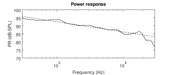

Here is the power response determined from the same data as shown in post 895. The slope of the dashed line is -1.9 dB/octave.
I used this code to calculate power response. It is based on the method described by Joe Tylka.

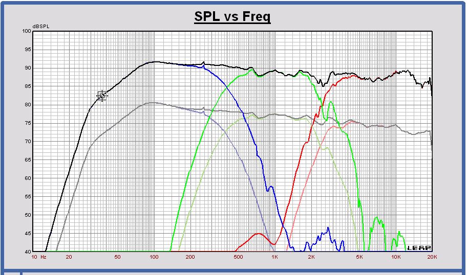

Well, I guess that's a question about how we perceive the sound balance of a loudspeaker. We hear a combination of the direct sound coming from the drivers (corresponding to the anechoic SPL) and the reverberating sound from the room. With a directional speaker, the proportion of the direct sound at the listener position is larger than with an omnidirectional speaker.
The sloping power response is just the consequence of the directivity increase towards higher frequencies (as seen in the polar plots of post 895). I don't think the slope of the power response is very conclusive for assessing the sound balance perceived by the listener. What is more important to me is that the power response curve has no pronounced peaks or dips.
The waveguide idea with the Monkey Coffin was to (i) match the directivities of the midrange and tweeter, (ii) to reduce the room effects at the listener position, (iii) to reduce the effects of baffle diffraction, and (iv) to reduce non-linear distortion from the tweeter (because lower drive voltage can be used for a given SPL output).

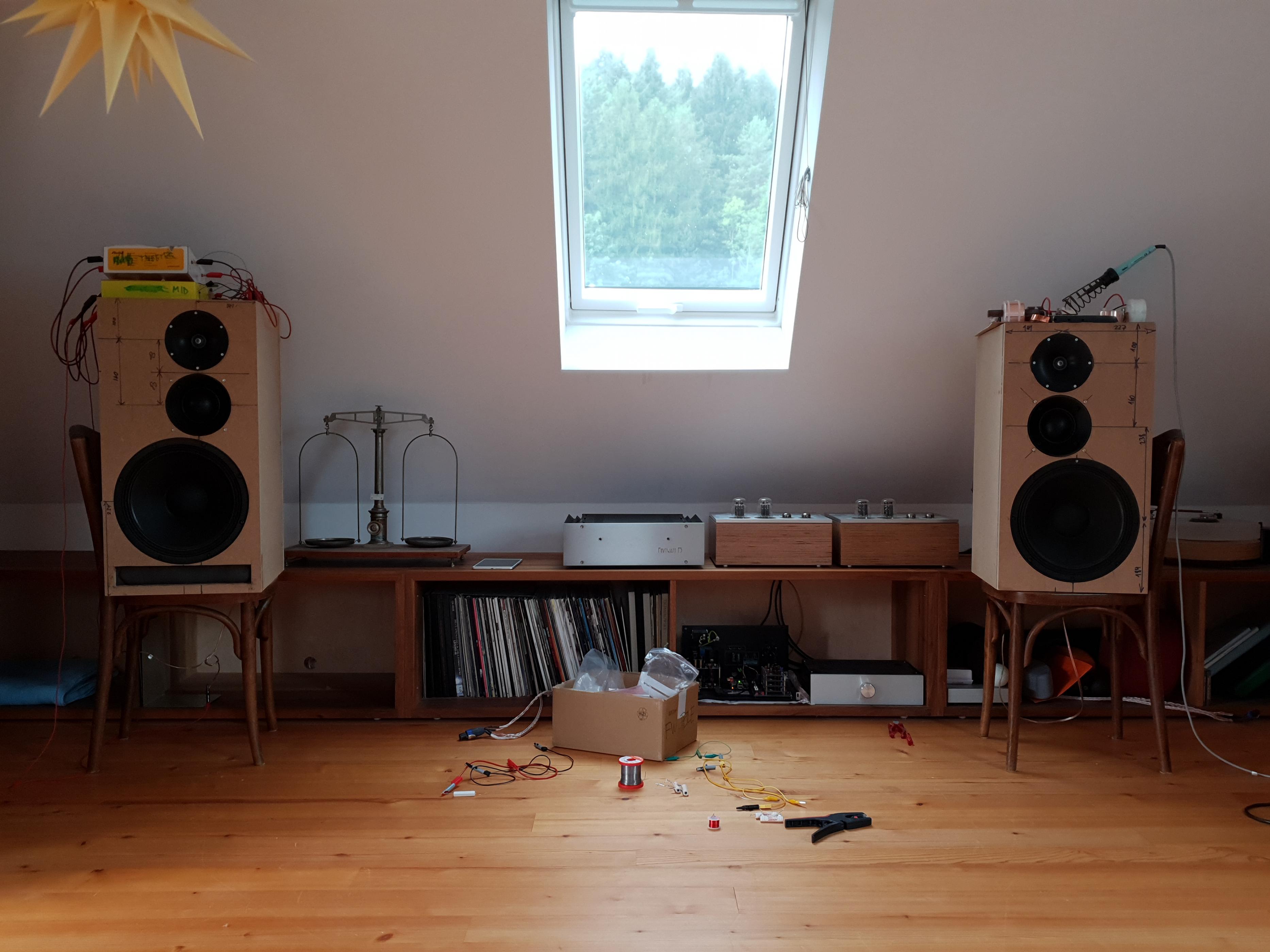

Here's a quick update from the listening evaluation. Listening is done in home environment, using my "Mac Gyver" KT66 tube amp (max. 11 W into 8 Ohm) and a FirstWatt F5 amp (25 W into 8 Ohm). x-over filters are EL2019030 version.
Describing sound is not easy, but here it goes...
The good things:
Not so good (and how to fix things):
The good things:
- Both amps have no problem to go drive the speakers. They can go loud enough to wake up the kids sleeping two floors below, all doors closed.
- Timbre is nicely balanced (with exceptions noted below), although the SPL curve(s) show a slight decrease towards higher frequencies.
- Sound is very transparent and dynamic. Integration between the drivers is very good (you don't hear the woofer, midrange, or tweeter -- just a speaker).
- Imaging is good. Close your eyes for a while, and then open again. With most speakers, the sound seems to go from the 3D stage to the speakers when you open the eyes. This does not happen with the Monkey Coffin.
- After longer listening sessions, something did not seem right in the lower treble. After listening to the individual drivers it was obvious the issue is related to the tweeter. Looking at the filter transfer functions it loos like the transition from the stop band to the pass band has a bit of a "sharp kink", which might affect group delay. A simple change in the parallel inductor of the tweeter filter from 0.22 mH to 0.18 mH solved this issue.
- Bass is clean and deep, but too lean. I took another look at the bass tuning using the microphone-in-box technique. This allowed me to determine the low-frequency SPL without the issues involved in summing the woofer and port SPL (crosstalk, phase inconsistencies). It seems we overdid the bass-reflex tuning a bit when we decided to tune it low in order to get a smooth roll off. The roll off started above 100 Hz, and was way lower than intended (-3 dB @ 50 Hz). I shortened the BR ports until I got closer to the intended low-frequency curve, and I am now listening to this. I still need to adapt the impedance compensation for the upper BR impedance peak.
It stays strange with this design that the SPL has to be decreasing to high frequencies for a good sound. It is about 3 dB, not so slight in my opinion.
If I look back to my own designs, if I designed the SPL response like that, it did sound dark, less expressive without any life experience, not amusing. I have to remark that all my designs have been done without waveguide. But with waveguide the room power is even lower for the same SPL on axis. So I shouldn’t expect that the high frequency power has to be set lower with the waveguide.

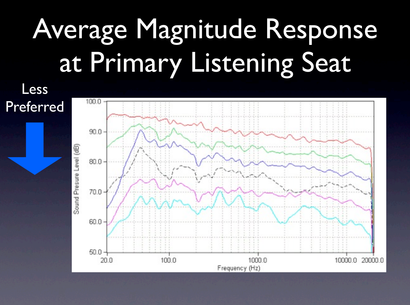

There has been quite a bit of research about what kind of SPL response curve is "right". I couldn't find the original publications / reports by Floyd Toole and Sean Olive (they seem to be hidden in non-open access papers), but there is a presentation summarising their findings. One of the slides (attached) shows the in-room SPL frequency-response curves of different loudspeakers, and how listeners rated them. The listeners liked a smooth response with a decreasing trend towards higher frequencies.
If the power response curve is used as an estimate of the in-room SPL curve, the preferred power response curve should look like the "good ones" in the attached plot. With a constant directivity loudspeaker, the on-axis response curve would have the same shape as the power response curve. While the Monkey Coffin is not a perfect constant directivity system, it is much more "constant directivity" than an average loudspeaker without waveguides. This is why the Monkey Coffin on-axis SPL response curve needs a decreasing trend towards higher frequencies for balanced sound.

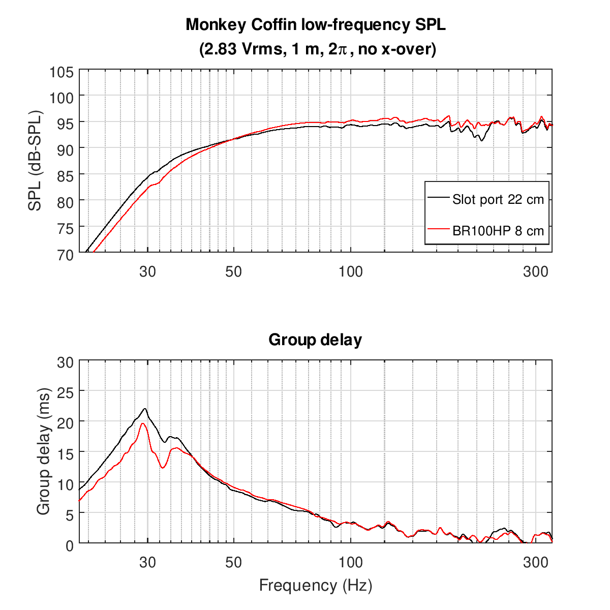

I also took some better measurements showing the bass alignment. The attached plot shows the free-field SPL curves (2pi)* with the 8cm long BR100HP port ("new" alignment) vs the 22cm slot port ("old" alignment). The difference is not huge, but there is about 1 dB more SPL with the new alignment from 50 Hz to about 240 Hz. This makes a surprisingly large difference to the perceived "weight" of the bass. Group delay is even slightly lower with the "new" alignment.
[*curves were measured using the mic-in-box technique for data up to 110 Hz, which was spliced to near-field measurements covering the range up to 300 Hz.]
The next task is to drag the loudspeakers from the workshop in the basement back to the listening room in the 2nd floor... these things are heavier than you'd think!
