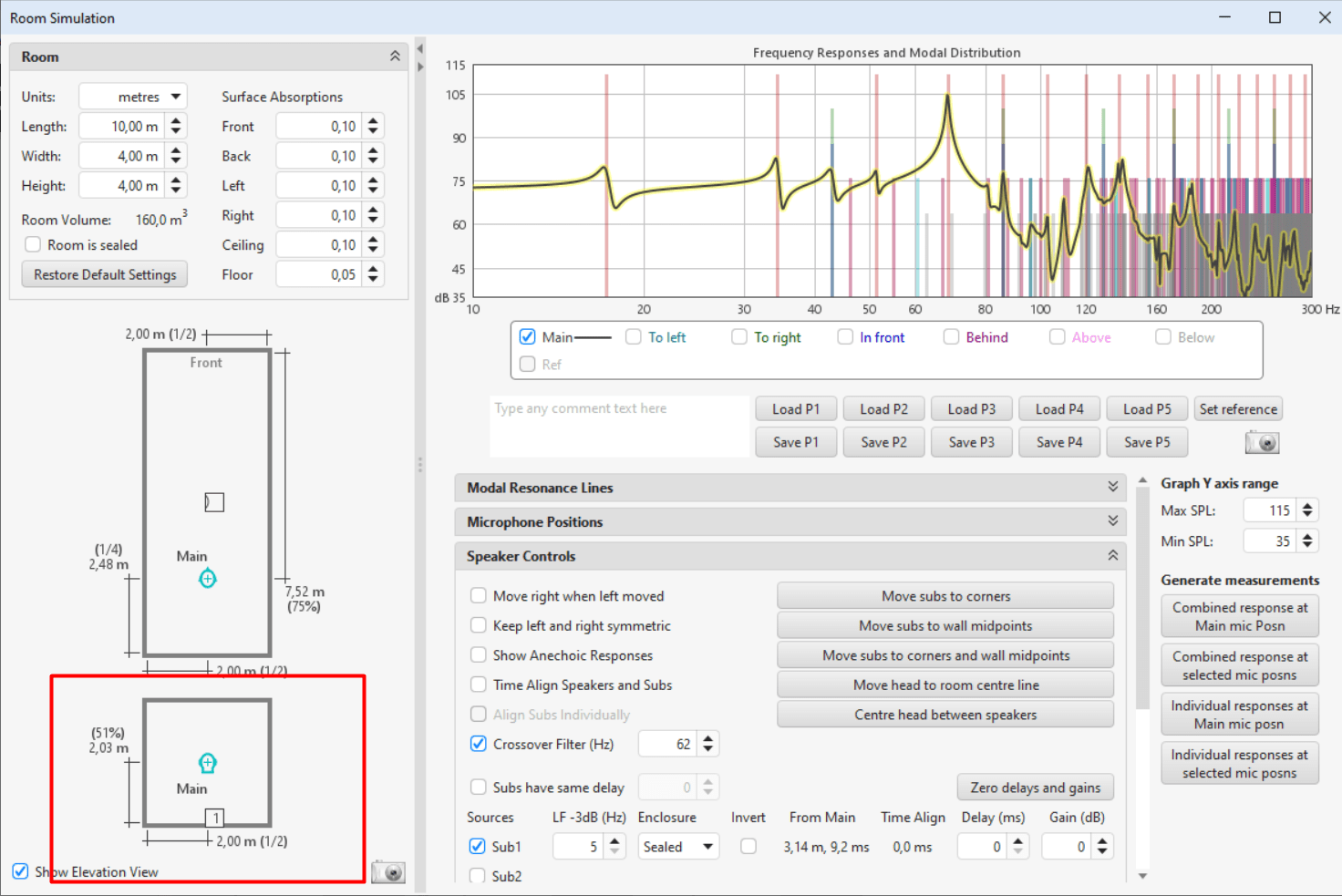

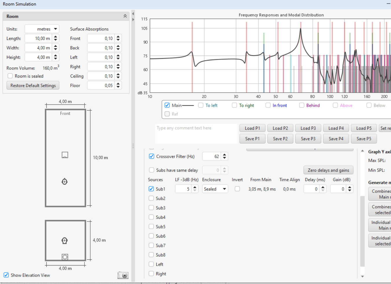

Here is a trick Kimmosto has posted about few times:
using REW room simulator, input 10x dimensions, 0.1x frequency to emulate a speaker.
Using a sub as the driver within box, listener is about at port inlet and the graph shows noise at that position with the sub position. There is no damping here and so on, but the underlying physics is same with room modes or box modes so this is indication between better and worse situation that considers only position of the driver and port inlet.

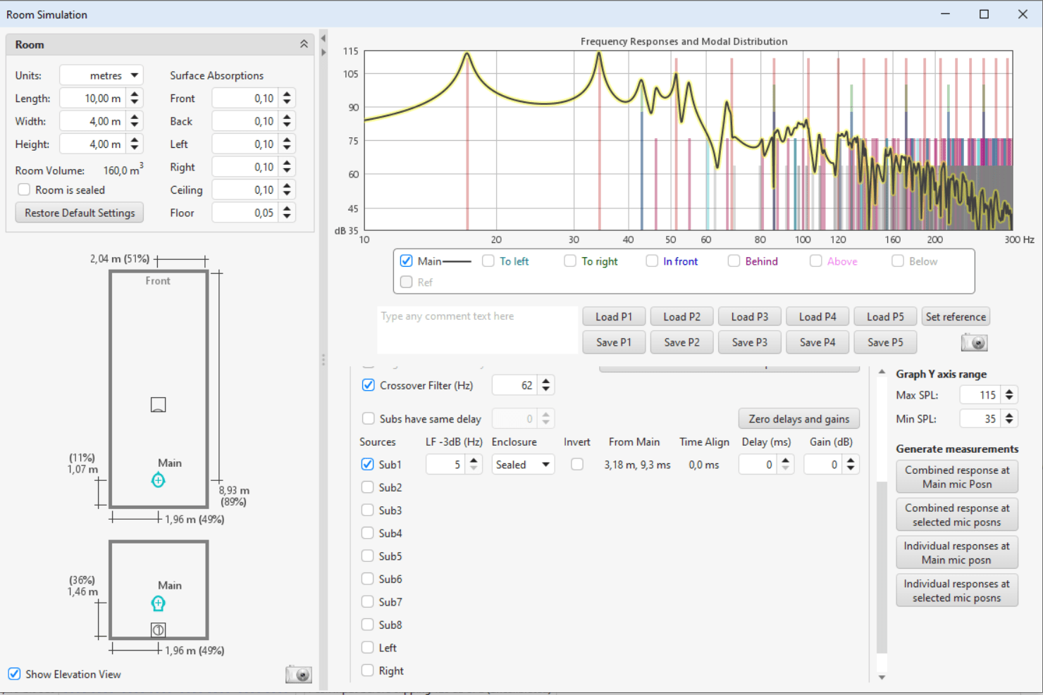

Here the source is midway to minimize lowest mode, and port inlet adjusted for minimal peaks above.

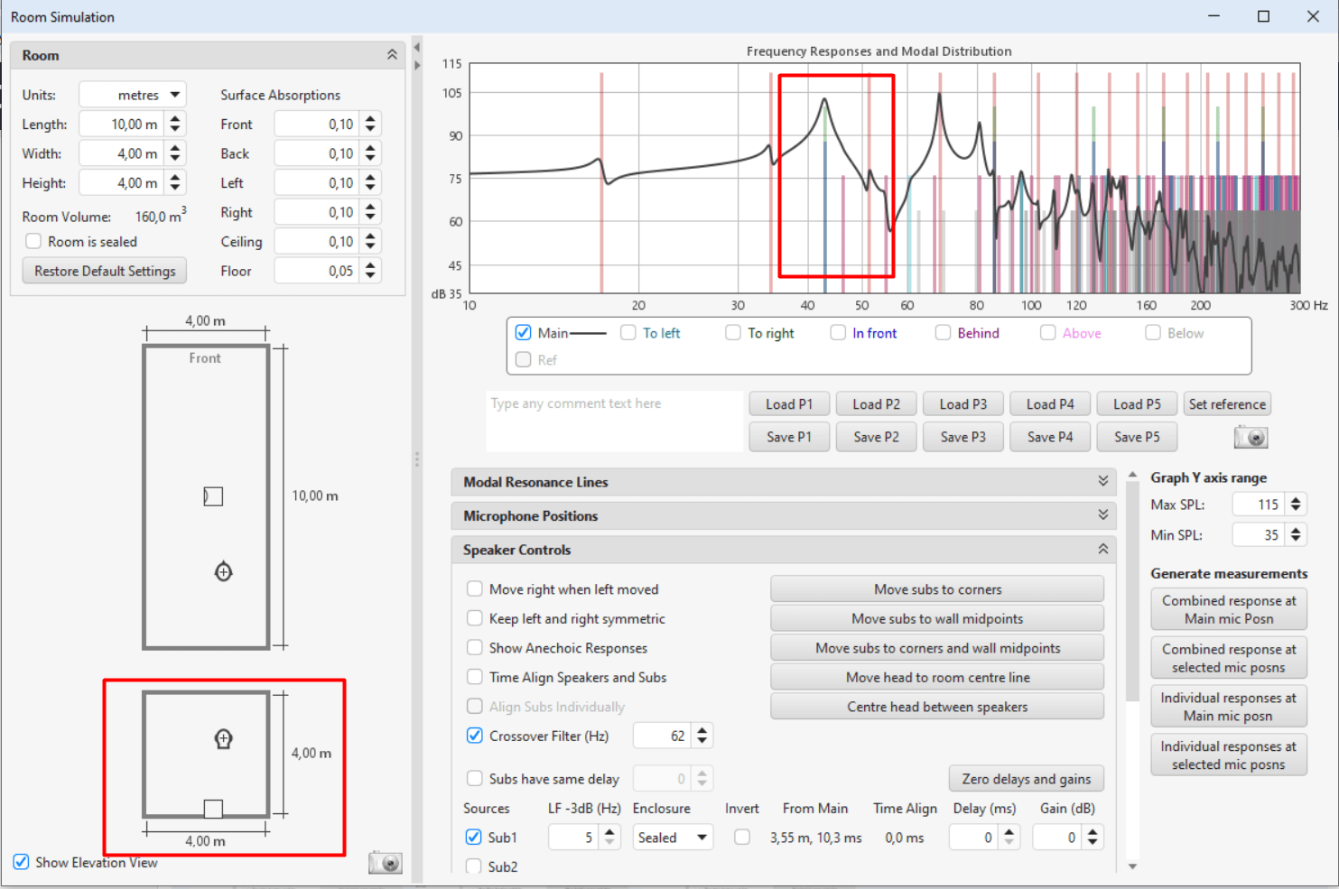

Moving both a little leads to much more noisy situation, difference on pass band could be tens of dB:
![example-speaker-as-driver-listener-as-port-inlet-worse-position.png example-speaker-as-driver-listener-as-port-inlet-worse-position.png](https://www.diyaudio.com/community/data/attachments/1174/1174362-586ba2a1967964514a6336ba0bf30a65.jpg)
On the above, 17Hz peak on 10m long room means 170Hz peak on 1m tall speaker, it's 10x scaled situation.

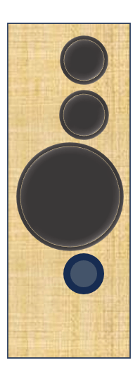

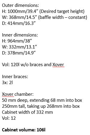

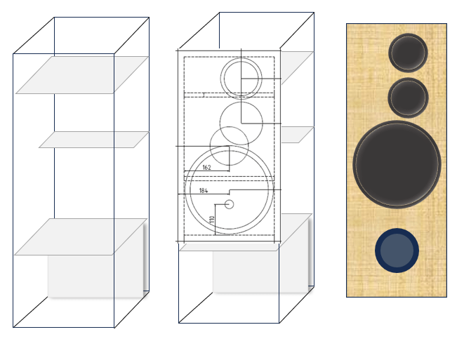

As mentioned above, I have been thinking about a tower version of the OSMC. To fit into our living space, and not be larger than the current speakers, 100cm would be a good height. Keeping the width and depth of the OSMC, I sketched the following and wonder if I am missing anything or making silly mistakes? Assuming 18 mm nominal thickness for the 3/4" Baltic birch available here in the US, the volume would be about 106l.
The two upper braces would be identical to the OSMC ones, and a third brace (or more) could be placed below the woofer. This brace could also be the top or bottom of a small crossover compartment. Any issues with the third brace or crossover compartment?
I would love to make this front ported to not have the speakers too far into our living room. Port placement/height could be centered between the woofer and the bottom, or closer to the woofer. Any insights on port placement on the front? Port dimensions is another question.
Unless I can find Baltic birch thicker than ¾” (18mm nominal), I would likely put a layer of MDF on the back of the front/baffle to accommodate the min depth of 20 mm for the Volt752. Would it be beneficial to add an MDF ‘lining’ this to the rest of the cabinet if using 18mm Baltic birch? This would further reduce the volume and add some heft to the cabinet.
Any insights and suggestions will be greatly appreciated!
Soren

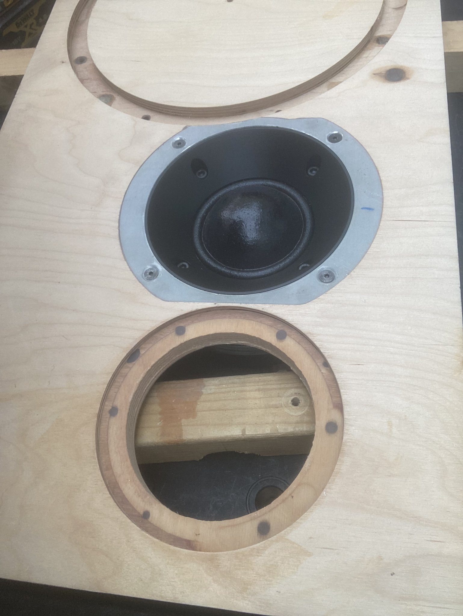

Re: front baffle. I just went with a single thickness of multi-ply. I can't imagine a scenario where rigidity would be a factor in that decision with the side walls so close to the woofer basket, and all the bracing. To account for the 20mm depth of the Volt I cut a ring of cork/rubber matt, that's available in many thicknesses—I ended up using 3/32". Came out perfect with maybe the Volt just a hair behind the face, basically right where it should be IMO. That driver is not small, what you see on the front is deceiving. It's a bit of Jenga to fit it in place with the woofer...I mention this related to the double MDF idea, there won't be much behind that driver and your screws may be long—and getting the Volt in place and not having sloppy baffle holes and not cross-threading the Volt is a challenge. I'd say keep it simple..... and build them again later if you love them and feel the need to eek out whatever you think might be missing (nothing! Haha).. Joking... it's all personal taste (placement?), assuming some baselines where met—they were.
Hi,Thanks for these insights! I have REW but have never attempting anything like that.
I note that ATC puts their ports immediately below the woofer and to one side, aligned with the mid/tweeter.
Would something like this be a safer/better position?
well, it could, depends where the inlet of the port is. The port could have a bend for example. It might be just visual thing, because if you try the sim the longest dimension really dominates the modes and the "height" is most important here, of course the "width" and "depth" also matter some.
The relatively random example I posted yesterday has symmetric width and depth so if the port (head) is offset on one dimension but fine on the other it's still alright, but offset both even a little and a peak appears. It's fiddly in this sense.

I encourage you to try REW, just input the room dimensions (your speaker dimensions scaled x10) and move the source and head with mouse and look the graph.
All this doesn't guarantee your port output is problem free, but I think it is a good indicator giving you a better chance if you put the port inlet to a position where SPL is lower than higher. At least try to avoid positions where you have strong modal peaks.
What you especially want to do is avoid the lowest modes, those are the most problematic as those if any are on the pass band, or closest to, and they are also least affected by damping material inside the box. Having transducer / port midway of any dimension gives most advantage on these.

I am rereading the thread to absorb more details. I did not see it, yet, but was bottom porting considered, or is this a poor idea? I am more or less resigned to the rear port as designed.

There was a lengthy discussion about this somewhere in the thread, and the (my) conclusion was that a front port is not the best idea. A front port would need to be a rather narrow/flat channel that ends at the lower rear corner of the box. The acoustics of this arrangement did not work out well. It's better if the port is wide open and can breathe somewhere near the center of the box. If you don't like the rear port for whatever reason, you could do a side port with the same dimensions as the rear port.was bottom porting considered, or is this a poor idea? I am more or less resigned to the rear port as designed.
