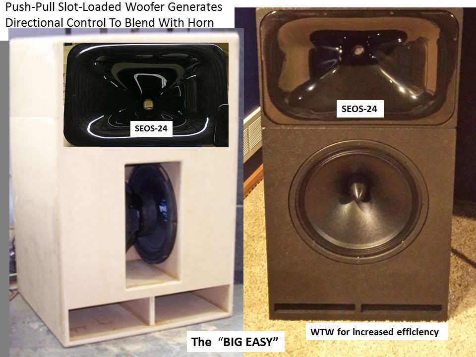

Hey, if people will buy a 6.5" full ranger for more than $1000/pr on this forum, I do not think that is an unreasonable expectation at all!
I'm not sure I would go with MTM. You have to be able to move the dang thing, ya know? And two 18s plus a big horm in a large cabinet would be very, um, weighty. One way that could accommodate both would be to make the design modular:
>> SEOS chamber to hold horn and crossover or electronics
>> 18 woofer chamber
Then people could build it up as an MT with woofer chamber and SEOS on top, or do an MTM by adding another "woofer chamber" stacked on top of the SEOS chamber.
Also, your push-pull slot loaded concept is not good since you need those driver to operate up to >500Hz. The slot creates a resonance which causes significant dips and peaks in the response, and these will occur below 500Hz if you use 18s in the slot (e.g. the slot is circa 20" deep).

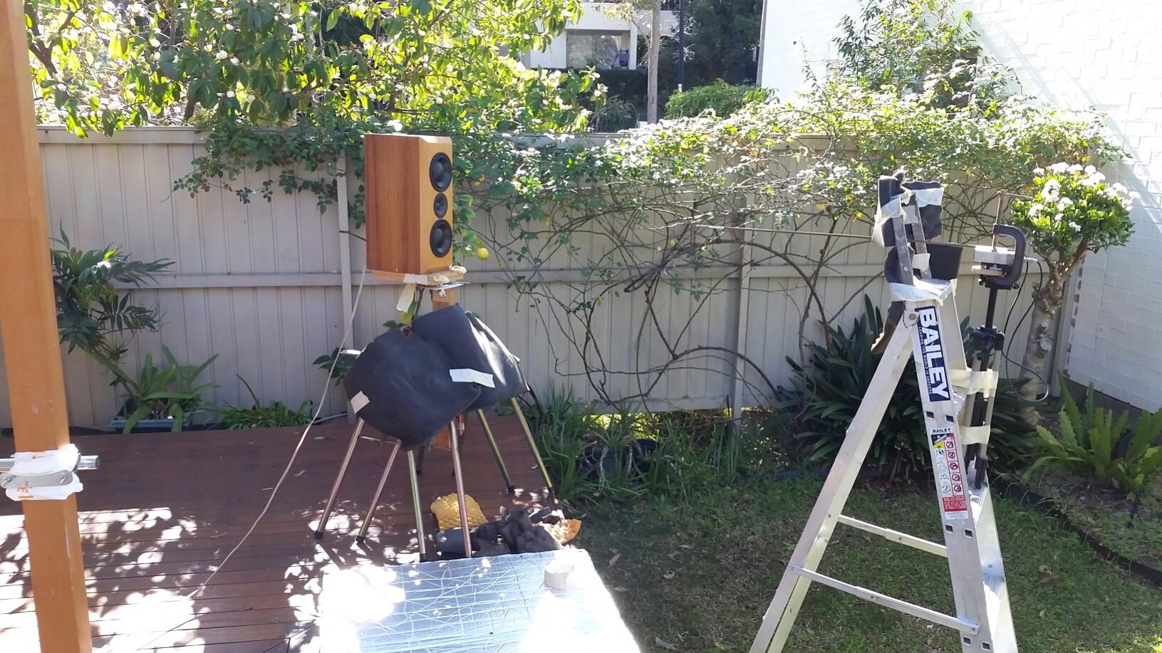

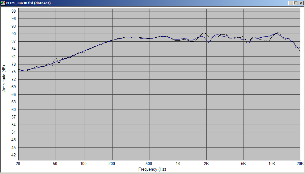

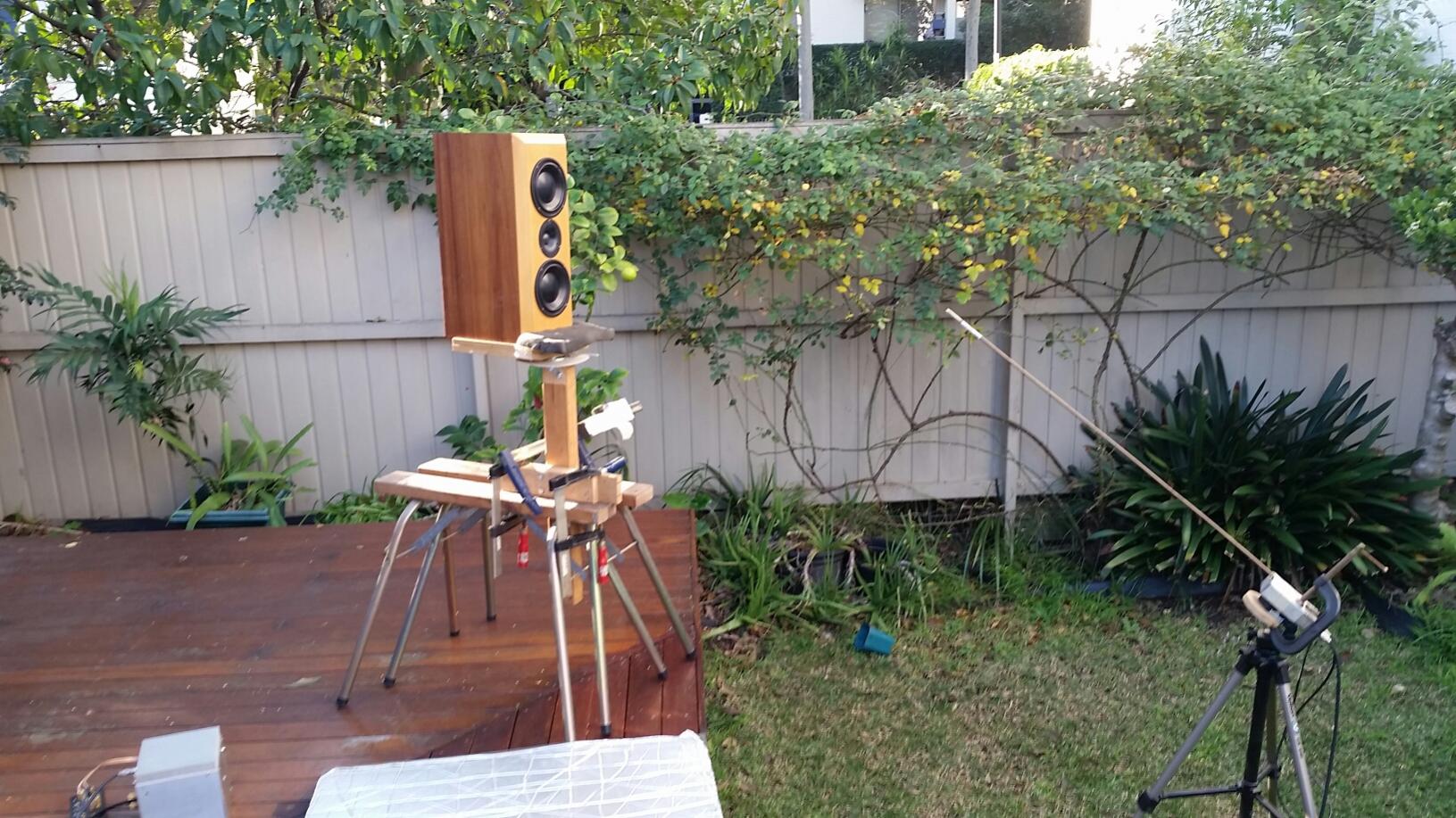

Very good point Charlie2. having the tool is one thing, actually being able to use it properly is a very different thing. Having a reference to check your results against makes a lot of sense!
I've been taking measurements for a long time now and it still surprises me every now and then when some variability creeps in. See Attached. This is the exact same speaker measured in the same place in my backyard. Black curve on 30th June, Blue curve yesterday.
There were probably three differences between these measurements. The one on 30th June I had the saw horses that were holding my speaker turntable oriented differently and had a large F clamp protuding out to the side.
The second difference is the 30th june measurement was done with Mic on tripod which is not tall enough with the mic wand angled up at about 45deg (it's an omni mic so theoretcially shouldn't make a difference, but reality says otherwise.
Third difference is that yesterdays measurememt had the tripod mounted on a step ladder. So that the mic boom could be straight on.
The 30th June measurements were cleaner and allowed a longer gate time, but I think that yesterdays measurements are probably more accurate. However without a reference how would you know.
There is a hell of a lot more to getting good measurements than having a calibrated microphone. Note that these measurements are with an uncalibrated mic, but I have measurements of this speaker from 5 or more years ago that match very closely to what I measured yesterday. The setup is equally important, and without a reference, how do you know you have set up properly!
1st picture is the setup 30th june (black curve) 2nd pic is setup yesterday (blue curve).
