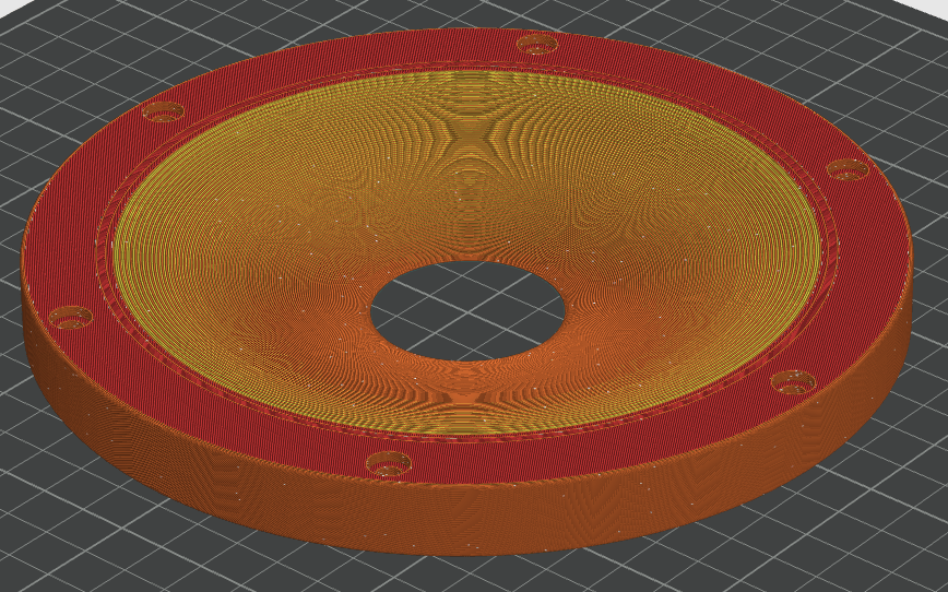

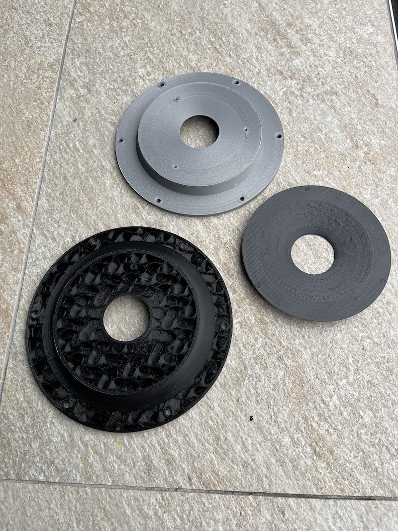

A small one that I posted T34A Small Waveguide
The bigger one that simulates better is printing now.
Trying to decide on the best strategy and material for the prototype
