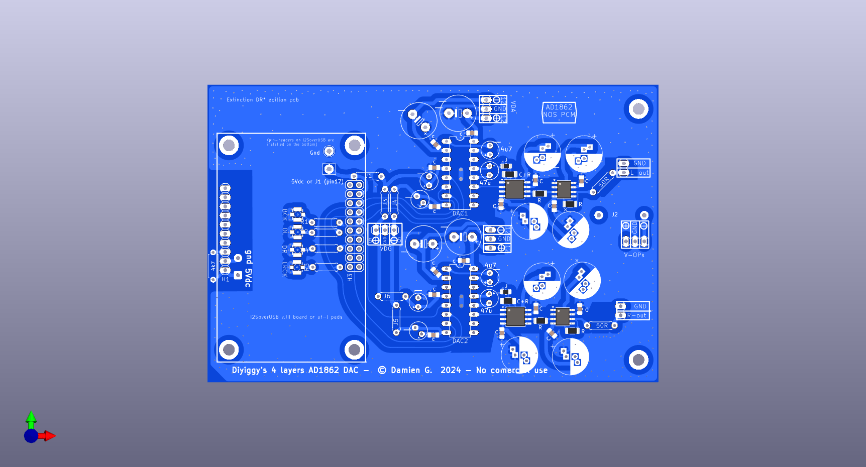

The best way to select the cap is to get the DAC to output a square wave. Any capacitance from the op-amp summing junction to ground is going to cause overshoot on a square wave. The cap across the feedback resistor can then be adjusted for max square wave fidelity. Unfortunately, even if you know the DAC output capacitance, you probably won’t know the layout parasitic capacitance. Therefore you have to do this on the actual final PCB layout. Additionally, keep any ground plane well away from the summing junction as this will cause problems as well.
I tried to do so. As one can see, no ground on the 4 mm circa between the output of the dac and the inverted pin... it is perhaps even too much (but the ground pin of that dac chip is just the next sided one, so signal can find a short return path away from the PS ground btw.
Edit : the name Extinction DR(for dead rooster) is a pun story to give a stupid name to the pcb as some do 🤓

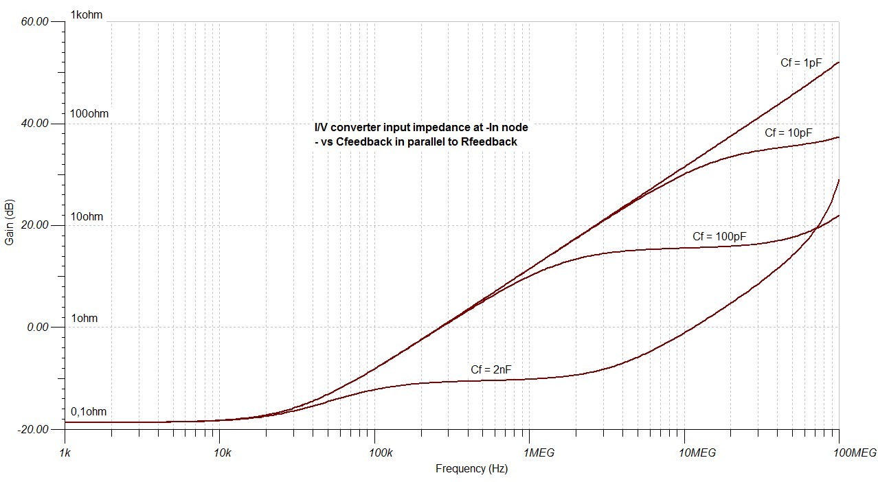

About the capacitor parallel to Rfeedback: I join the sceptics about it's rule as a compensation cap for stability and noise peaking. The typical audio value is much higher.
Instead, that capacitor plays a role in extending the low input impedance range at the -In node. Apart from defining the dominant filter pole. And helps with slewing.

"Instead, that capacitor plays a role in extending the low input impedance range at the -In node. "
Here it is a demonstration of this:
In a circuit configured as TIA, the Cf parallel to Rf is changed from 2nF (a ~ usual value) downwards until 1pF. ~10pF would be a usual noise peaking /stability compensation value..
With increasing feedback capacitance, the impedance at the -In node stays low for a more extended frequency range.
Reactions: Lee Knatta
Thanks, very instructive. I would not go for less than 20 pF cause layout, stray capacitance, contaminents (pollution, moisture, ?). Btw I wonder here if the gnd should not be removed bellow the Rf and cF too to put a return trace close but not bellow. OK greater area ground loop but less stray risks.
Some noticed a too much big negative effect on sound when you climb too much with cF, indeed it is often I have seen 2 nF with the op828 for instance.
