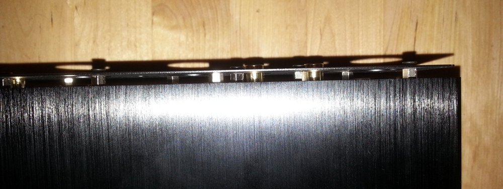

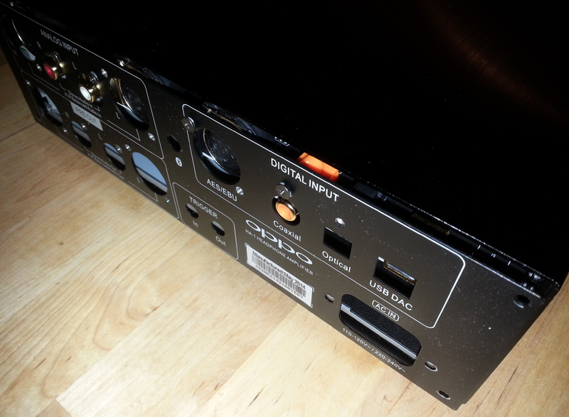

Quite happy with the solution I found for the back panel, giving more access for cold air inside the box. In the last time I had almost an obsession for finding something to improve the ventilation...😉

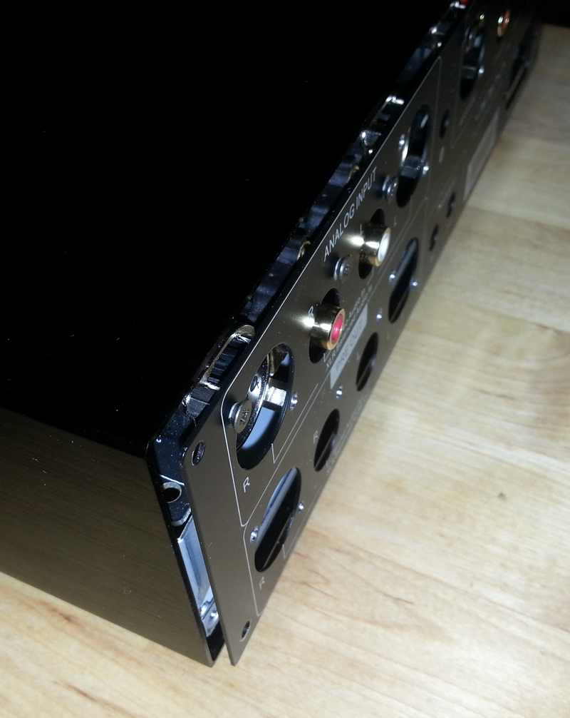

It is for sure not the best (looking) one, but I think is enough elegant. It will be Oppo`s job to find a better design to fix this ventilation problem. I have already some alternative in mind, but Im too lazy to put it in a CAD processor...
The solution here consist in creating a space in the back of the enclosure, to give more access to the air to come in. This space do not have to contradict very much with the nice design of the device. In my opinion this idea it fit quite well...
Using some (in this case) 5mm lengh M3 spacers for all the holes of the back panel, and the four holes of the enclosure, it create a enough opening. I have not tested it yet, but I think it will work fine this way.
I had not the right screws yet, but I ordered some black ones.

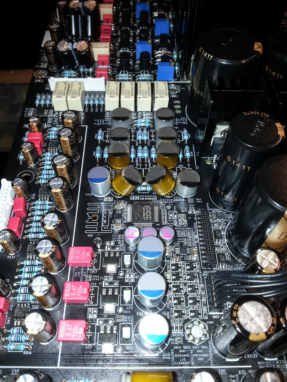

Here is the picture of a part of the visible mods. There are some more which are not yet done, and will be done soon. And the main mod after all these small, but very efficient: the battery powered clock for DAC. I just wonder how it will sounds this device after all will be finished, if the results so far are so spectacular...
P.S. BTW, I used the AC isolation caps of the class A amplifier in the suggested previously mounting configuration (serial coupling) to make a bipolar cap one...

As promised, I will try a disassembly tutorial for HA-1.
I will describe in details the operations. For someone many things here it may be already known. The detailed descriptions are for those who may not know such details…
First operation is to unscrew all the screws on the back panel, and remove the back panel plate.

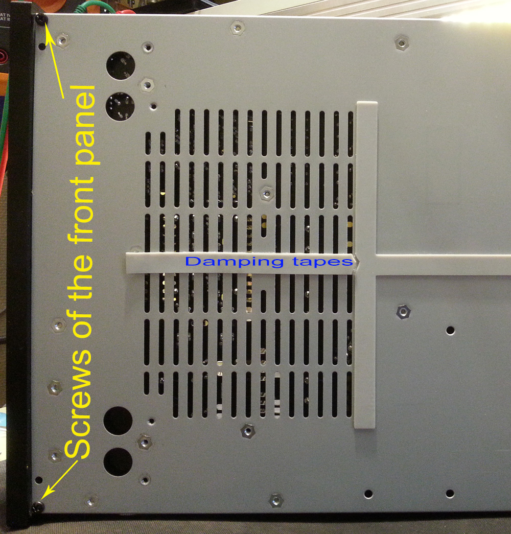

Then, turn the whole device vertically, on a side to have access to the lower side of the enclosure. Carefully remove the rubber pieces on the enclosure`s feet. You may use a tool to lift up the edge of the rubber pieces. These are attached in on the feet, with a double side adhesive tape. You do not have to remove completely the rubber pieces, but only lift it up a half part of it to get access to the inside screws. Unscrew these screws for all the feet.
Under the enclosure`s feet you may find some other screws, as the screws which keep in place the lower grill of the enclosure. Just unscrew all the screws you may find here, and remove the grill.
The down side of the chassis it have some kind of tapes on it to prevent vibrations, and eventual resonances of the mechanical parts (pic 3). If you may remove these tapes, it may be easy to take out the chassis from the enclosure. However, this operation can be done without removing these tapes on the backside of the chassis.
Place the device in normal position with the back end in front of you. Push carefully the inside chassis, while holding the external enclosure in place. The device chassis it is mounted as a tray inside the aluminium enclosure.
When you have created a space between the front panel and the enclosure, by pressing on the back of the chassis, turn the device with its front side in front of you, and pull carefully, but resolute the whole tray, out of the alu enclosure. Done!

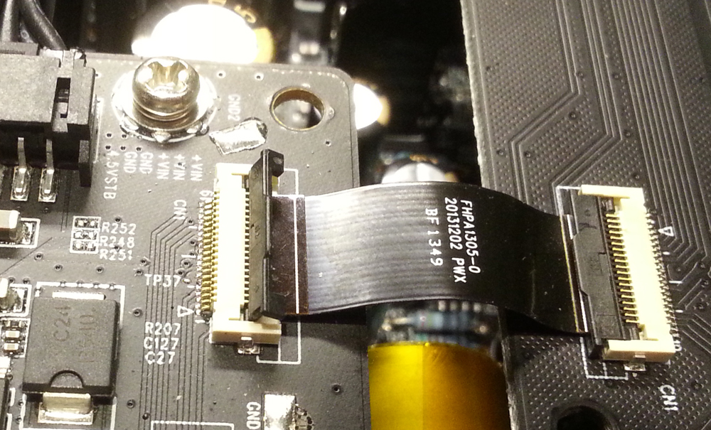

First operation in the next steps is to remove the digital board. Before removing the board, you may disconnect all its connectors. There are few quite easy to remove connectors. The connectors for flat cable it have a locking lid on it, to fix firm in place the flat cable. This lid it have to be lift it up as in pictures (pic 1, 2). The best tool for this operation it may be your fingers.
After the lid is lift it up, the flat cable can be removed very easy. One should pay much attention when to set in place again the flat cable. Its position into the connector is very easy to find, and is quite precise. However, be sure the cable is in the right position, and completely inside the connector, before you lock again up its lid/connector.
You have to take out also the Bluetooth coax from its module on the digital board. There are very small connectors here, so be very carefully when disconnect it. Eventually use a appropriate tool for this operation, and lift up the coax connector as vertical as possible from its pair connector.
After all cables are disconnected from the digital board, you may unscrew the four screws, which hold in place the board.

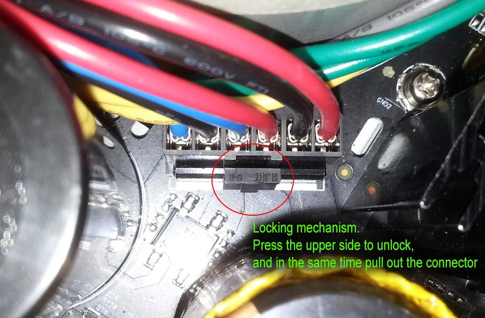

You may then take out the front panel in the next step. First, disconnect the connector with the wires coming from potentiometer.
Please pay attention that almost all of these connectors it have a locking mechanism on it (pic 4). One have to press the upper side of this small plastic part against the wires, while pulling out the connector from its place. Some time it may be a difficult operation, but once the connector is out, I will suggest cutting out that small plastic profile which lock up the connector inside. This in case you may appreciate repeating the mounting/disassembling operations. However, there are very few reasons to have these connectors locked in such device. There is actually no any pressure or vibrations to push out these connectors from its places, in absence of a locking system.

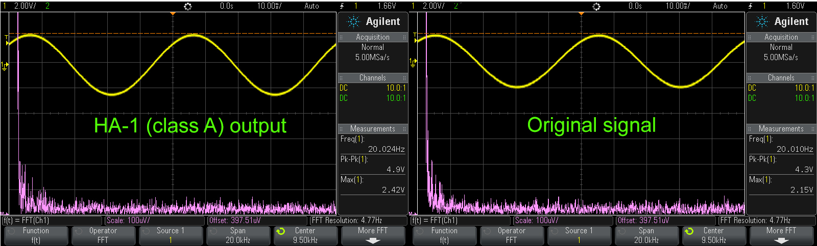

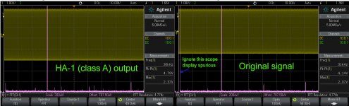

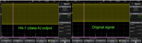

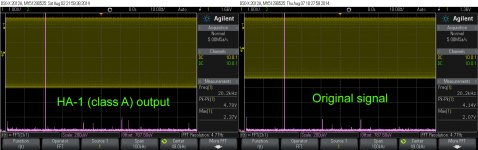

Well, I`m proud to announce that this last Oppo product (HA-1) is now modified, and the result is a much improved sound. As I know, this it may be the first modification of this Oppo headphone amplifier.
Do you thought the HA-1 it may be the most high level/end of an Oppo device, and no place for more modifications, or improvements? You took wrong. There is here enough to be even more improved...

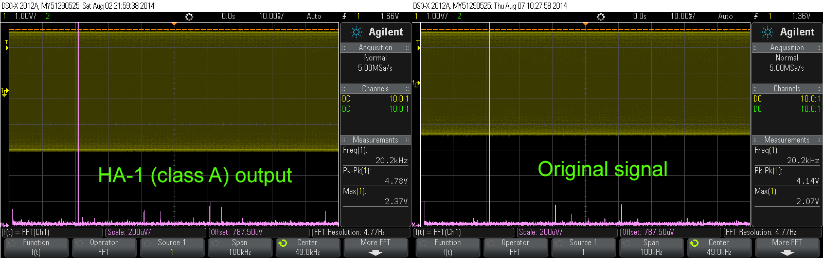

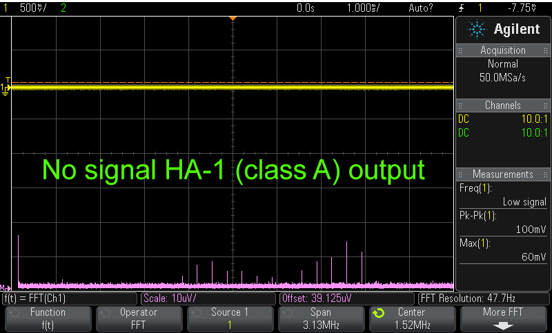

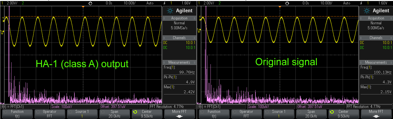

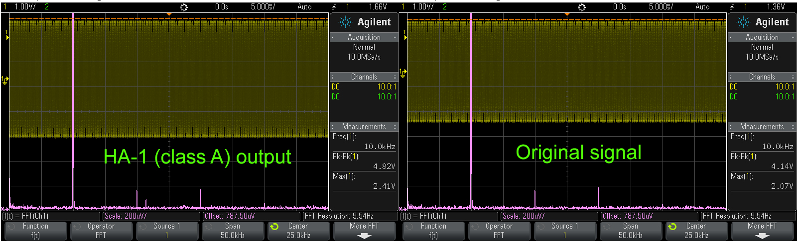

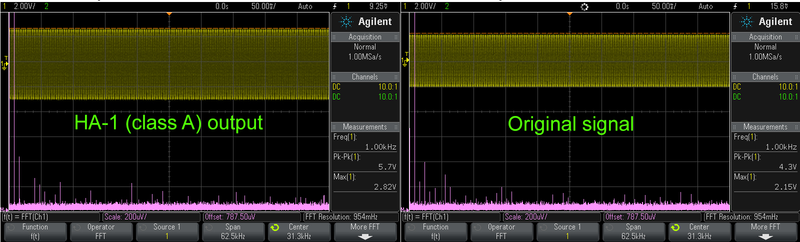

I show here some scope pics, with what I founded, doing some simple measurements. I find these measurements as irrelevant when about sound quality improvements due to quite simple modifications. But for those who want to see some measurements, please have a look...
My signal generator is not a high end one, so I put the original signal beside the measured output of the class A amplifier output, for comparatives. The device level is set to 0dB. I have seen under measurements on my device, 1dB difference between channels (showed by the VU meters). It may be because a graphic display error, or so. I perceive the channels very well balanced.
I show only one and the same channel output. Both channels are very similar.
I use the Vrms for FFT, as this way is more intuitive, I like it better, and I feel it as less abstract than the dB scale. Please note that the FFT calculations are for signal levels in µV domain, while the signal outputted level is in a Vpp equivalent scale.
Sorry to not detailed very much these modifications, and the components values, but a general list of the mods for this so called "Level One Mod" is as follow:
- Applied shielding for some noisy components inside the device (transformer, display. digital board).
- Thermal shield applied to some components (filtering caps) very near high temperature generating devices (heat sinks).
- Improved the passive ventilation and air flow inside the enclosure, by increasing the air input area at the back panel end. A 5 mm space is created between back panel and enclosure, while keeping the same mechanical position for the back panel components.
- Moved the 3,3v regulator`s final transistor on the back side of the main board, to dissipate directly on the entire chassis. This device is a high heat dissipating one in a quite tight and low air flow area.
- Improved the line output to DC coupling.
- Improved the analogue line input and its input AC coupled stage.
- Improved the AC coupled Class A amplifier inputs.
- Improved the decoupling of the line inputs stage, post DAC analogue processing stages, as line output stage. This improvement have as direct consequence an increasing of the filtering capacity for the whole differential power system (+/-14,5v).
- Improved DAC`s I/V stage, while keeping all the original opamps in place.
- Replaced AES/EBU connector with a similar one for headphone output, to use the headphone out (front panel) as dedicated line output.

Coris,
Well, we have discussed these measurements before, and with a 12 bit digital oscilloscope, you can't really see much on the audio signals. One option would be to put out a -60 DB signal, and amplify it before you send it to the oscilloscope… I'm glad that it sounds good anyway.
Regarding the heat, have you considered increasing the size of the holes in the bottom of the chassis? Usually, the way the chimney cooling works is to bring the air into the bottom and have it rise up through the top.
You said that you were thinking about forced cooling, and this can be noisy, or dusty if you're not careful. I like the Noctua PC fans, when they are run at lower voltages, ULNA, then they can be truly inaudible. However, I think generally you're better off without any fan at all if possible. Another option would be to add a larger heat sink, or even heat pipe to remove heat from these components.
Eric
Eric
