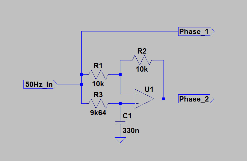

Hi Tom,
Here is an example of a generator kit XR2206 Function Signal Generator DIY Kit Sine Triangle Square Output 1HZ-1MHZ Sale - Banggood.com
and here is the design of a phase splitter.
![Phase.jpg Phase.jpg](https://www.diyaudio.com/community/data/attachments/533/533138-02503454e99a8edcc06d692172fb8ab1.jpg)
The example is for 50hz in and 90 degrees shift, but I can give you the values for 60 Hz in and 60, 90 and 120 degrees out.
The op-amp can be any low cost version.
You can vary the 50Hz frequency for +/- 0.9 Hz, while the phase only shifts +/- 1 degree, almost negligible.
For two phases you need one opamp and for three phases two of them.
Hans
Hi Hans
They do not spec how fine of a frequency change this will do. So if I understand this the unit provides us the sine wave we need but does not have any phase splitting ability. So you build a circuit with the right values to get to 90 for the 2 phase unit and 2 generators with 2 circuits at 120 and 240 for 3 phase unit.
So if this thing can make small enough frequency changes I am all in. No real expense just a lot of solder time. I enjoy these kind of journeys.
If you could do a schematic for a 60hz 90 degree for my hurst motors and the combo schematic for the 2 generator 120 /240 splitter I would appreciate it.
Thanks Tom

Here are the splitters at 60Hz for resp 90, 120 and 240 degrees.
When switching to 81 Hz (=45 RPM) all you have to do is to change R9, R5 and R8 into a 1.35 lower value, so resp 7k46 and two times 10K3.
This can easily be achieved by switching a parallel resistor of resp 23K0 and two times 39K8 to R9, R5 and R8.
Hans

Stability of the chip is at 10ppm/C, so I think stability won't be an issue.First I build the XR2206 kit, then I build a three phase splitter, and use the signal from the kit to drive the splitter. This would give the ability to fine tune the frequency +/-0.9 hz, which I could use to fine tune speed, after getting it very close by mechanical means. It would also stabilize the frequency, once set, it should stay that way. Correct?
Just change the frequency and the phase splitter resistors, no mechanical adjustment is needed.Any big changes in platter RPM, such as going from 33.33 to 45 rpm would be done by mechanical means, which I can do, as I haven't built my turntable yet. It'd be great to change platter speed from 33.3 to 45 by frequency alone, but I can deal with the mechanical option. Would it be possible to build a second kit and splitter for 81hz, to deal with electronically changing speeds, with the throw of a TPDT switch? Certainly seems cheap enough.
A NE5532 is a cheap and perfect amp for the job.If you give me a schematic with values I will build it, and post back. Since I'm a complete dolt when it comes to solid state, could you be so kind as to identify suitable op amps?
I have no idea what pot is used, but when fine adjustement is still too coarse, you could replace the pot by a 20 turn pot.One final question. How fine are the adjusting steps in that +/- 0.9 range? Thanks so much for your input on this. I think it is getting very close to a very nice solution to speed control for my 3 phase motor. Like you said it is a pity the 3 phase ebay generator is not ready for prime time.

Hi Twystd
Looking up how the pin out and schematic correlate on the ne5532 op amp. There is 8 pins on that op amp???
So I am all in. Will order the parts I need today. Looks like at least one guy in states that has the gen kit for sale.
