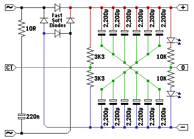

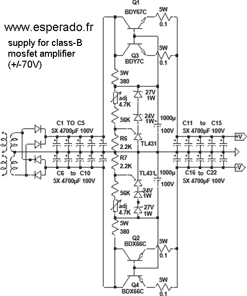

Attached is a power supply in use with 200va transformers for TDA7294 Monobloc amplifiers (each chip has its own transformer and power board).

Use a stiff power supply (20,000u per rail, 3a per chip)
Use less voltage than max (under-volt)

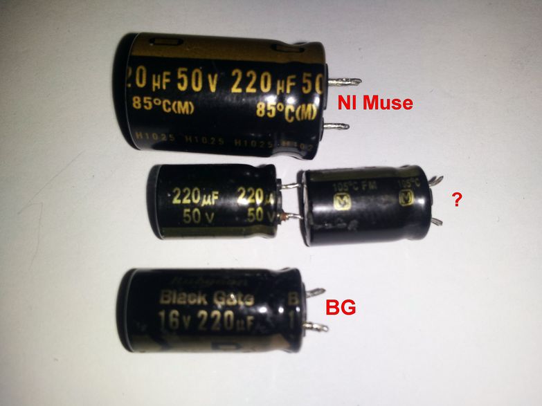

Oops... I thought you meant 2x220uf per rail. As I have space for one pair on pcb so I took 470uF. Will try 2x220...
So I tried 2x220uF. I couldn't find my Black Gate. My options were Philips, Cerrafine, Panasonic Pureism (which I don't like) and Panasonic CE HF. The Panasonic is twice the size of Cerrafine (and I think only slightly smaller than BG) so I used that.
I'm afraid I was listening to different brand instead of different capacitance here 😛 But I also change the bootstrap cap from 2x33uF Elna to Philips KO (that I like) 68uF.

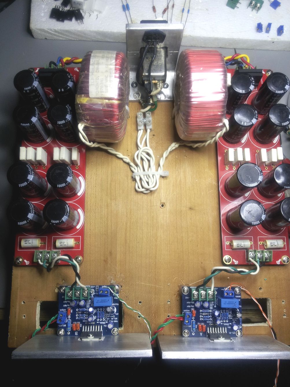

Jay, You are miles ahead of me ( I'm still working on some graphics to keep things defined for we less experienced) but I did find some 220 U caps to try. Unfortunately, they are all large amd previously used. Is simple off-board mounting OK, or should I attempt to extend the leads ? (I've done that before successfully)

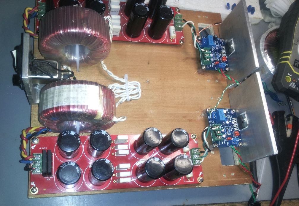

I'm working on the dual transformer setup right now.
Unfortunately, they are all large and previously used. Is simple off-board mounting OK, or should I attempt to extend the leads ? (I've done that before successfully)

Bob those 50v 220u with the "M" are Panasonic, and may do nicely.
The amplifier power caps need to be quite close to the amplifier chip.
Those are about normal size for the amplifier board's power caps.
Maybe see if there's room to add a small drilling to the board (so that normal size caps can fit) without drilling through a trace?

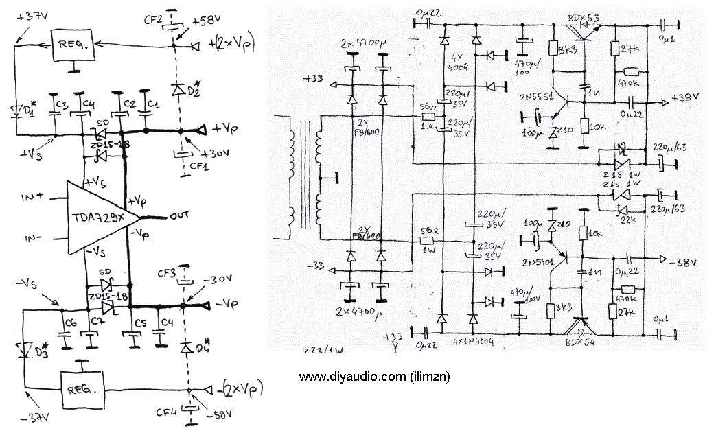

A few notes on the TDA7294...
The schematics of the 'insides' are notional only and not the actual schematic. Someone mentioned an op-amp as a phase inverter for the bottom MOSFET, in actuality this is a rather different circuit.
The output stage uses a combination of current source and bootstrap to enable the 'VAS' stage to produce outputs above the positive rail in order to be able to fully switch on the top MOSFET in the output stage. In some cases omitting this mechanism actually produces better sonical results even though there is a reduction in power. The reason is capacitive coupling of the bootstrap circuit to the VAS recycling any crossover distortion into nonlinear current sourcing for the VAS. It is a subtle difference, and can be avouded by driving the input stage power supply to about 8V above the output stage power supply.
In cases where separate power is provided to the input stage, it is VITAL there is a schottky diode preventing the input stage negative power rail ever going more more positive than the output stage negative power rail. The reason for this is the negative input stage power rail is tied to the chip's substrate (and with it the cooling tab), this should always be the most negative part of the chip otherwise parasitic thyristor structures which normally provide insulation of circuit parts from the substrate latch into conduction turning the chip into a short circuit, resulting in catastrophic failure when full power is applied (chips will literally blow apart). This is only hinted at in the datasheet in the 'high efficiency application circuit' - actually a class G amplifier built around the chip.
The most improvement in distortion comes from providing a regulated more negative rail for the input stage, as the first stage of the chip amp has lower PSRR from the negative rail. Adding a regulated and more positive supply rail for the input stage is mainly useful to eliminate the bootsrtap cap for the output stage - a higher input stage positive rail will automatically provide the extra voltage needed to drive the top MOSFET in the output stage to full conduction.
It is highly advisable to use the chip derated, in a configuration with lower than maximum output power. 30-40W has proven to be completely reliable and optimizeable without ever reaching any of the chip's maximum ratings. In particular, the power dissipation rating is a problem, the case will not dissipate as much heat as the actual silicon might suggest from it's voltage and current ratings. Think of these as a 'reserve'. The chip will reward you with top performance as none of it's protection circuits will ever be activated and muddle up the music signal.

I finished the dual transformer setup, but won't do any serious listening till tomorrow morning.
That takes the idea of tweaking to a whole, new level. 🙂 While that may be viewed as a challenge for some, I wonder if the sonic characteristics improvements - in terms of 'real' significant differences - offset a total re-design of the amp? That sounds like a real commitment of time, money and a lot of energy. Just a thought. I'm quietly and passively following this thread though.....full optimization will require a more sophisticated board layout than what is generally used.....
redjr, I understand what you are saying. It does appear two divergent paths are emerging. I'm coming here from a LM3886/MyRef background and completely appreciate the years and number of contributors necessary to go from "ChipAmp" to it's current state. Maybe this thread will determine which direction gains the most support.
The most improvement in distortion comes from providing a regulated more negative rail for the input stage, as the first stage of the chip amp has lower PSRR from the negative rail. Adding a regulated and more positive supply rail for the input stage is mainly useful to eliminate the bootsrtap cap for the output stage.
Thanks for the info, ilimzn. I'm attaching your circuit to this thread so everyone can see it as an option to optimize the TDA7294 output (by regulating the input stage).
I myself prefer another option to retain the bootstrap cap. And regulation can be done to entire amplifier. Call it a pre-regulation, because full regulation for output stage of class-B amps usually doesn't sound good for some of us. So a simple zener based pre-regulator can be employed. I'm attaching a power supply used by esperado (Christophe) to power his mosfet amplifier (class-B SAA-Crescendo). Note that after regulation he still provides massive capacitance. I have tried simpler than this and I can accept the sound, noting that I'm a proponent of input-stage-only regulation.
The regulator must be simple, as too expensive might not justify the use of chip amp (?). Fortunately we don't want a full regulation for the output stage. What is your comment about this second option?
As for going "cost-no-object" with this cheap chip amp, can you see any benefit? As you have noticed, it is not really preferable to get the maximum power out of it. About class-A approach, I'm afraid an Aleph-J is simpler and sound better. What I can see is the performance of the mosfet. They say it is a DMOS. But I think it s quite good for class-B. So because lateral mosfets are expensive, this can be a justification for those who like the sound of mosfet amps.

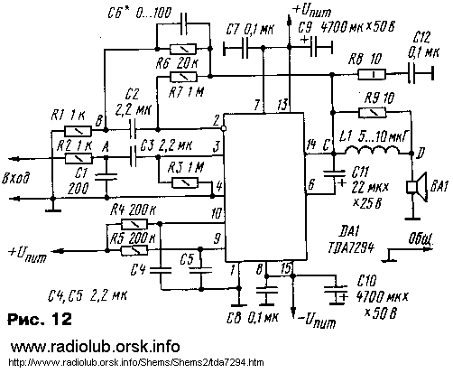

The input stage is fairly low noise, but it's still preferable to keep input and feedback impedances low, better 10 or 20k than 50 or 100k. Keeping the DC resistance on both the + and - input is crucial for low offset, also if somewhat lower amplification factors are used (IIRC 20 or 24 is the minimum for stable operation), I have found the chip's input stage offset to be low
Yes, I can see the current mirror of the input LTP. With original schematic I prefer lower feedback resistance (10K for example). But low input impedance (issue for the signal source), along with low feedback (issue for speaker damping) will seriously "ruin" a capacitive mosfet output performance. You will see lower distortion, but the sound will be boring. And this is a situation I think where a matching preamp should be discussed also, as part of the design.
But the schematic from radiolub that I posted previously have a high input impedance and to my ears sound preferable than any schematics with simple FB arrangement I have tried.
