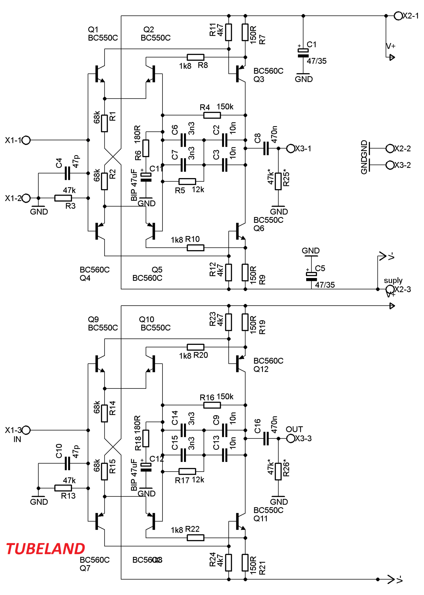

Actually, the Tubeland.de kit is nicely priced if someone want to experiment on a Supra-type topology (actually Borbely-Lender type).
Selling it as a kit I would think Tubeland has tested their kit and it should be good as is. Maybe they reduce current in output stage to avoid heat in Q3/Q6.
That being said, I would have expected R11/R12 at about 8K2 and R10 at about 2K2 or so. I'd be currious as to how this would sim
I may actually order a set and test the PCB with JFET input transistors. Way back in the mid eighties I had a Supra and remeber that I was very happy with the sound quality (although my references was very low-Fi at the time).

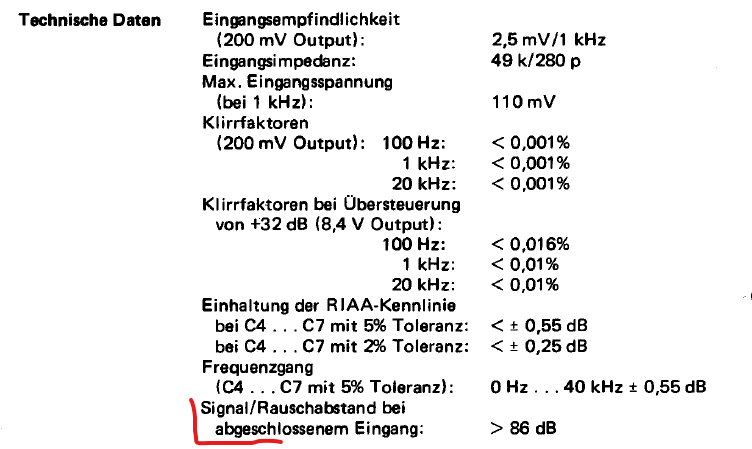

Elektor gave the following specifications:
SNR > 86dB
THD < 0.001%
The noise is to be reduced by a factor of 2.82 by connecting 8 transistors in parallel in ac-mode.
Correct as always Marcel, my German is very rusty, but I believe "abgescholssenem" means shorted in this contextThey probably measured with an unrealistic source impedance, for example 600 ohm instead of 600 ohm plus 500 mH.
The technical term "abgeschlossen" means in German:
with the typical source impedance against the reference potential shorted.
No short circuit or even open.

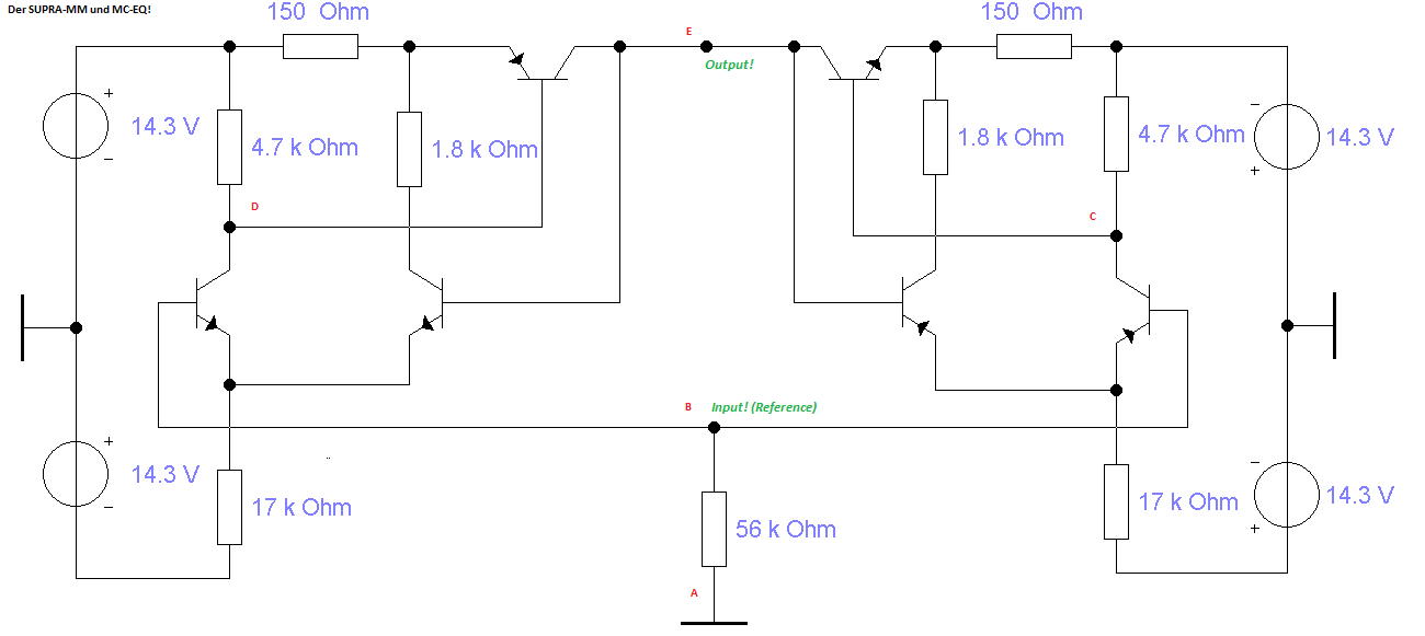

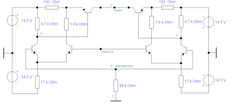

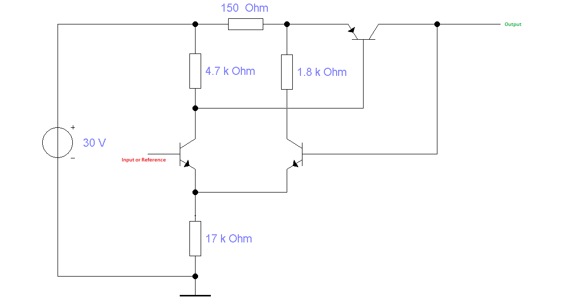

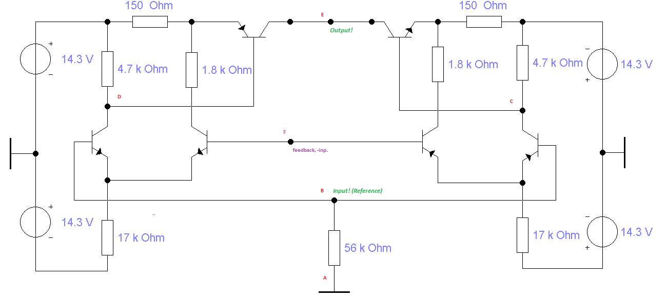

Please take a look at my sketch of the discrete (symmetrical) OP-AMP. And now a transfer to the dynamic, ac voltage world must take place. Then you can also better understand the noise issue.

I wouldn't do that.
You can see that TUBELAND must have misunderstood something.
SUPRA

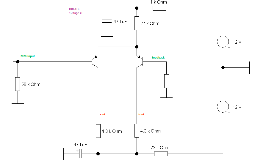

With open global loop, only to supplement the excursion /trip.
But it still revolves around possible shot noise and the base current in OREAD.

On the left of the picture you can see a positive voltage regulator and on the right a negative voltage regulator - if you like. In any case, you have two halves, which is not quite right, you could also talk about single-ended operation, but in the end you have 100% class A push-pull operation. Or also a source in 4-quadrant operation.

Our schematic is shown in post #2.

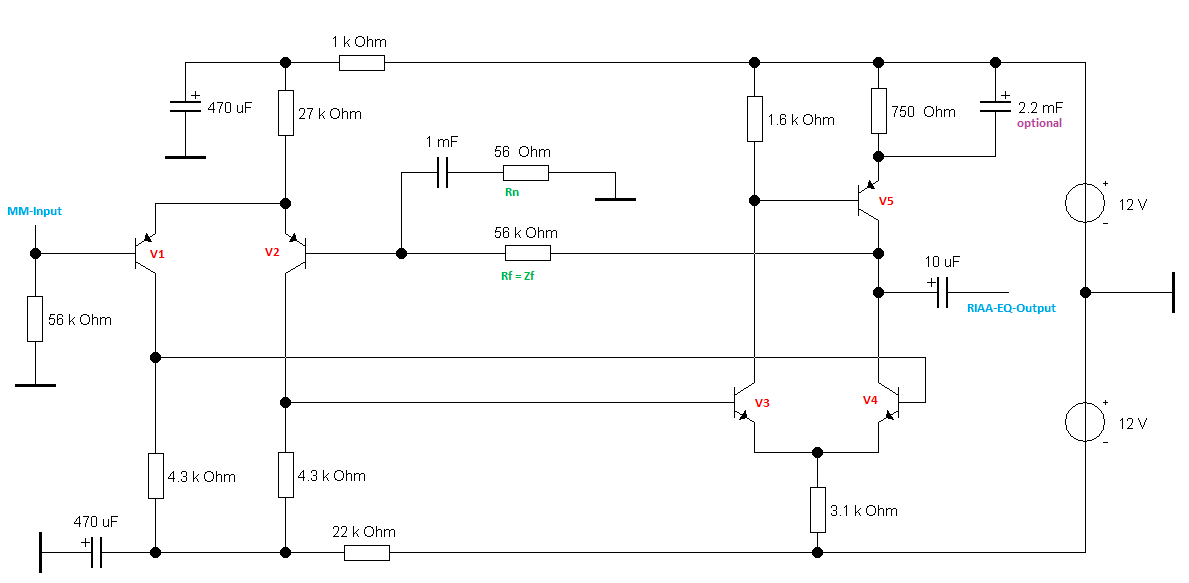

Since "chestnutspread" is down sick, I'll try to steer this thread a bit for now (hopefully in his best interest).
The SUPRA design excursion was for clarification purposes only.
Maybe someone has a better dimensioning and transistor suggestion, or a different topology with a maximum of 5 active transistors, unipolar or bipolar. The better one might be the EQ of the AR A-03, but that would be a clone.
Thanks for digging this up. Unfortunately, abgeschlossenem means terminated, so you still don't know anything when they don't tell you what they terminated it with...

In this instance it means "Input connector shorted" or "signal to noise with input shorted""Abgeschlossen" would probably mean "disconnected" in contrast to "angeschlossen" (connected). Not sure if that's what they intended though.
I fear that too "Boydk". But i hope it isn't. "Elektor schrieb nicht "mit kurzgeschlossenem Eingang" " - that means the term shorted.
Here is an adapted dimensioning example of the first stage of the possible discrete OP amp ... The question of the most suitable transistors at this point is still open.
Shot-Noise should be no longer an issue.

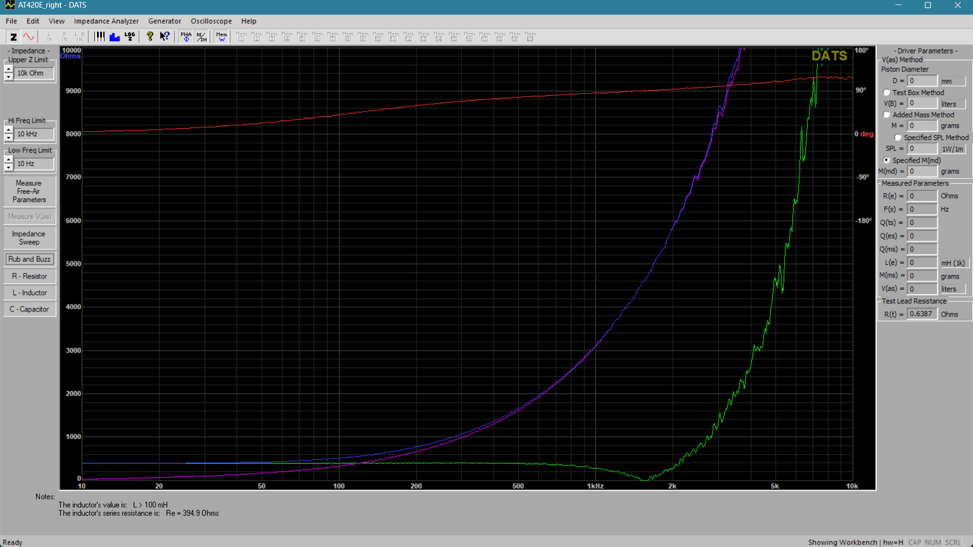

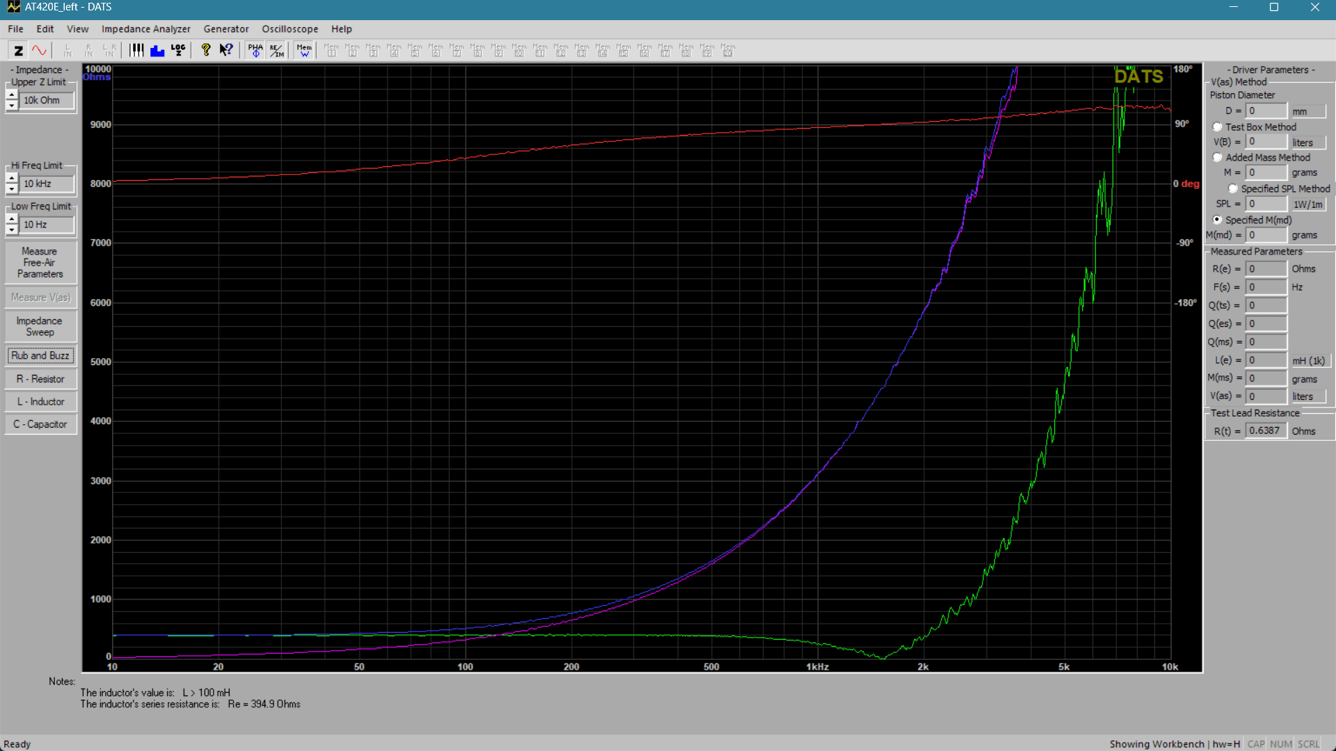

Measurements on an AT420E/OCC MM system (with HM8018 LCR bridge, FLUKE 73 Multimeter, DATS V3)
left: "100Hz to 25kHz"
Rdc = 385 Ohm
Ls = 515.4mH to 269.6mH
Rs = 406.8 Ohm to 21.83 kOhm
Ls_1k = 481.8mH & Rs_1k = 734.2 Ohm; Lp_1k = 510.7mH & Rp_1k = 13.22 kOhm
right: "100Hz to 25kHz"
Rdc = 385 Ohm
Ls = 520.5mH to 276.2mH
Rs = 393.7 Ohm to 21.47 kOhm
Ls_1k = 483.9mH & Rs_1k = 751.1 Ohm; Lp_1k = 513.8mH & Rp_1k = 13.01 kOhm
The manufacturer's specifications are as follows:
|Z1k| = 3k1; L1k = 500mH; u_max = 4.5mVrms at 5 cm/sec and 1kHz sine wave!
This is the only MM I currently have to hand. The moving magnet was not clamped, but moved freely during excitation and measurement.
As we can see, the series equivalent circuit is dependent on frequency as follows: Rseries increases and Lseries decreases.
The parallel equivalent circuit results in a slightly different function, let's think of a classic resonant circuit ... ultimately, as we all know, the result is (at the end) a higher-order low-pass filter with a quality factor (hope) not greater than 1, which is why we have to terminate the signal generator correctly.
Without a capacitive termination, the highs could be lost, right?
Cp||47k
Z(25kHz) = 21,645kOhm +j (42,867kOhm) ---> |48,022kOhm| The manufacturer's specification of a 47k termination is correct.
Now we just have to play with Cp until we achieve a Q between 0.707 and 1, done
Bye,
HBt.
