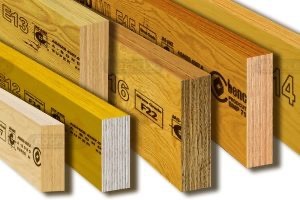

What about Laminated Veneer Lumber LVL. Say for an open baffle design, this is pretty inert and mighty solid. Any downside besides pricing.
A tad overkill? 😳
A tad overkill? 😳
