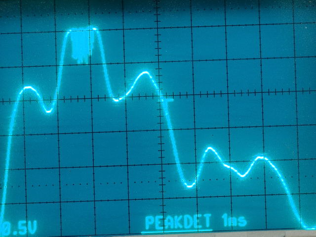

I have been working on my "universal driver board" on and off since late last year. Before my recent trip I had been testing the first prototype with various output tubes in screen drive and conventional grid drive. No anomalies have been seen but all testing has been on the bench with test equipment and a load resistor. No listening tests were done since I only had about one week to work with the board before I had to make a long road trip. The last test was a pair of VT225 / 307A tubes in triode wired P-P using conventional grid drive. 30 watts comes easy with this design in AB2. Hard clipping is near 40 watts.
Tonight I turned the power on for the first time in 3 weeks and the amp still worked. The scope traces were clean even when pushed well into clipping. OK now it's time to listen. Righe now there is only one channel, and it is operated by 4 seperate bench power supplies. There are clip leads for connection to the output tubes and power supplies. I connected my speakers in parallel and wired them to the 4 ohm tap, attached the CD player and cranked it up.
The amp sounds nice but the bass is a little loose. Maybe a small amount of feedback will tighten it up, but I am not going to try that now. I played some different music while turning the knobs. I found that the amp sounded better by reducing the B+ from 380 to 350 volts and turning the tube current up to 75 mA each, yeah way over the line. This tightened up the bass considerably. I can play Depeche Mode pretty loud now, and Diana Krall is sitting on top of my speakers (mono remember).
I was cranking Diana way into the clipping zone and her voice cracked. This is not right. The piano cracked too. It doesn't sound like typical distortion, it sounds like...... the gremlin!

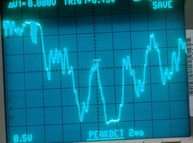

I connected the storage scope right across the speaker and kept pressing the save button until I caught one. It is interesting that cranking the amp with rock, techno, or any other complex music doesn't seem to cause it.
The picture is a single piano note pushed into clipping from the intro to Diana Krall's rendition of "How can You Mend A Broken Heart" off of her latest CD. Note the ringing in the flat topped portion of the wave. This is a high frequency oscillation that occurs briefly as the amp clips. It does not do this with the same music and a load resistor. A speaker must be used. It does not happen if the amp doesn't clip. In fact it doesn't happen on gentle clipping. The oscillation either happens, or it doesn't. It doesn't change level or get worse if the volume is turned up more, it just happens more often.
I plan to investigate this more thoroughly and report my findings here. My usual gremlin hunting tools like the AM radio, the TV, the scope, and even the spectrum analyzer will be used.
After playing the entire Violator CD at far too much volume I have found that the gremlin can be coaxed out of hiding with some more complex music. It doesn't happen as often and you have to be far enough into clipping that I had to put the speakers in the bathroom and close the door. It sounds nasty, turn that s*** down kind of nasty. You would not listen to this, so I never heard it during the first listening session. I captured one instance of the gremlin on the scope with Depeche Mode's "Policy of Truth."
Later I found that brief transients seem to be the worst offenders. The single piano notes mentioned before can be played far enough into clipping to bring out the gremlin, but not yet sound bad, so the effect is audible. The worst offender? Enya. Her brief staccato orchestra hits on "Orinoco Flow" can be played loud enough to invoke the gremlin on every note, but oddly enough he is just barely audible.
Its 10:30 PM, and I have annoyed the neighbors enough tonight, so all is silent now.
I have a new version of this PC board all done in my computer. I am debating whether to continue chasing this down on this board, or stop and make one of the new ones. Either way it will likely wait till next weekend.
