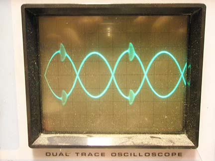

I may have run into this recently. At 1 KHz, pushing the input to the point of clipping, on a breadboarded amp that is rather poorly laid out, I got these "bubbles" when I backed off the test input level. This was located right after the phase inverter, and before the final output tubes (not 807s, but pentodes). There is a high level of feedback in this situation. The image shows both "legs" of the inverter output.
Are these the same kind of bubbles that are described for the 807s?
I hope these bubbles will disappear in the final build using better layout and much shorter wires. . . . I also noticed that touching an AC balance pot in the PI section affected the bubbles (in one case well below clipping causing it to appear, and then disappear when not touching the pot), but the bubbles appear on their own at just below clipping. I hope this is just RFI and not due to the OPTs.
